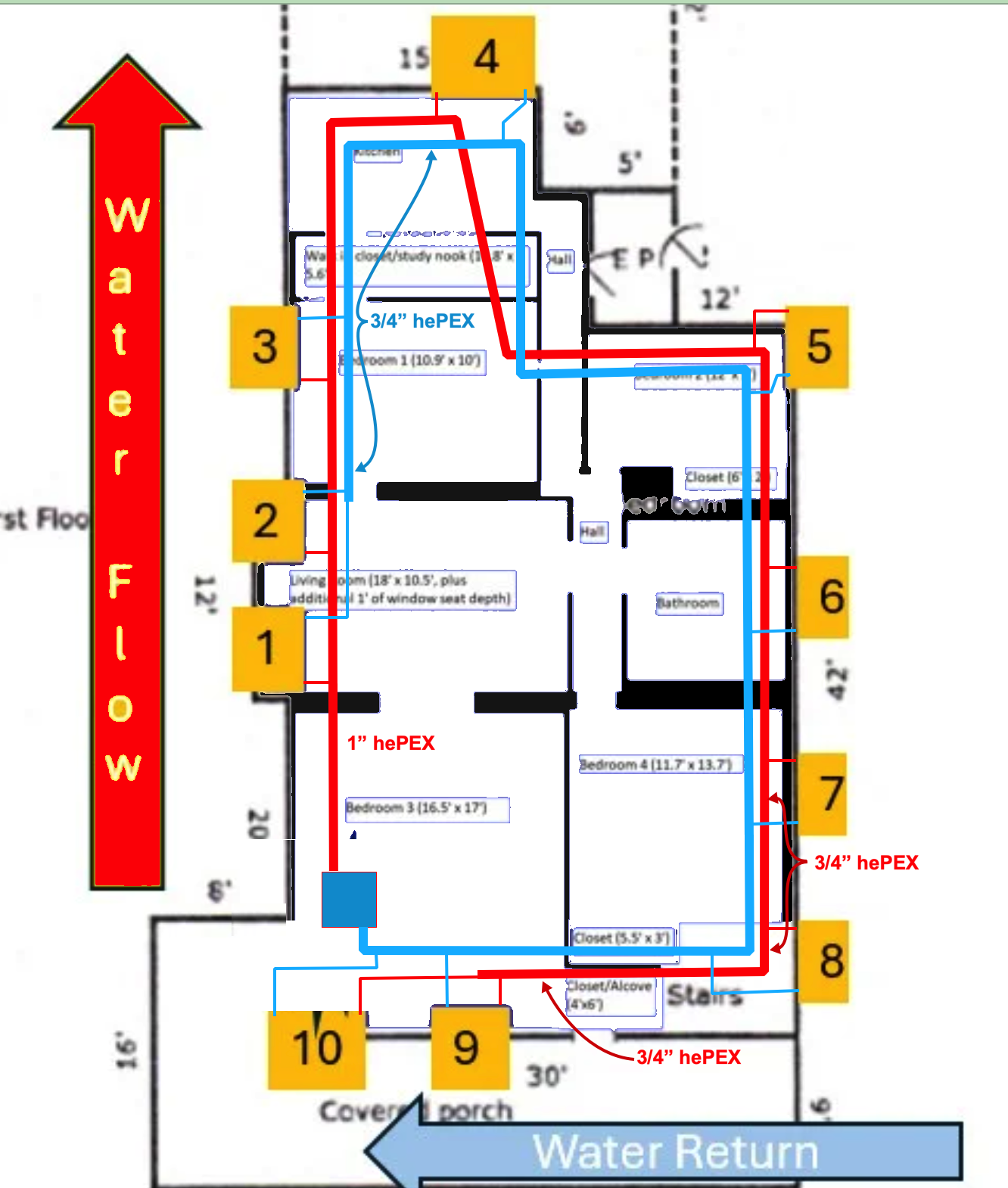

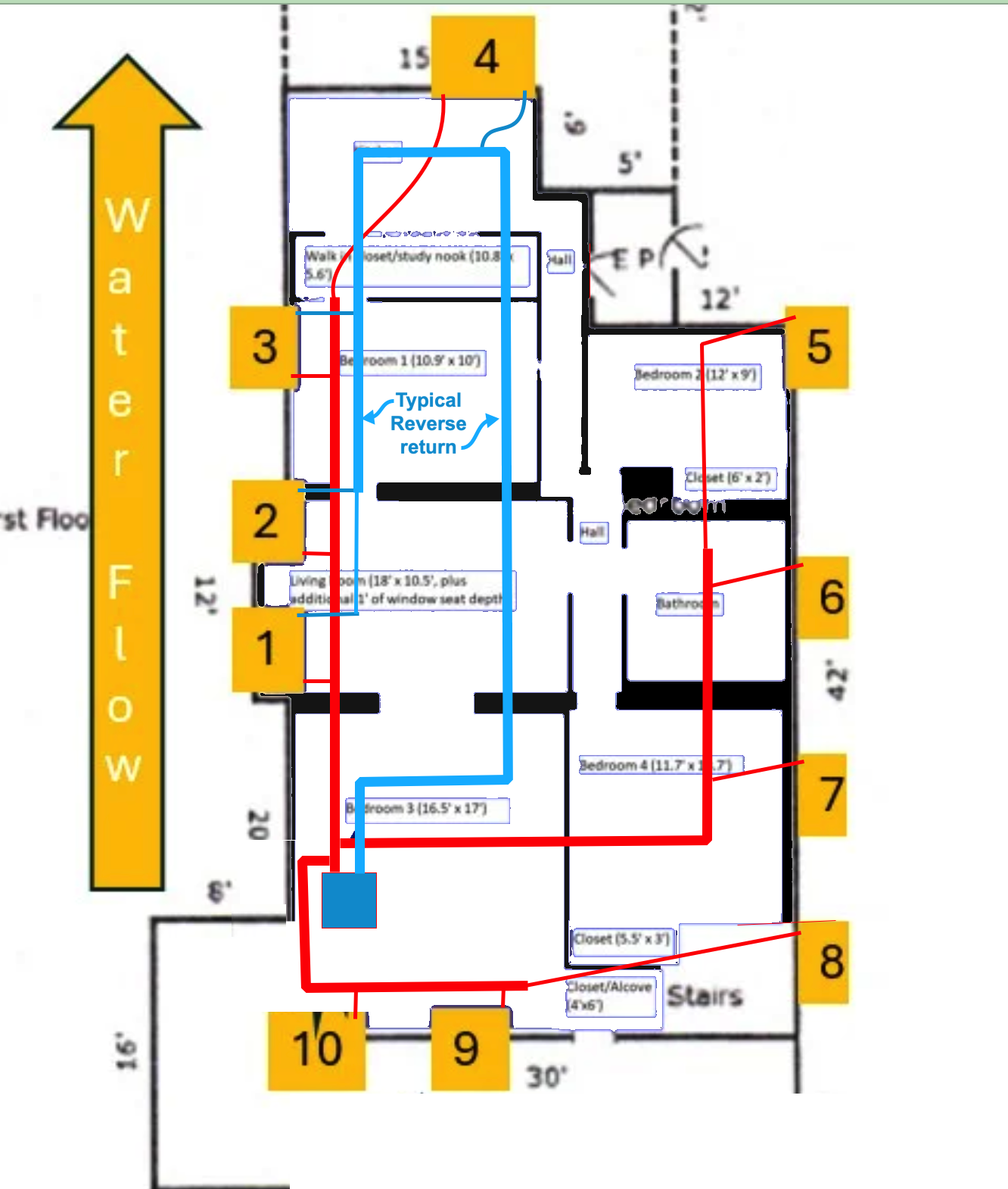

    After @hot_rod mentioned splitting it into 2 series loops, I started thinking of the layout, and for some reason the idea of 2 loops sounds appealing, although I'd still want to do the 2-pipe reverse return on each of them for the individual radiator/room control. If Jamie is saying that there's no harm in doing 2 loops vs. 1 (and potentially even a benefit), I'm now thinking about splitting my current output into a loop that runs from the #1 through #5 radiators on the diagram in my original post, and then a 2nd loop that runs backwards from the #10 to the #6 radiators. Both would be reverse return, and with the flow split between 2 loops, it seems like 3/4" PEX may be sufficient as I could run up to 4gpm through each loop, which is comparable in capacity to the 1" loop @Kaos had suggested for a single loop system, and it fits with @Jamie Hall's point about 3/4" PEX maxxing out at about 40k BTUh, so 2 individual 3/4" loops could handle my Max boiler output of 77 MBH. I'm looking to make it work well, but also get it done quickly, as I have cranky tenants and our temps have been in the single digits the last few nights, so getting it to 80% of optimal is good enough for all of our needs.
    In my own living space, I can see how a manifold/home run system that I can fine tune for my preferences could be a great setup, but I rent mostly to student tenants from the local universities, so in this case I'd prefer to have a setup where they can regulate each radiator individually from their living space. That way, they're not needing to go to the basement to try to adjust the heat delivery for their loop, and if one roommate wants it to be 80f in their room and another likes to optimize their sleep with a 60f room, they can self manage with the valves on each radiator (which has not been possible with the current series loop system).

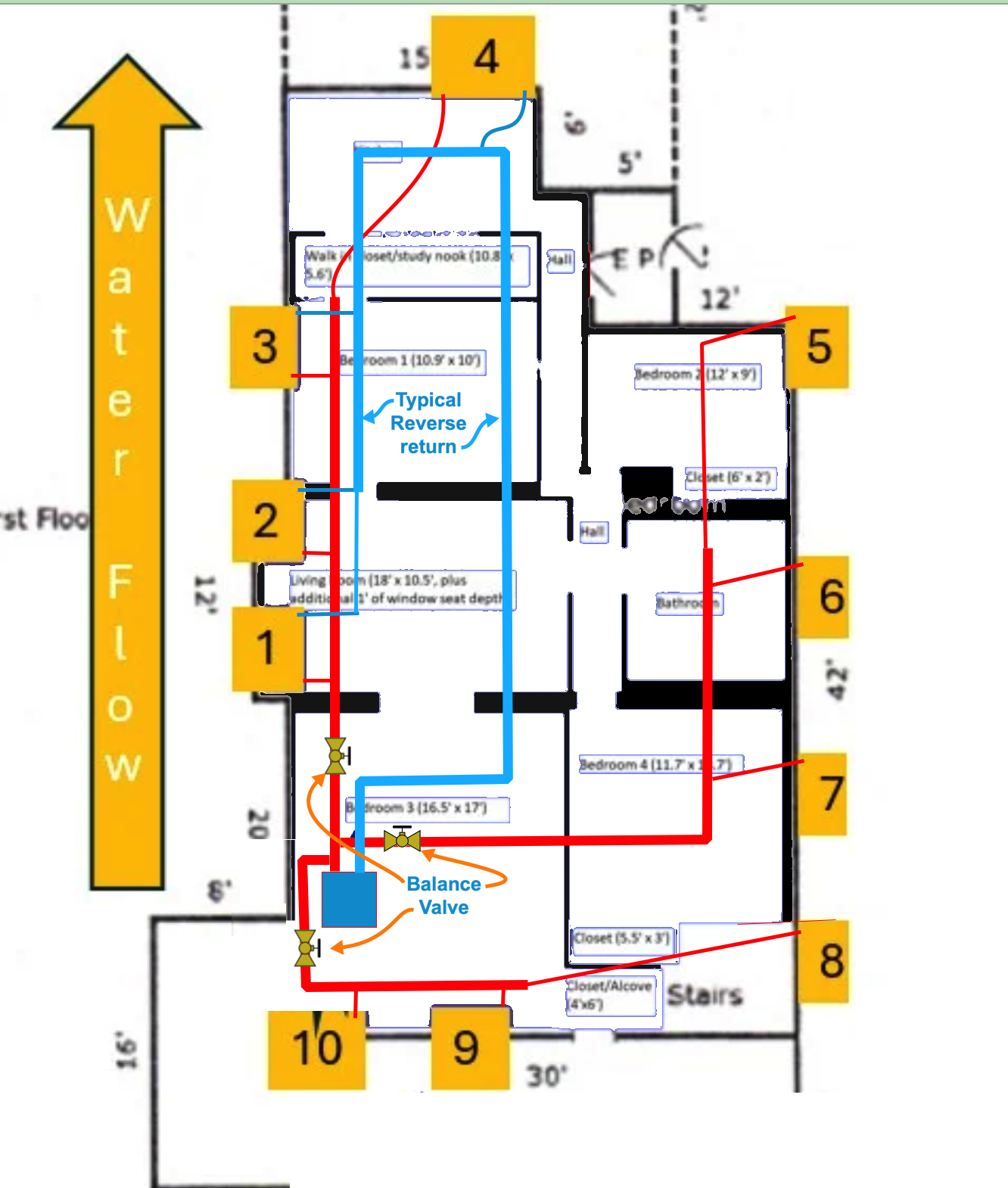

    3 questions for y'all:
    1. Does the above 2 loop 3/4inch 2-pipe per loop reverse return system seem like a "80% of optimal" solution to you?
    2. Should I remove the super small/tight elbow following the flowcheck in the upper right of the following pic when I set up the new system? It seems unnecessarily restrictive. My inclination would be to place the 3/4" wye or tee to split into the 2 loops right after the flowcheck to avoid the bottleneck, and then just flex the PEX to head off in the proper direction, and avoid unnecessary restrictions.
    3. Will the valves in the following pic, that I'd thought were balancing valves, work to modulate heat to the individual rooms? @leonz informed me that they are actually shutoff valves, and so I'm assuming they don't offer the same level of fidelity as proper balancing valves. These valves will go 1/2 turn, lock to lock, so fine tuning is assuredly a bit more difficult but, assuming that they can be set to intermediate points between open and closed, I am having trouble seeing why they can't be used for modulating the heat delivery to individual rooms with the above spec, 2-pipe 2 loop, system.
    Thanks again, everyone, for your contributions. You're really helping me narrow down the myriad options to get to something that will get us not just back in action, but restored to proper function.
    mattmia2 Member Posts: 11,029
    Valves can be used to balance. with the split loop i'd probably do 1.25" copper to the center and 1" copper for each half of the loop. 1" and 3/4" probably can carry more heat than you need but the boiler might cycle more with the smaller piping. if you use pex compare the id to copper, especially in larger sizes you have to use a size or 2 larger to get the same size as copper. 3/4" and 1" fittings are reasonable, 1.25" fittings get expensive in copper so the split loop saves a lot of cost in fittings.

    Jamie Hall Member Posts: 24,988
    The only problem with two series loops rather than individual piping is that while you can control each loop individually, you can't control individual radiators within a loop, since what you do to any one of them affects the flow in all of them. You may well be able to live with that.
    It's quite true that quarter turn valves are usually pretty miserable at balancing flows, but… with patience they can and do work. They're just a good deal more finicky.
    @PC7060 what do you disagree about? 1' is iffy for 70,000 btu/hr but it is fine for 35,000 btu/hr.
    If you split your main in the middle most of your main can be 1", you just need to use 1.25" to the center of the main. Your return mains can be 1" and connect together at the boiler.

  • Ironman
    Ironman Member Posts: 7,569
    Considering all things involved, it’s probably gonna be best to go with a home run system connected to a good manifold with flow setters.
    Make sure that you use O2 barrier pex.
