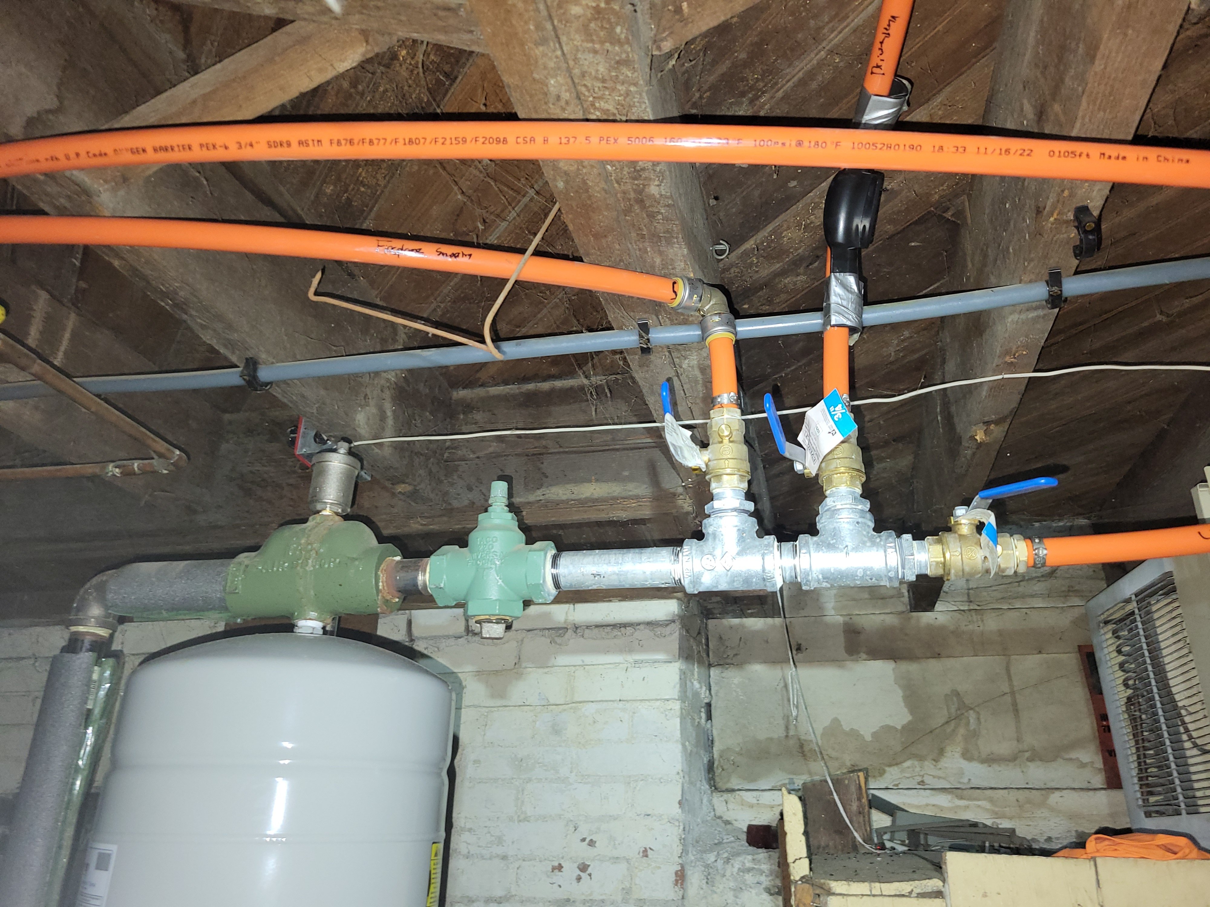

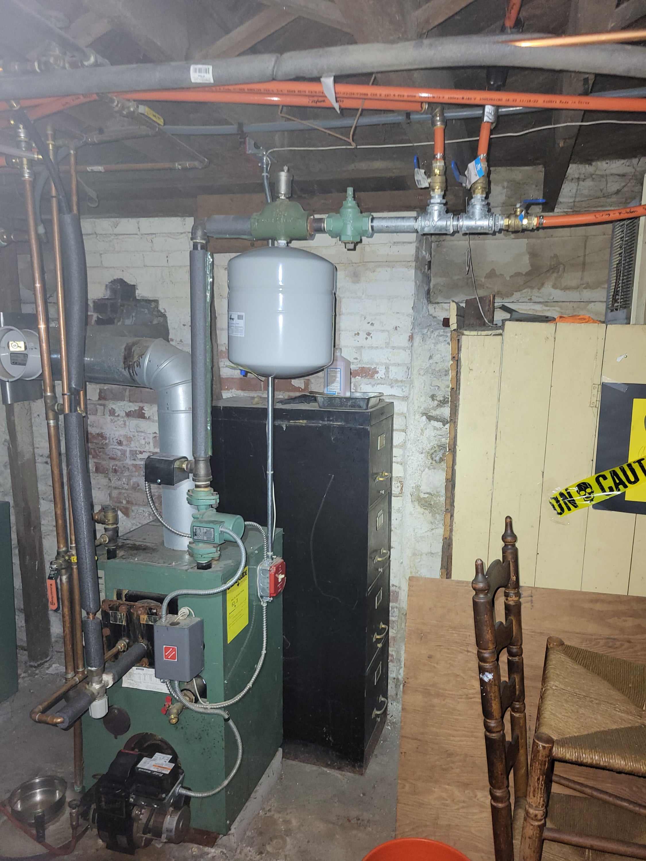

  • Hi guys, I hope you've been having a good Summer (for us Northern Hemisphere folks), and are well prepared for this upcoming Winter.😊
    I'm hoping for a 2nd round of advice and tweaks / modifications I can do, 1yr out from our previous round, to my oil boiler with hot water radiator system in a unit I rent to tenants in my duplex.
    If you need Background: Just to try to refresh everyone's memories and save you digging back into last year's posts earlier in the thread, when I bought the place, it had previously had all the (copper) pipes stolen, and had a single ancient boiler for the duplex. In retrospect, looking at the remnants of various pipes that were left by the thieves, I think it had a Fluidflow system, with a single large diameter (3/4 or 1") copper circuit, and each individual radiator had 1/2" copper running to it, which was controlled by regulator/shutoff valves, which are still located on the outflow of each radiator. Interestingly (to me at least) these valves are opened by turning them COUNTER clockwise! I am sure there is a reason for this, due to the threading and valve type, but I just thought it was funny given how standardized things are now.
    I wanted separate utilities for each unit, so I had a very strongly recommended local plumber install 2 new boilers, and re-pipe it. I clearly failed in my responsibility to educate myself, and talk tech and monitor him, and instead trusted his expertise. He plumbed the 2 new boilers into the old radiators in SERIES, using 5/8" PEX A, with 9 radiators per unit, and said he thought they should "balance out" fine.
    As I'm sure you can imagine, right off the bat, I had issues with heat imbalances along the chain, with some rooms (early in the series) too hot, and some rooms (later in the series) too cold. After struggling with it for years, and with a new round of tenant complaints, this past winter I had separated the heating circuit for that unit into 3 separate circuits for the front/back/side of the house, using readily available fittings and ball valves from Home Depot, and and 3/4" PEX, to improve flow rate.
    Some of you guys said I should really use a manifold system with 1/2" PEX going to each radiator, but I didn't listen, as I couldn't source one locally and I had my handyman booked and available, plus I was concerned about how messy that many home run 1/2" circuits would add up to, if I ended up doing one for the other unit in the duplex too, so I went with what was on hand and seemed like it might work.
    The swap to 3 circuits was certainly an improvement, but was not great, and I was constantly adjusting the ball valves to try to please the student tenant's (in a 4br apartment) requirements.
    Back to the Current problem: Over the Summer, I had shut the boiler off, as they have an electric water heater for domestic hot water, and in the Spring "shoulder season" as some call it, it seemed like the boiler was thermal siphoning, as they were telling me they had the thermostat all the way down, but the radiators were still hot. Now, as we enter a new heating season, I am getting a whole new round of "too hot / too cold" complaints from the girls, on all 3 heating circuits. They're telling me "thermostat is at 55f, but my radiator is burning hot". My suspicion is that that with the current plumbing arrangement, and 3 relatively free flowing circuits, the boiler, which stays hot and ready, is constantly flowing hot water to the earlier radiators in each circuit due to thermal siphoning, regardless of if the thermostat is calling for it and circulator is running, and since the boiler is configured to maintain a given temp, the return flow from the thermal siphoning creates a vicious cycle, even if it is 70f in the house and outside, and the thermostat is at 55f. My constant adjusting of the ball valves on the 3 circuits can help get the 3 circuits balanced if the temp is consistently 25f outside, and genuine BTUs are needed 24/7, but in Spring/Fall where heating needs are intermittent, it seems like there isn't a fix without stopping the (presumed) siphoning, and making the BTU input to the system tied to what the thermostat is actually calling for.
    My question for you learned experts is, can I easily stop this thermal siphoning, while maintaining the current configuration more or less? I know I probably should have gone manifold last year, but I am struggling to understand how that would fix the problem, as it still seems like I'd get thermal siphoning in the manifold too. Will something as simple as a dip or a loop in the pipes to create some sort of thermal lock? If not, how is thermal siphoning not plaguing every system?
    I'm attaching pics of the DIY "manifold" we rigged up, as well as an overall pic of the boiler setup. I realized I probably should have taken a detailed pic of the return lines, but you can kind of make them out in the upper left of the 2nd pic with the "big picture" showing the whole boiler.
    edited November 2025
    why is the boiler set up as warm start?
    i see a tankless coil in the boiler, is that being used?
    is it one zone divided in to 3 loops? if so, is that flow check closed? there is a knob o manually open it when servicing the system, did you close it after you were done?

    @mattmia2: I've pasted your very excellent questions below in italics, and my answers follow each one.
    These questions seem related, so I'll answer them as 1. It was set up this way from the original installation, due to it being configured for a tankless water heater. We have city water that comes from a surface source, and in the Winter the tankless system has proven to be insufficient when the supply temps drop by about 30f+, so the domestic hot water temp fluctuates in the shower as the boiler cycles on/off, dropping to a very unpleasant lukewarm before heating up again. As a result of tenant complaints, I installed a standalone electric water heater for that unit last year, but the system is still has the plumbing to run the tankless coil. Since installing the electric water heater, I have shut the boiler off in the summers, and generally kept the shutoff valve for the tankless coil in the closed position, but if I were to have it open, it seems that the domestic hot water will be drawn via a combo of the water heater and the coil on the boiler.
    is it one zone divided in to 3 loops? Yes, it is 1 zone, and since installing the additional piping to separate the single loop into 3 zones, I've been hoping that I can use the individual valves for each loop to achieve a sort of balance that will keep the 1600sqft 7 room apartment more or less evenly heated. I think last Winter, when it was consistently cold and heat needs were more or less constant, and after many repeated adjustments to the valves, we got to a decent balance, but in the Spring/Fall conditions it seems to frequently be delivering heat at inappropriate times, even with the thermostat turned all the way down, which is what prompted my questions about thermal siphoning/gravity feeding, even if the circulator is off.
    This seems like a pair of facepalms😯. First of all, thank you for pointing this potential Flo-Check issue out! I think I've fundamentally misunderstood the purpose of the Flo-Check. I'd thought it was intended to prevent backflow, in a similar manner to the very loosely sprung/free moving check valves with rubber flappers that I've used to prevent backflow from sprinklers into domestic potable water, or in aquarium settings. I didn't realize, or had forgotten, that its primary purpose was to prevent thermosiphoning/gravity driven flow in the forward direction. So, just to make sure I understand the structure of the Flo-Check, it seems like the valve must have some sort of spring in it, that is calibrated such that when preloaded by the knurled knob, the force to open it exceeds the expected pressure differentials that could be achieved by thermosiphoning, but is well under the pressure differentials generated by the circulator pump. Is that correct?
    Based on the PDF in the final post from the TACO rep in this thread (https://forum.heatinghelp.com/discussion/155723/taco-flow-check), you are100% correct that the knurled Flo-Check valve was in the fixed "open" position, as I just checked and the knob and stem were in the fully counterclockwise/many stem threads showing position. In my defense, the Flo-Check operation instructions are surprisingly hard to come by and even in the previously linked thread there are posters with diametrically opposed suggestions as to what position is fully open, and what position is "normal/active". I just turned that Flo-Check fully clockwise/fully threaded in/no threads showing, and will be thrilled if that fixes the delivering heat on warm days (with thermostat all the way down) problem. 🙏

    supplyhouse.com has the instructions for the flo check on the page for that product
    https://www.supplyhouse.com/Taco-220-6-1-Universal-CI-Taco-Flo-Chek
    looks like there is a small packing nut and a bigger cap that was used to assemble the valve. some designs use a spring and others just use a weighted gate. the stem lifts the gate when it is in the manual open position.
    if you are not using the tankless you can turn the low limit all the way down on the aquastat and it will be cold start, it will only fire when the thermostat calls for heat. it only needs to be kept warm if you are using the tankless coil. it will save a fair bit of fuel running it cold start.
    The Thumb knob (yellow arrow) should be in the Automatic position to prevent thermosyphoning (gravity flow) I believe that is turning it clockwise until you can no longer see the threads.
    The Taco Submittal is vague on the subject but the B&G flow check operates the same way with a weighted stopper. Here is the information on the way a Flow Check operates
