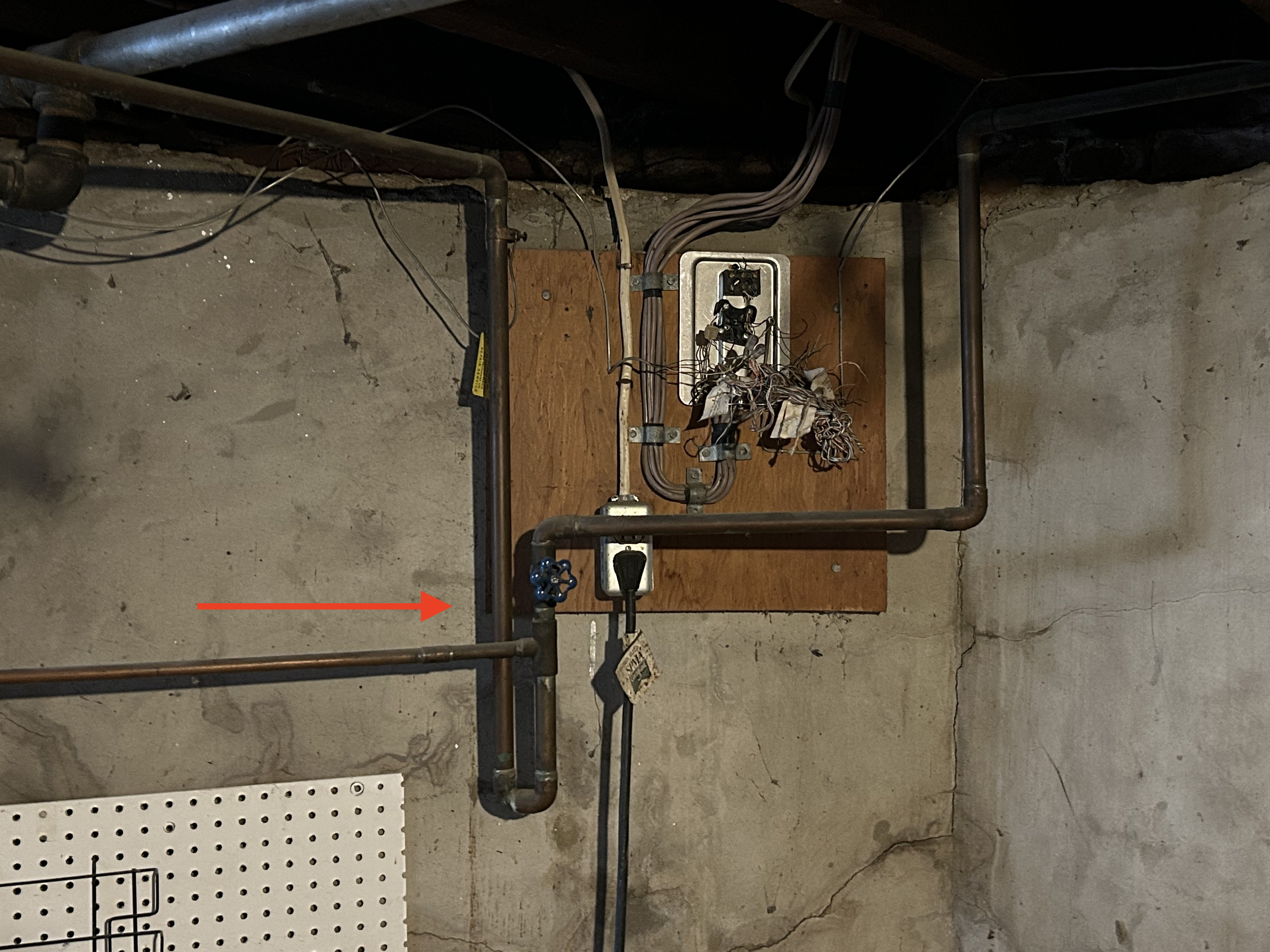

Installing boiler on other side of basement. Is it OK to relocate the copper piping? I'm assuming this is some type of backflow prevention? Plumbed like the service line, but it's actually the 2nd valve.
    Jamie Hall Member Posts: 27,504
    OMG. Who was the rocket scientist who put a pipe — grounded, no less — over a live electrical socket?
    I have no idea why the loop is there in the piping. Whimsy. It's not doing anything as far as backflow or any other kind of protection might be wanted.
    Not only do you need to relocate that pipe, you need to shut off power to that socket until the piping is corrected.
    Now there is a joker in the deck: higher up on the pipe, just even with the top of the plywood holding that rat's nest of wires, there is a ground clamp and ground wire. It is possible (though I do hope not) that that may be your main ground connection. If so, you also need to establish a to code house main ground before you do anything to that pipe, and to do that you will need to disconnect your entire house power from the grid (at the meter or at the main shutoff breaker) until you get a proper ground established

    Or, put in your stake, connect new ground in parallel to the old one and remove the old ground. 😉
    No lifted ground/ grid disconnect required.

    Seriously, is that 3/4" piping with a 1/2" tee going to a stop and waste valve all closes system piping? it looks more to e like the cold water line to the home (judging by the color of the copper). Heating pipes don't seem to get that dark color the way cold water pipes do. Unless they are really old.
    Anyway, there is no need for a heating pipe to be installed in that up over down piping design. So move those pipes as needed. But take care about the ground wire. In times gone by, when there were copper water service lines from the municipal water system, lots of folks used them for the electrical ground. If that is your only electrical ground, I would be SHOCKED if it were removed in some SHORT way before you were GROUNDED properly.

    Oh, and having a valve between the ground and the supply pipe coming out of the floor is a no-no.
    hot_rod Member Posts: 27,697
    if that is the cold water supply, it looks like a water softener loop

    Thanks, folks. Love this board. The ground is for Ma Bell, long deceased. I have a new 200A service WITH a ground (there was none before)—that was the 1st mechanical improvement. Take it from me, Joe Homeowner should not trench 350' and do his own conduit. Long story, but got it done and I was so proud of myself. Until the power company pointed out that I had inadvertently glued in the pull tape. Then they showed me a neat trick with a plastic bag and a shop vac to pull a new one. So much learning.
    Anyway, Ed, that is the water supply, not heating. No water softener. At least not since I've been here.

    That ground clamp isn't a type that is listed for a grounding electrode system, it is probably for the protector for that phone network interface. if you remove the copper pipe and replace it with nonmetalic you need to connect a bonding wire to the grounding electrode system of the service and and of the things that are bonded to the copper pipe. If the phone drop is still there you need to keep it bonded.
    It looks like they had a lot of phone outlets or maybe even a pbx or something but it looks like it was all neat until someone that didn't care got to it.
    Was there laundry equipment at that location at some point or something? That is how you make an expansion joint but it doesn't look like the pipe is constrained there. Maybe something was removed there but that pipe doesn't really look reworked.
