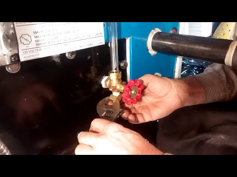

In a pinch you can try skimming from the top of the top port of the sight glass but it's less effective than a proper skim port. You would need to remove the plug at the bottom of the sight glass.
https://www.youtube.com/watch?v=lO2oR9JhF0M
This one shows installing a blowdown on the bottom tapping:https://www.youtube.com/watch?v=_z8v1YOQcM4&t=215s

You would shut the bottom valve on the sight glass, keep the top valve open, turn off the auto feed and remove the 1/4" plug from bottom of the lower sight glass. Then feed very slowly using manual feed valve. Water will stream down once it gets to the level of the top sight glass tapping.
Check out the two videos, they show it pretty well. I did this when i didn't have a working skim port and it worked OK.1 -

Hard to say when you've skimmed enough, give it an hour or two skimming very slowly - a stream no thicker than a pencil - then put it all back as it was and run it to boiling to drive out the oxygen in all that new water, and make some steam if you need heat
You can come back and do it again at a later time, usually you need to do it more than once.1 -
Thank you! This is going to be hard to pull off given the geometry, you can see how the sight glass is perfectly aligned with the drain valve so getting a bucket in there is challenging. Clearly I should do the blowdown thing eventually, but there's no way my local hardware store has those fittings.
I assume I should do this with the boiler cooled down to avoid thermal shock from all that new water?0 -
You can wait till it's not been running for a while, IDK how much risk there is from thermal shock since you're gonna be sending in a very small volume of water.
You may be able to find a 1/4" street 45 and 1/4" valve of some kind locally. If not you can always order them. I used a brass bar stock street 45 and one of these so I can put a hose on it and put the bucket wherever:
