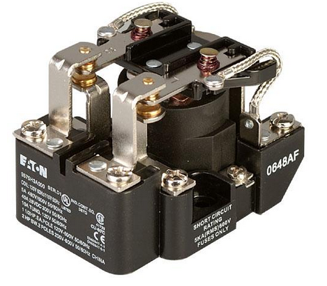

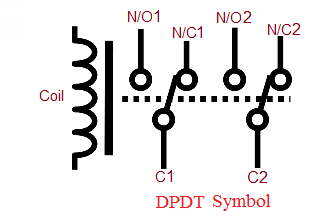

  • NY_Rob
    NY_Rob Member Posts: 1,370
    nibs said:
    Run the grid power through a normal closed relay, and the inverter through a normal open relay, when the grid shuts down the closed relay opens and the open relay closes turning on the inverter.
    Should be inexpensive and simple to wire.
    Or just use one DPDT relay... the grid would go to the NO contacts, the inverter goes to the NC contacts.
    Grid power energizes the pull-in coil which lets current flow from the NO contacts to the common contacts. Grid goes down, relay opens routing current from the inverter NC contacts to the common terminals.
    Jamie Hall Member Posts: 26,148
    A word of caution: either relay solution must -- repeat MUST -- be set up as a break before make device. This does two things. A minor (?) one is that it prevents your device from electrocuting the person trying to repair the power line. A more significant one is that it prevents a potential very high current out of phase connection, which would blow your inverter or whatever to kingdom come.

  • NY_Rob
    ^ the nice thing is with a DPDT relay it would be pretty much impossible to feed the inverter output back into the grid. By design only one set of contacts can be closed at any time.
    I use a 50 amp DPDT relay to charge my Chevy Bolt (Electric Vehicle) it will easily handle the 32amp draw from the Bolt all day long if needed.
