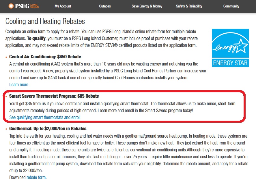

    IDK if you're referring to this particular case, but utilities supplying "rebate/free/discounted" t-stats that they have the "right to control" is becoming more and more common.
    Here's the offer from our power supplier (PSEG LI) on Long Island:
    https://www.psegliny.com/saveenergyandmoney/energystarrebates
    The text is small in the screen cap but it states:
    "Smart Savers Thermostat Program: $85 Rebate
    You'll get $85 from us if you have central air and install a qualifying smart thermostat. The thermostat allows us to make minor, short-term adjustments remotely during periods of high demand. Learn more and enroll in the Smart Savers program today!
    See qualifying smart thermostats and enroll
