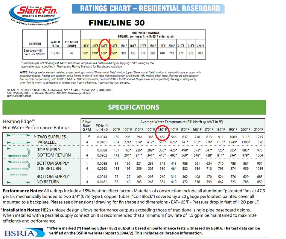

    The heating edge baseboard is quite pricey, more than 2x the cost per foot than the higher output versions of the more standard baseboard manufacturer offerings.
    I looked at the heating edge baseboard when I designed my system (see link in sig), but the higher output did not make up the higher cost vs. using longer runs of more traditional baseboard (not including labor costs for installation) .

  • NY_Rob
    NY_Rob Member Posts: 1,370
    I made this comparison chart when planning my HE2 emitter upgrade. In some rooms there was just no way to add additional std fin-tube to make up for the btu output loss going from 170F AWT to 130F AWT so I had to go with the $$$ HE2 baseboard.
  • Brewbeer
    Brewbeer Member Posts: 616
    edited November 2018
    The Slant Fin 30 is pretty underwhelming in output. I used Sterling's Heat Trim Plus line, the output is 20% less than the HE2 per foot, but costs 60% less per foot (again, not including installation costs).

    I designed my system around a 130 F SWT at the design day (0 F).
    Hydronics inspired homeowner with self-designed high efficiency low temperature baseboard system and professionally installed mod-con boiler with indirect DHW. My system design thread: http://forum.heatinghelp.com/discussion/154385

    ^ is your design based on HE2 or conventional fin-tube?
