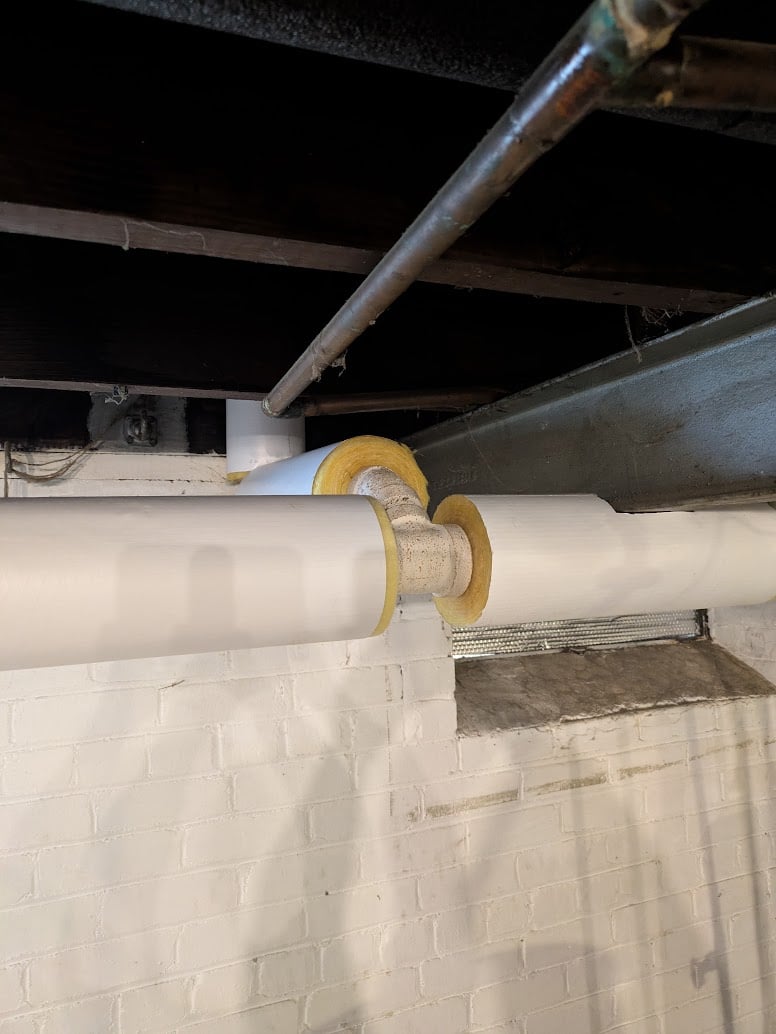

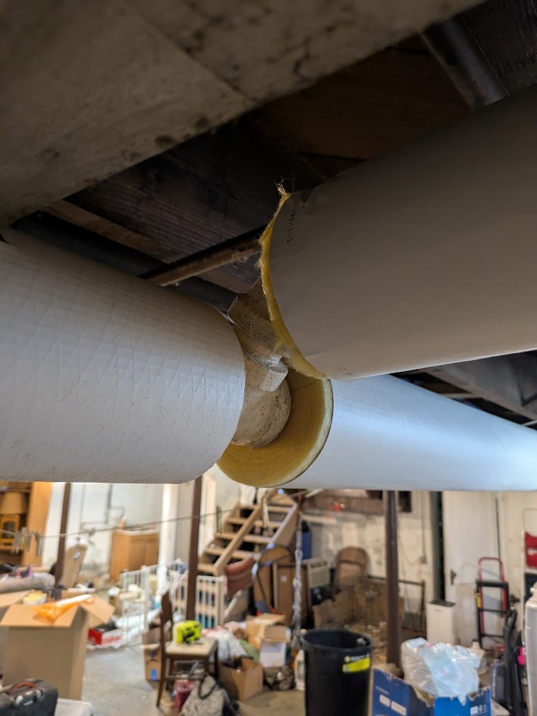

I'm currently insulating all my steam pipes with 1.5" thick fiberglass. I have PVC jackets for all my 45s and Tees. I know how to install them individually, but I'm not sure what the best practice is for insulating a Tee that's immediately attached to a 45. I have this configuration at nearly every riser.

    You probably can't get it perfect as the covers are large and you have some short nipples. Yo may have to experiment with the covers and cut them down with scissors. They should have given you insulation to fit inside the covers. If they didn't you can just get some fiberglass insulation at the big box and stuff it in there.
    You can put the insulation on the pipe and hold it in place with any kind of tape (electrical tape) to hold it in place while you work with the covers.
    For the cover don't use tape it looks like crap. They make white thumbtacks with barbs. get them where you bought the insulation. The trick is to put the thumbtacks through the first layer of pvc before you try putting the covers on.

    Don’t sweat it, there’s no harm from an exposed tee

    Trimming the plastic like @EBEBRATT-Ed said will be about the best-looking, but it takes some doing to get it looking good. You can also cut the itchy in, the pros use a fillet knife, but you'll end up with sharpish corners (might not be an issue with a 45°). Seal it with white mastic that you can get with the insulation pieces and it looks pretty good; but if you use the plastic covers everywhere else it may stand out a little.
    And of course @ethicalpaul is right, the heat that will leak from those exposed fittings is negligible. Covering them is either a contractual obligation or an aesthetic decision.

    I agree a few exposed fittings isn't a big deal but the OP already bought the PVC cover so I just explained my method.
