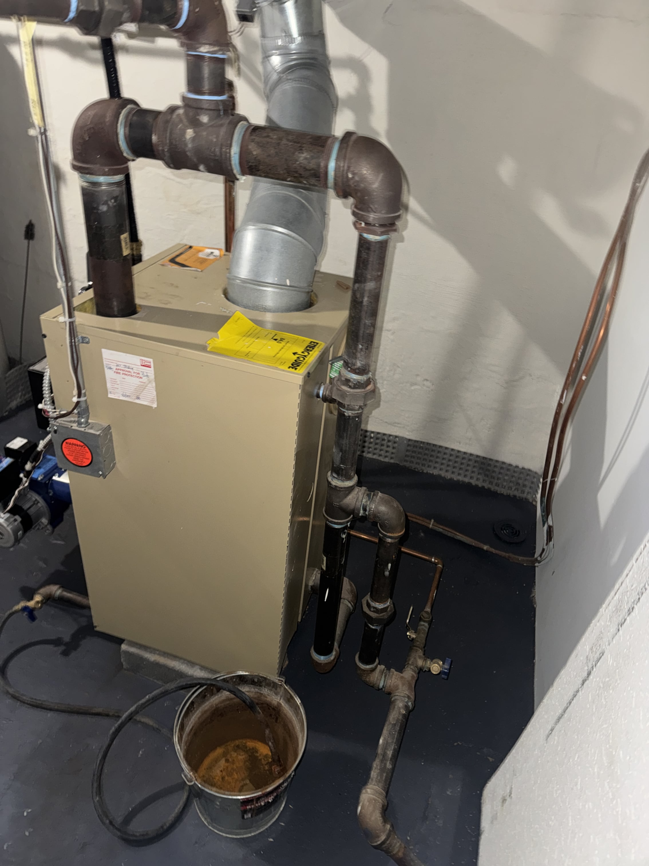

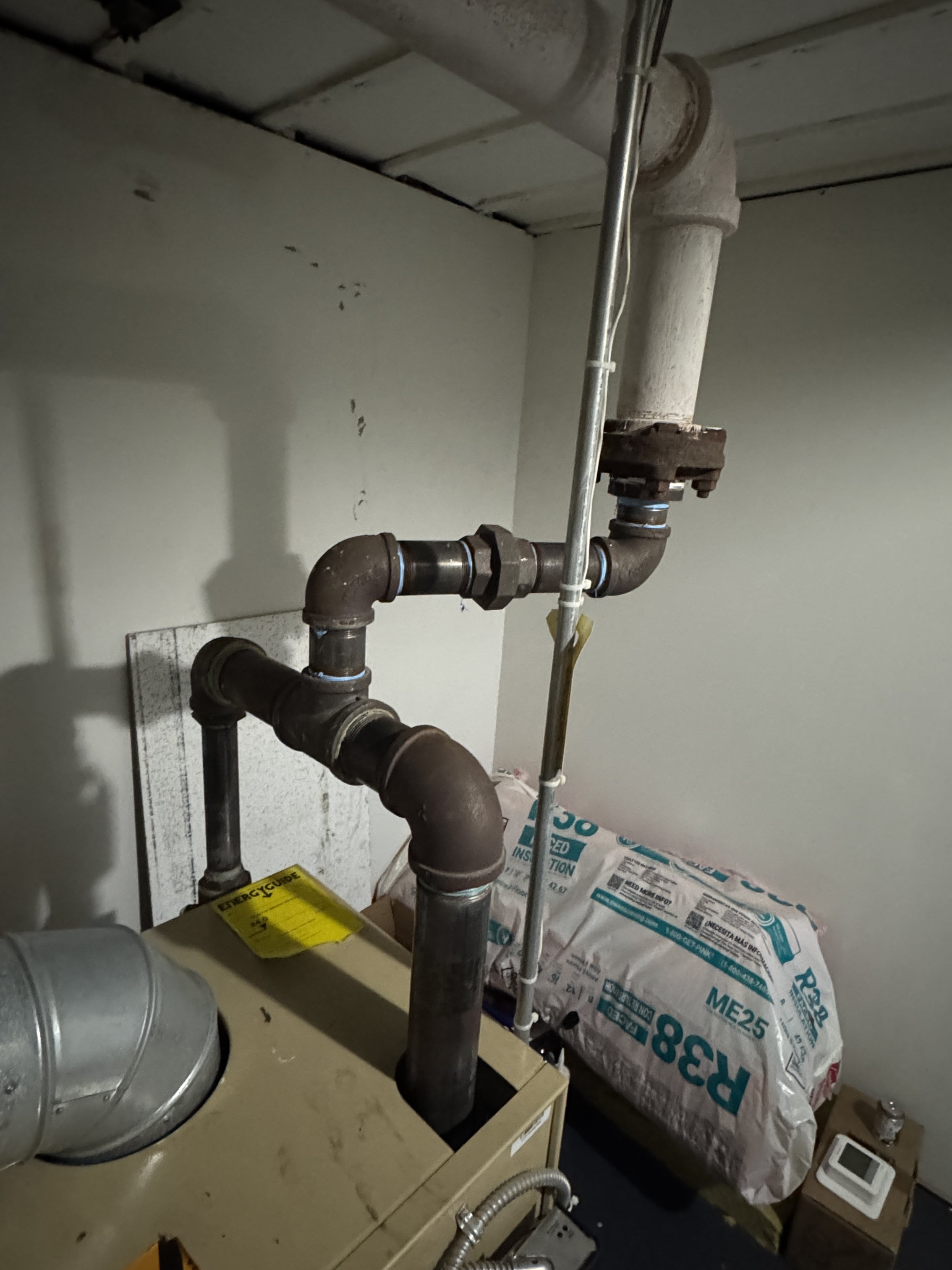

Is this header piping ok?
I think my header piping is incorrect.
For starters, the height from waterline to bottom of first horizontal section is only 20 in.
The first riser and header are 2.5 in pipe, then reduced to 2 in through the tee, followed by the coupling to original 3 in header from the old boiler. The equalizer is 1.5 in.
Boiler is a Weil-Mclain SGO-4, installed by previous owner in 2020.
Any thoughts?

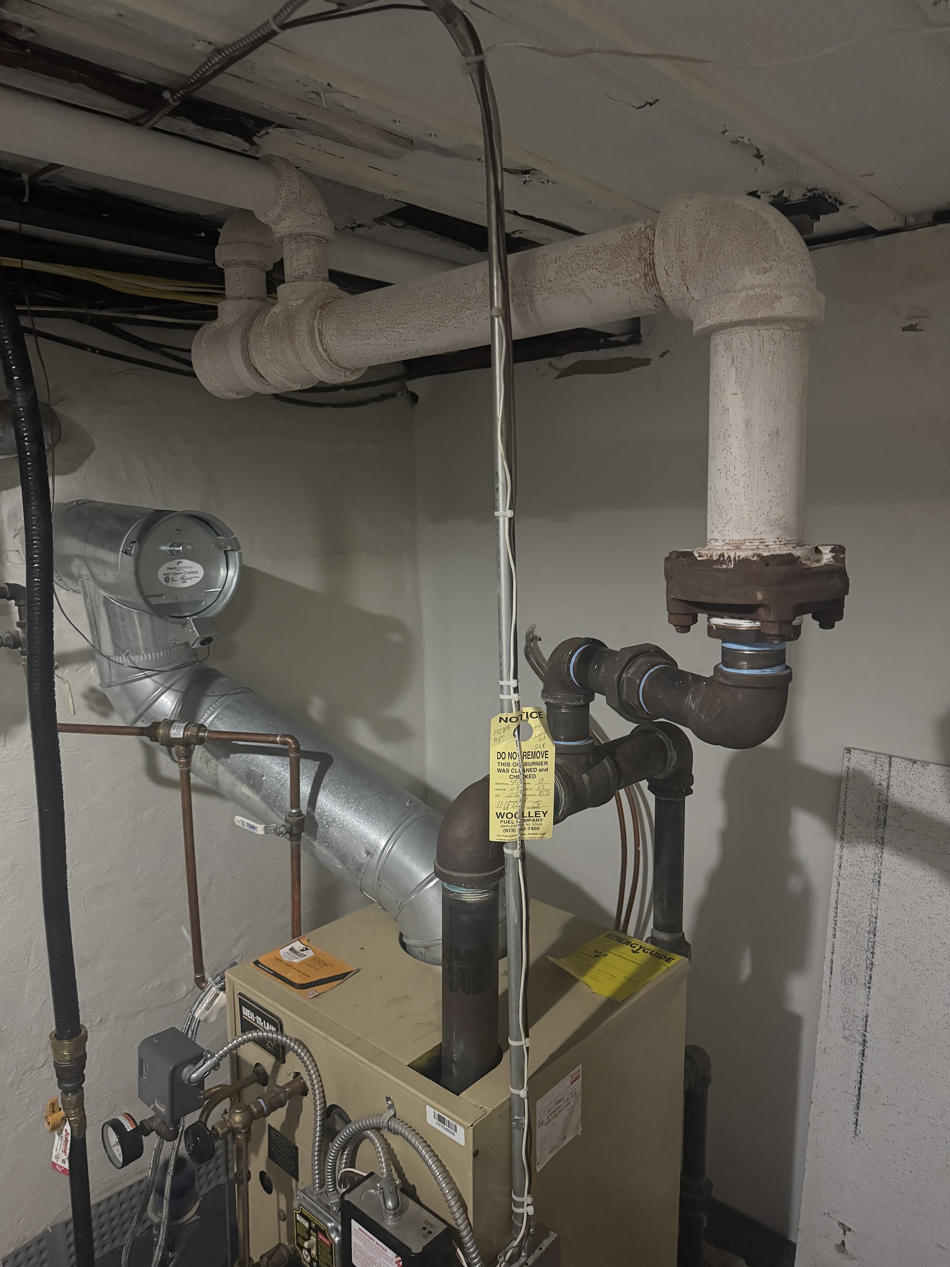

    we need to see the other side
    mattmia2 Posts: 18,478
    the header from the old boiler is still there
  • Here’s a picture of the backside. Looks like the wet return connection into equalizer is just below the water line.
    Mattmia2, you’re saying that the top 3” horizontal pipe is what counts as my header? That’s what I need minimum 24 in distance from the water line?

    Does not look great. They should have separated those two inch mains, and ran them individually into a new header. Seems like the old header was left in place. Even if it is pitched back towards the new header, there might be excess water over there. And can't really tell pictures of any of those horizontal pipes. Not so thrilled with that 2" horizontal pipe coming off the header. The main question is. Is it working properly. Or relatively well. If yes, then might not be worthwhile doing anything

    Leave it alone. Its not text book but the new header and equalizer are correct. The 2" out of the tee should have been 2 1/2 or 3" but its such a short run it will be fine.
    If you not getting any knocking or banging leave it as is not worth changing. If it was knocking or banging you would know by now.
    The barometric damper is in the wrong location however.

    I agree. Any condensate up there will get re-evaporated or it will just sit there harmlessly until it eventually runs back. If you are very nervous about it you could insulate those pipes which would reduce it, but I can tell you from first hand observation of condensate behavior that you are OK.
    And don't worry about the 20" vs 24"— that is not going to be an issue at all.

    @ethicalpaul and if it did hammer in the riser to the horizontal main (I would think he would have herd that by now) you could take the tee off the bottom of the riser and drip it 3/4 pipe back into the return or boiler.

    I would have not bothered to build a new header, just connect the boiler's supply to where the old boiler supply was connected and connect the equalizer pipe to the other end of the old header past where the mains are connected. It would have been a better Header than the new header that is there now.
    At this point if is is not causing problems leave it alone.
