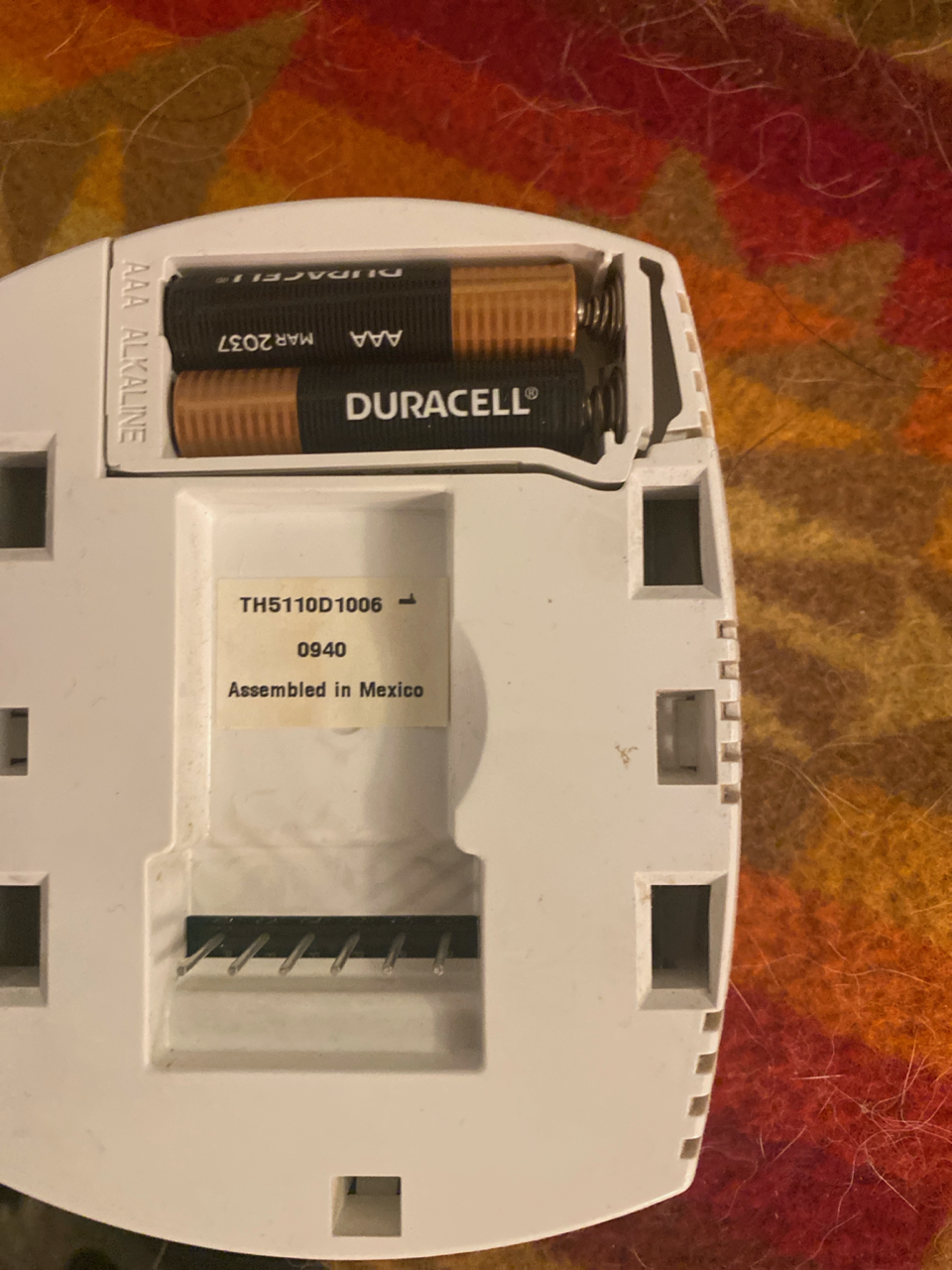

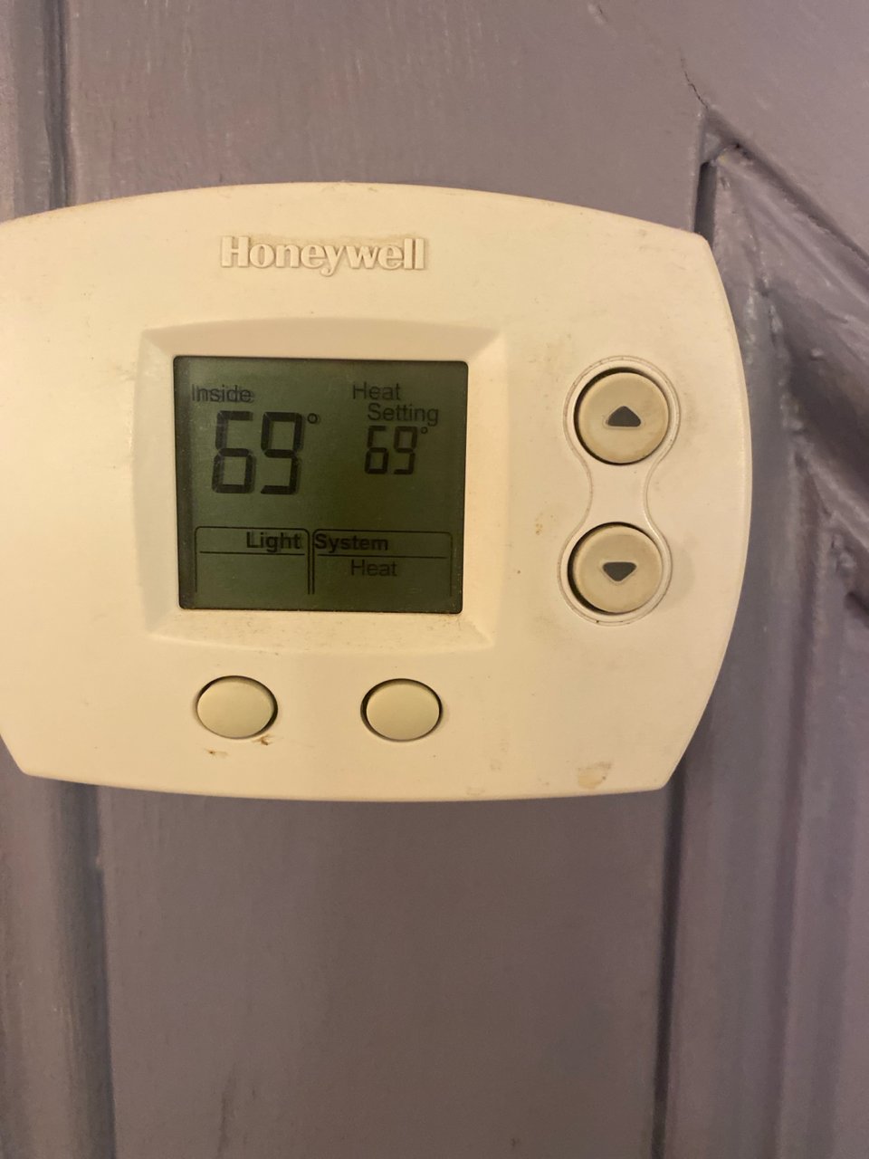

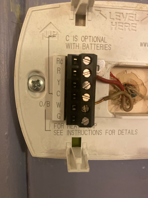

I'd like to replace my old Honeywell TH5110D1006 for one that is programmable. Attached pics show the old Honeywell.
E5BEA38A-1A1A-43DD-8E13-073C7CF5BC58.PNG 60CA624D-0904-40D5-B48D-3DFB218D4686.PNG 986223BE-D318-4EFB-B5D4-A900C993A853.PNG
System is a 30's Arco model K vapor system that is running well.
Recommendations?

    As a matter of course I've always taken the temp down about 10 degrees at about 10:00pm and then bring it back to normal house temp around 7:00 am. But the comment about fuel saving has me thinking. Am I in fact saving fuel? Considering that I'm using all that energy to heat the house up each morning?

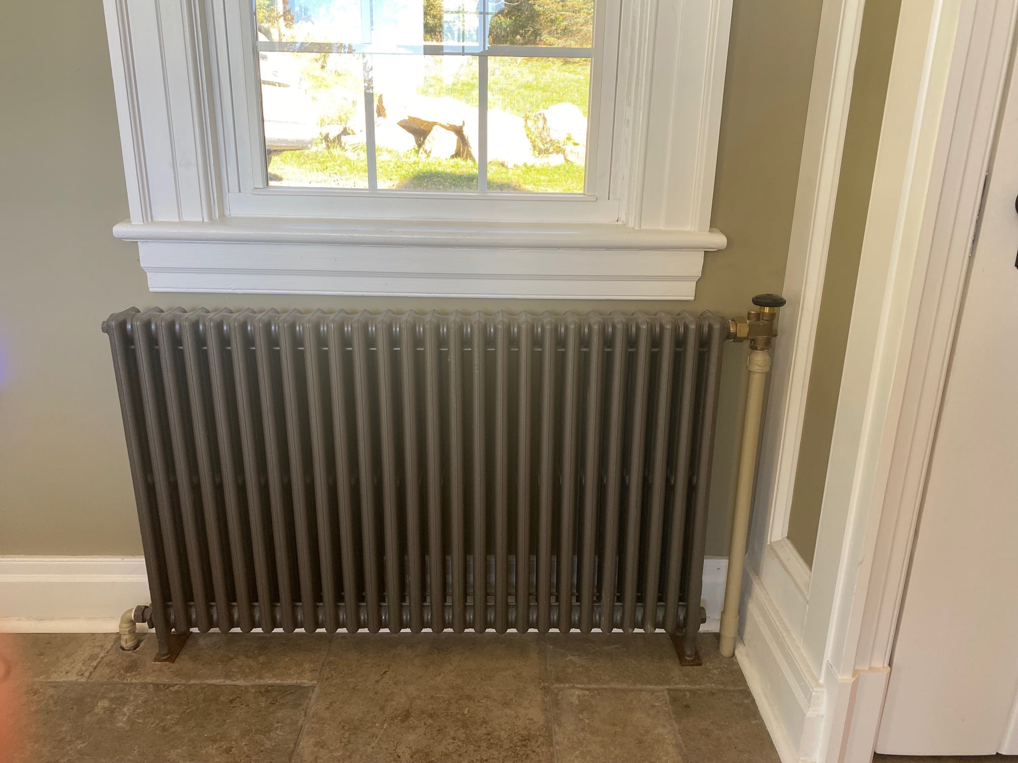

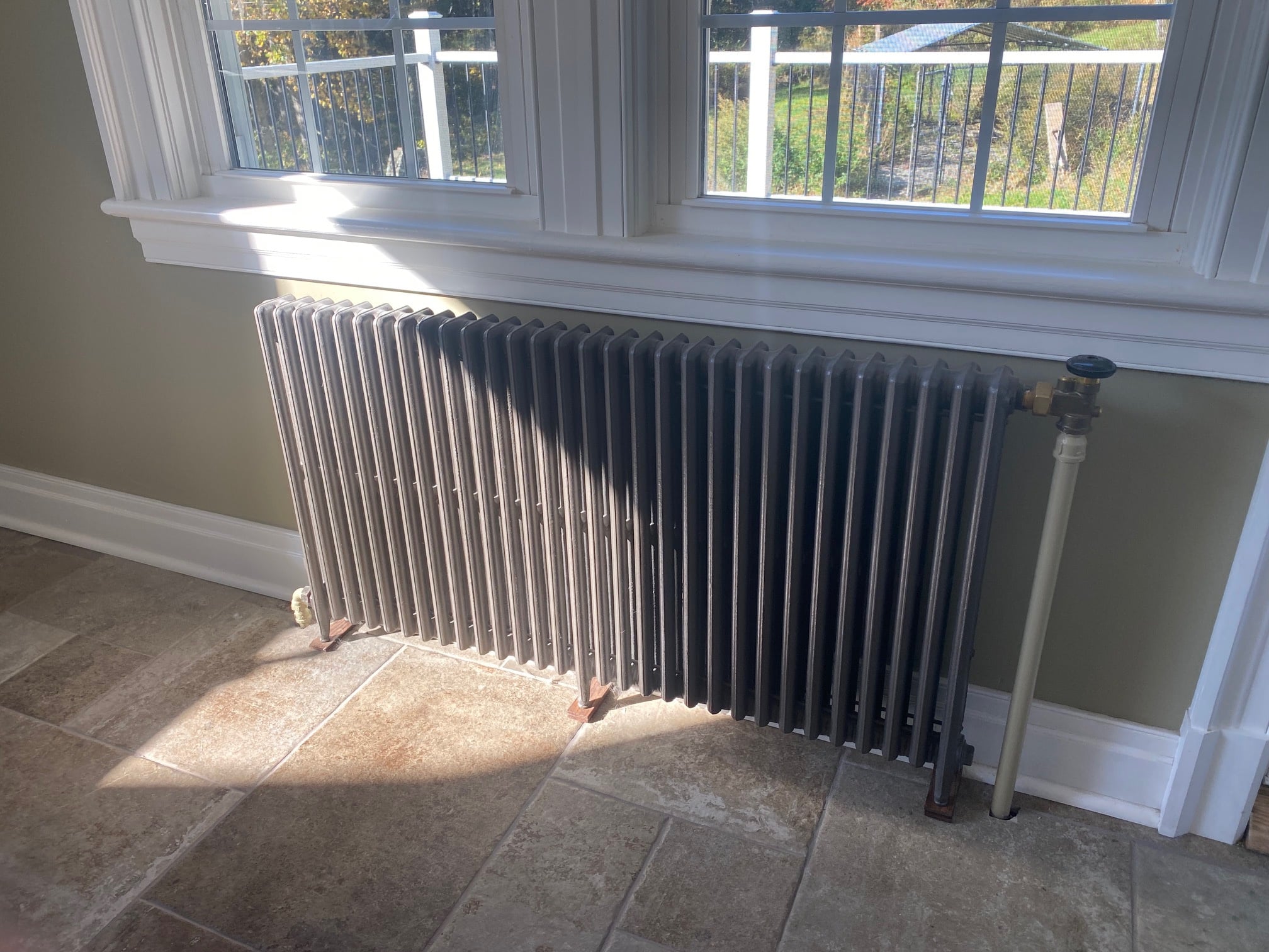

    p.s. re: my post last year about radiators not heating fully. we cleaned the boiler a few months ago. what a difference! still cannot believe how well this 65 yo commercial weil-mclain works…and love these new valves (Mepco SWRF-B) which I install everytime I pull a radiator out to work on this old house..
    These are now warm at the return.

    I don't think you can get a "C" wire from an oil primary unless I am old and out to lunch.

    Another question: I am running 30.15 volts control voltage. Pretty sure my old t-stat is ok between 24-30v, but don't know if a newer t-stat will be happy with that voltage..
    Jamie Hall Posts: 27,919
    That voltage shouldn't be a problem. And that voltage is probably with the transformer unloaded — it may drop when any load is put on it.
