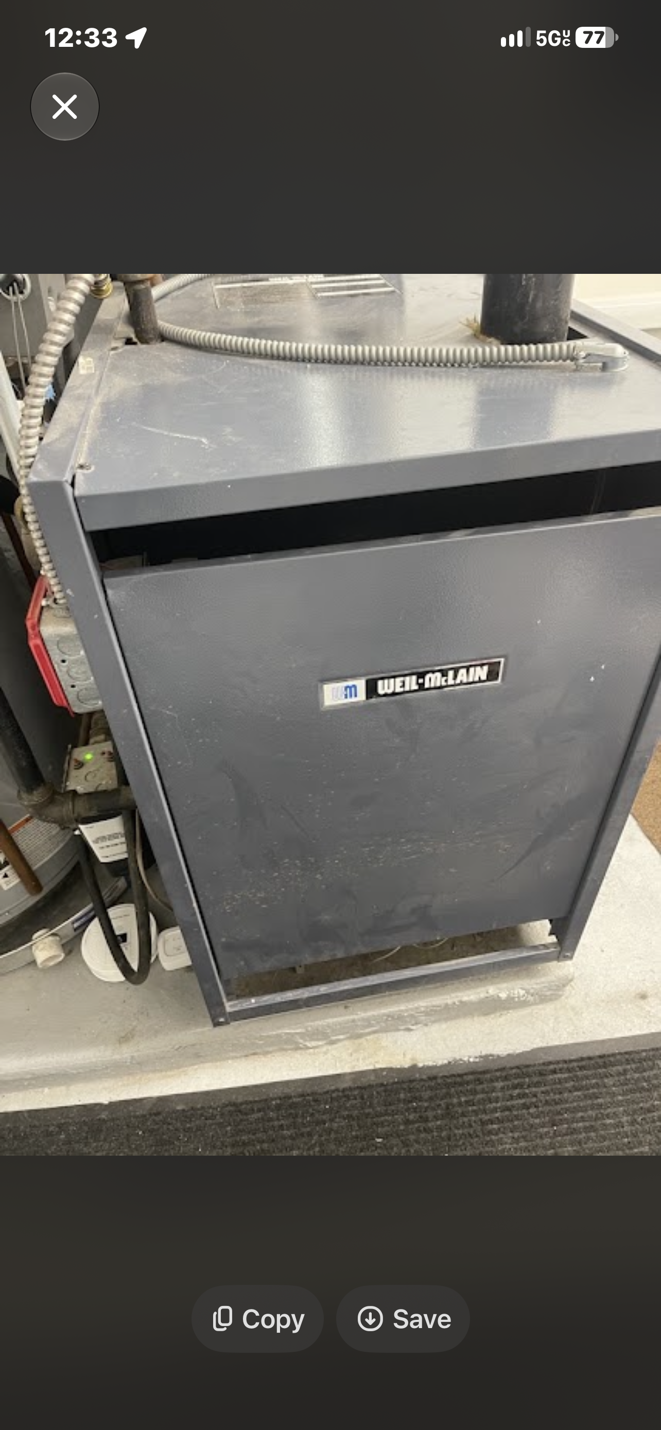

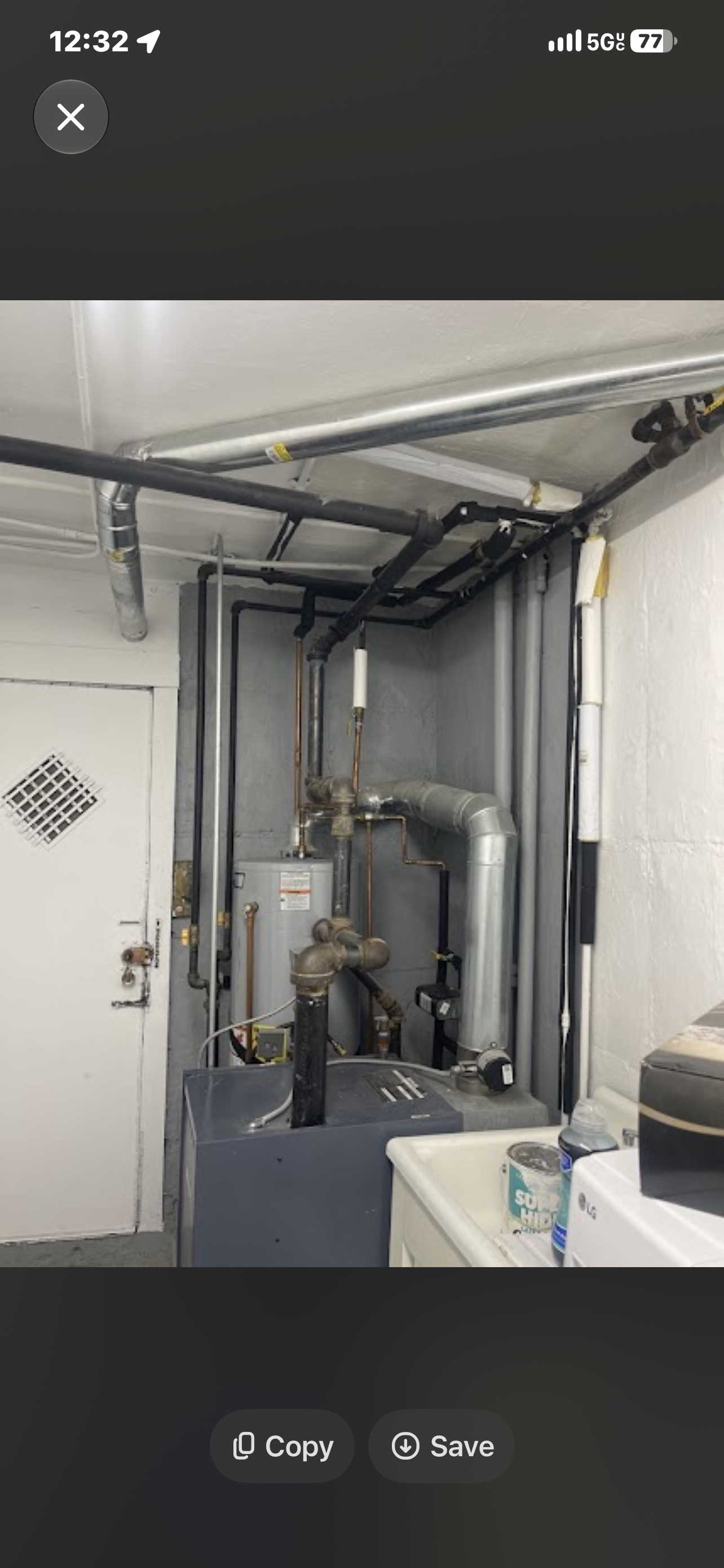

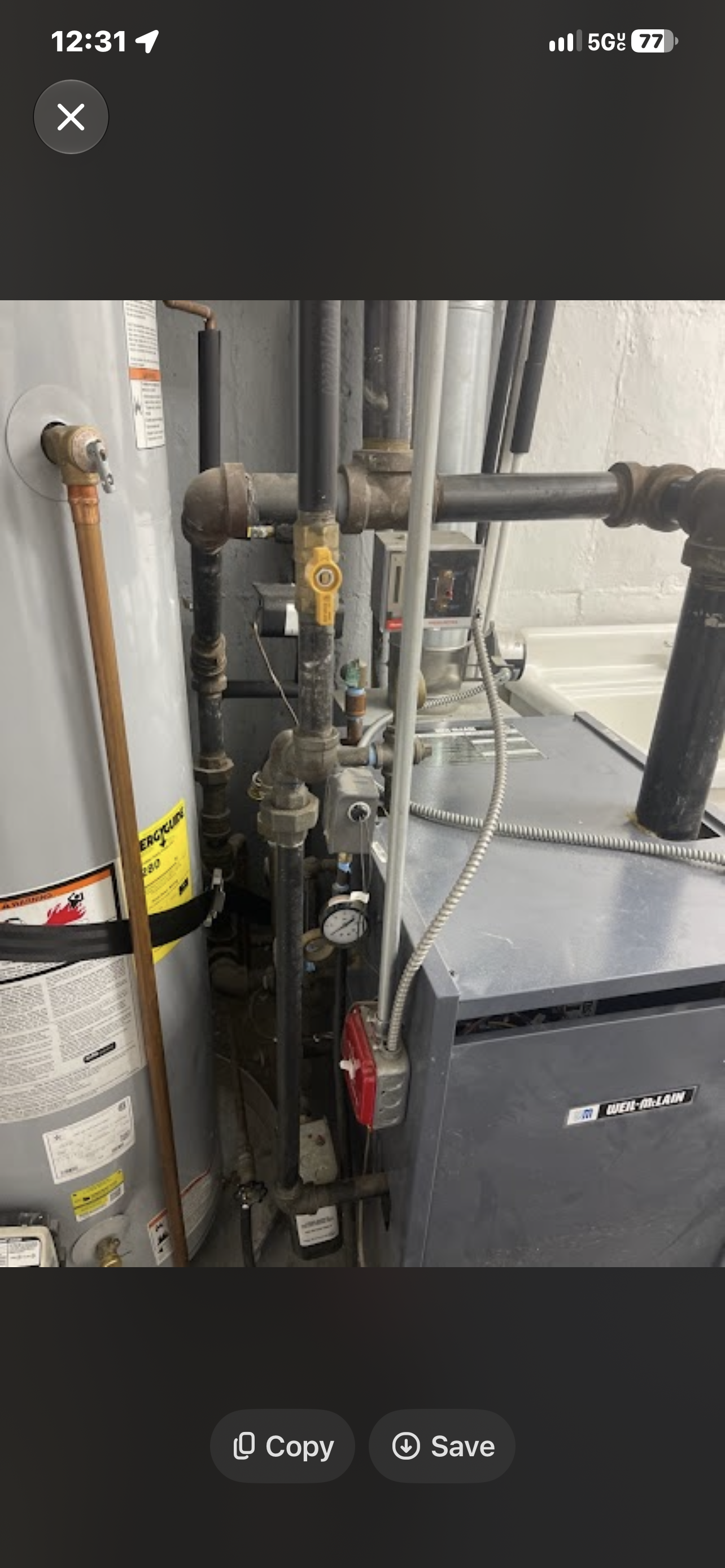

I live in Queens, NY, in a home with a single-pipe steam heating system. A local plumbing company installed a new gas steam boiler in basement with two floors above it for us when we converted over from oil.
The installer says it is OK to leave the Pressuretrol set where it is, but I read online that residential steam systems should run at a much lower pressure (around 0.5 PSI cut-in).

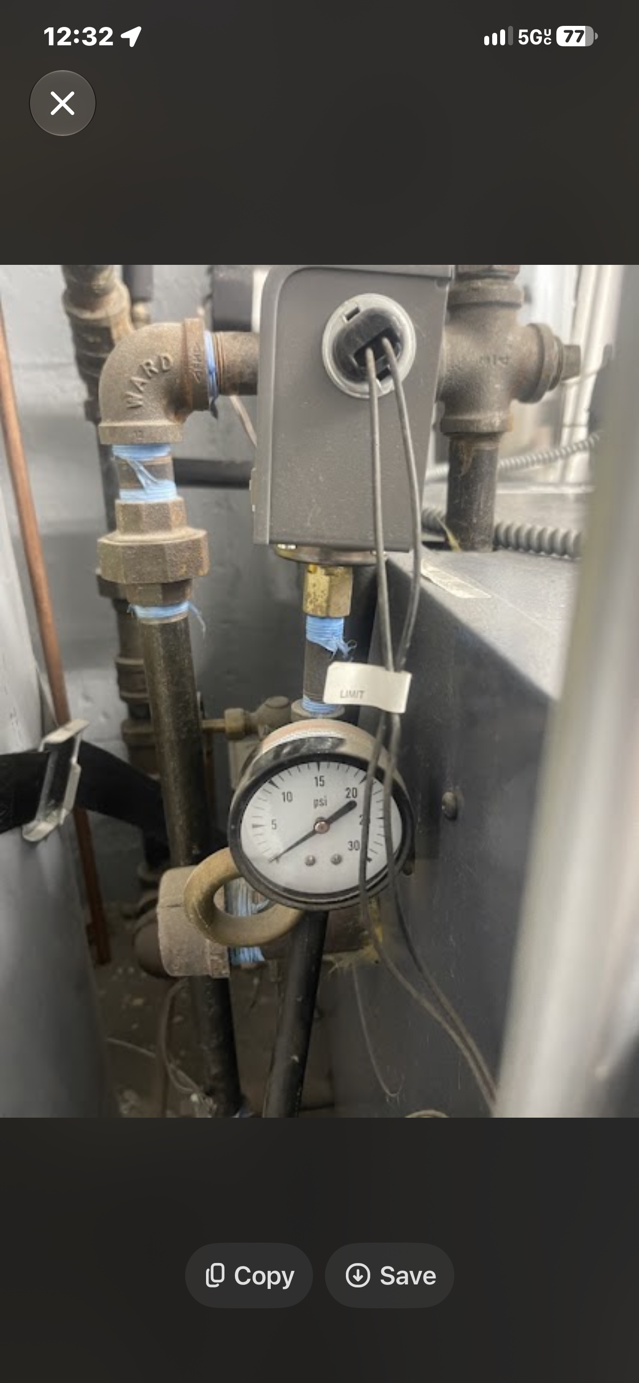

Currently, my Honeywell PA404A Pressuretrol is set with a cut-in around 2.5 PSI and a differential around 1.
Here is what I'm seeing:
1. Whenever I attempt to lower the cut-in dial on the front scale below 2.5 PSI, the boiler will not fire at all.
2. When I inspect the internal microswitch and press the button next to the differential, it does not click when set low. It only operates on the lever once the dial is back up to ~2.5 PSI.

    How are you measuring the pressure, with the gauge on the boiler? That is not accurate much below 10 or 15PSI.
    EBEBRATT-Ed Posts: 21,202
    The Pa404a the scales are inaccurate and they can be difficult to dial in.. Before you go to the expense of a vapor stat which is $$$$ I suggest you buy a low pressure 0-5 psi pressure gauge. You can stick a tee on someplace to add the gauge next to the pressure control etc. Its better if the gauge is protected by a pigtail. Use all brass fittings.
    Make sure the pigtail and the pressure control connections are clear while you at it.
    Once you can see the accurate pressure you should be able to adjust the control to cut in just above 0 and cut out at 1.5-2psi.
    Did they size the new boiler to your existing radiation (measure the rads)?
    Pictures of the install may help.

    The PA404A is an additive pressure control device. On the outside, there is a scale for cutin, which can be set as low as 1 psig — though I would suggest slightly higher is better. On the inside there is a differential wheel which should be set to 1. That should give you a cutout pressure of a bit above 2 psig — which is the most you want for residential steam — and a cutin of a bot above 1 psig.
    If the control is operating properly, it is quite satisfactory for most residential steam systems (not for vapour — ow pressure — two pipe systems, but that's a different matter).
    As suggested, get a low range pressure gauge and add it to the pigtail with the pressuretrol and see what is really happening. The 0 to 30 gauge, which is required by code, is none to accurate at low pressures.

    Get the pressure gauge and check — but it's not unheard of for a PA404A to be out of calibration — but not, usually, that far! Vaporstats are not cheap — and in my opinion they are overkill for one pipe and most two pipe steam systems.
    After you get the low pressure gauge, if you find the PA404A is lying to you you can try to recalibrate it — there is an adjustment screw — or simply set it so that the gauge reads a 2.0 psig cutout/1.0 psig cutin and write a iittle note to yourself…
