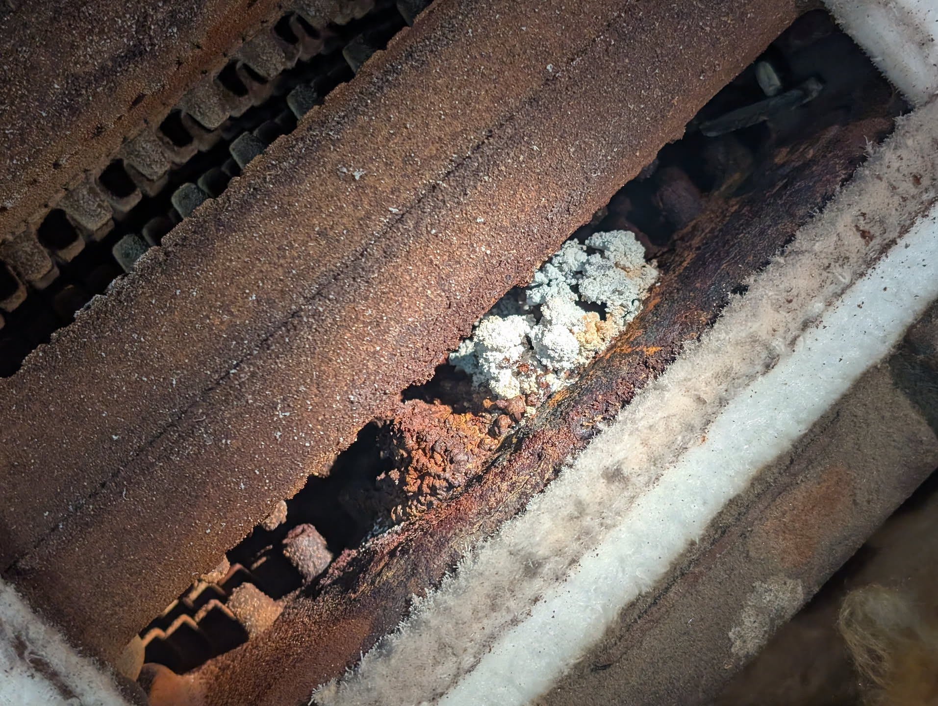

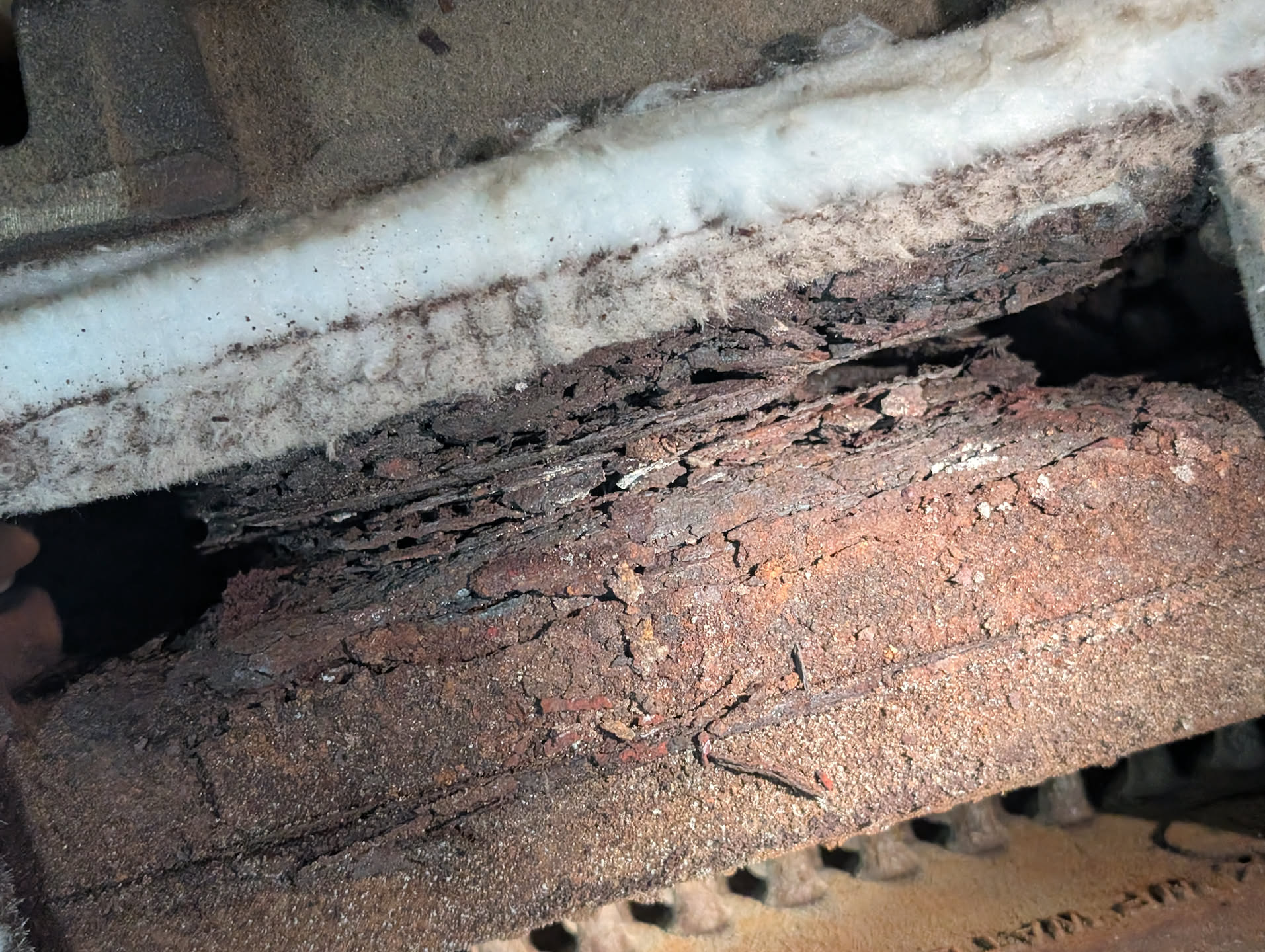

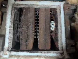

Another Burnham Independence bit the dust. Photos at the bottom, you may like to see it!

As promised, some photos of the Burnham and why we need replacement:

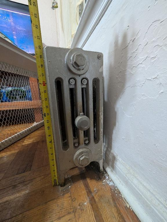

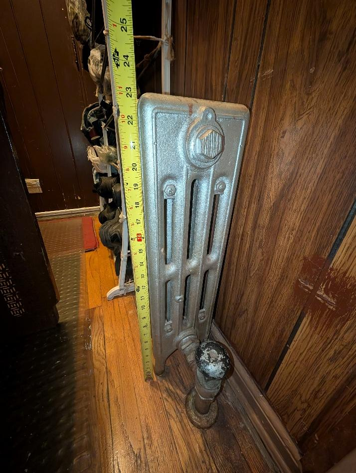

And here are some photos of our radiators:
Front room; the other radiators have the same chamfered style:
Front door has a different, rounded style radiator:
