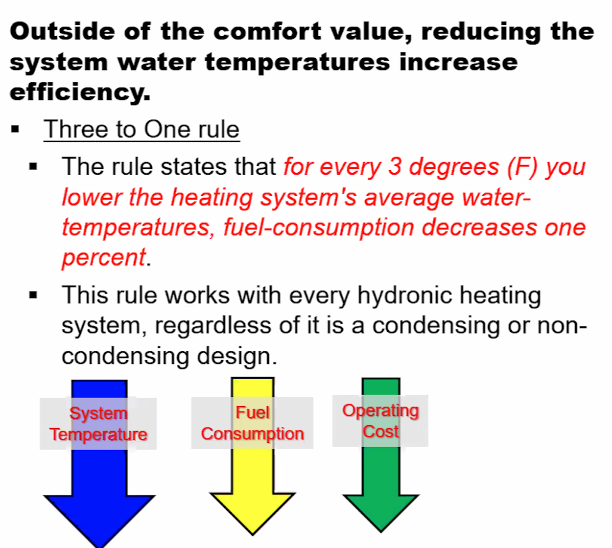

    If in fact you need that high, use an ODR control. Most areas are at design temperature lerss than 10% of the heating season. That high operating temperature drives down efficiency.
    Years ago the HI Hydronics Institute suggested a high 200°+ operating temperature to use less fin tube and come in with a lower bid than competitors.

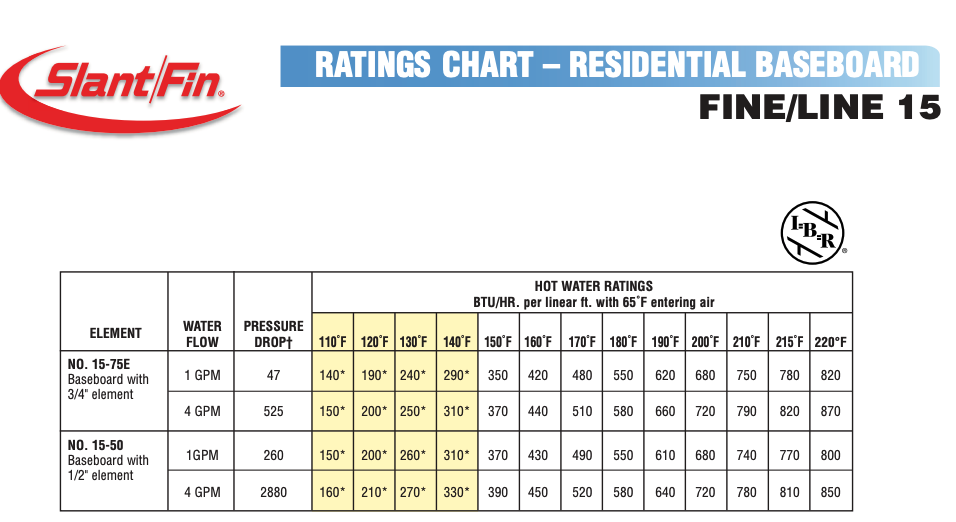

    You can pick up a small output increase with any heat emitters by increasing flow rate
    Notice how fin tube shows output at 1 and 4 gpm flows. Same applies to fan coiuls, CI radiators, etc.
    The higher flow increases the AWT average water temperature across the heat emitter, increasing output. 3/4 copper can run4 gpm without wear or noise issues.
