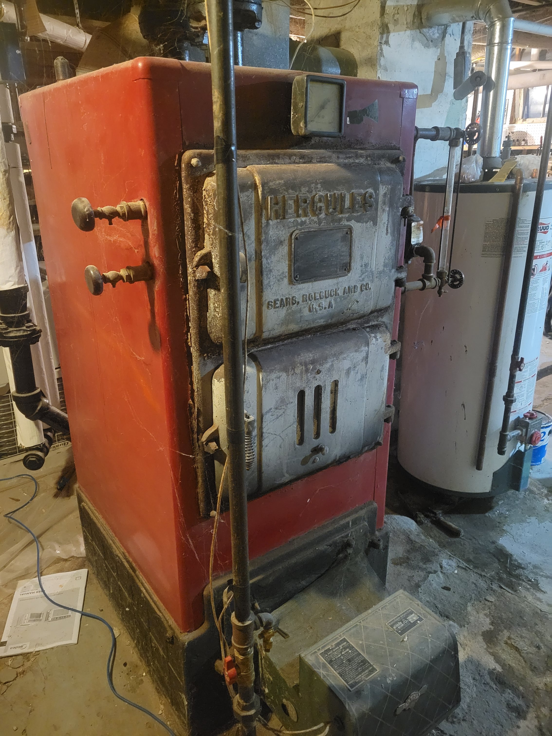

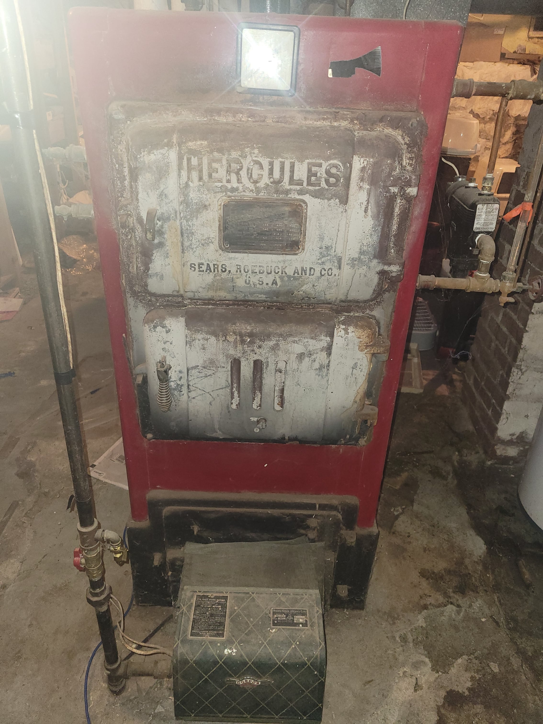

I just stumbled upon this website today while trying to learn more about my current heating system. I have a Hercules boiler- I believe it was converted from coal, to oil, and then gas. The house I live in was built sometime between 1890-1910, and I was wondering if anyone knows how old this model is?
I'd also like to know how efficient or inefficient they are. My brother and an HVAC guy who serviced it in the past both think I should keep it going until it fails. I figured it might be worth reaching out to see who else might have one, or who has worked on one, and gather more information about this Hercules in general and what their thoughts are on keeping it running versus modernizing??
I have steam heat with old-fashioned radiators.

    Steamhead Posts: 19,007
    @Ananda , later Sears boilers were made by Dunkirk. Not sure if that one was since it's older. I'd say 1930s or 1940s on yours.

    EBEBRATT-Ed Posts: 21,328
    I agree with the 30s-40s
    mattmia2Ananda
    probably not super inefficient but a new boiler might be 15% more efficient. you can buy a lot of gas for the cost of a new boiler and the new boiler probably won't last 80+ years.

    109A_5 Posts: 4,759
    You can buy a lot of gas for the cost of the old boiler's removal, a new boiler and its install.

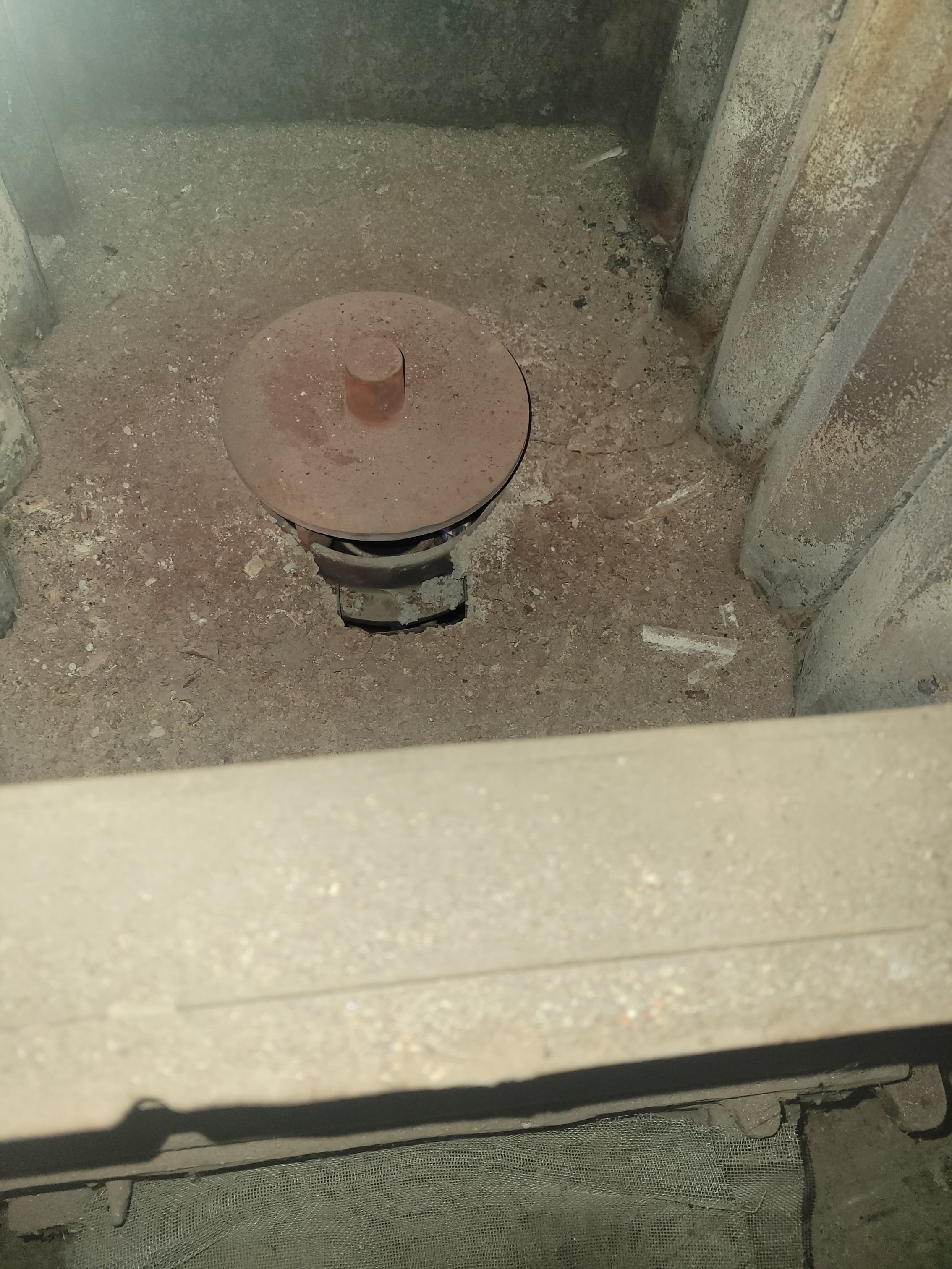

    Anandajesmed1
    also be careful of that refractory disc on top of the conversion burner. they are kinda fragile and long ago unobtainable.
  • Definitely keep the boiler. There’s nothing better than these old original boilers and they are more efficient than people think.
    I regularly get the “it’s 40% efficient” incorrect guess on my No. 7 Ideal boiler which is 90 years old. I bought my own combustion analyzer, it’s actually 72-75% efficient and my heating bills back that up. The talent just doesn’t exist like back then with the installation of that boiler. We have seen it here in the group countless times with newer installs. Just crappy install work and of course, people are here because it’s giving issues.
    Yes, technically a new cast iron boiler would be slightly more efficient, but honestly, the cost to install, especially if your basement piping is asbestos covered (abatement will be needed) just is NOT going to be made up in the mild savings you will earn. And once again, the fact nothing lasts, you are lucky to make it 10 years with a new boiler. I’ve seen peoples boilers develop a crack in the cast iron section after 5 years. Keep that thing going and maintained.
