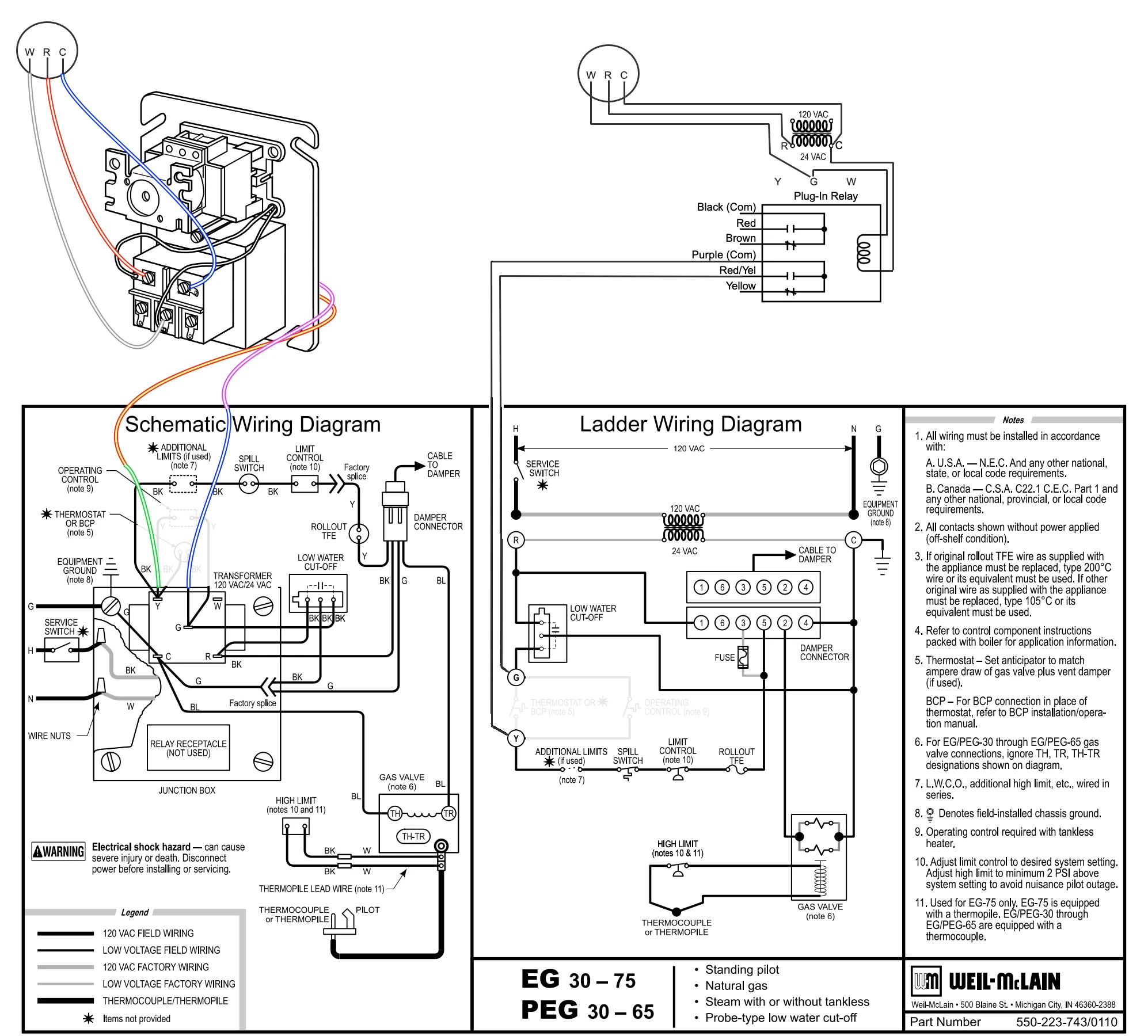

We have a gas-fired Weil-McLain EG55PIDN series 4, 2001 model in good working order, and serviced annually. Two pipe system with 19 radiators, all in good working order with fresh traps and valves.
We would like to upgrade our thermostat to an Ecobee Smart Enhanced model with Wi-Fi capability, so that we can monitor temperatures and turn the boiler on/off remotely.
The existing thermostat is connected via 18/2, using a red and white ran a new 18/3 wire.

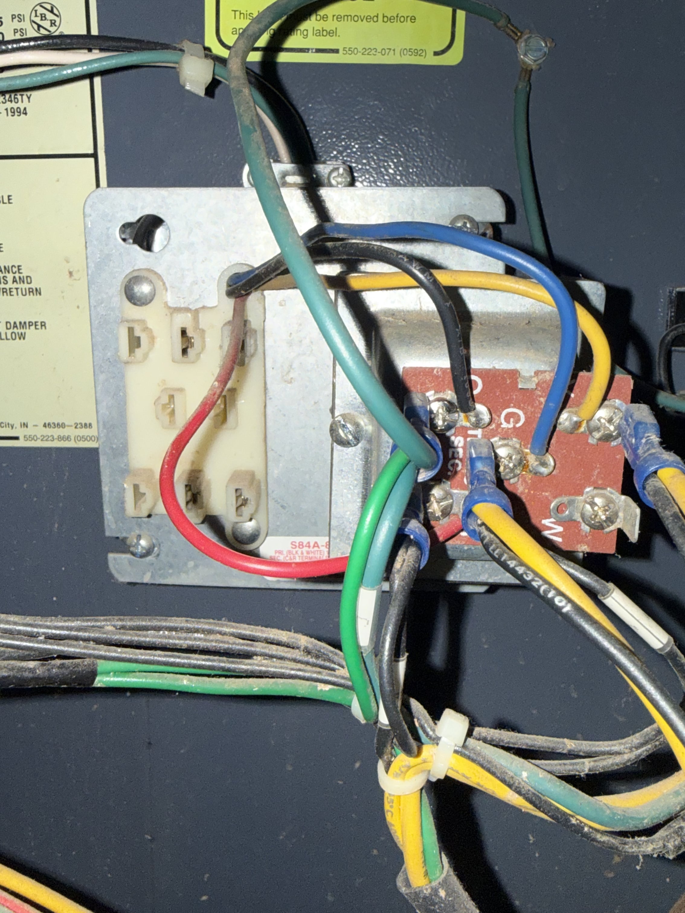

There's a 24 V transformer as shown in the photo below below, with the following terminals:
Y - connected to the white thermostat wire
G - connected to the red thermostat wire

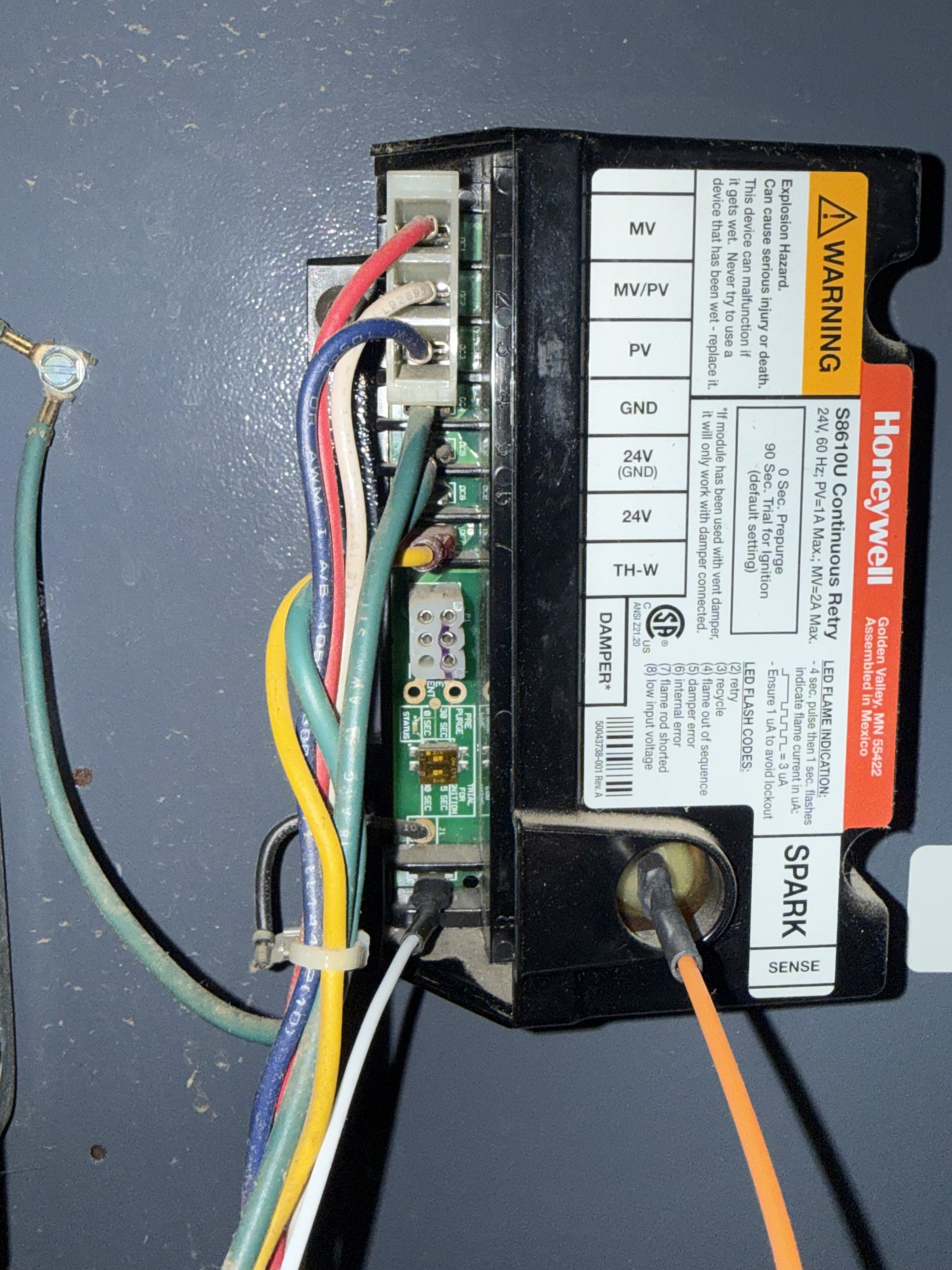

There's also a Honeywell SB8610U ICM continuous retrywith several of terminals. There's also water feeder and an LWCO, which I certainly don't want to bypass.
The new Ecobee thermostat won't turn on without the green wire connected, and I'm having difficulty figuring out which wire terminal to connect it to.
I haven't powered it up yet I don't want to damage it by connecting it under the wrong terminal.
Can someone kindly advise me as to which terminal to connect the green wire to get power to the thermostat? Or do I need an isolation relay to get power to it?

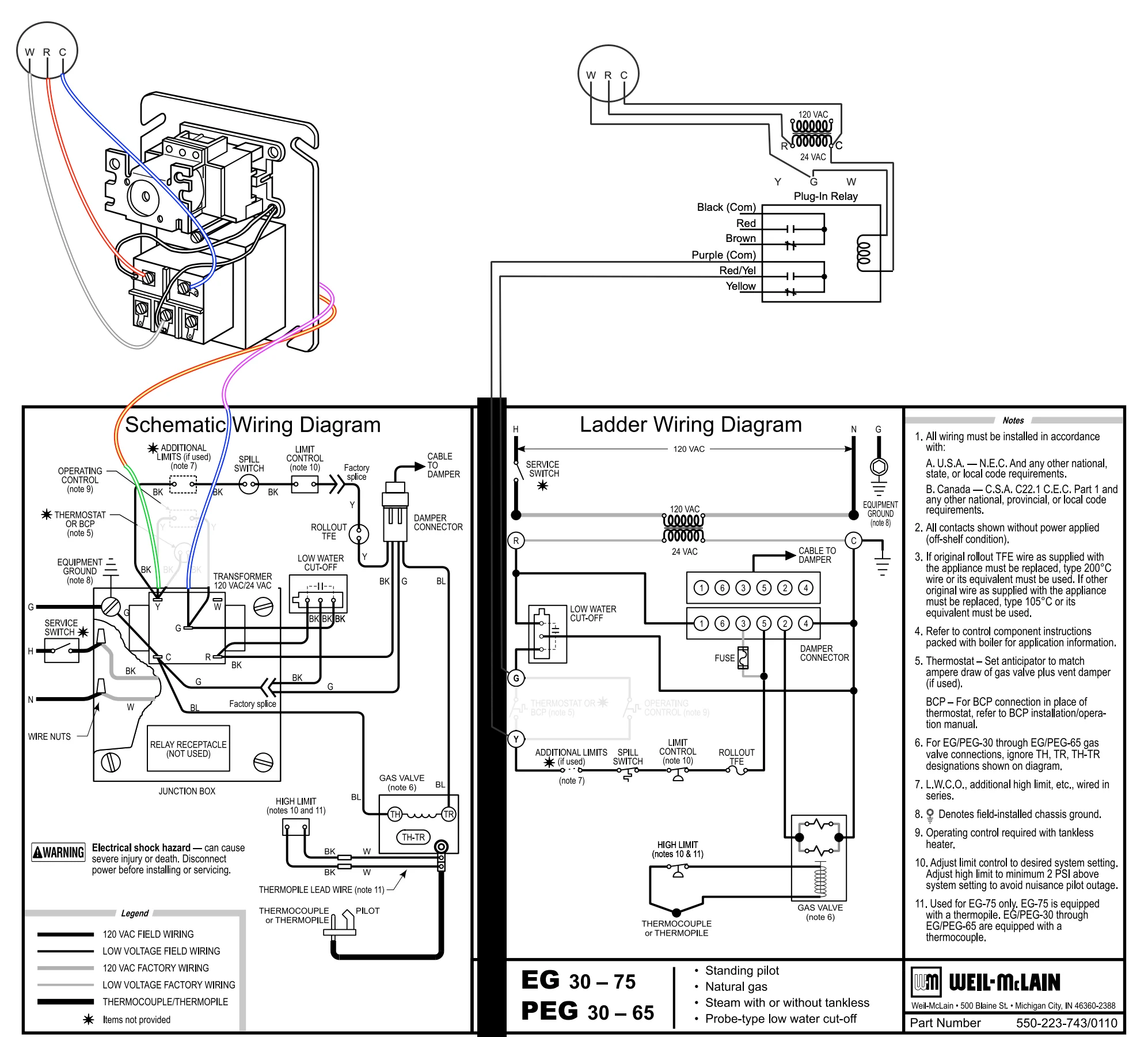

    This is hopefully a similar wiring diagram to your boiler, although you probably don't have a standing pilot.
    Is your LWCO a probe type ? If so the first thing connected to the Transformer's R terminal is the LWCO and not the thermostat.
    You will probably need to add relay. Since the LWCO and the Ecobee thermostat both want constant 24 VAC power.
    The Ecobee thermostat's R and C would connect to the transformer's R and C. This provides constant power to the Ecobee. The coil of the added relay would go to the Ecobee's W terminal and the transformer's C terminal. The contacts of the added relay would connect to where the original 2 wire thermostat was connected. I bet @EdTheHeaterMan has a wonderful wiring diagram all ready prepared as to how to add the relay.

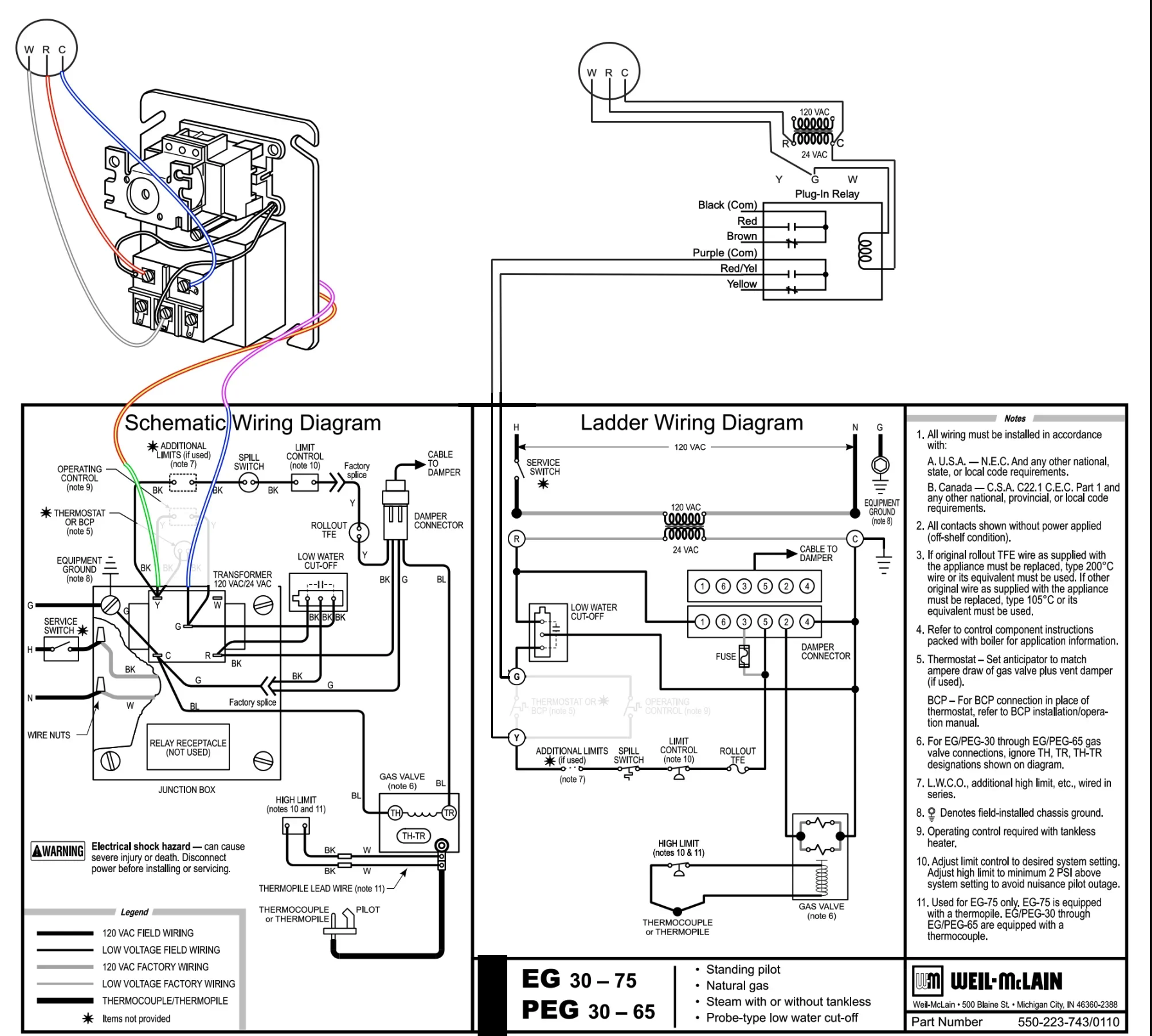

  • That is why I posted that diagtam where it is easy to find. Thanks @109A_5 for sharing it. But somehow there is a black line where some wires should be. Here is the corrected version.
    I also went back to the original post and corrected it too. Thanks Again @109A_5

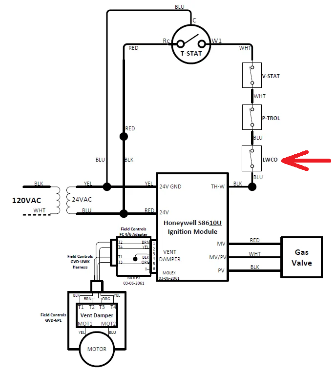

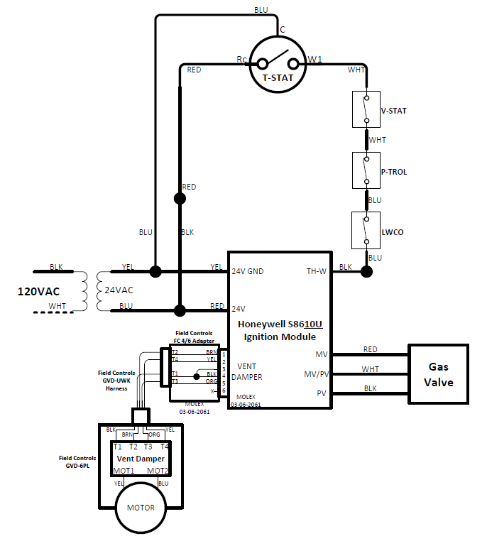

  • I was in an identical boat about 5 years ago. I installed an Ecobee wi-fi thermostat and had to replace my 2-wire thermostat with a 3-wire.
    At the same time I installed a vent damper which required me changing the Honeywell S86F Ignition Module to a Honeywell S8610U which had the correct pinout for the vent damper I was using.
    Long story short, I connected the "C" wire from the thermostat directly to the 24V side of the existing transformer. Below is a diagram I made so I wouldn't have to reverse engineer it again.
  • I fixed it for future use. That seems to happen from time to time as a result of the default settings of PaintBrush where a "no color applied" area in my drawing appears white. Then someone copies it to program that shows
    "no color applied" areas as grey or black. I wish I could find a way to cut and paste things without leaving the ares where I "Cut" or "Delete" leaves it white and not blank

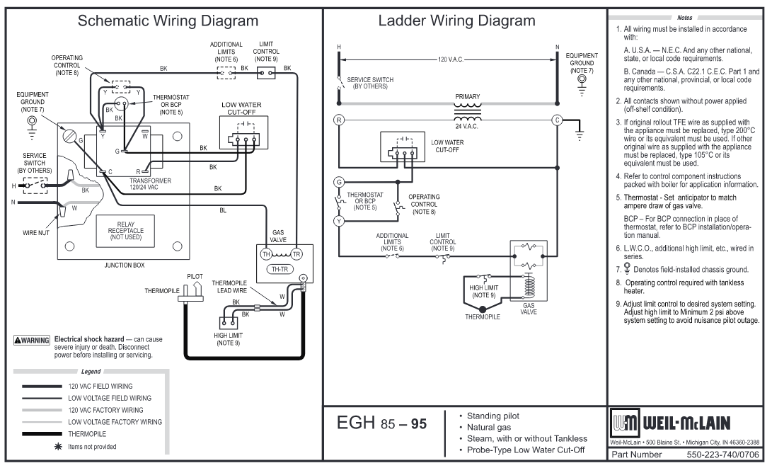

    @AdmiralYoda I don't know what type of LWCO you have but the contacts portion are in a different place in the limit string as compared to @TheClevelandSteamer's boiler you may have removed a jumper and wired the your LWCO power and contacts independently. There are different ways of getting it to work depending on the system's equipment.
    With @TheClevelandSteamer's WM boiler if his LWCO uses the 3 circuit connector isolating the LWCO power and the contacts may be more difficult.

    @109A_5 I have a Peerless G-461-SP-1 installed in 1986. The G-461 was the naming convention before Peerless changed ownership in the 80's. It then became the 61 series and then eventually the 63 series. My old Peerless uses a float style LWCO. The contacts are closed when the float is up and open when the float drops to a certain level.
    My main point was that he can just tap off of the 24VAC side of the transformer to power the C wire.
    According to the Ecobee spec sheet it uses "Up to" 3.5VA, which on a 24VAC source is less than 150mA of current so there should be enough headroom on the transformer to handle the Ecobee.
    Other options do exist. He could have another 24VAC transformer wired in just to power the Ecobee. If a 120VAC receptacle is nearby they make plug-in transformers to tap in to as well.
    Ecobee also makes a "Power Extender Kit" which essentially taps off the 24VAC on the existing transformer for you and sends power to the C wire.

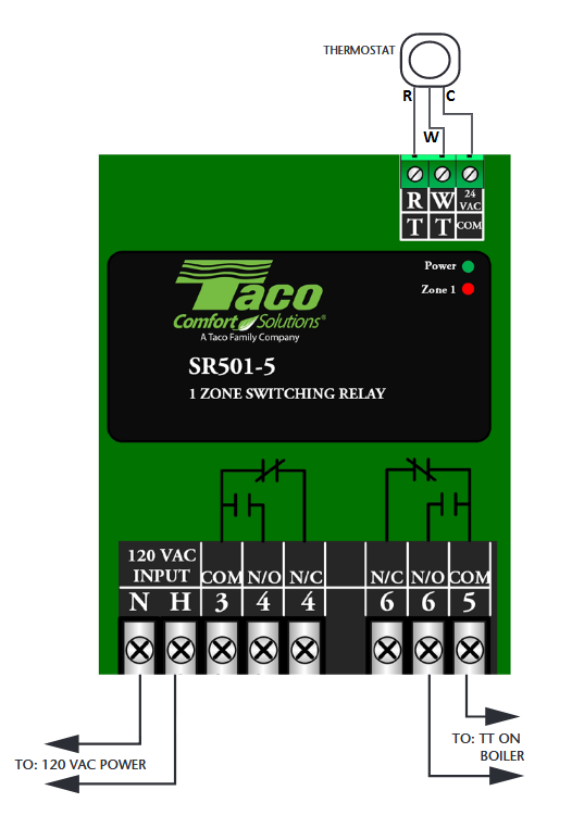

    109A_5 Posts: 4,778
    A single zone switching relay like this makes for a nice clean upgrade technique. It has the transformer and the relay in a nice housing.
