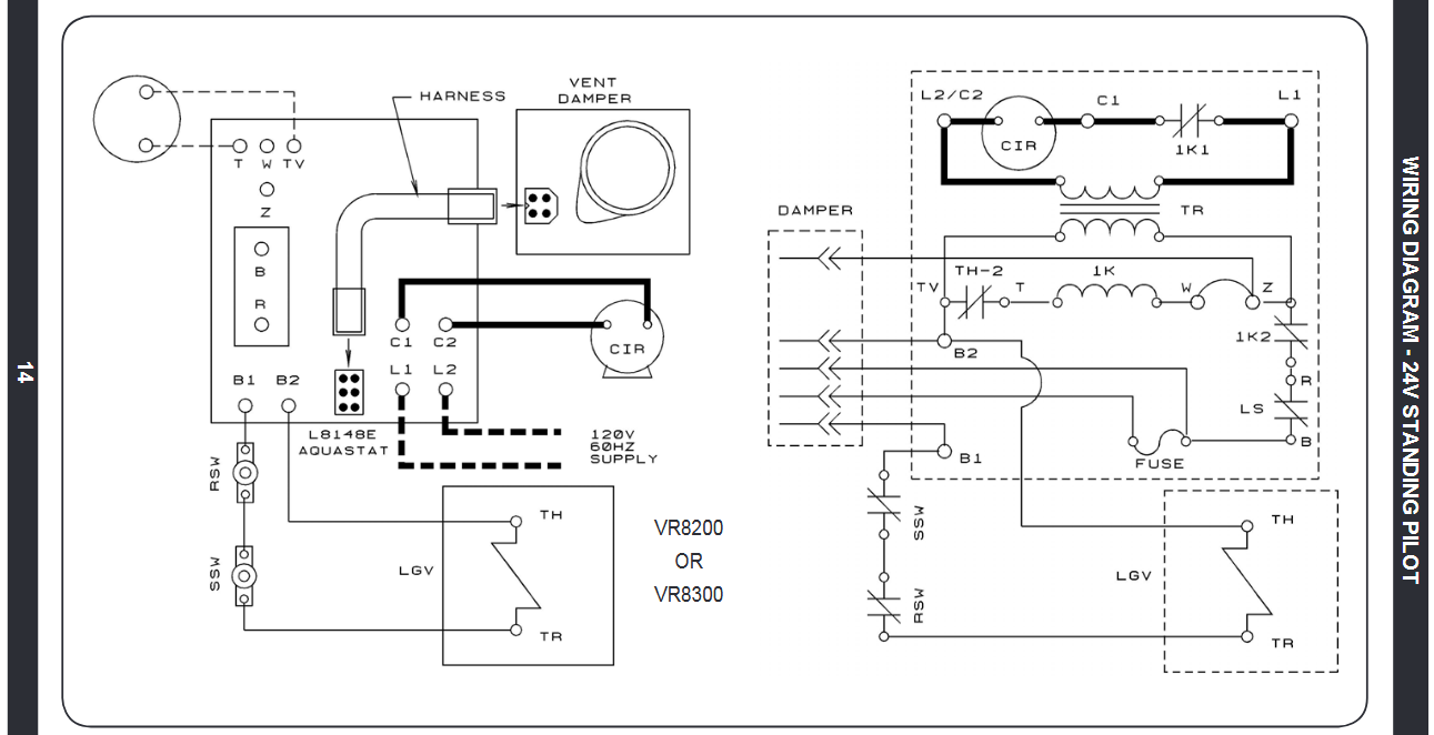

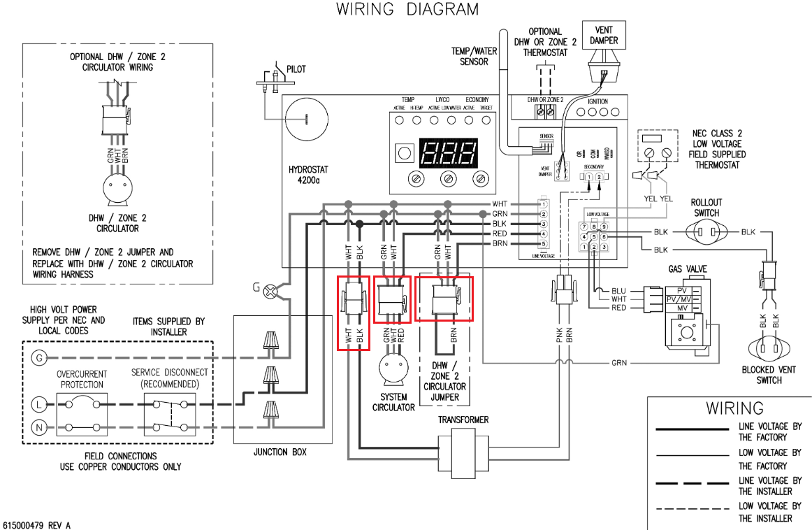

    I can't find a manual that is specifically for the MGB 150HD, the HD is not listed, this wiring diagram is from a MGB 150K.
    Anyway if they are similar I'd be looking at the circulator(s). It looks like you can easily disconnect them and see if the overload goes away. Also inspect for crushed or otherwise compromised wiring.
    Also this is a bit confusing " pilot is on but as soom as the ignition goes on ", does it have a standing plot lit all the time or is there an ignition system that lights the pilot. If the ignition is used to light the pilot how can the pilot be on ?
    109A_5 Posts: 4,784
    Older standing pilot version MGB150, may need a screw driver and a bit more caution to disconnect the circulator wires. I'd still suspect the circulator or damaged wires.
