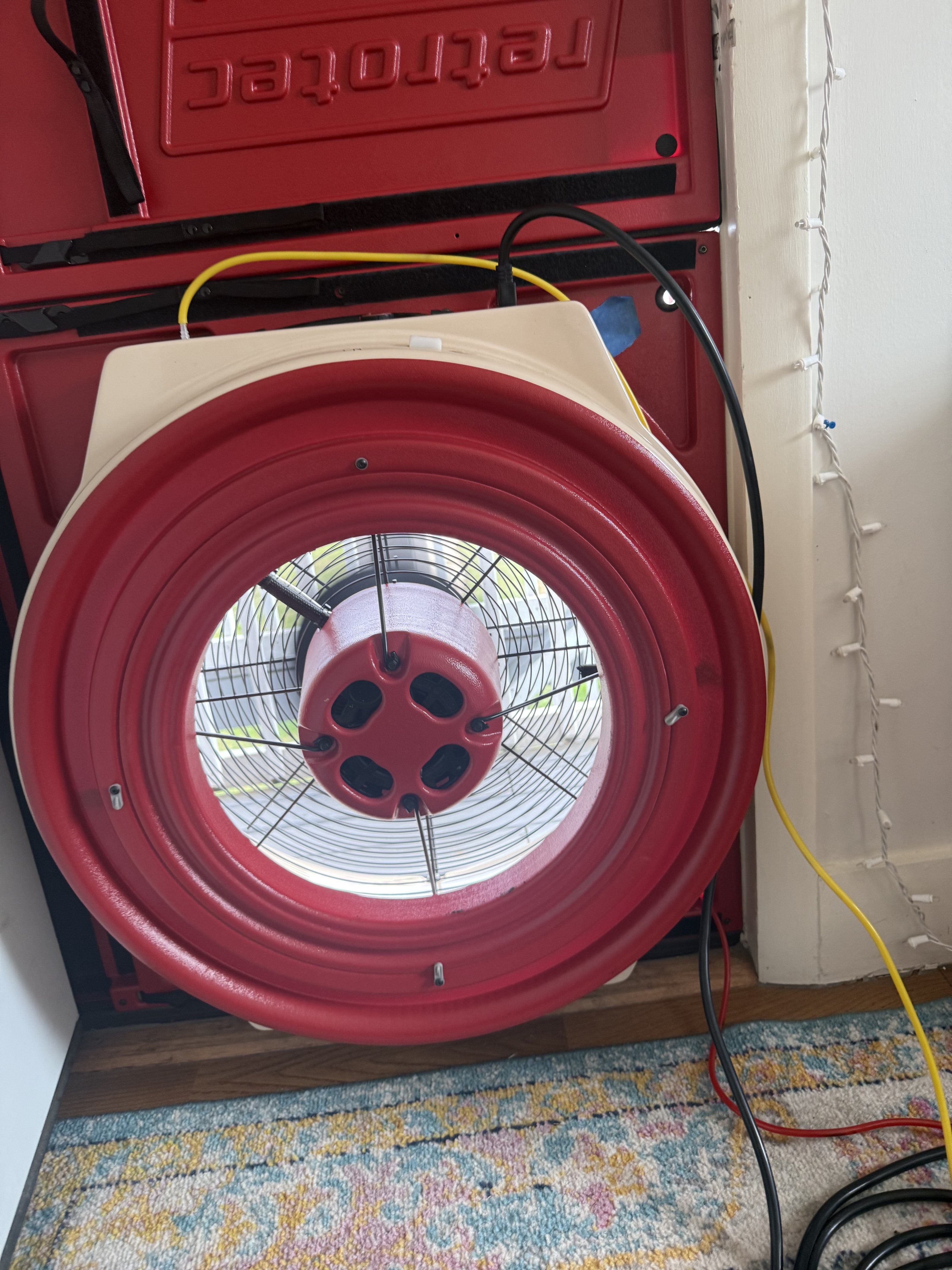

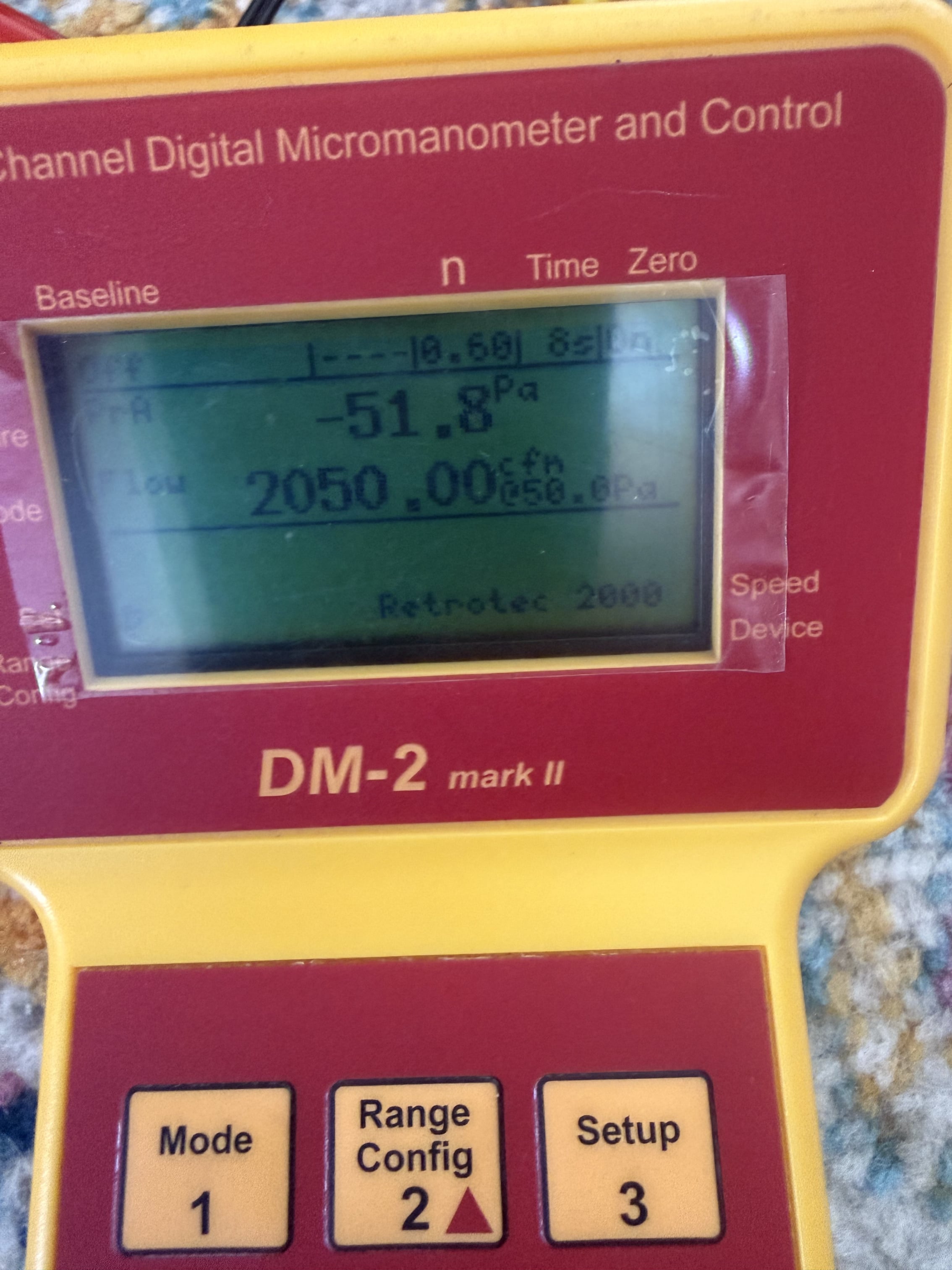

  • GW
    GW Posts: 5,257
    buy a smoke puffer and get to work. Gotta wait for cold weather though for the natural convection affect.
    or bust out the blower door. I just bought a little 4 family and one of the tenants said she was getting wicked drafts last winter. She expressed further dismay when I told her she would be getting her own heating and hot water bill in the near future.
    I blew the dust off my 20 year old blower door set up and found some gushing wall cavity leaks.
    I’ll see if the local energy program can tighten things up. I won’t tell them I did my own blower door. Seems to be the classic balloon frame building
    yes I see the tiny hole in the panel. I’ll simply re test in the same manner

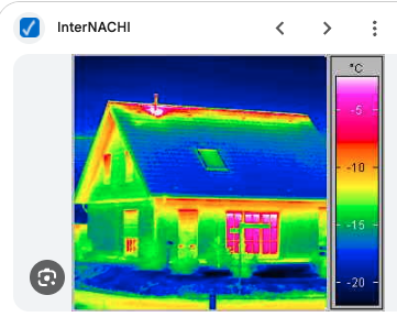

    hot_rod Posts: 28,606
    An infrared scan along with blower door will show you where to start
