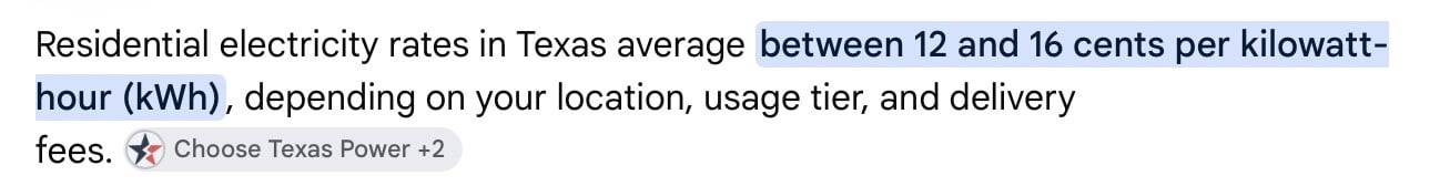

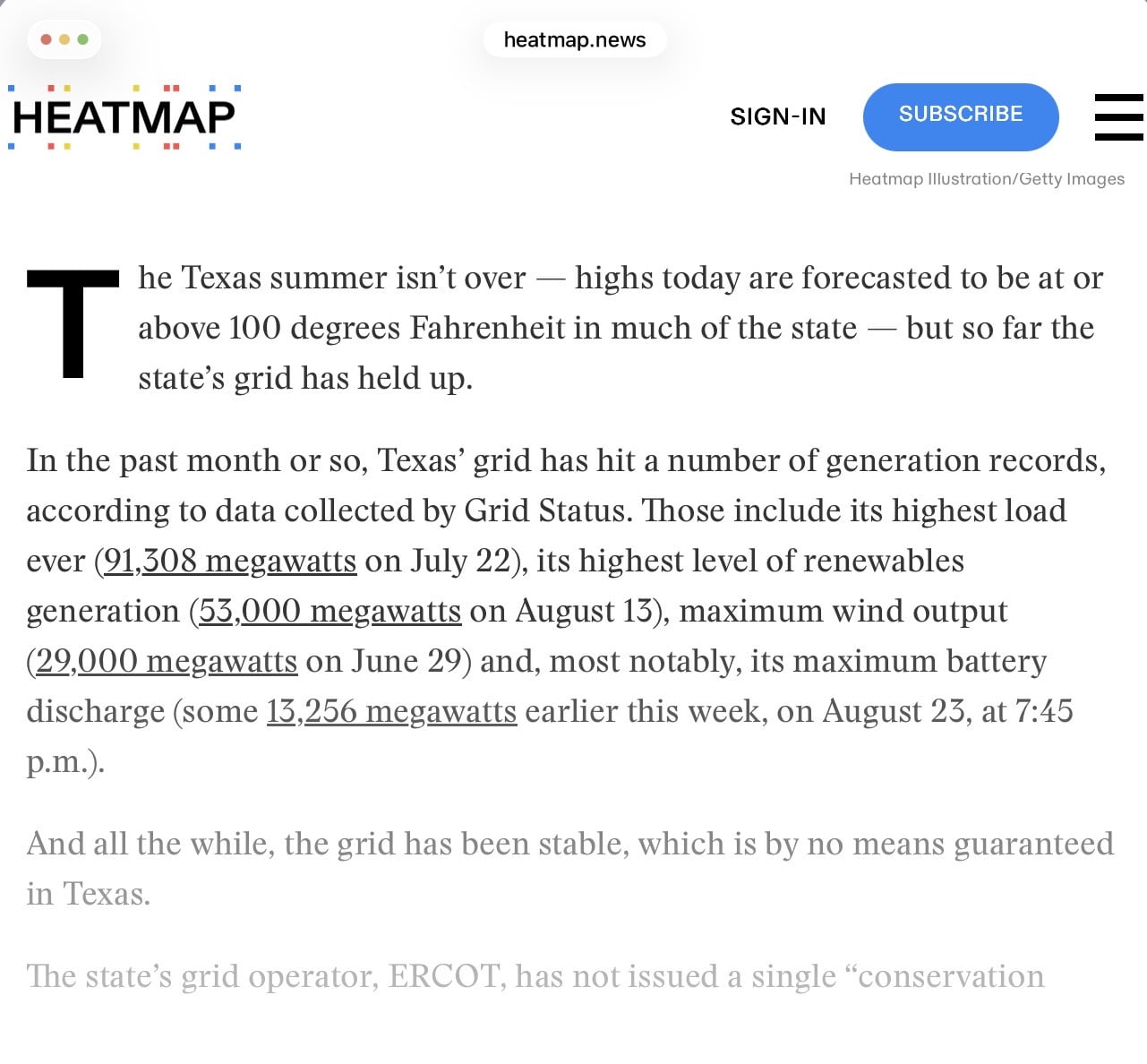

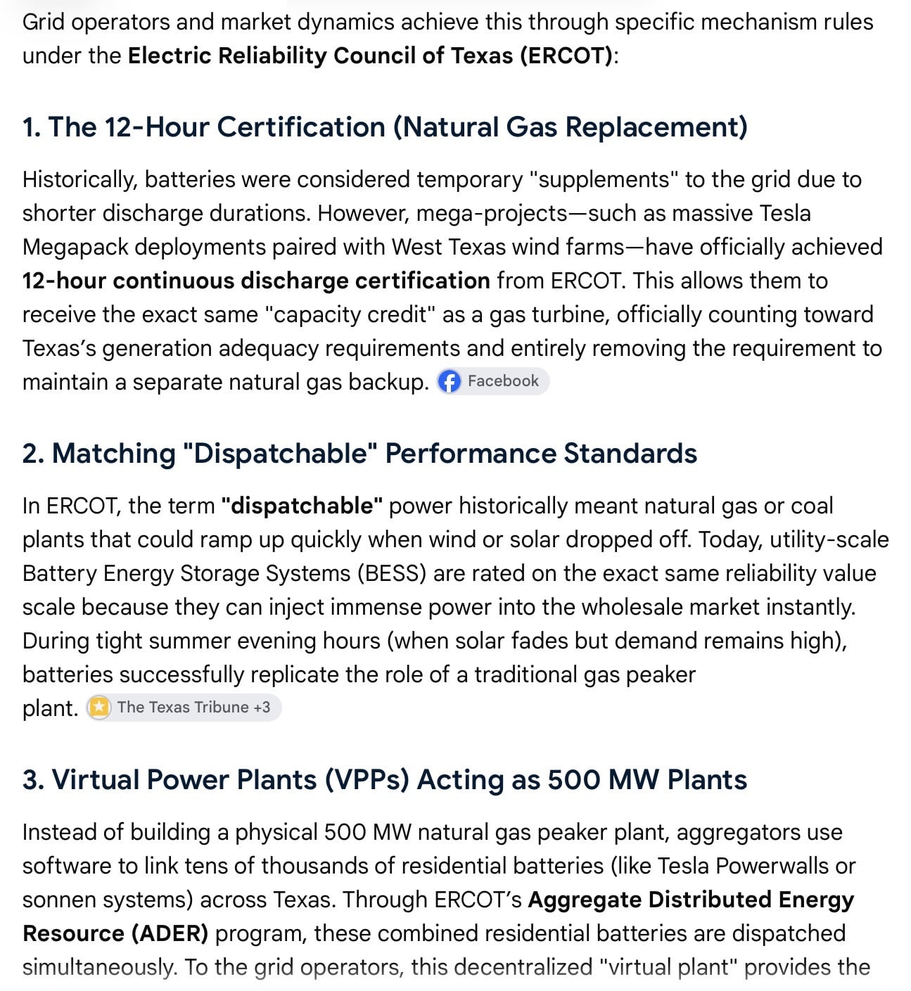

    Texas seems to be blending RE into the mix, and low rates
