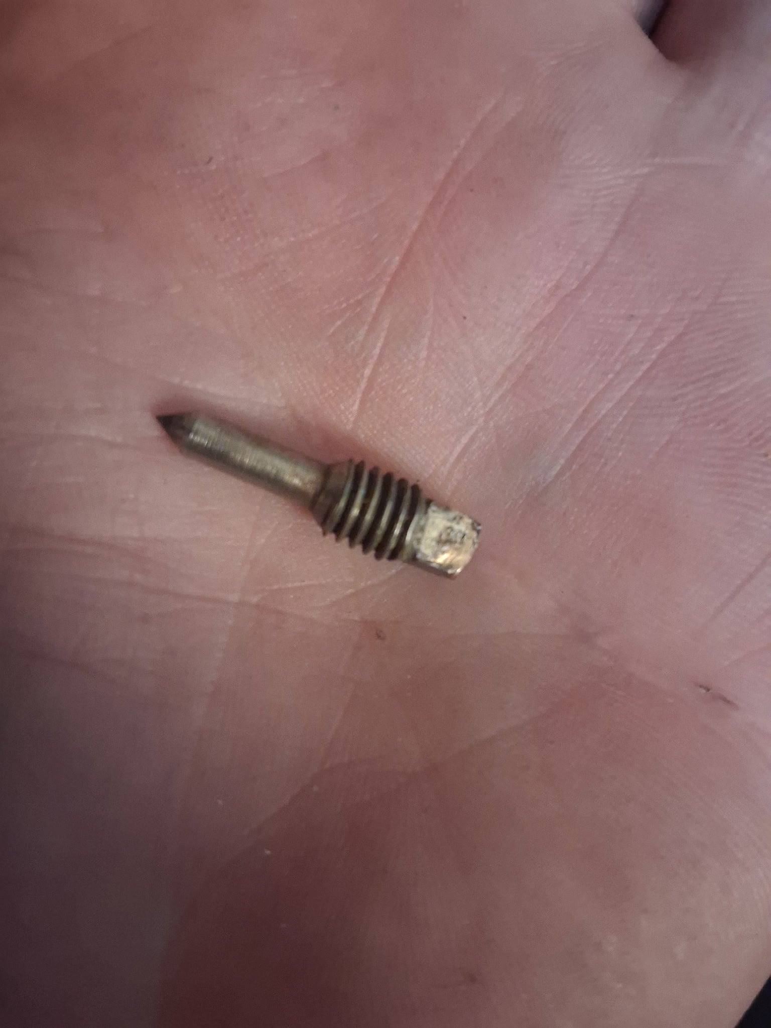

I lost that part of a bleeder valve on a 100-year-old cast iron radiator. I was going to buy a screw at the hardware store and turn it down in my lathe but its not metric or SAE. I don't have a clue if any of the bleeder valves i see for sale with 1/8 or 1/4 NPT will fit and I am scared witless at the ide even trying to remove the old bleed valve because i don't want break anything and make my situation worse. Any body have a clue as to where I can get that part?

" not metric or SAE " maybe the old USS (United States Standard) or UNC (Unified National Coarse).

It looks a lot like an acme thread and valve stems are an application where acme threads are used.

Unusual to see something that diameter with such a coarse thread.
a 1/4 bolt coarse thread is 20 tpiIt could be a specific thread cut to give you quick and wide opening
