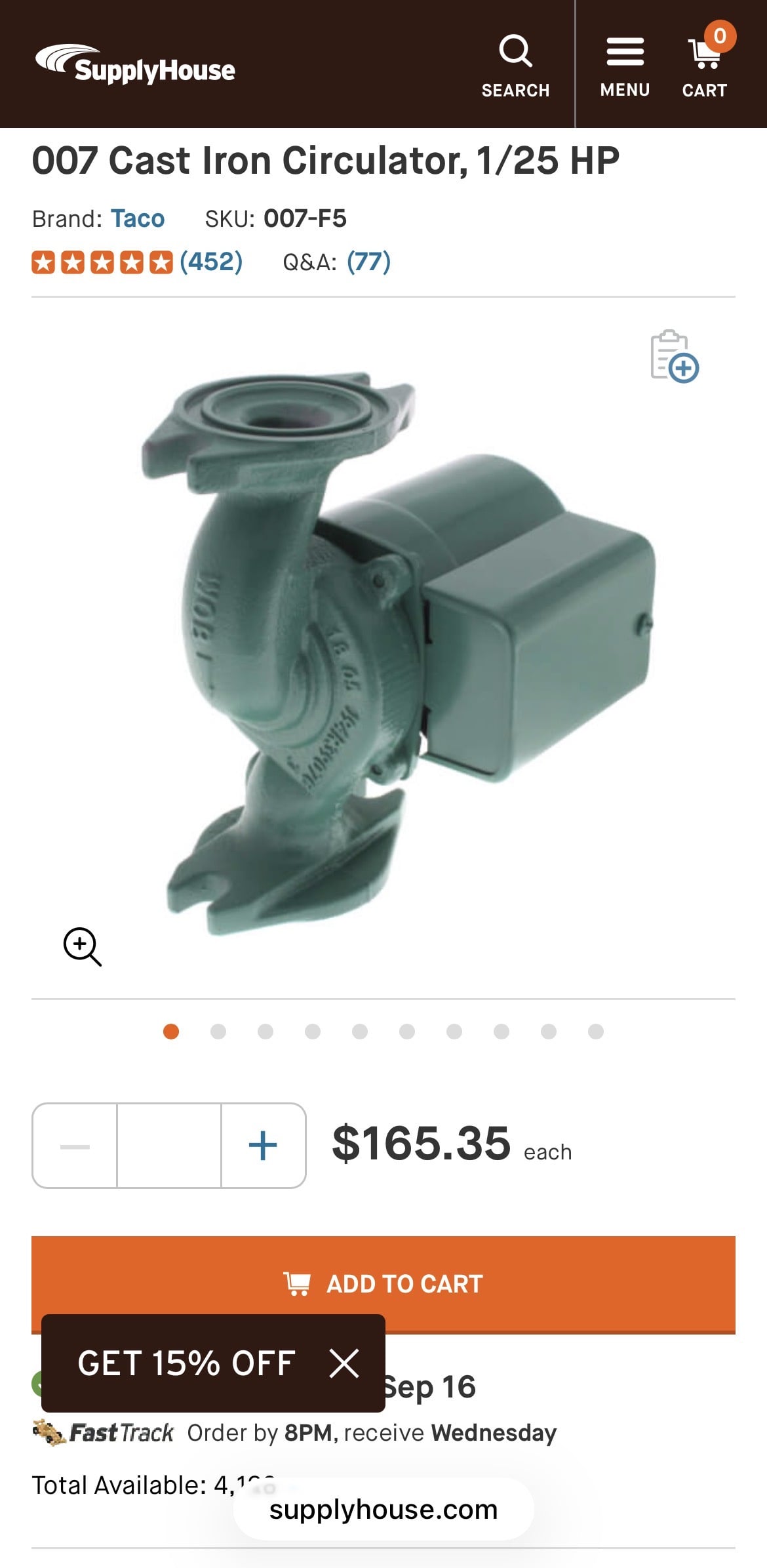

Greetings,
I need to replace an IFC in one of my 15 year old 007s and was wondering if it’s worth replacing the whole circulator with the ECM version. The pump circulates water through the whole first floor and is probably the most used of any of my 007s.
Any thoughts are appreciated.
Brent

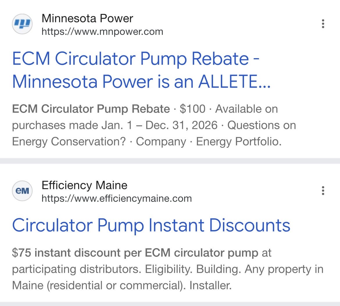

    Where are you located, many utilities have rebates still
    hot_rod Posts: 28,789
    if you save even 25 bucks a year o electricity
    And you get the 75- 100 bucks rebate
    Numbers look good to me

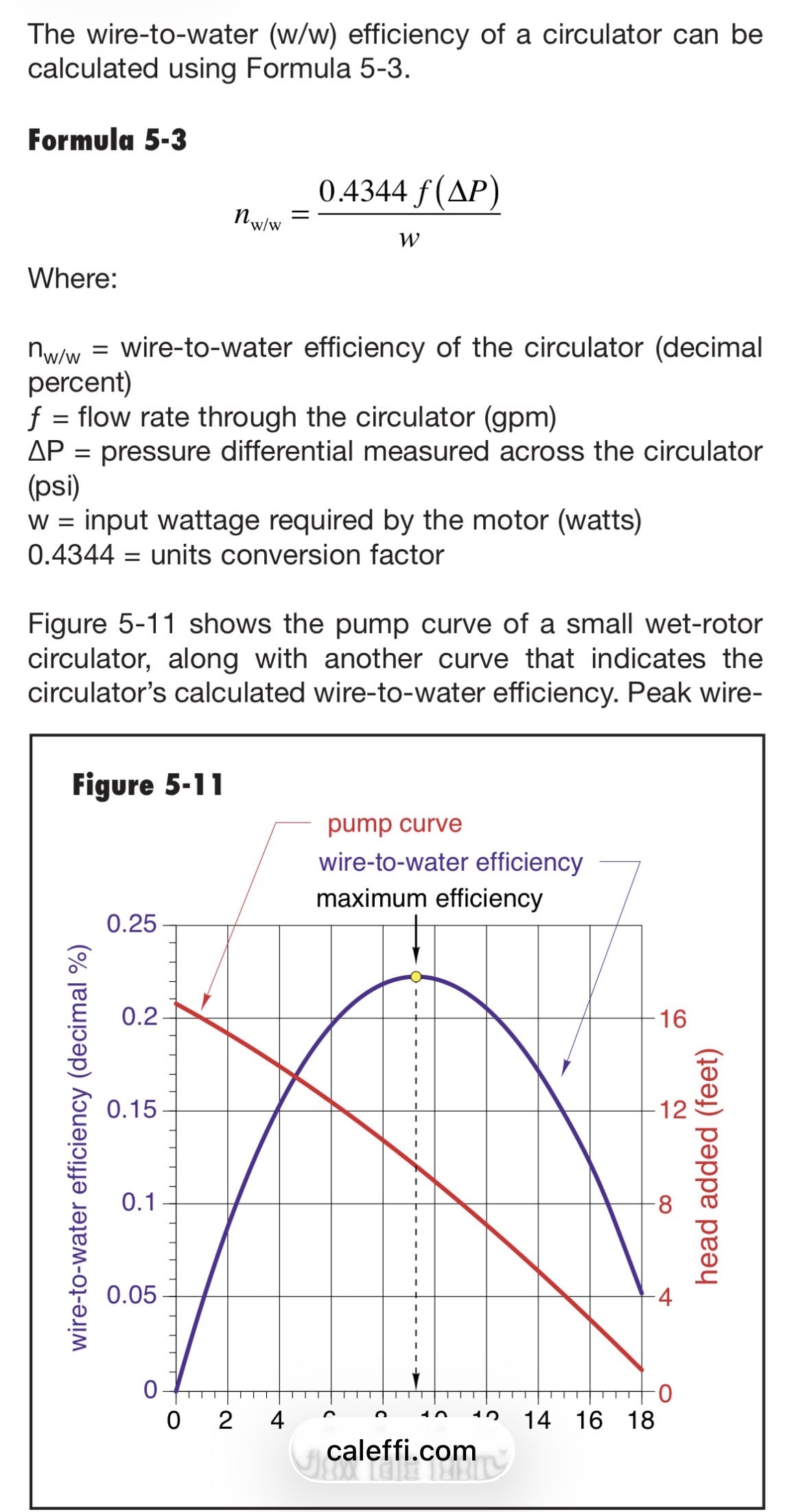

    a few things to consider, the motor itself, the ECM will be more efficient
    But also most single speed circs are over-pumping with a wire to water efficiency below 20%
    being able to adjust the speed to the load is also an improvement
    Pump people tell you 50-80%
    An 80 W circ moving only a few gallons through a single loop may be 10%!
    All these questions can be answered with some number crunching

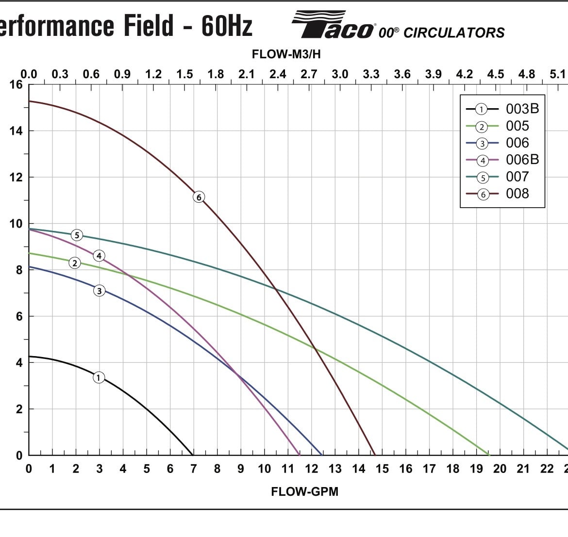

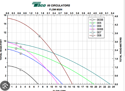

    So a 007, number 5 on the graph, at 3-4 gpm is running way to the left of curve, maybe 10- 12% efficiency
    Mid curve is where pumps like to run, 8-12 gpm is a comfort range for an 007.
    I’d guess an ECM may run 17- 20 watts to move 4-5 gpm
    Here is where you find rebate $$
    Unless 100 bucks is peanut s to you😏
    www.dsireausa.org

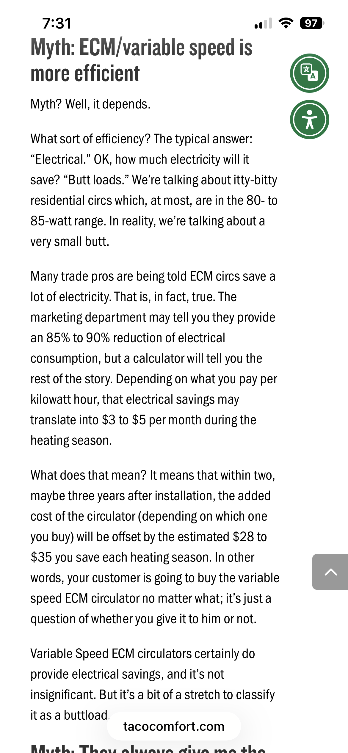

    same thing with the ECM blower motors on a furnace. it all looks good on paper until you have to pay for a new motor and the labor to replace them. they even sell kits to convert a furnace to a PsC motor.

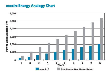

    I have cheap electricity and even here the ROI on an ECM pump is about 2 years. If you have the typical wall of pumps, upgrading the often used zones is well worth it.
    The one problem with PSC pumps is even when you turn them down, the use almost the same power. This adds up when you have 4-6 pumps running. An ECM on the other hand, on low speed might only use 10W.

    The reasons for changing iclude the efficienct bump and also I suspect the current cirs is way over-pumping if this is just a single loop 0f 3/4 fin tube. Generally a loop is 70' or so. 3/4 fin tube designs around 1 gpm.Or up to 4 if you need extra out put.
    So call it 2 gpm and see where if falls on the 007 curve
    I think the 007E is still way to much pump for a single loop fin tube.

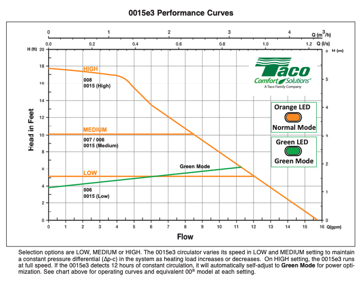

    I'm not up to speed on all the Taco, but a 0015 on speed 1 may be a better fit for a low flow circuit?

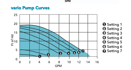

    I like the B&G Vario where you can lock it at 9 different speeds. Speed 1 or two may do it 10- 15W perhaps.
    Screenshot 2026-09-14 at 7.52.36 PM.png Screenshot 2026-09-14 at 7.52.49 PM.png
    I've been using ECM of all different brands since Wilo first introduced ECM circs. I have yet to have one fail.

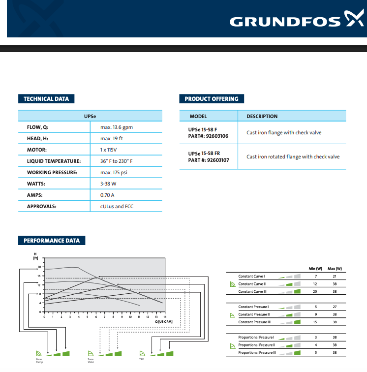

    This is another option, UPSe 15-58 it has a zone valve, constant curve, setting, looks like the 7W position1 may do it.
    Or keep the 007 at 78 W over-pumping :)

    @hot_rod
    The UPSe 15-58 looks like it may work if I order the version with the flanges rotated. I assume the spacing is the same so it will drop in where the 007 was?
    Thanks.
    you could look up dimension for both, a Google search for dimension, for example. I imagine they are very similar

    I have a Buderus G115/3 with a Riello burner. I am running with outdoor reset. If only it was just $70. I’ll likely change it out anyways as it’s the zone that runs the most and the cost really isn’t that bad. Just trying to make sure it will fit as it’s between a couple circulators.

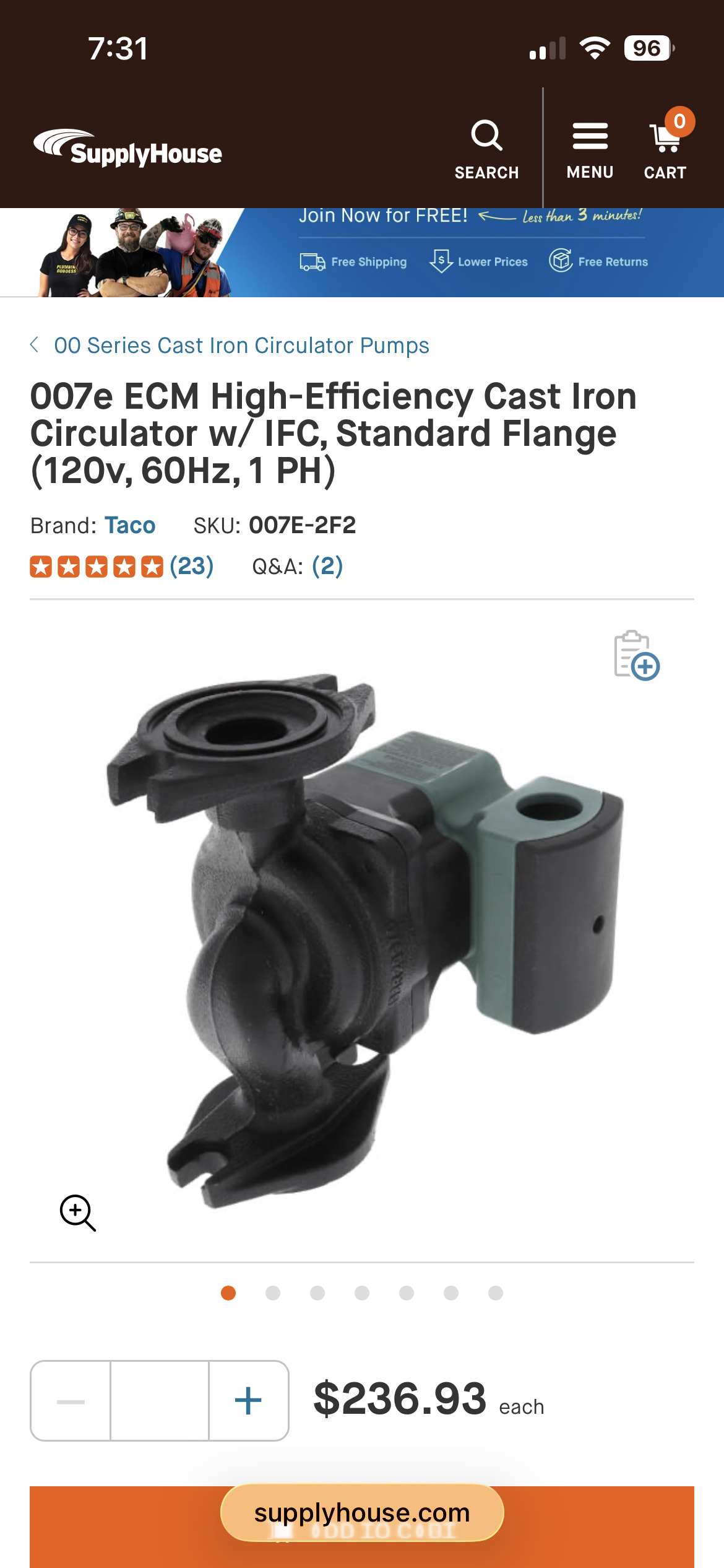

    here are the priced online from a HH sponsor
    Looks like a $63 difference
    These are contractor prices, you may be 10% more
    the reversed flange of the Grundfos should fit
    All the dimension info is online at SupplyHouse.com

    @hot_rod Strangely enough, the reverse flanged version is cheaper. Likely order one next week.
