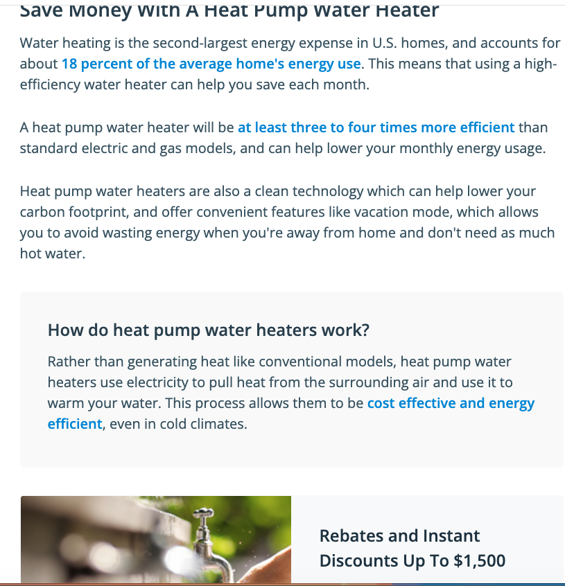

    A heat pump water heater is an option
    Check with your energy provider and state tax code, there are some good rebate programs

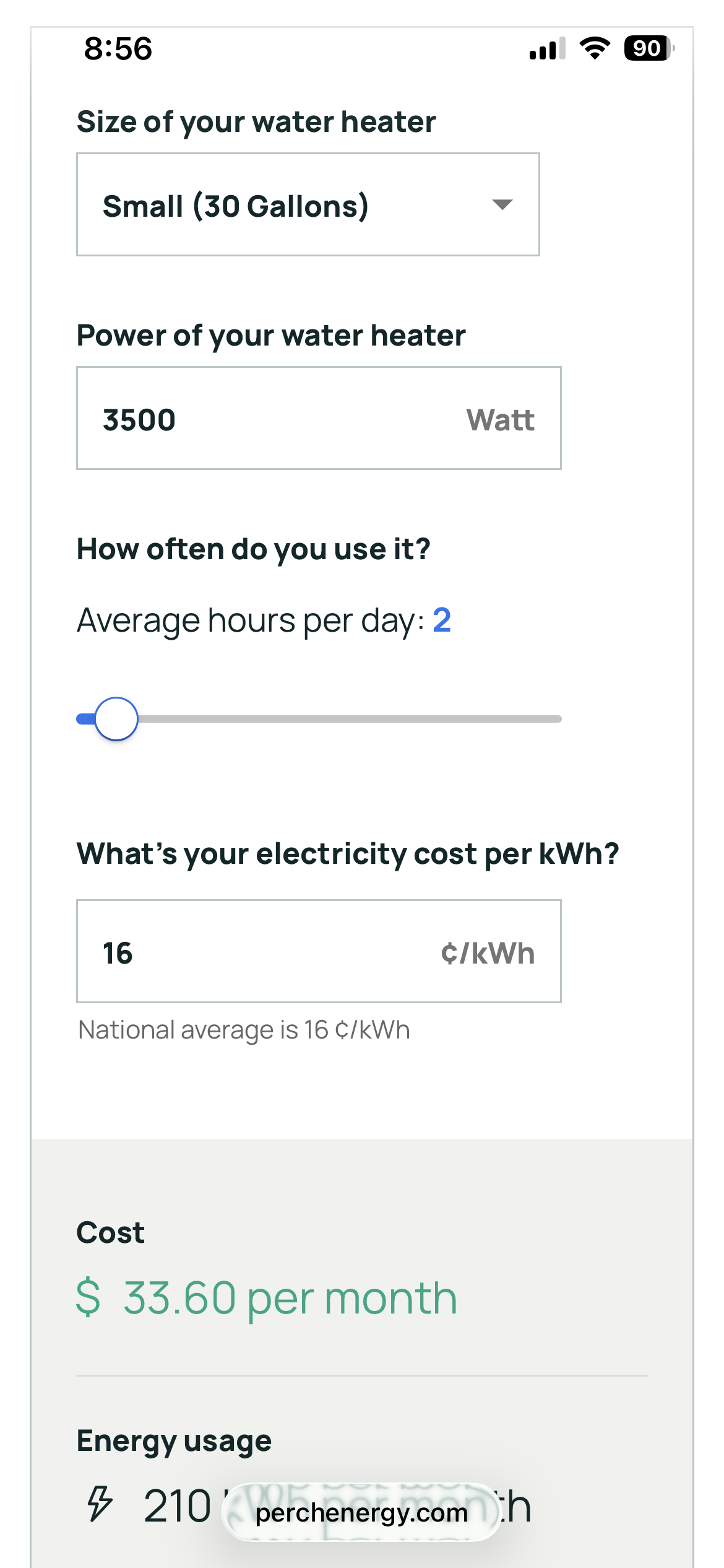

    electric water heater calculator
    It comes down to how much hot water you use a day
    https://www.perchenergy.com/energy-calculators/water-heater-electricity-usage-cost

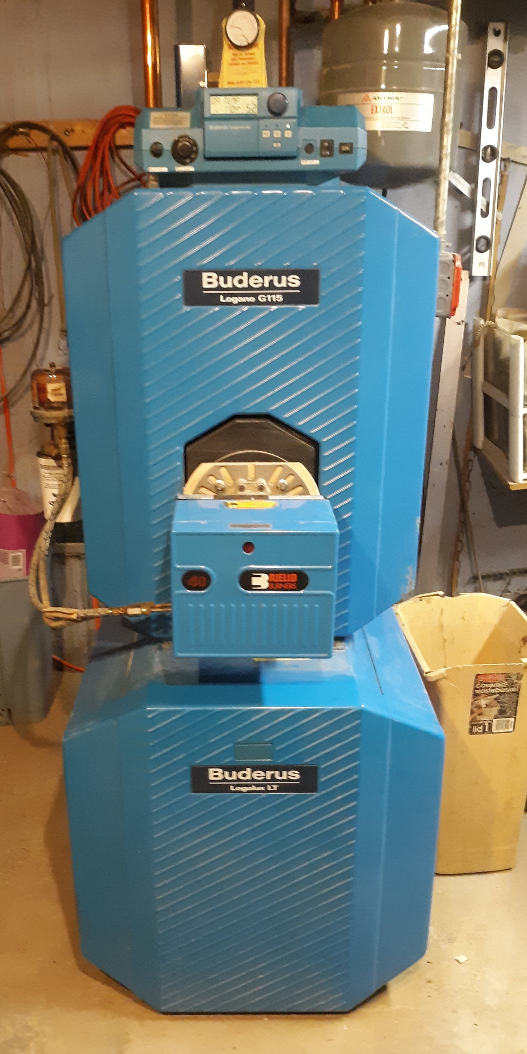

    @EdTheHeaterMan - I agree option 4 is looking like the best one. Re: "bad water feeder or a water heater that is passing"- Passing meaning causing water to flow into the system, be it the radiator distribution pipes and/or the hot water (faucet) pipes? And regarding not getting experience from the repair - true. I always ask questions, trying not to be a pain. The 'kid' (younger than my youngest) was good with explaining and answering my questions, but I could tell I should let him concentrate fully on his work. He was on the phone with the office, sending photos and videos.
    My concern now is - which is really causing the over pressure? The bottom hot water tank as shown in the photo? And I'm likely thinking too simply, but could some kind of check valve be installed to prevent it from flowing back to where it shouldn't? Or maybe that's not the case, but instead the pressure in the pipes (water supply and/or radiator) is high for another reason.
    As you can see I'm naive about this technology, but have always been interested in it which is why I signed up and read posts. I really appreciate the reply and information. Interesting that your signature 'After you make that expensive repair and you still have the same problem, What will you check next?', applies in my situation.

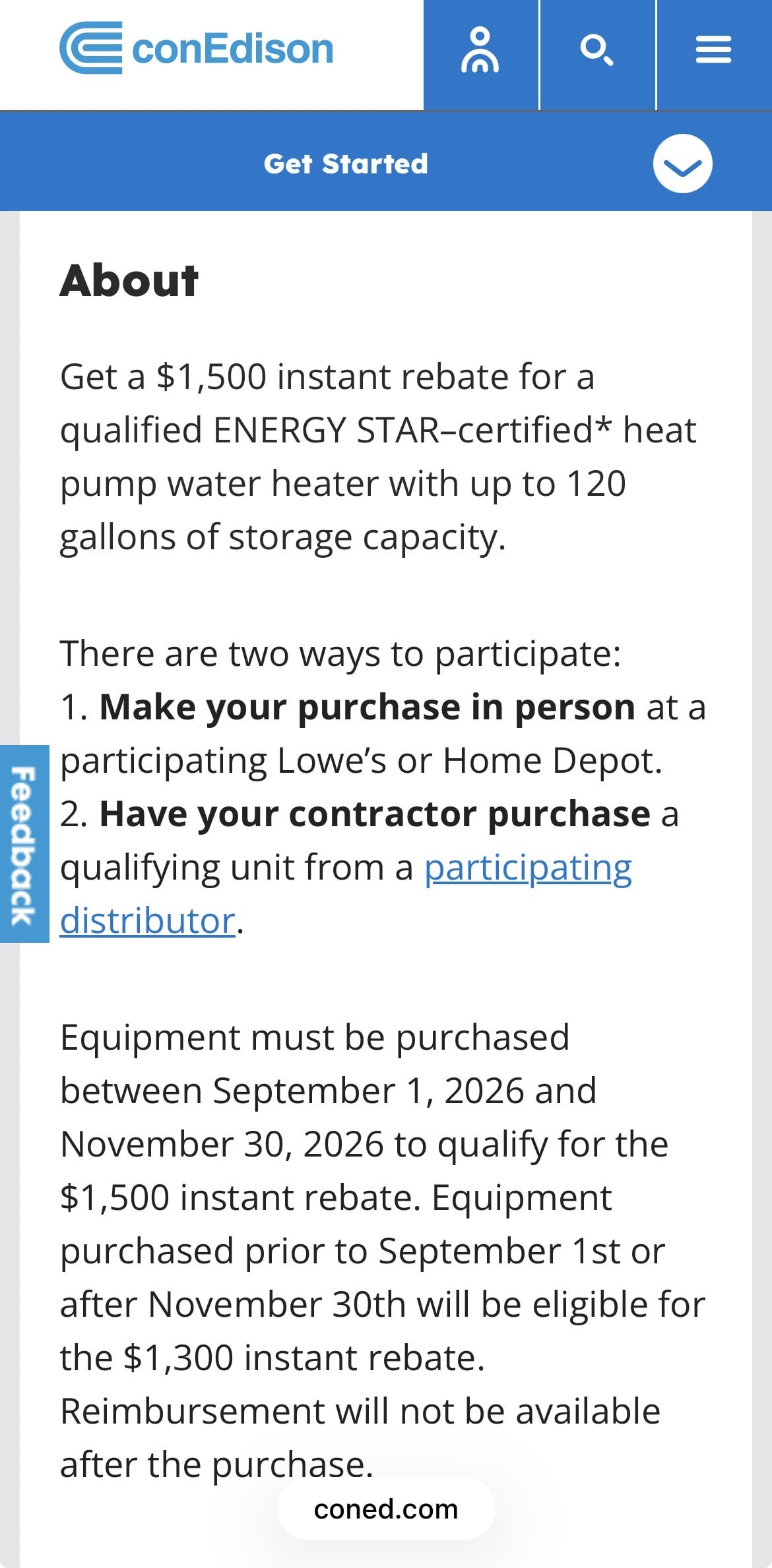

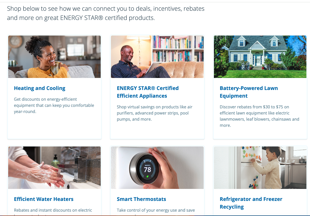

    Go to the Eversource website, click on your state ad it shows rebates. These show up for MA.
    Screenshot 2026-09-13 at 11.11.52 AM.png Screenshot 2026-09-13 at 11.12.02 AM.png

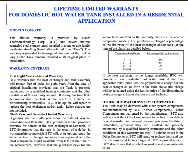

  • That is the indirect I had in my previous home. See if Bosch has any warranty left on that tank.
  • What is the model and serial number of your tank? I installed that same setup for a few customers. You may have warranty left.

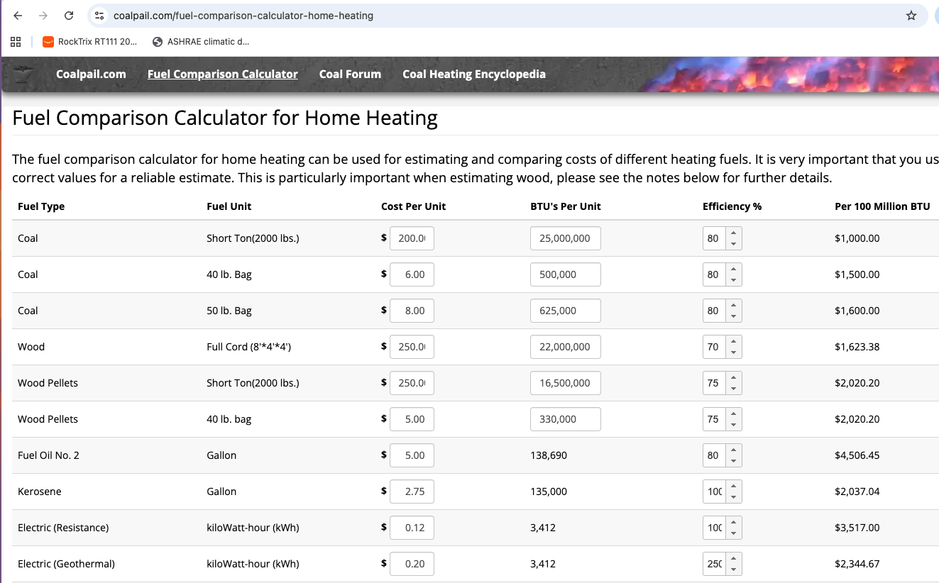

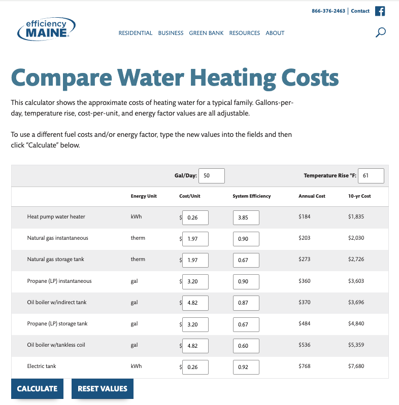

    Here is a fuel cost calculator
    Put oil at $5.00, electricity at .20
    Enter your own figures if you have them.
    10 million BTU/ yr for a small household 16% of the homes total energy
    , 20 million of more for family of 4, 24% of a homes energy.
    So maybe $900 for oil, $460 for HP per year?
    So an estimate of you hot water use and your actual delivered fuel costs, to narrow down on a number.
    If you use a lot of hot water, or large dump loads like tubs, then a HPWH may not be for you.
    Rebates can pay for the HPWH, so the installation costs. But price your options.

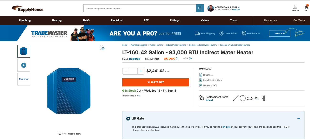

    I'm guessing 4 grand or more for one of those Buderus tanks now.

    Here is a tank by Buderus that has a lifetime warranty: Buderus Water Tank Warranty. Look for the model and serial number. Bosch is hoping that you dont ask for that warranty. Even if it is only a few hundred dollars, that is better than nothing and keeps you using a Bosch tank. You can leave that old tank there as a stand for your boiler and place the replacement tank next to the boiler. You will want to have records of your heating system tune up to satisfy the warranty requirements. (even if the maintenance does not specifically say anything about the tank). You were asking the professional to do the recommended maintenance. Done be to specific on details. "be dumb as a fox"

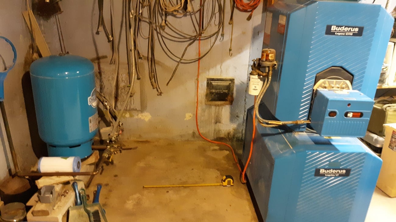

    @EdTheHeaterMan I'd need to find the model and serial number of my Buderus tank. It was installed in 2002 though, so likely no warranty remaining unless I was lucky enough to have the lifetime warranty, thanks for the link.
    And @hot_rod & @PatN thanks for the fuel comparison calculator. Just 2 of us here, not a lot of hot water usage so a HP may be somethng to consider. I returned to add this, wow - the heat pump is very efficient!
    My son's friend called be today who's in the business, we discussed the situation and some options. He suggested a 'hybrid' electric hot water heater, but after talking he was referring to a heat pump. That's what he has in his home. I guess the question is will being able to turn the furnace off for about 4 months make economic sense overall. That's where the calculator will be helpful. I'm also considering that we've had record heat it seems the last few years. but that doesn't necessarily mean the warm season is starting earlier and ending later. The HP he mentioned is about 22" in diameter. Shown on the floor is a a tape at 24", so it will be quite a close fit between the well system and the Buderus. And I suppose an indirect tank may even be wider.

    hot_rod Posts: 28,789
    There is bo question regarding opetating costs, and if oil prices keep rising…
    The only unknown is what your delivered Kwh costs are.
    50 gallons per day sounds reasonable for your use?
    This calculator shows up on a lot of uility websites.

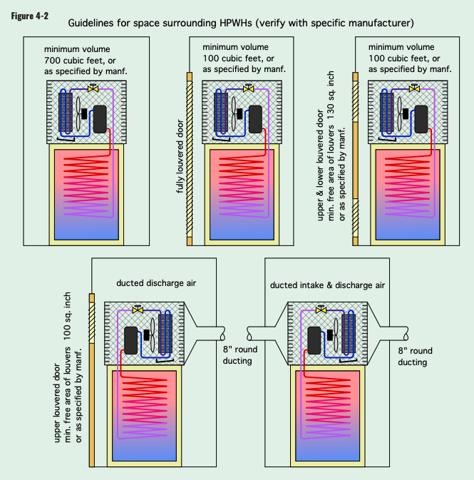

    It depends on the volume of the room where it is located. It is getting it's heat from the heated space above, either through the floor or open doors.
    This idronics explains the concepts in general terms, regardless of the brand.
    If the cold air is excessive they make vent kits to vent outside.
    In some cases air comes into the unit, and discharges out another duct.
    https://www.caleffi.com/sites/default/files/media/external-file/Idronics_33_NA_Heat%20Pump%20Water%20Heater%20Fundamentals.pdf

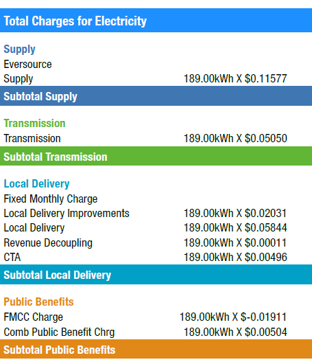

    As for electric rates, I'm not sure. Would it be the summary of these values? We're staring to get a small refund on the contoversial Public Benefits charge.

    I'm guessing 4 grand or more for a new indirect installed? But we can't discuss installed prices here, just materials.

    Waranty on your current tank is probably pro-rated. The tank is 24 years old?
    Screenshot 2026-09-14 at 8.07.21 PM.png Screenshot 2026-09-14 at 8.07.21 PM.png
  • That's the Buderus that I have! The quote for the HPHW from my heating co. was well over $4k. The guy (who will solely work in his business this January, does HVAC on the side now) will write up a quote as well. Spoke to my son who's an electrician about running the 240V to where the heater will be. He said "dad, you're not gonna pay me *&$% for labor" Oh yes I will !

  • Per the heating company and another heating/furnace pro - possibly a crack or hole in the heating coil(s).
    The way I understand it is my well system is pump on at 30psi, off at 50. The heating system should be around 25(?) so the higher pressure cold water supply is 'leaking' into the heating system.
    I didn't check it this morning, but what's been strange is in the last few days, including last night there has been minimal water in the bucket under the relief pipe, maybe an ounce or two and no dripping. The pressure appears to be around the same value when the pipe was dripping, I'll check this evening to try to get a psi number.
    Thanks - will send a PM.

    I'll admit I really can only guesstimate. and probably on the low side. We don't use a dishwasher, but I've heard they can be more efficient with water usage compared to washing by hand.
    For the last 2 weeks, the bucket under the overflow pipe has been totally dry. The pressure I believe has been staying around 25 lbs. I wonder if the suggestion about the gasket in the new relief valve was dry and needed several days to recover was valid? Anyway - the annual furnace cleaning is scheduled for this week. When I made the appointment quite a while ago, I asked that the anode be replaced, as it's probably a couple of years overdue. Now I don't know if that's a good choice given what happened and have been considering a hot water heat pump. I guess it would be worth the expense if I could get a few more years from the existing system.
