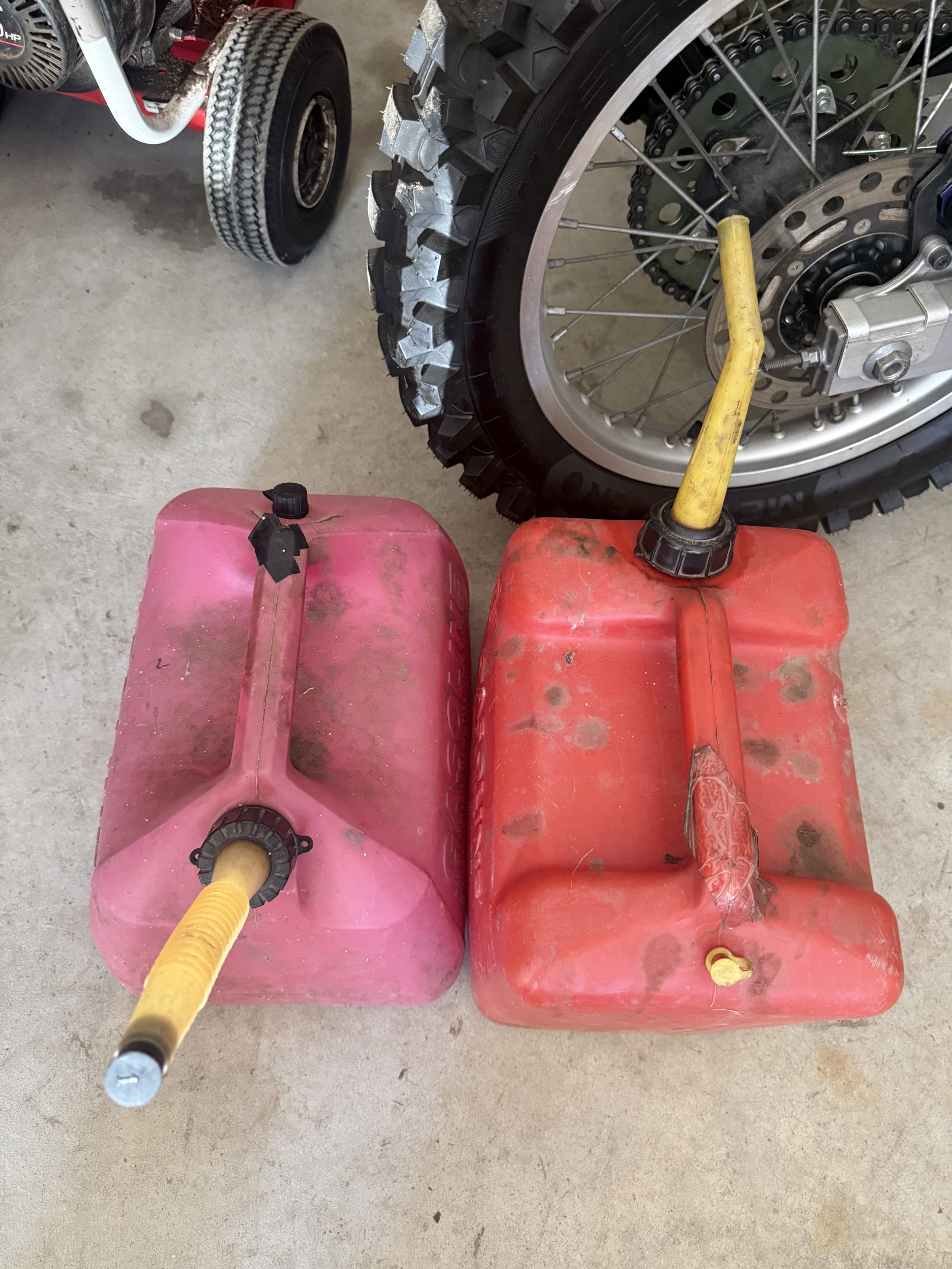

anyone have any tricks to keep the gas fumes from getting into the garage? Back in the old days, my grandfather had shotgun shells for this purpose, but no more around.
thanks for any tips

    Get new cans
    You know the new style that leak gas when trying to fill something.

    Usually you take the spouts off and reverse them so they point into the tank and then they have a blank plastic cap to cover the spout hole.

    At least those have spouts which are long enough. A lot of the newer ones have short spouts and fancy valve arrangements which don't work anyway, or at least not for long.
    I take the spouts off and store them and use solid screw on caps. And no, I don't remember when or where I got the caps…

  • As much as the mechanisms are terrible on new spouts and drive me bananas, I think it's time to replace those. The right one especially as that plastic looks sun bleached which means its going to be brittle and much more prone to breakage. On the left one you might be lucky enough to find a cork or rubber plug that conveniently fits into the spout (confirm rubber types! not all like Gas)

    Those slip on caps will pop off if the can warms up. Almost instantly when you put them in the sun.

    if you do some googling yo can find solid caps to screw on in place of the spouts. you can get replacement vent caps too although i think that snap in style always leaks a little.
    you can get the ventless type can and an aftermarket plain spout and solid cap for it, those will keep the gas fresh longer then the ones with the vent with a snap cap.

    Ed yes, that’s just how I transport them from the gas station

    i think some searching will find a cap for the screw on vent cap on the can on the right

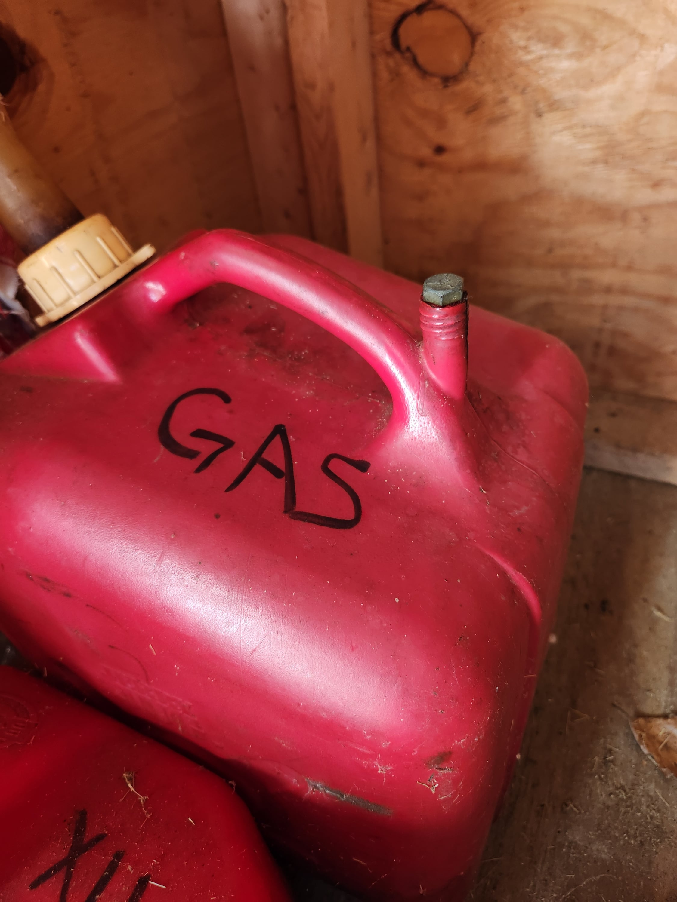

    The can on the left does not have a replacement spout that fits, so you can glue a cap on a short chunk of PVC to slide over the top or shave down a dowel/stick to fit inside. I have a 1 gallon can with a bolt wrapped in electrical tape plugging the spout that's been that way for 30 years. Maybe even an expandable rubber plug like is in a boat?
    The can on the right you can do the same or just go to any store that sells hardware or power sports type of stuff and get a replacement spout for like ten bucks.
    Or buy the new cans, immediately throw the spout away, and install a replacement. You have to drill a 1/2" hole in the back by the handle for a vent, but the spouts come with a barbed vent that you push into the hole. The cool part about these is they also make a big bore spout with about a 1" hole so you can empty it in about 30 seconds. I have several of these for diesel fuel as most diesel equipment has fuel fillers that are in a place where you don't want to hold up a 50 pound can for 4 minutes.

    I think the thread size would be a little difficult to ascertain

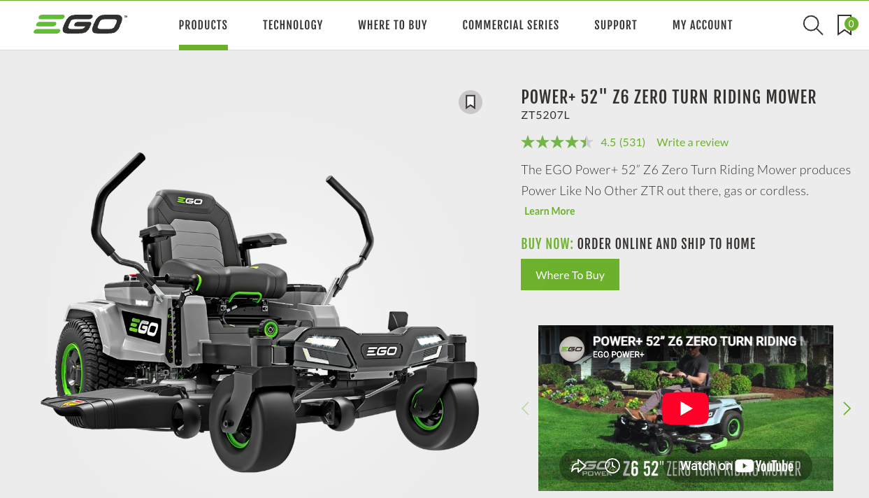

    Up to 4 acres per charge with these, charge it from your PV array!

    I was editing my comment when you put up that ad for the Ego zero turn. I do have an Ego push mower β€” and honestly love it. I've looked at zero turns, but they aren't well suited to our lawns (a tractor type is much better!), and I'd love an electric. Really, I would. But a) I can't afford it and b) the Simplicity is quite reliable, easily maintained, excellent parts availability when something wears out β€” and does an excellent job.

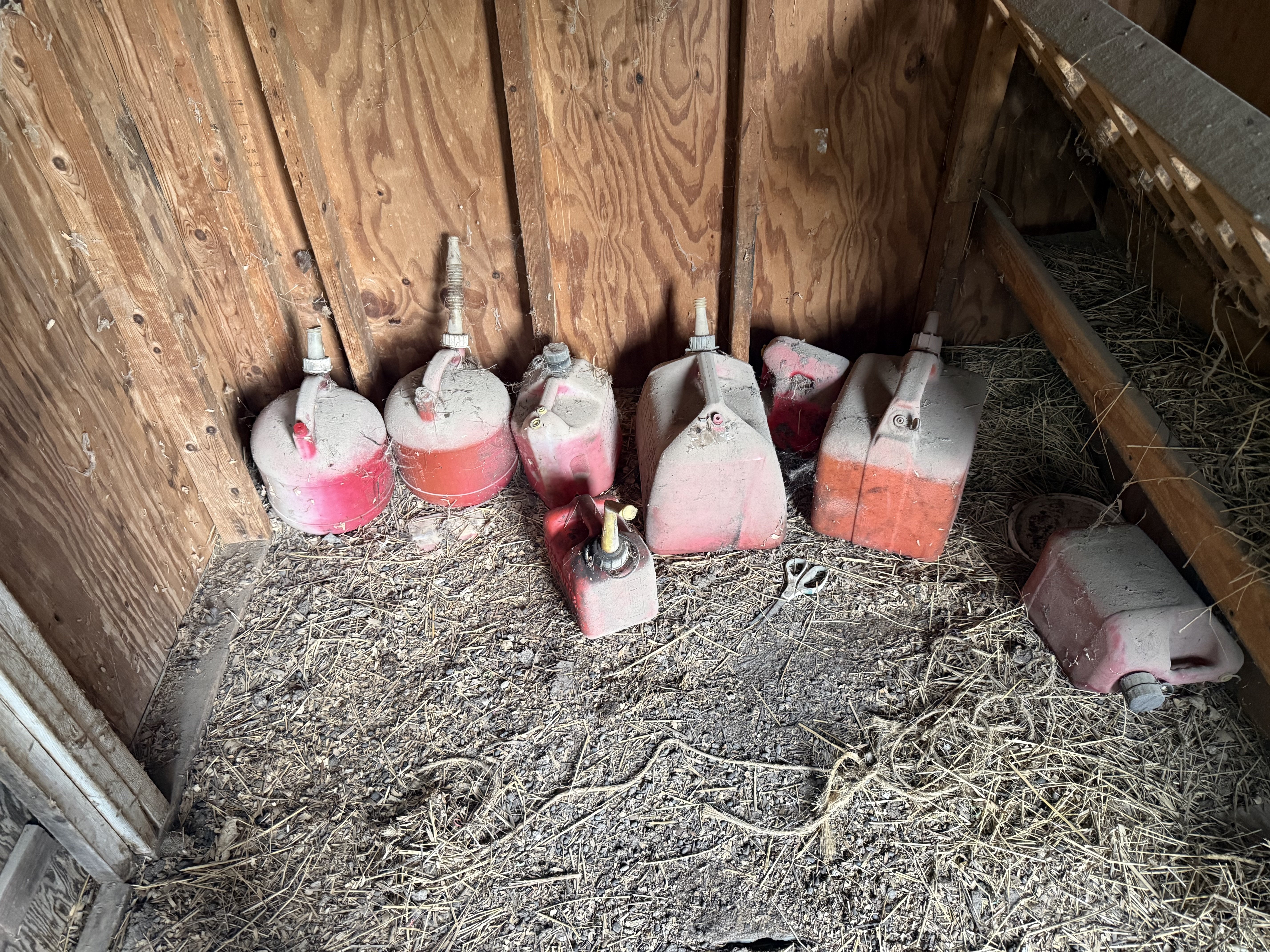

    more cans in the chicken shed $36.99 each, no low balling. IKWIG

    Am I the only one that can smell that picture?

  • Amazon has replacement spouts with a screw-on spout cap. Converted my cans, works well.

    I think we’re talking about different threads

    Amazon to the rescue

    The one on the left is a style my dad used to use all the time and I even bought a used one a while back. I think he's still got 4 on hand.
    But like with yours, they get faded, brittle etc.
    It's a shame. That style can with the flexible tube, cap and the vent on the back was extremely nice to use. You could have the tube down inside the can, or sticking out with the cap on the end. It was also affordable!
    So, we "improved" things and got rid of them.
    The Safety II can is better, but it's also heavier and what, 5, maybe 8 times the cost? It's not 5 times better, that's for sure I wouldn't even say 2 times.

    the can on the left is what i have had for about 25 years. it is rubbermade branded. the end of the vent cap broke off like 20 years ago and has had a piece of a plastic bag screwed under it
