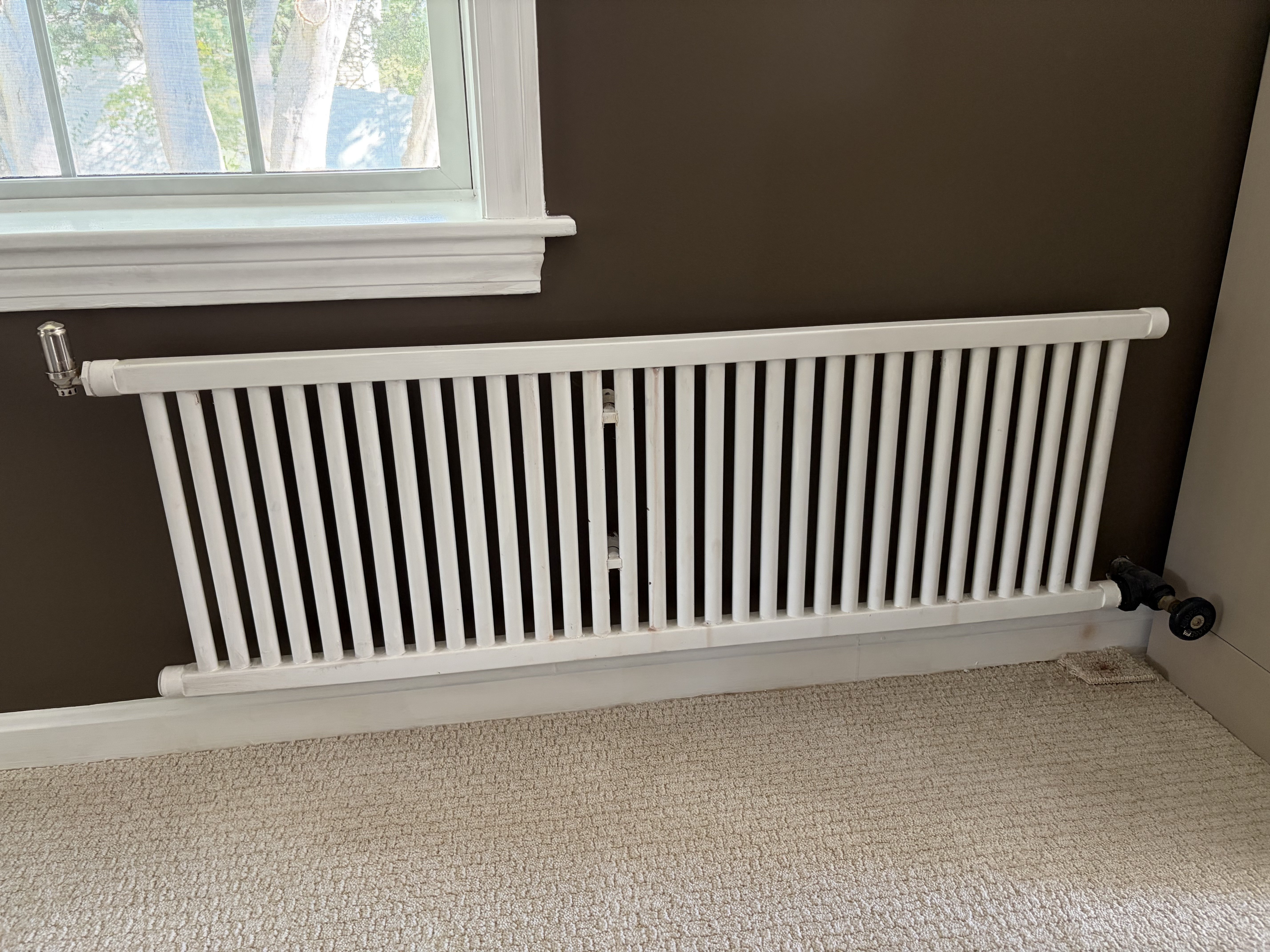

Hello - I have a very old home with steam radiators. I believe they are steam because they all have vents on the top left corner that let out steam periodically. The pipes inside the wall going to one of my radiators bang terribly just after we turn the system on or just after it calls for heat again. I don’t tend to notice the radiator itself shaking; it instead feels like the pipes inside the wall are going to bang their way out of the wall. It is terribly loud and scary and is in our nursery which is just awful. I don’t think the air vent is faulty because we had replaced them and I do see it lets steam out the same way the others do. Any tips on how to stop the banging?

    here is a pic of the radiator! We are located near Framingham, MA. Thank you for your help! It’s been hard trying to research and find anyone who knows anything about radiators.

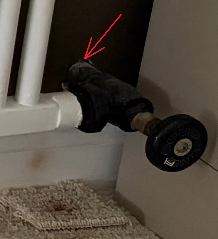

  • Also, I put a level on the radiator and it is ever so slightly leaning to the left, meaning it’s ever so slightly pitched away from the pipe coming out of the ground … which I think is bad? You will also see a stained extra piece of carpet below that pipe because it leaks water down there onto the carpet. I assume that’s bad too but do not know what to do or how to communicate to a repair person what I need to do to fix it
    OK — on that type of radiator, the vent needs to be exactly where you have it! Great! That's why pictures are important.
    Now the drip — is probably from the valve, and you might take a really close look. If it looks as though it's coming out on the stem with the handle on, that's easy (yeah, right) to fix — you will see that the stem goes through a fairly good sized nut which is threaded onto the valve body. That's called the packing nut, and if you can find a wrench which fits, try giving it a bit of a turn clockwise and see it that helps.
    And the radiator does need to be sloped wo that the valve end is lowest — I'd say at least a half inch lower than the other end. Depending on how it's hung on the wall, you may be able to raise the end with the vent on it enough.
    Make sure that that valve is all the way open!
    All that may help with the banging — but I wouldn't count on it. For top quality steam service, though, try @New England SteamWorks .
    @New England SteamWorks as @Jamie Hall mentioned or @Charlie from wmass . they both are usually busy so you may have to wait.
    Are the other radiators in the system also that type or has only that radiator been replaced? That type of radiator will be more sensitive to pitch than conventional cast iron radiators because of its lower mass and smaller passages.

    @mcmurphynora Mentions here that the radiator is back-pitched. He may be able to lift/pitch the radiator toward the valve so that condensate can drain properly. I would do that before opening the walls.

    Here is what I see. Depending where the puddled water is that is causing the hammering the radiator pitch could be improved and/or the radiator as a whole may need to be raised to improve the pitch of the supply pipes.

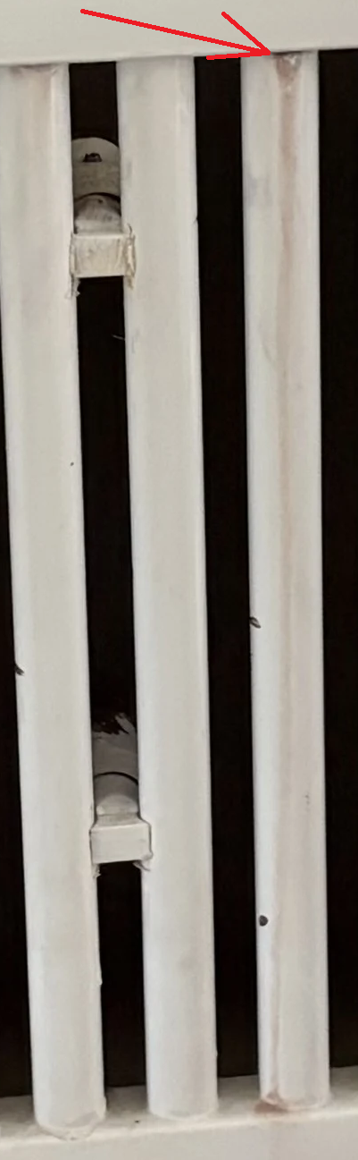

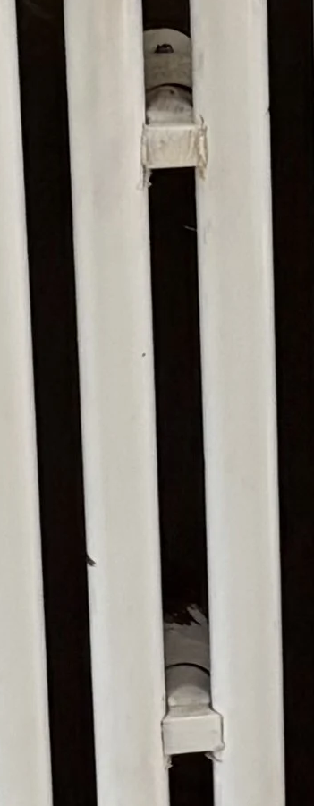

    These mounting clamps will need to be dealt with.
    The wall may have to be modified to lift the supply pipe.
    Is this radiator leaking ???
    edited September 10
    or if those hangers are sagging you could just wedge something under the far end of it. It is much lighter than a CI radiator but it still probably weighs 100#-200#
    i bet those hangers are supposed to be installed at 2 different points horizontally in the top 1/3 of the radiator so but someone didn't read the instructions. There is a lot of rotational force on the hangers where they are now.
    ethicalpaul Posts: 9,076
    I agree with you leveling should at least be tried and that is a weird radiator. However, my rather extreme experiments with backwards pitch of a radiator resulted in no hammer, so the walls or basement might still be required to look at
    dabrakeman
    That radiator will act a lot different than a cast iron radiator. It will be more like a convector or fin tube.
    Since the mass of the steel tubing is much less than a cast iron casting it will heat much faster so the steam will progress in to the radiator much faster, in a cast iron radiator having to heat the cast iron will make the steam progress slowly so it will be able to heat any water in the bottom of the radiator more gradually.
    That tube header at the bottom is much smaller than the nipples between the sections of a cast iron radiator so the steam that is coming in faster also has less room to pass over the water in the bottom of the radiator without interacting with it or picking up a slug of the water when the steam collapses at the surface of the water causing hammer.
    Fixing the pitch and putting a slower vent on it may make the hammer go away if it still heats adequately with the slower vent.
