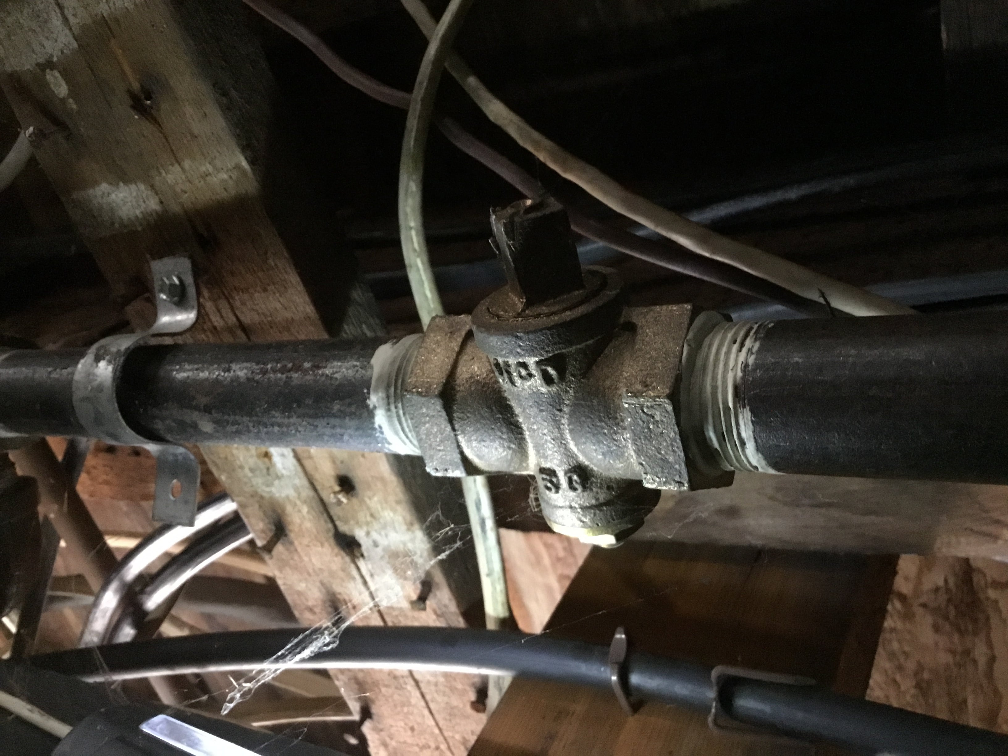

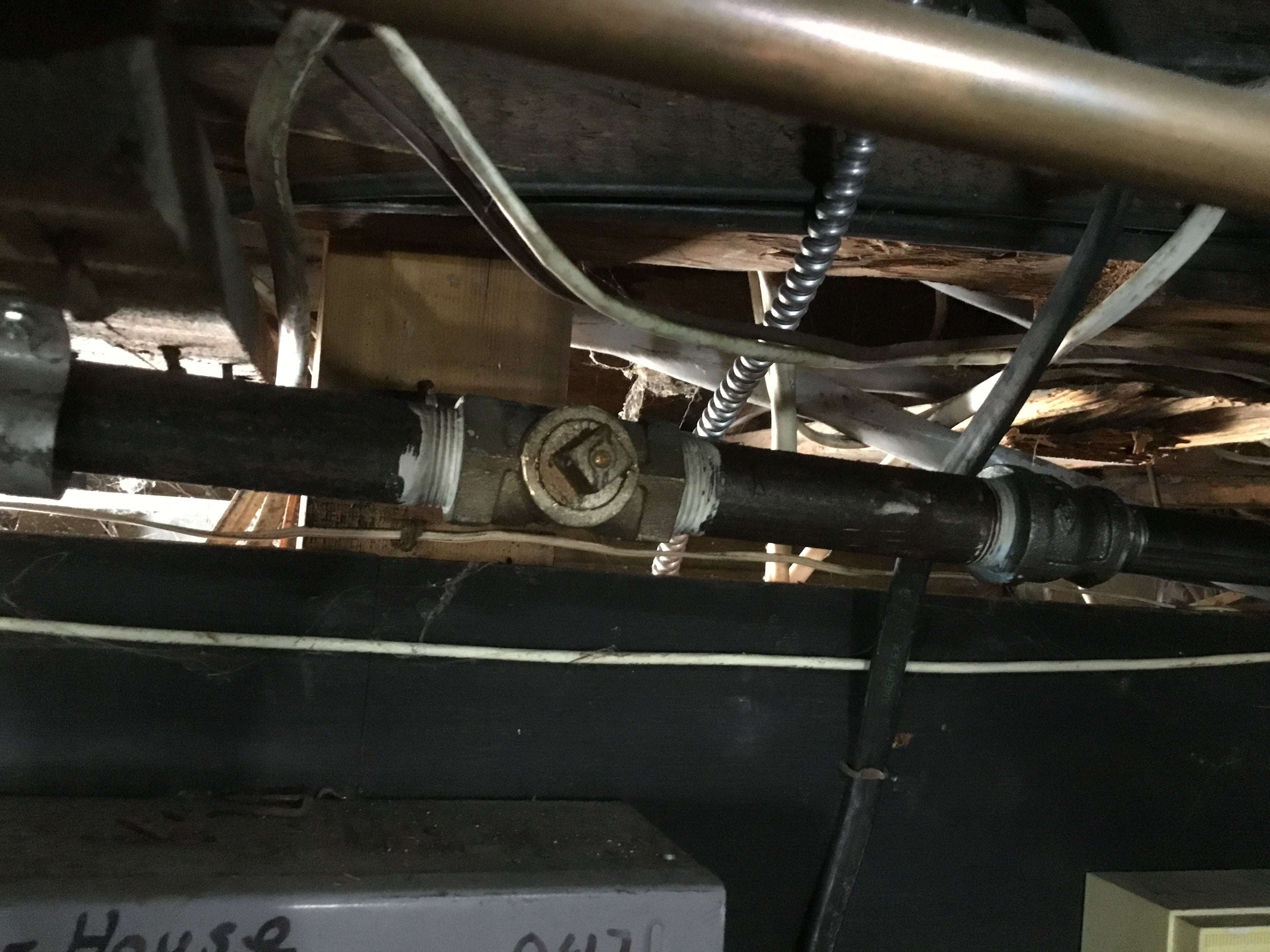

Living in a condo with shared basement access. We came back from vacation and found our gas oven/stovetop nonfunctional. Igniters for all burners and oven work fine, but no gas delivery and no gas smell. Water heater on same gas line, with a different shutoff, works fine.
Either my stove has broken such that no gas is being delivered to any burner (certainly possible there is a failed “range valve and regulator”) or someone shutoff the gas line to my stove. I can’t imagine that being the case, but maybe someone was doing electrical work (junction panels right below) and shutoff then didn’t turn back on?
Before we replace the stove, can someone check whether the pic showing the gas line (with what I assume to be a shutoff) is open or closed?

    It looks like there's a line on the head of the gas valve that's perpendicular to the pipe. Generally, that line should show the state of the valve, in line with the pipe = open, across (like what I see now) = closed.

    It looks off to me. The raised ridge/line on the square portion is perpendicular to the pipe. For on the line would be parallel to the piping.
    Are you sure that is for your stove? I would not turn it until being certain.

    valve looks like relatively new install and is definitely off. May have been recently added to allow the system to be isolated from basement.

    It is in the off position.
    Looks like a newish install.

    Thank you Andrew. For those interested, an upstairs neighbor responded that, yes, the gas company had come to change his meter last week and they were in the basement. Our gas lines are independent after going to the meter; the gas company changed my meter while I watched months ago without affecting any other unit. So the same should have happened when they changed his meter, but obviously they (the gas company) screwed up.
    The gas company came out and turned on the valve that I had identified, but had no interest in looking any further or explaining why this valve would have been closed or left closed in the first place. Nor did he or customer service explain why they didn’t inform us in text, email or mail that it had been done. “It’s working now” was his reply, clearly more interested in going to his next call.
