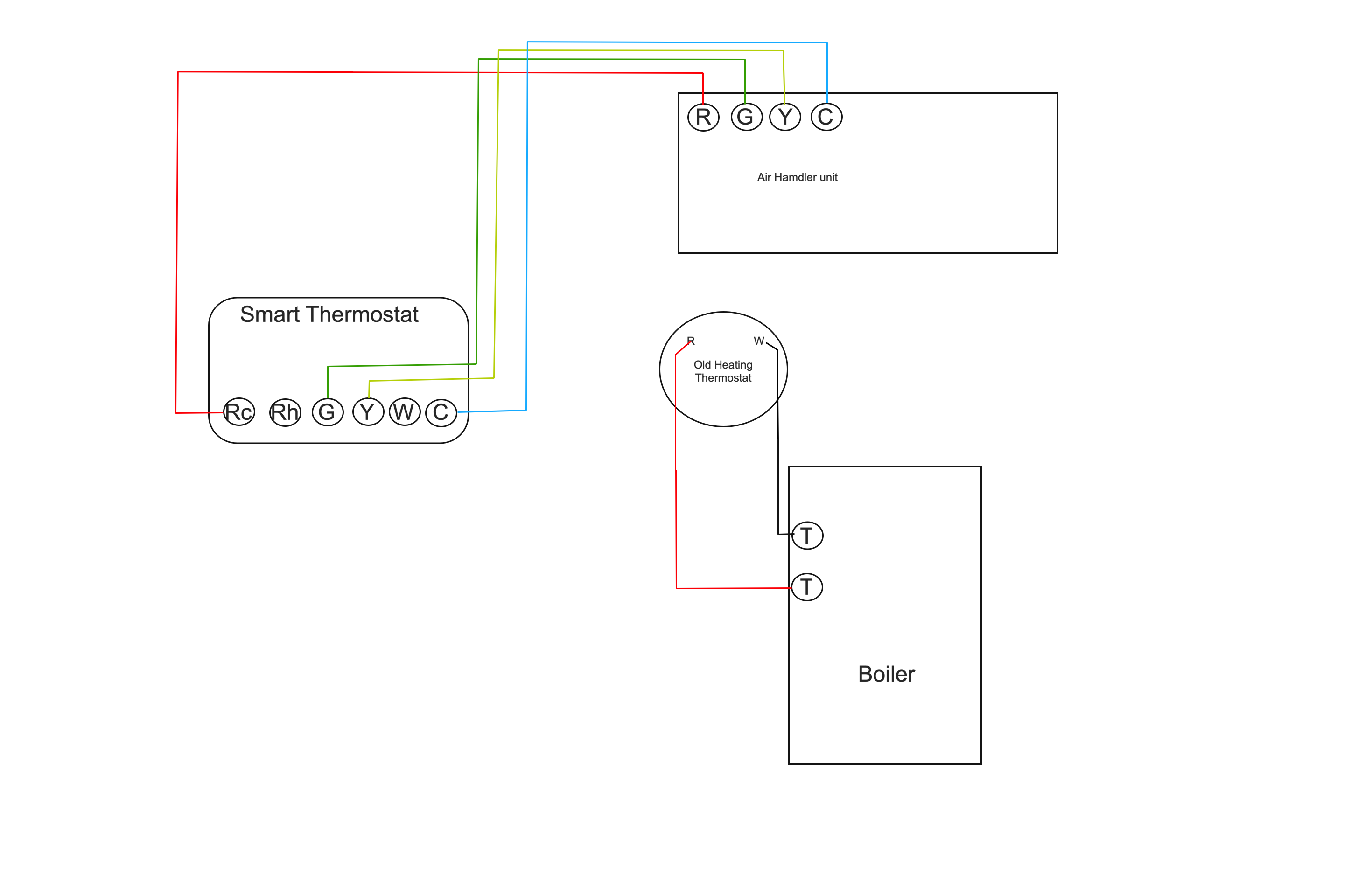

I am looking for a new smart Wi-Fi thermostat that I can use remotely when I am away from my home.
I live in a small 1200sqft ranch, one level, one zone, 1970’s house in Northeastern part of the country.
Currently my home setup has two separate thermostats: one for heating and one for central AC.
HEATING:  Weil-McLain Oil Burner with hot water baseboards.  This is a single zone system that is original to the house.  I have an old 7-day simple programmable thermostat for this.  It has no “yellow” wire and it runs on two AAA batteries.  Two wires going to the thermostat.
Central AC: Goodman Outside Unit installed couple of years ago.  Compressor is outside and Blower/evaporator is in my attic.  It is also single zone setup with air vents in ceiling.  It runs on a separate simple 7-day programmable thermostat that uses 2 AAA batteries.  This unit also has heat pump in it, but I do not intent to use it, so it does not need to be set up on my thermostat.  Only the cooling system.
I wonder if I could find a Wi-Fi smart thermostat that I could connect both systems to it instead of having two thermostats.
I like Honeywell due to the company reputation and simple no fee apps for Wi-Fi connection.  Would Honeywell RTH9600WF Smart Thermostat be able to do this task or do I need something else?  I am very handy with electrical projects so I don’t mind running any additional wires or redoing anything that would be needed.
Any suggestions would be appreciated!

    HEATING:  Weil-McLain Oil Burner with hot water baseboards.  This is a single zone system that is original to the house…
    Central AC: Goodman Outside Unit installed couple of years ago.  Compressor is outside and Blower/evaporator is in my attic…

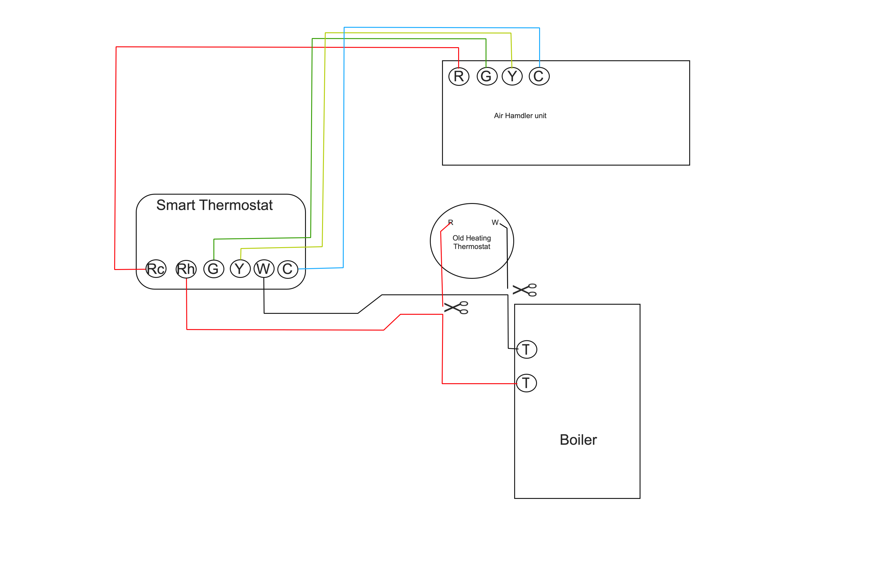

    @Jerry_Z this is usually very simple. how close are the two thermostats to each other?
    You connect any of the thermostats that include a R and Rh. or Rc and Rh to the air handler. this way Rc may be labeled R on some smart thermostats.
    Then test the AC system to see if it works with the new thermostat. After the test is successful then you add the wires to the boiler to the smart thermostat like this:
    Once that part is done, you can test the boiler operation from the new smart thermostat. This will work 90% of the time. If this does not work for you, then an isolation or heat relay may be needed to get your boiler to operate.
    The setup instructions for the thermostat will tell you how to program the thermostat for 2-transformer (air handler & oil burner control) operation. This is usually in the installer setup menu of the thermostat.

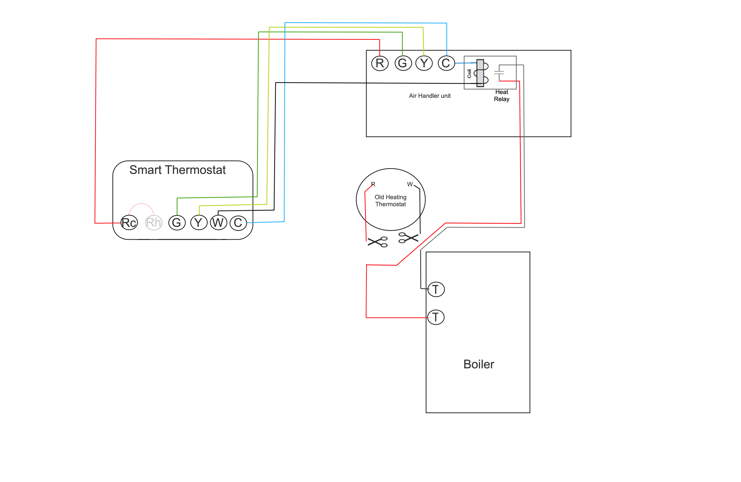

    I have liked Nest, but they can be problematic for some folks. Just ask @pecmsg . You cannot go wrong with the Resideo (formerly Honeywell) line of smart thermostats. I have also worked on Ecobee thermostats successfully. Just be sure you get one that has both R terminals.
    R for cooling is the transformer that operates the thermostat on most brands of thermostats. R for heating is just a switch for the boiler when configured properly, and the two transformers do not cross-connect when properly wired.
    The Honeywell RTH9600WF may no longer be available. That may be a Big Box store model number. If available, that should be a perfect choice. There are many 9000-series thermostats to choose from.

    The Rc and Rh terminals are made for the instances where there is a heating transformer and a cooling transformer. The Rh makes with the W terminal (or terminals, for multi stage) and the Rc makes with the Y's and G. Electrically, they're separate once the factory jumper is removed. Not all stats have this, but those that were designed back in the olden days when AC was an add on do.
    Most dual-transformer stats power themselves from the Rc transformer, meaning the C or common has to come from that transformer as well, but not all do so check the paperworks carefully.

    Only one R terminal at the thermostat? The two transformers shouldn't need to be "in phase". They shouldn't have anything to do with each other. You need an isolation heat relay at the air handler. Or a new thermostat with seperate Rc and Rh.
    EdTheHeaterMan Posts: 12,940
    This will not happen if you wire the thermostat correctly. If, however, you have a thermostat that has only one R wire terminal (there are some out there) then you need to add a heat relay to the air conditioning system. It is very simple.
    Then add a 2-wire connection from the AHU to the boiler to operate the boiler.
    When this design is used, the power to the AHU must remain on all year. This is important to know because, for some reason or another, some owners feel the need to kill the power to the air conditioning system at the end of the cooling season. This practice will render the thermostat without any power to operate the boiler. If it is a split system you can kill power to the outdoor unit but the AHU in the attic needs to be powered.
