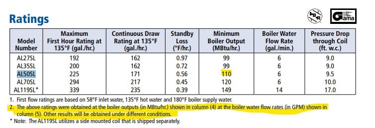

Per the Burnham spec sheet for the AL50SL, it states the minimum heat source should be 117,000 btu/hr. If I had a boiler installed to meet this I would be oversized by over 2X for what my heating load needs.

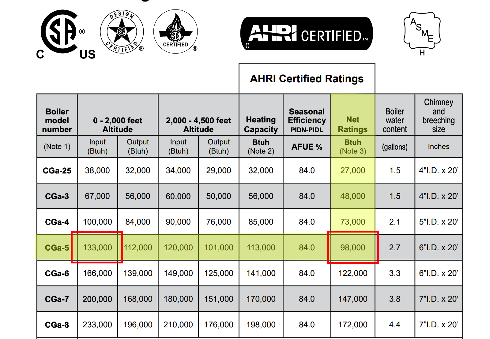

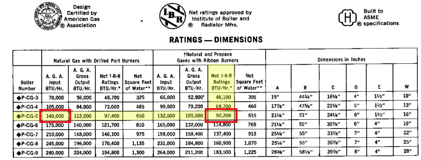

    There is validity to the “size to the DHW demand” idea in some cases. Your home only needs 50,000 BTU NET. That is not the boiler size.
    The boiler size is usually stated by the input rating, which is the amount of fuel the boiler uses every hour of operation. On a 140,000 BTU oil boiler, that might be about 1.00 gallon per hour. On a gas boiler, that would be approximately 136 to 141 cubic feet per hour, depending on the chemical makeup and heating value of the natural gas.
    After you burn that gas or oil, most of the heat goes into the water in the boiler, and the rest is lost through the vent pipe. That determines the output of the boiler.
    Then there will be some additional heat loss through the piping between the boiler and the radiators. That is called the piping and pickup loss. On steam systems, the standard allowance is 30%. On hot-water radiator systems, the standard allowance is 15%.
    After those allowances are deducted, you arrive at the AHRI NET rating. On older equipment, this was called the I=B=R NET rating.
    Now, those fixed percentages are not necessarily the actual piping and pickup losses in every house. They are more of a standardized, somewhat worst-case allowance. Many homes will have actual piping and pickup losses below those percentages, but these are the standardized numbers used when sizing a boiler from a heat-loss calculation.
    Here is an example showing the AHRI NET rating and the older I=B=R NET rating.
    NEW Equipment
    Older Equipment:

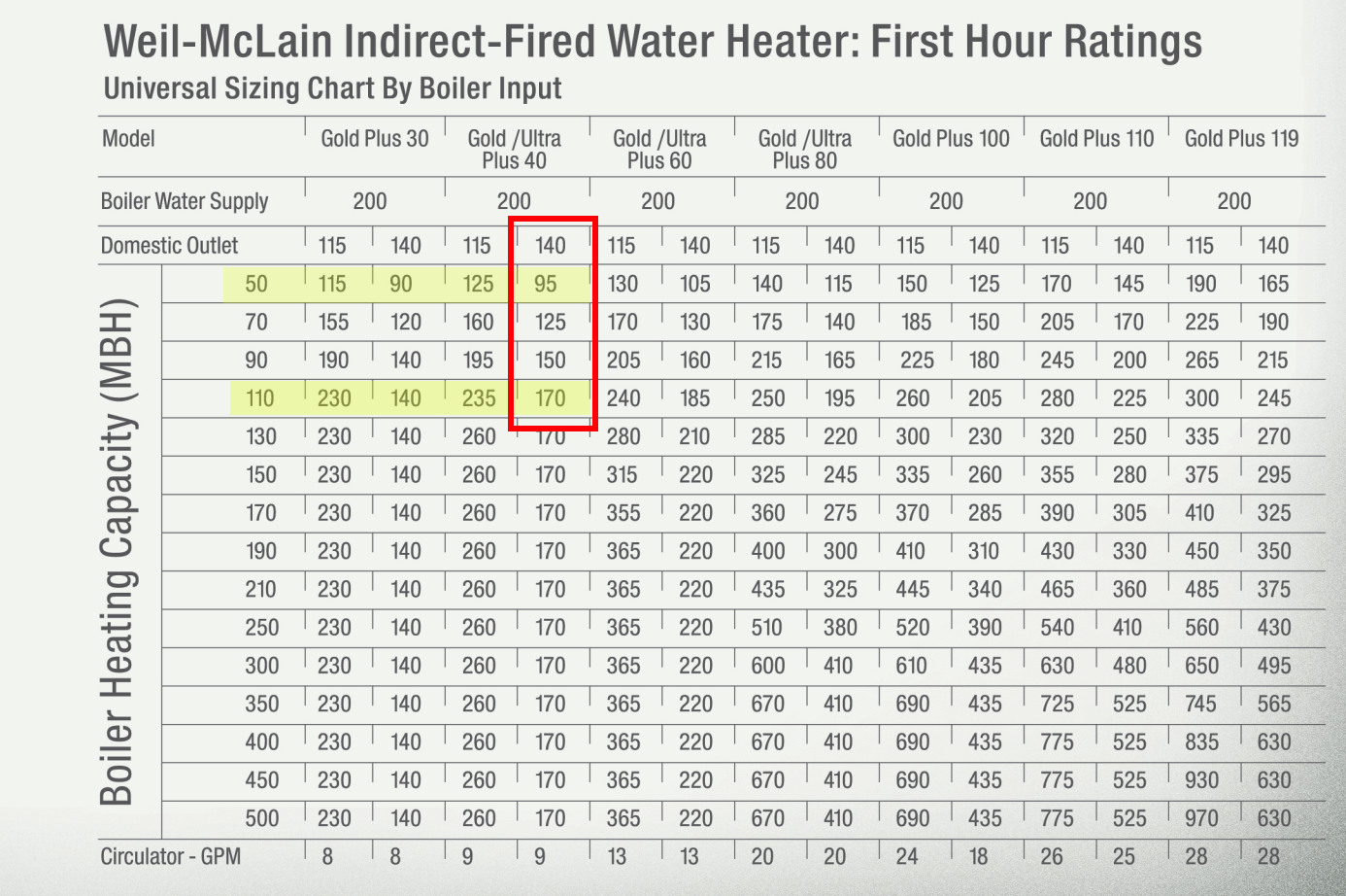

    Now, here is where the difference with an indirect water heater comes in. If you use a smaller boiler with only 49,000 to 50,000 BTU of NET output, the indirect water heater will not operate at its full rated capacity.
    If you select a larger boiler with a higher NET output, the indirect can receive more heat from the boiler. That allows it to recover faster and produce more hot water in a given amount of time.
    That difference is shown on this chart:
    See how the same water heater provides less hot water when connected to the smaller boiler? With the larger boiler, the water heater can produce up to a 170-gallon First Hour Rating. But the tank itself also has a limit. Once you reach that limit, installing an even larger boiler will not increase the rating beyond 170 gallons.
    But do you really need that extra capacity? Maybe not.
    I grew up in a house with a 30-gallon gas water heater and a 30,000 BTU burner. There were six of us—Mom, Dad, and four kids—and I rarely remember running out of hot water. With a 50,000 BTU NET boiler and a 40-gallon indirect tank, you would already have more hot-water capacity than we had.
    If you want to use the 40-gallon indirect to its full rated capacity, then you may need a boiler larger than your home actually requires for heating. Personally, I don't think that is necessary. A reasonable compromise may be to choose the boiler size in between.
    Just remember: once you select the boiler size, you cannot easily increase its output later. If you eventually discover that you truly need more hot-water capacity, increasing the boiler size would usually mean replacing the boiler.

    GGross Posts: 2,104
    an indirect does not really have a minimum requirement (unless burnham does something weird!). your DHW usage and requirements dictate the required BTU/hr delivered to the indirect. That all being said most of what the 3rd party told you is true. not sure why they randomly added 40% though! in my experience, when done correctly, manual J is already applying a safety factor.
    checking your Burnham the wording is just strange, they do not actually require a minimum boiler output, that's just to meet the ratings shown on that sheet. so no they aren't doing anything weird, you still calculate your space heating needs, and your DHW needs, and size the boiler on the largest of the 2.
