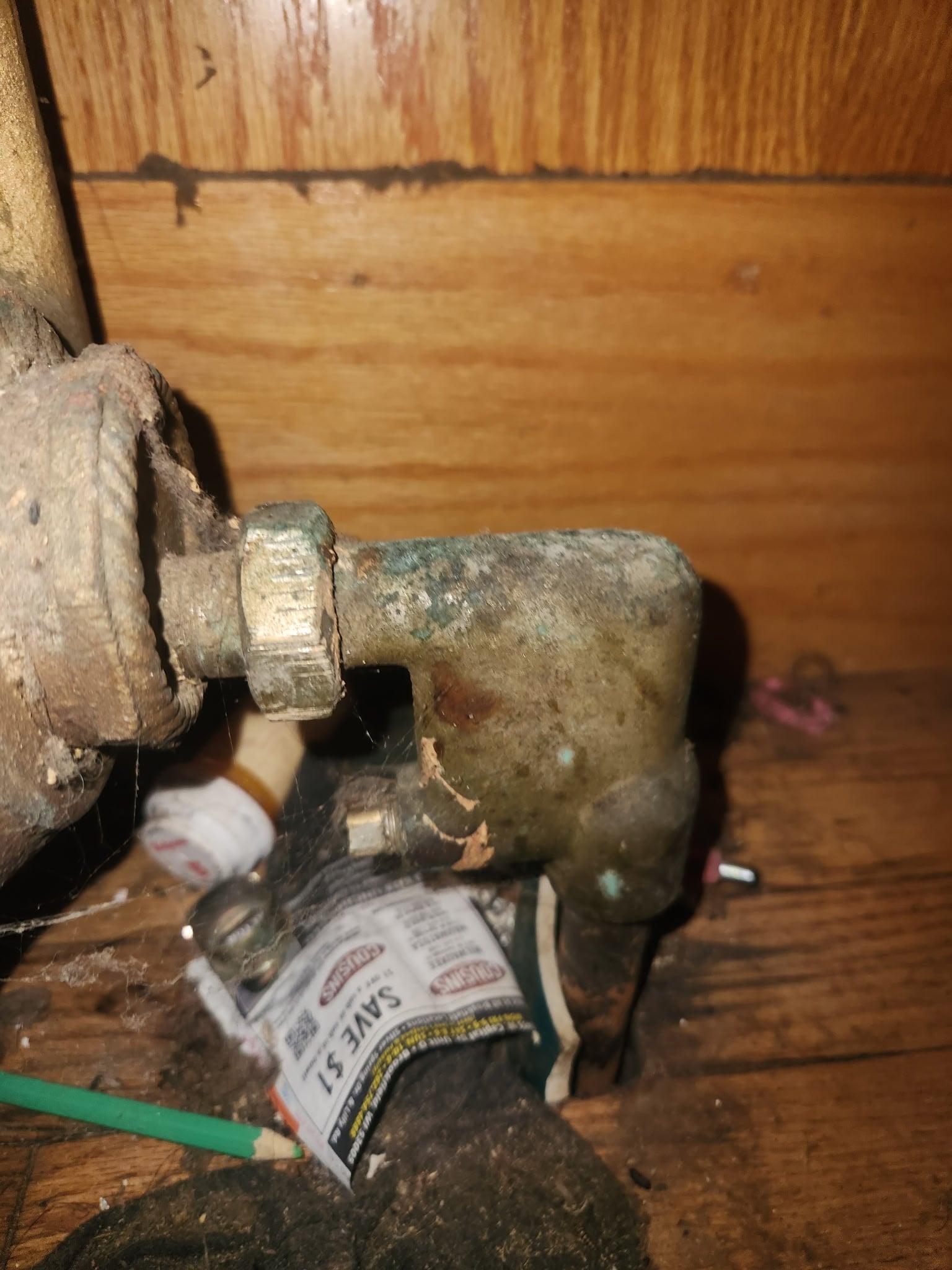

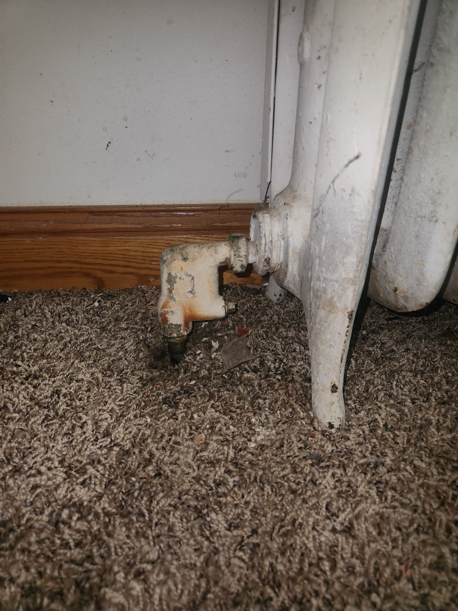

Curious to what this functions as? I'm assuming it's some type of steam trap based on the two pipe radiators .. but I have never seen one of these so I have to ask you guys.
This is the oddest system , was in foreclosure and anything in the basement that was copper was gutted..
Steam boiler
Each radiator has two pipes going to them.
Main vent on each return
Not a steam trap in sight...
One radiator was piped in as if it was a hot water radiator with a bleeder at the top..
But I'm curious to what these are on every radiator on the lower portion return side
Thank you in advance

    it is a return fitting proprietary to one of the vapor systems. you have a vapor system. some others will know which vapor system without digging through "The Lost Art of Steam Heating".
    your radiators have special metering valves that in combination with controlling the pressure at the boiler limit the amount of steam admitted to the radiator to less than the amount of steam that the radiator can condense so no steam makes it to that return fitting.
    if there is a bleeder on the radiators and knuckleheading in the basement then someone might have tried to convert it to hot water.

    And you don't absolutely have to have the specialized inlet valves - just keep the pressure down (8 OUNCES per square inch or less).
    And you may actually be in luck — if someone did you the favour of removing all the copper in the basement, which you have had to remove yourself and which was most likely kludged anyway, you can replace the piping correctly and have a wonderful quiet heating system!
    Mail4tommo
    Look on the "trap" or the supply valve for a name that would be a clue.
    Also, look around the boiler for a boiler return trap

    @mattmia2 , you're right, it's some sort of water seal. I don't recognize the brand though.
    @Mail4tommo , we have some detective work here. I don't see any maker's info on those water seals. Are any of the original radiator shutoffs still there? If so can you find any name on them and post some pics?
    Also, do the main vents look original?

    I remember a system with something like that in Atlantic City NJ. that might be a VECO trap. There are no moving parts inside. Just a water trap and a hole drilled into it where that plug is located on the bottom

    Not a VECO, but the same idea.

    a lot of times there will be a little check ball inserted through that plug but it could just be a cleanout for the water seal too. if any of the specialties near the boiler are still there those could help identify it too. many vapor systems need to vent only at one specific place in the system if all of the original parts are still in place.

    That plugged hole is there so someone can drill the small (1/8" or smaller) hole in the internal trap. The plug is there to cover up the hole they made to drill the other hole. It is a machining necessity for drilling the hole and inspecting it if the device fails.
    This is what I remember: »»»
    So, I’m not an expert on this particular vapor system, but as I remember the explanation of how that trap worked, it was an extremely simple device that depended on maintaining the proper operating pressure.
    At the correct pressure, enough condensate remained in the trap to form a water seal. That water seal prevented steam from leaving the radiator and entering the return piping. If the system pressure became too high, however, the steam could blow through or displace that water seal, allowing steam to enter the returns.
    The very small hole in the trap—perhaps 1/8 inch or smaller—allowed condensate to drain into the return at a controlled rate. The opening was small enough that, under normal operating conditions, condensate could pass without allowing any significant amount of steam to follow it. As condensate continued to form in the radiator, it would gradually drain through the trap and into the return, and the system would operate as intended.
    Once the firing rate dropped and the heating cycle effectively ended, the remaining condensate could continue draining through that small opening. That also allowed the radiator and return side of the system to equalize so air could move properly when steam was introduced again.
    You also have to remember that these systems were originally designed around hand-fired coal boilers. They did not operate with the definite on-and-off cycles we associate with modern burners. The fire was maintained continuously and adjusted according to the weather—less coal and a smaller fire on warmer days, and more coal with a stronger fire on colder days.
    That is part of the elegance of those old vapor systems. The trap had essentially no moving parts. As long as the orifice remained clear and the system was operated at the pressure it was designed for, there was very little inside the trap to wear out. In theory, it could last almost indefinitely.

    vapor systems keep the boiler pressure under about 8 oz/in^2 and have a metering device on the inlet to the radiator that acts as an orifice to regulate the steam that is admitted to the radiator to less than what the radiator can condense. this means that the steam is all condensed by the time it gets to the outlet so the return fitting never sees steam.
    if the vapor valve is missing you can use an orifice plate in the union of a standard valve or you can still get metering radiator valves in its place but you must have some metering device.
    the radiator vents through the return like any other 2 pipe system
    the mains will be dripped in to a wet return to allow the condensate from the mains to drain
    the mains either are vented in to the returns through crossover traps or have main vents.
    if there is a boiler return trap/differential loop or similar specialty the mains need to be vented with crossover traps and the only vent in the system needs to be on the return near that device.
    the returns also need a vent because tat is where the radiators vent.
    returns that were intended to be below the water line to provide a water seal between various parts need to remain below the water line with the current/new boiler. modern boilers frequently have much lower water lines than the original coal boiler did.

    Milwaukee was home to Sterling and O-E. That doesn't look like an O-E return ell though……………
