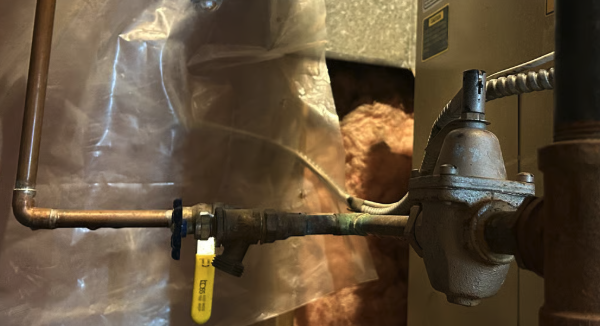

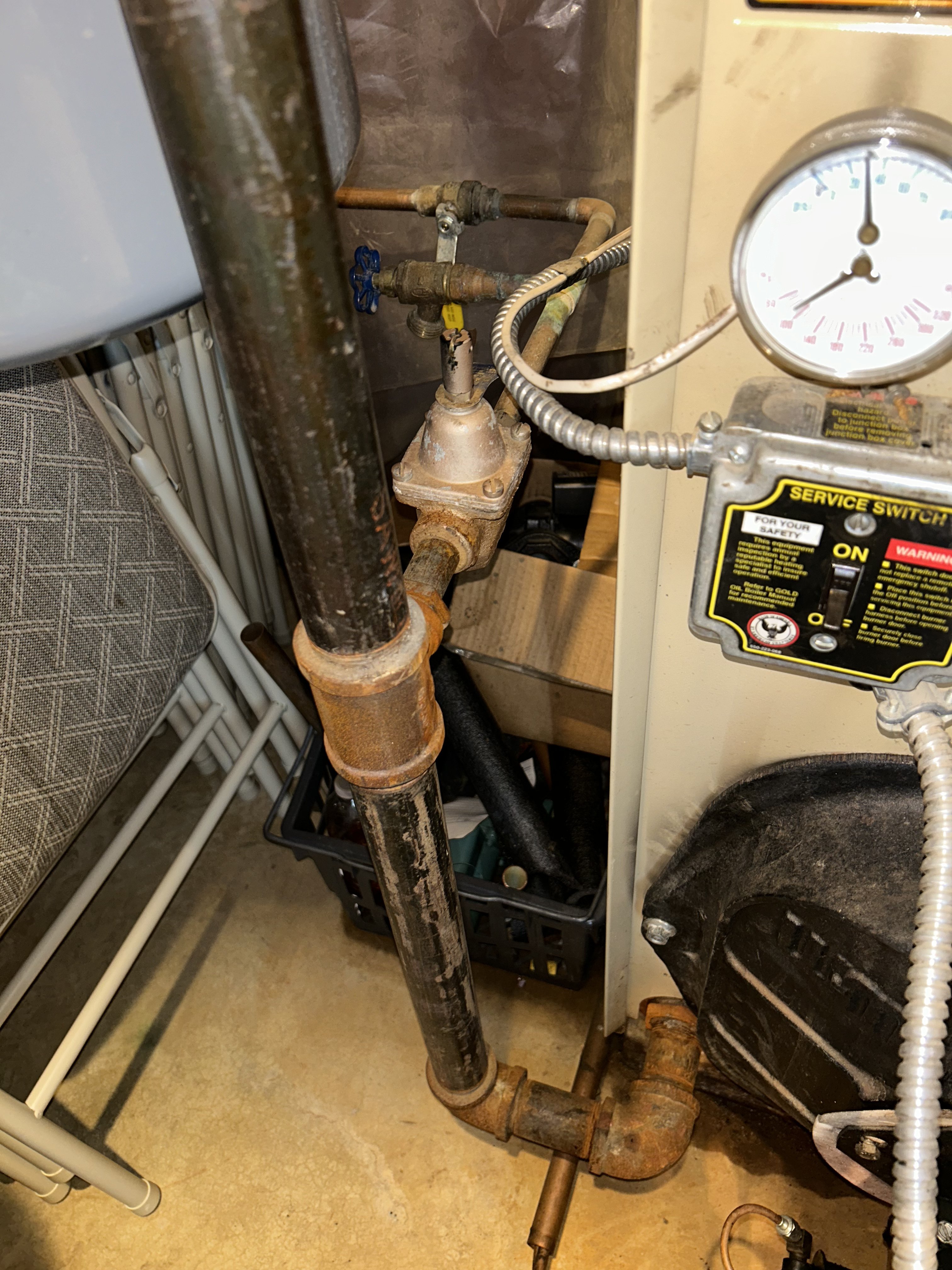

Boiler heats our water. 30 PSI Pressure release on the top back of until opened and stayed in the open position. I shut boiler off, turned off water supply and flipped the valve. Valve continued to dribble after it was flipped. I watched the gauge rise to 30psi and the valve did its job and released a shot of water and valved closed on it own, but still dribbling. This repeated a few times. So the valve is doing it's job. What could be causing the excess psi?
Expansion tank was changed a year ago
Thanks for any insight you might have.

    1. Fill valve not seating. Valve off fill and see if it happens again.
    2. If you have a domestic coil, domestic coil leaking. Valve off coil and see if it happens again.
    3. And/or air in system. After ruling out/fixing 1 or 2, purge air from system.
    And while you have the system down, replace the relief valve and install it in the proper orientation.

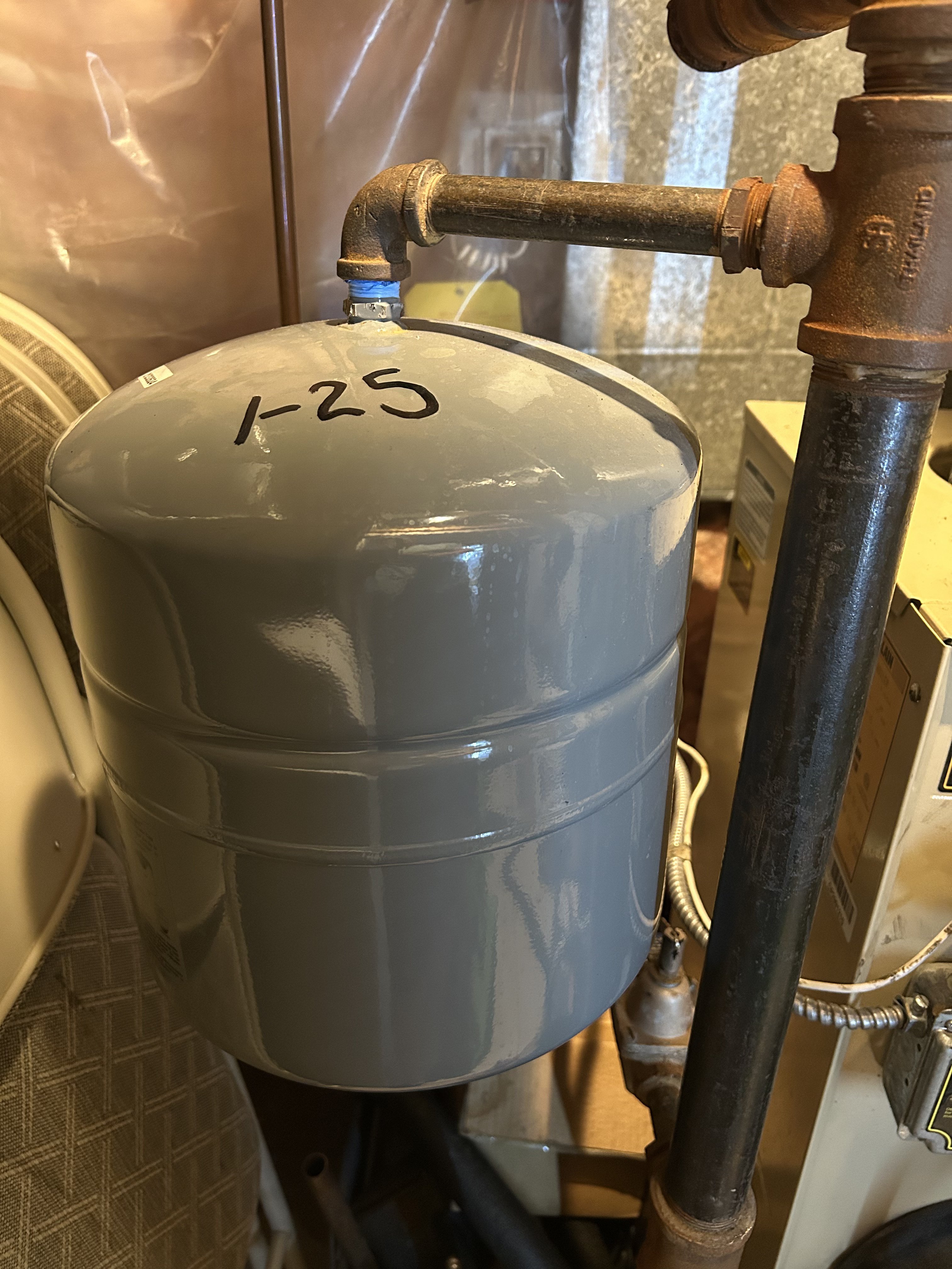

    Sounds like a bad expansion tank. System pressure should not rise above 12 to 18 psi if tank setup and operating properly.
    Take pressure off the expansion tanks and check the psi.

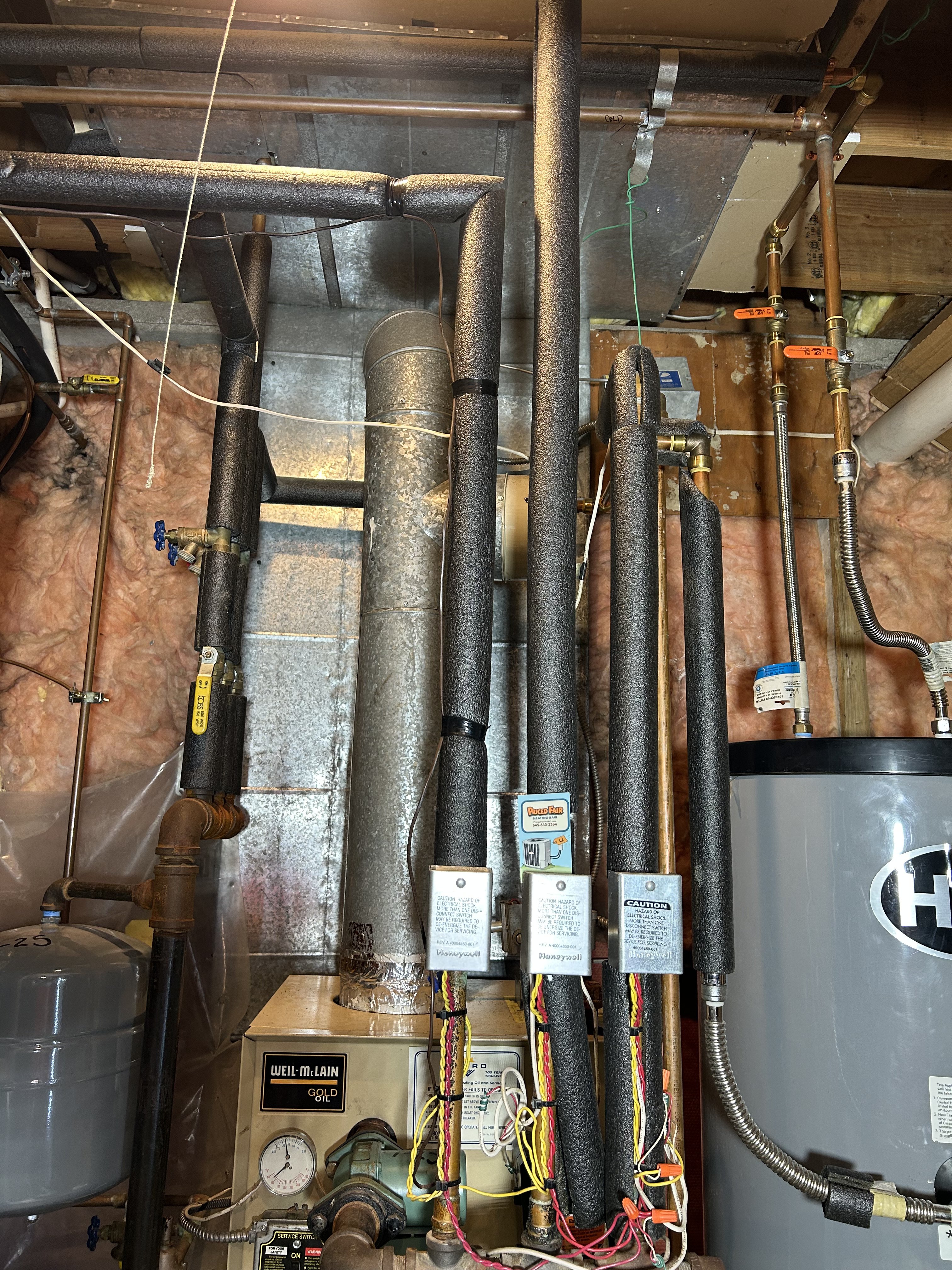

    post a couple pictures of the boiler and the expansion tank, please.

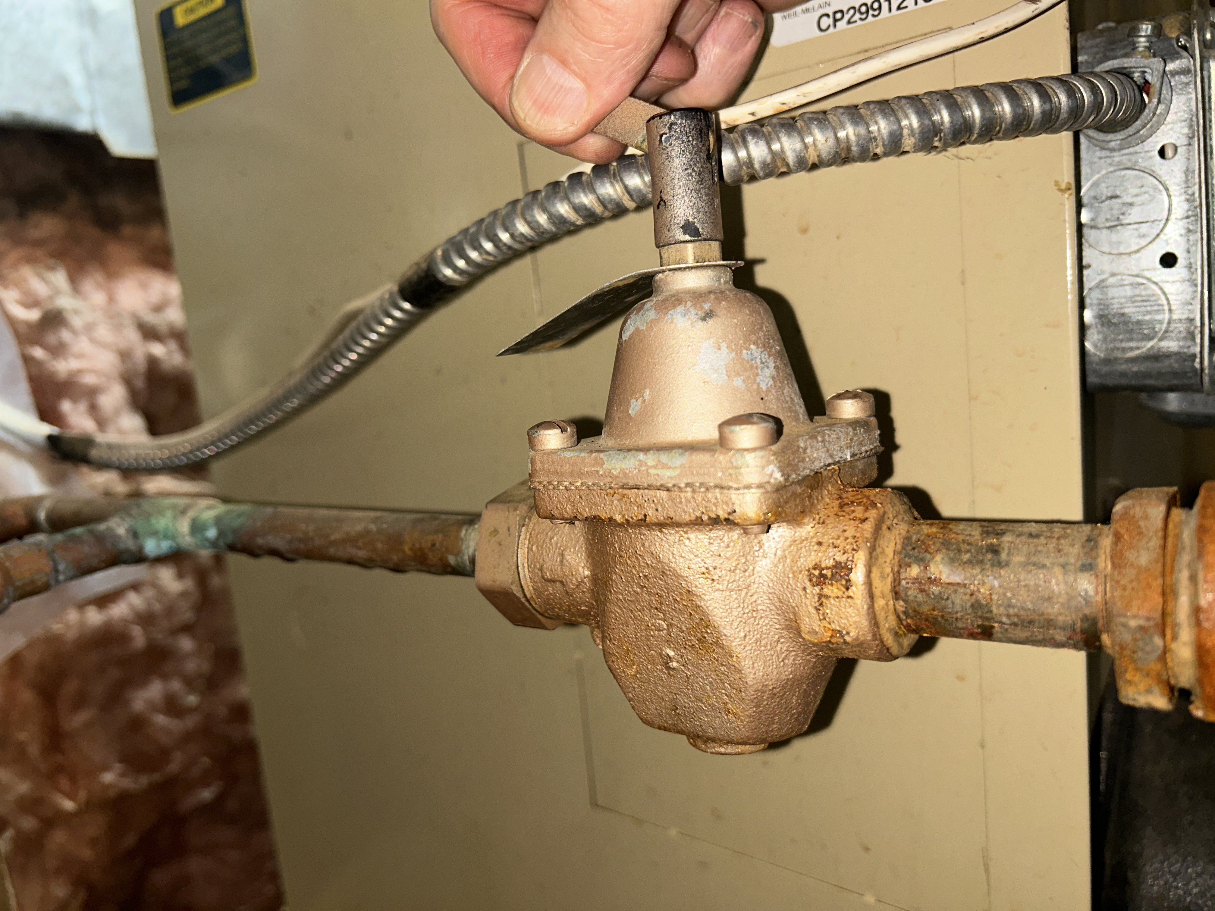

    The pressure reducing valve seemed a bit hard to pull up on the lever. But maybe I'm over thinking how much force is required. It is original (1996) so at 30 years it may be faulty

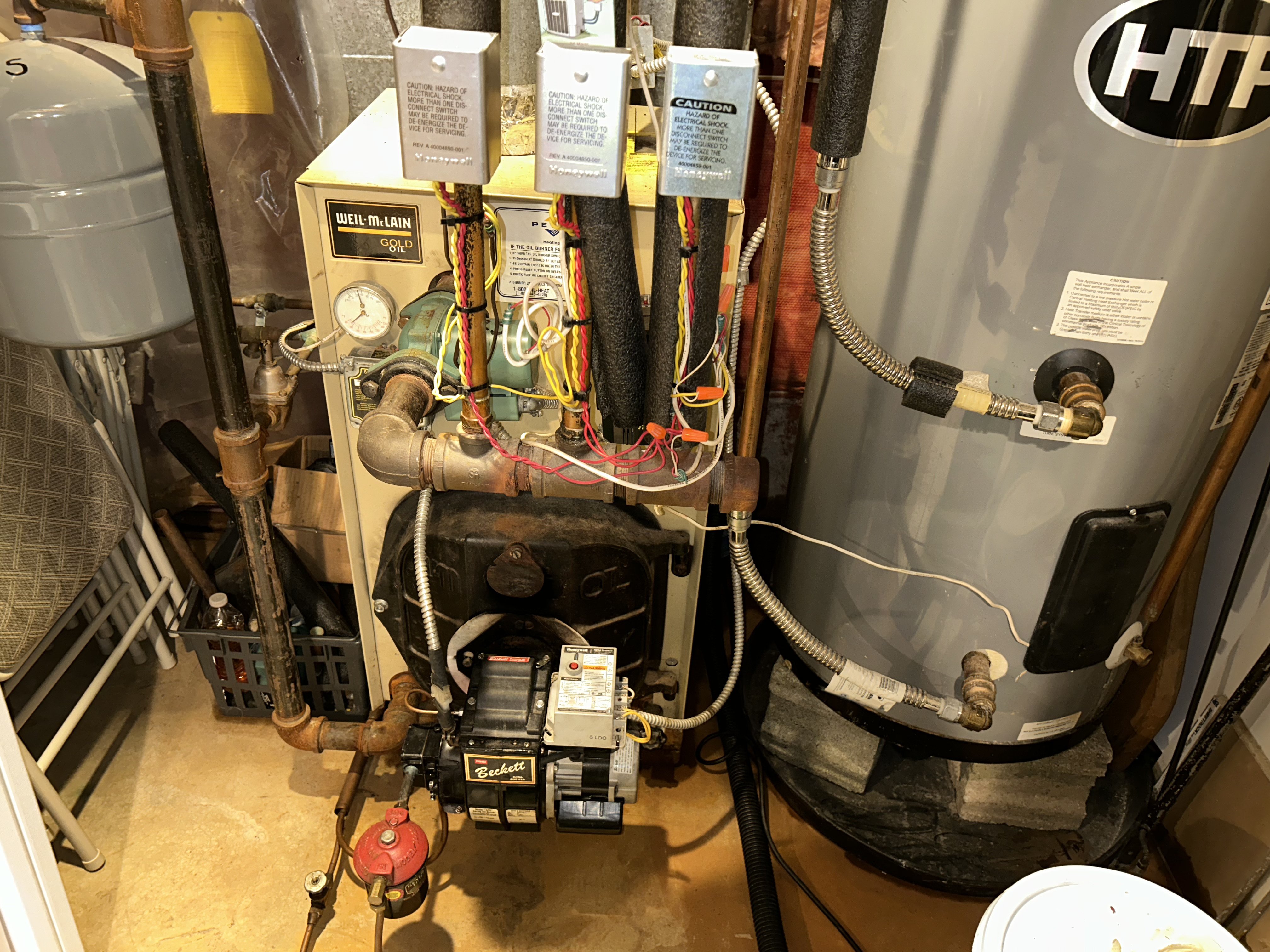

    tmtruett Posts: 50
    Air came out of tank valve.

    The PRV is from 1995. I don't see a tankless coil. That's a Series 1 WGO. Is there an indirect water heater? You can set cold pressure, then shut off the feed valve and wait a day to see if pressure rises. A relief valve not seating properly needs to be replaced.
    If the problem is the PRV, have fun spinning it off. The knucklehead installers piped it so close to the boiler. Maybe Watts makes the same model and you can rebuild it.

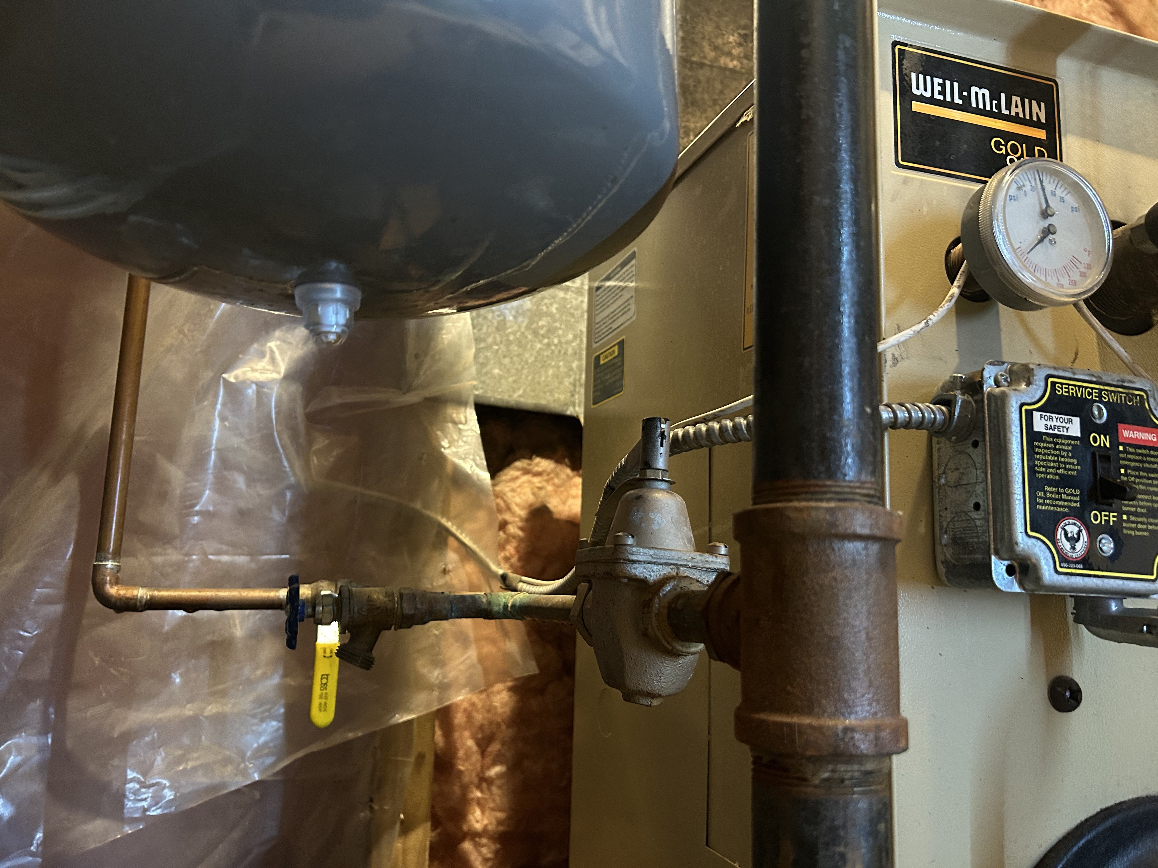

    Good air is coming out a valve, but you need to test with no pressure on boiler. Since there’s no way to isolate that expansion tank to take pressure off, I think you’ll have to drain down the system before checking psi on the tank.
    once you’ve got it drained down, do yourself a favor and add a isolation valve with drain above the tank.

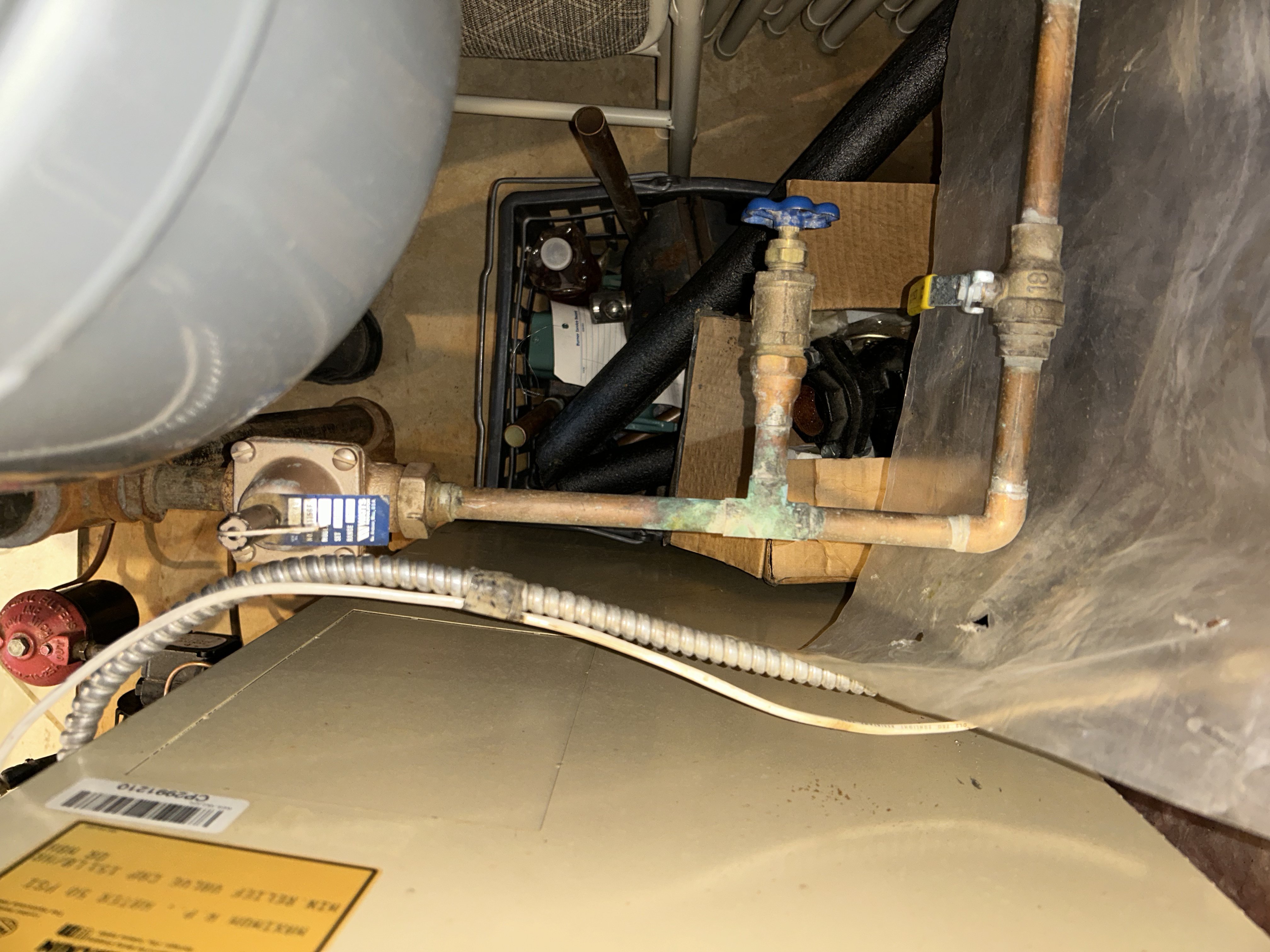

    can you post a picture from feet back? I’d like to see if there’s any isolation valves above the boiler.
    hot_rod Posts: 28,776
    Is there a shut off before the fill valve?
    This yellow handle looks to be a bypass around the prv for fast fill/ purge?
    If there is another valve before the fill, turn it off, bleed down pressure. Then you can run the system.
    Plenty of systems run with the fill valve turned off. All the time.
    If pressure continues to rise and the expansion tank is not waterlogged, it may be the indirect leaking into the coil.

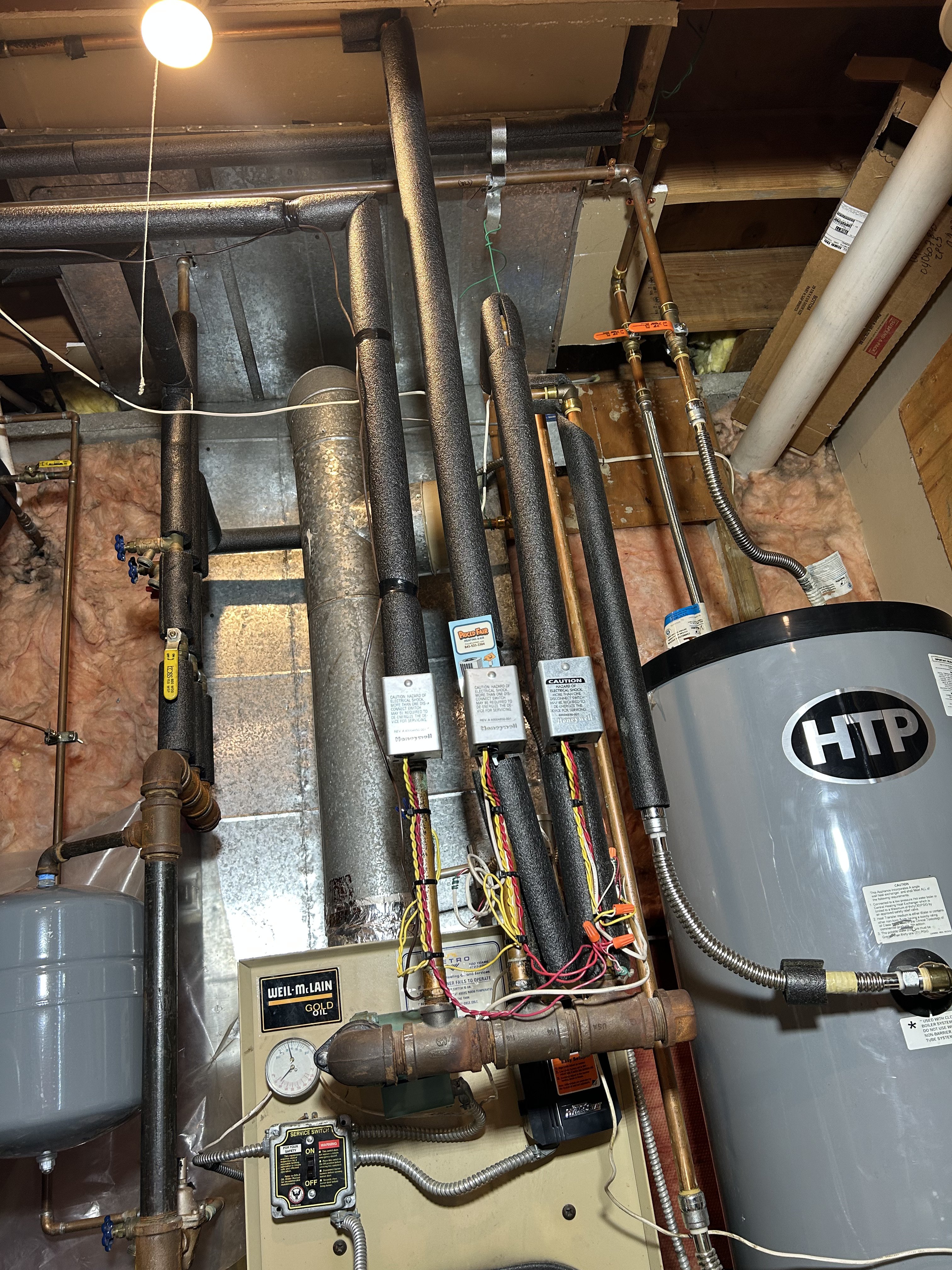

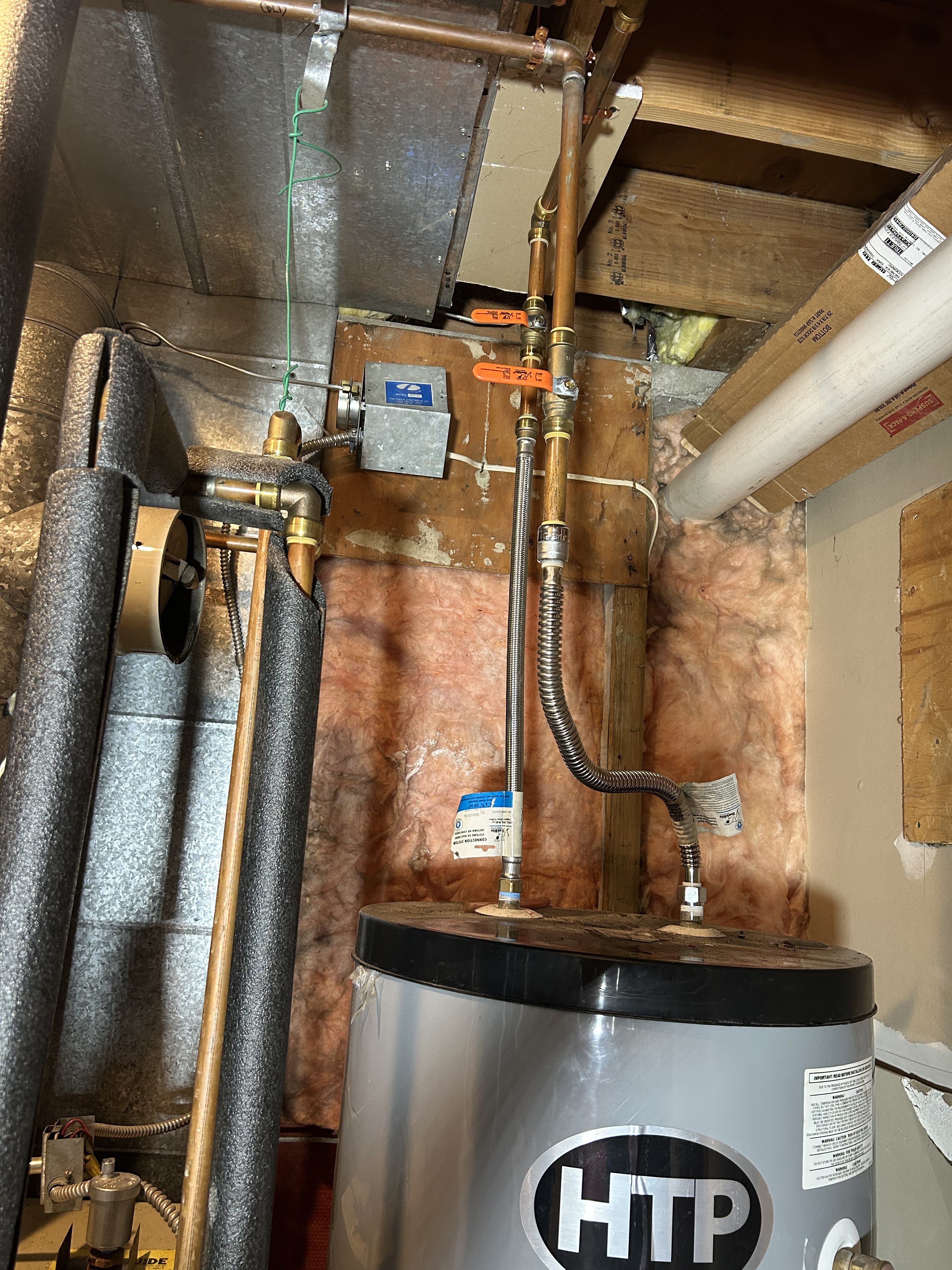

    Those pictures are helpful, thanks. Also need pictures of piping above boiler zone valves as well. Looking for insulation valves and the circulator pump.
  • PC7060
    PC7060 Posts: 1,982

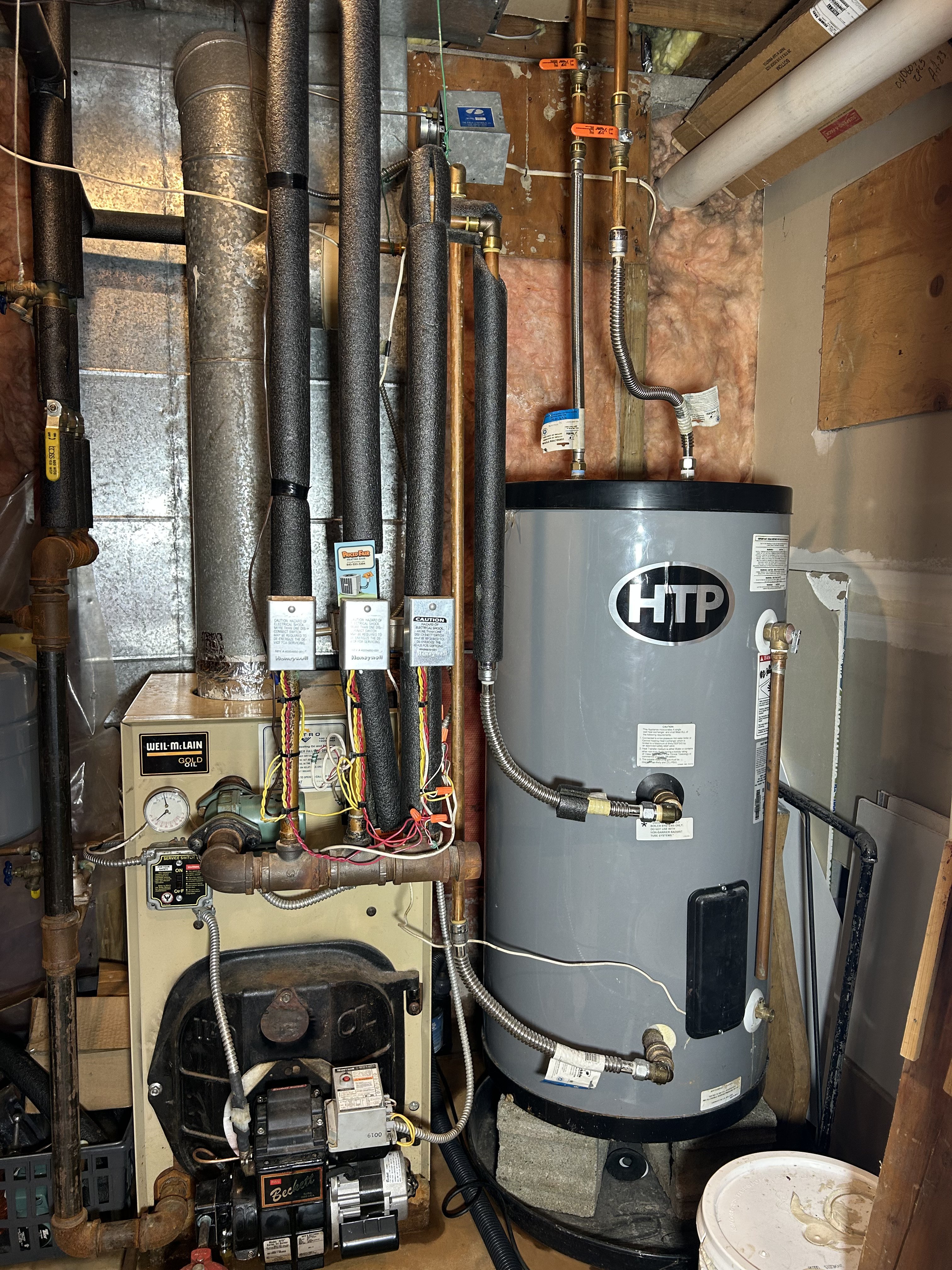

    Provide pictures of indirect hot water tank and the valves you mentioned above. Try taking picture from a few feet further back.

    Ugh. Whoever installed the boiler used shark bite joints, which I guess are legal, but makes me question the experience of the installer.
    What professional doesn’t have a ProPress tool in their kit?

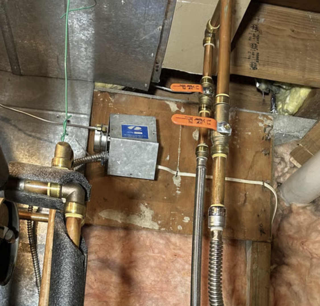

    I see isolation valves (yellow handle 1/4 turn) on the three zones returns directly above the expansion tank.
    I don’t see isolation valves on the supply side other than the zone valves.
    Assuming those are normally closed you should be able to close the valves on the return lines and drain down boiler without drain draining rest of the house.
    What’s your comfort level working on mechanical systems and plumbing?

    Isolated and drained boiler. Took the top off the PRV. Hoping this is the smoking gun.

    the boiler looks ok. whoever replaced the water heater was a hack.

    Well, no good dispite new PRV. Filled exmpansion tank to 12 psi as indicated on tank. Filled boiler and ran water though it for a bit. Closed drain and filled it. Pressure rose to 30 psi. and new boiler valve popped. :(
    Checked expansion tank psi again and it was 30
    pecmsg Posts: 7,654
    that’s cause it’s reading the boiler pressure.
    you only check the tank pressure when the boiler is at zero

    1. Did you close the isolation valves to the indirect tank while you were testing?
      2. What pressure is the PRV set to?
      3. Did the pressure hold at the PRV pressure value then slowly increase to 30?
    4. Or go immediately to 30 psi?
    I suspect the PRV set level is incorrect
    Or the domestic water is pressurizing g the boiler through a hole in the heat exchanger (this is why you should have the isolation valves closed when testing )

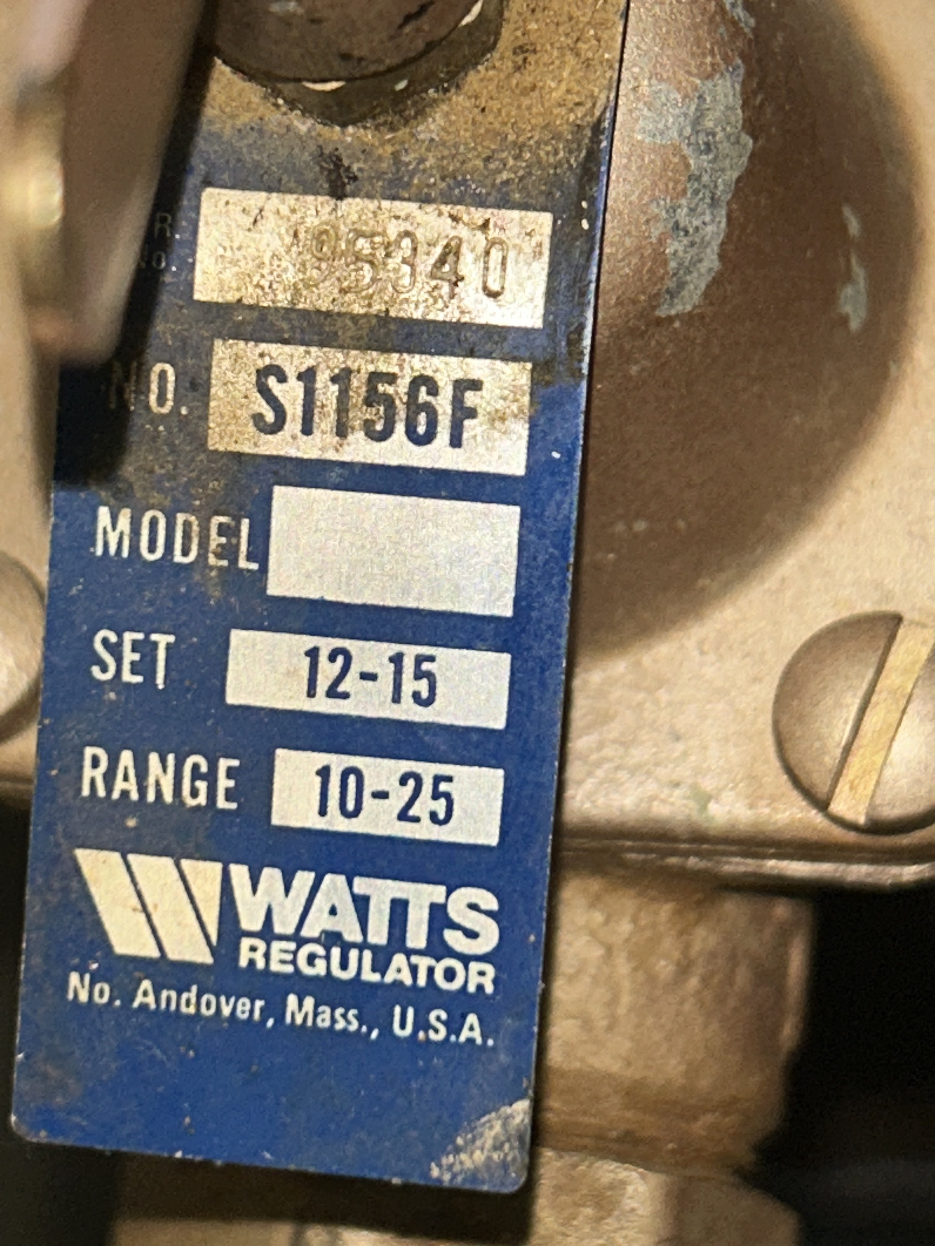

    I changed the PVR and TPRV. The paper that came with PRV said it's factory set at 15, so I left it. With the boiler drained and at zero the expansion tank reads 10psi. I shut the three valves above the tank when draining boiler. When I filled the boiler using the valve before the PVR the pressure was initially 10psi but very very slowly rose to 30 and the valve popped. For the additional isolation valve you suggested adding, this would be just for the expansion tank?

    1. ”For the additional isolation valve you suggested adding, this would be just for the expansion tank?”
    Yes, for ease of maintenance.
    2. “With the boiler drained and at zero the expansion tank reads 10psi.”
    The expansion tank pressure should be set to 15psi for 2 story house; 12psi for 1 story.
    3. Did you have the isolation valves for the indirect tank closed? (Valves above tank, shown closed in photos)
    4. Did you replace the complete PRV? The body in the new looks old like the internals were swapped.

    Supply house didn't have S1156, got a B1156f. Was told the internals will swap out after cleaning. Not ideal but they swapped out easily
    Right now, the boiler off and is empty, three valves above expansion tank shut and the PRV feed valve is shut…
  • PC7060
    PC7060 Posts: 1,982
    edited August 18
    ok, since the HTP is isolated, the PRV must be the problem.
    Drain down the boiler
    Refill boiler and close supply valve to PRV when boiler PSI hit 15 psi.
    if boiler pressure stabilizes at 15 psi, there is a problem with PRV body and you need to change entire valve.
    (honestly, I’ve never heard of anybody swapping the internals of a PRV)

    mattmia2 Posts: 18,437
    is the stop before the prv holding? if you turn it off nd open that drain does water come out?
    tmtruett
    there are rebuild kits for most PRVs. finding someone that knows how to order one can be harder.
    with all that corrosion in the valve body you probably have something that isn't sealing.
