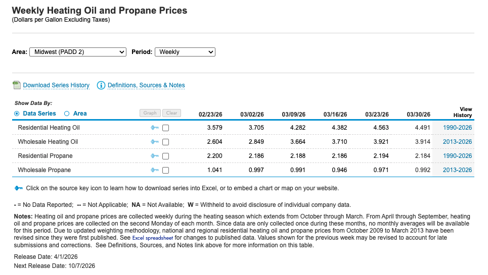

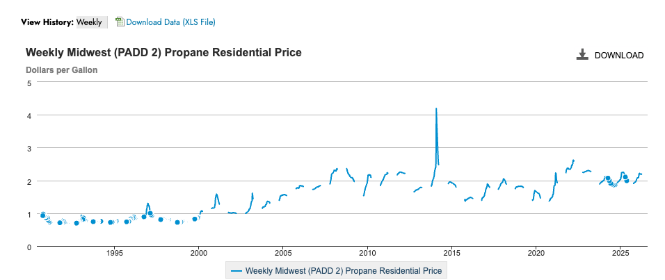

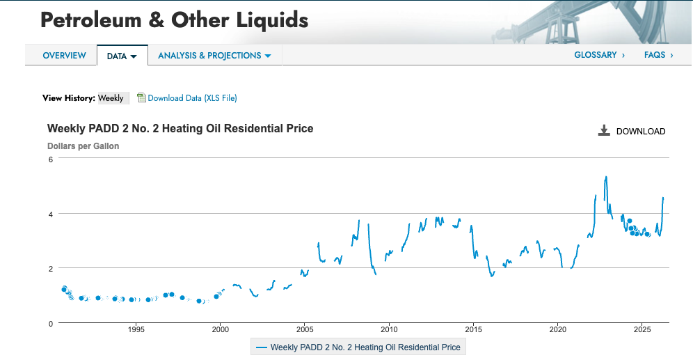

    hot_rod Posts: 28,699
    You can go to the EIA website and find the history of fuel costs across the country.
    Typically in the midwest LP is the least expensive
    https://www.eia.gov/dnav/pet/pet_pri_wfr_dcus_r20_w.htm

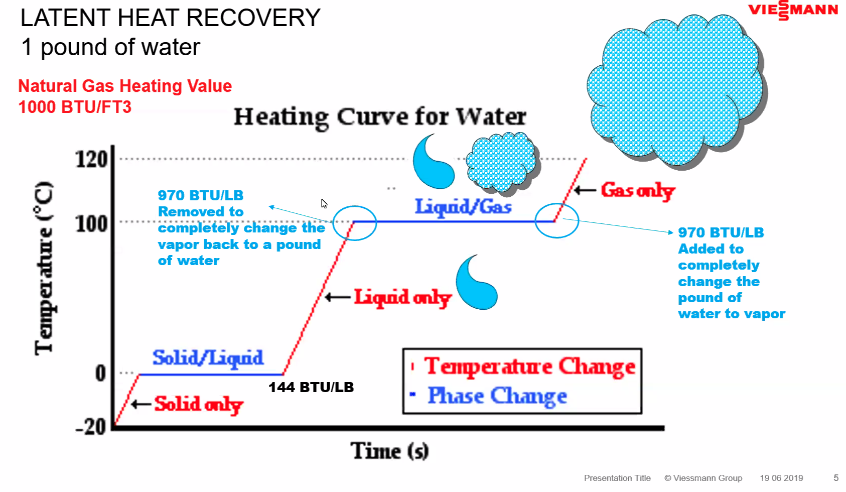

    Screenshot 2026-08-07 at 7.06.12 PM.png Screenshot 2026-08-07 at 7.05.37 PM.png Screenshot 2026-08-07 at 7.06.41 PM.png

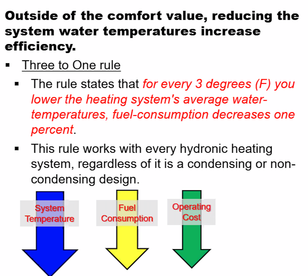

    If you can massage the distribution system and run cool returns, below 120F you can get mid 90% for an LP mod con. Runing a wide delta is another way to get condensing.
    Even with high tempetature, on ODR some of the season should be in condensing mode.
    But the modulation is a real nice feature on zoned system also.

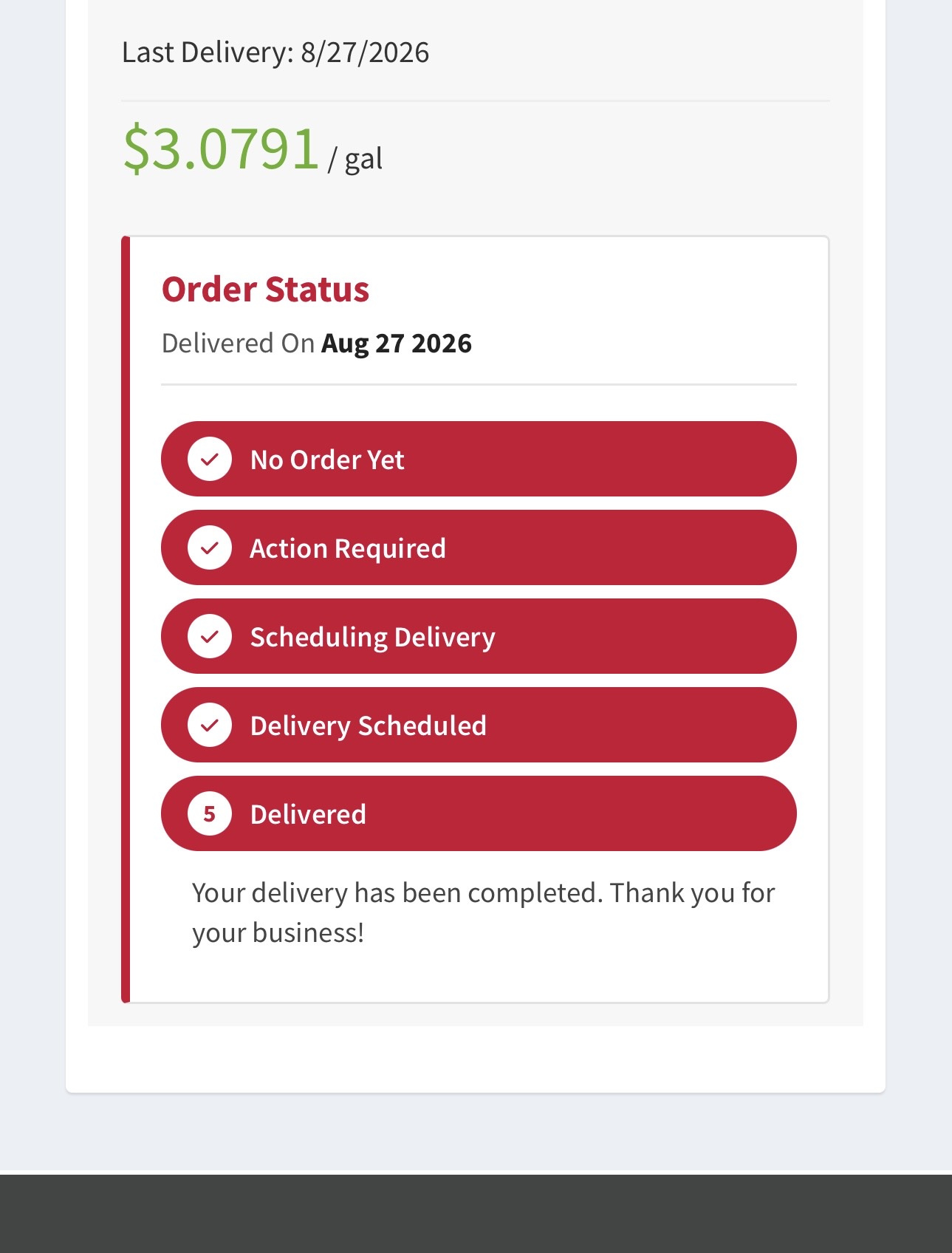

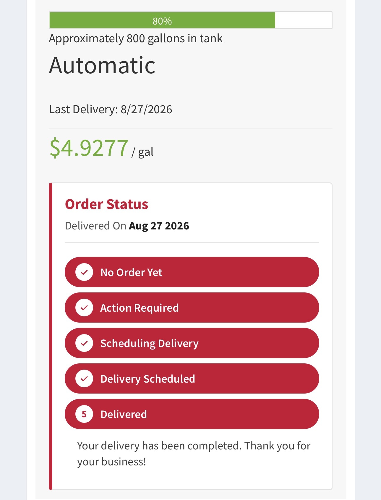

  • I have 2 propane tanks on my property in Northern NJ. I own a 120 gallon tank that I use to heat my pool I can go from 75 to 85 degrees in about 4 hours. The heater needs to be replaced at a cost of 4K dollars. Electric heater is 2K dollars but would take days to reach 85 and need to run continuously. The gas suppliers 1,000 gallon tank is used for 2 stoves, gas grill, 2 propane fireplaces and standby generator.
    I recently had both tanks filled they charged 1.85 more for filling the company owned tank which took about 400 gallons. I called and complained and am still awaiting a call back.
