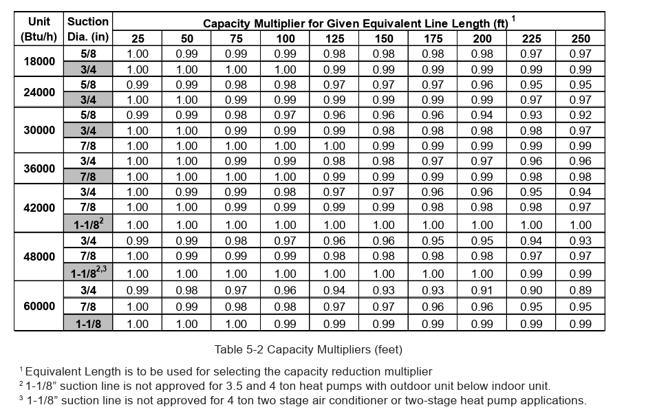

The spec sheets have the suction line at 1 1/8 for 3.5 ton unit. Unit is R32 any real world problem keeping it 7/8 it's only 38 feet long. I know warranties won't apply if it's known it 7/8.

    From the factory the TXV is different between coils. That's it. They won't advise using the 7/8 line set for 37 feet. I wonder if i replace the first 14 feet from the evap to 1 1/8 then to the last 24 feet of 7/8 burried in the the wall it would work. But then again i am going rouge without support. I would be fine with it if it was just an hit on efficiency . Thanks all for the comments.

    Look closer at the spec sheet, or look up the long line set info from them.
    Chances are you'll lose almost nothing even with a 3/4" line set on 3.5 ton. I just ran a 7/8 on a 5 ton and I think I lost an extra 1 or 2% vs 1 1/8 but I forget the distance.
    1-2% isn't worth pulling your hair out over.
    Higher velocity also means better oil return. It probably won't matter in your situation but just throwing it out there as a plus.

  • ChrisJ
    ChrisJ Posts: 17,763
    This is from Goodman's long line set application guideline for R32 systems.
    I assume the OP got their info from the installation instructions.
  • heathead
    heathead Posts: 252
    Chris,
    Yes I got the information from installation manual. Then called Tech line and confirmed. They said that the pressures could be off and they couldn't, wouldn't bless anything longer than 25 being smaller than 1 1/8 on 3.5 ton r32 system.
    Your chart confirms that it's no problem at all. Don't know why their tech support didn't have that chart. Frustrating that calling the tech support line didn't give this answer, Thank you again for your comment.

    @ChrisJ @pecmsg These look basically identical to what I am used to seeing. thank you!
    @heathead If what chris posted is accurate from goodman (it looks exactly like my manufacturers as well) then Goodman would have to bless the size reduction because they approve it directly in their own guidelines. They were blowing you off most likely. Most importantly I wouldnt want you to think you were doing something unconventional, you should be safe to reduce the size , no need to only reduce partially.
