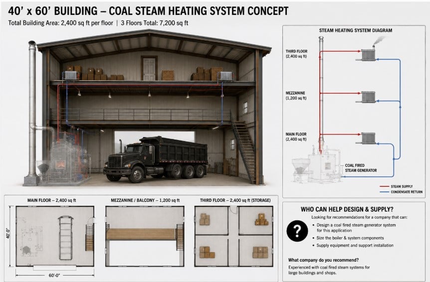

Looking for a Company to Design & Supply a Coal-Fired Steam Heating System for a 40' × 60' Shop
the early planning stages of a new building and I'm looking for recommendations for a company (or engineer) that specializes in coal-fired steam heating systems.
Building concept:
  • 40' × 60' footprint
  • Approximately 7,200 sq ft total over three levels
  • Main floor will be an open equipment/truck shop with a door large enough for a tri-axle dump truck.
  • Second floor will have a mezzanine/balcony overlooking the shop.
  • Third floor will be primarily storage with four storage rooms.
I'd like to explore low pressure steam using a coal-fired stoker boiler (or other coal-fired steam generator if there is a better option).
I'm looking for recommendations on:
  • Companies that Design the complete steam distribution system.
  • Size the boiler correctly.
  • Recommend the proper chimney, piping, controls, and condensate return system.
  • Supply the equipment (or recommend the best manufacturer).
If you've worked with a company you would trust on a project like this, I'd really appreciate the recommendation.
Thanks in advance for any advice.

    The chain grate stoker drawn in the building floor plan is much too large for a building of this size and not needed as the steam pressure generated by a chain grate stoker is not needed.
    My basic thinking about this was the lean to for the stoker and the coal bin where the double drop header with 4 inch pipe would feed the dry steam through the side wall sloped upward to the header pipe in the ceiling where it would meet a 4 inch elbow and then join the header pipe under the ceiling peak at the closed end of the building.

    I think it is a generic radiator image.
  • GGross
    GGross Posts: 2,104
    ChatGPT drew what it thinks a radiator looks like
