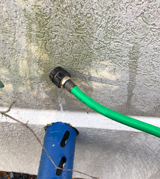

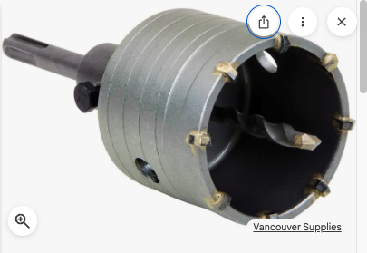

    You can purchase, or rent a carbide drill for coring brick if you don't want to do a chisel hack :)
    i keep an assortment of common pipe size in the shop. 2-9/16 for 2" PVC, 3-5/8" for 3"
    There may be a wood framed wall behind the brick?
    Imported diamond core bits are cheap online, a little harder to keep centered. They are deep enough to reach across the brick.

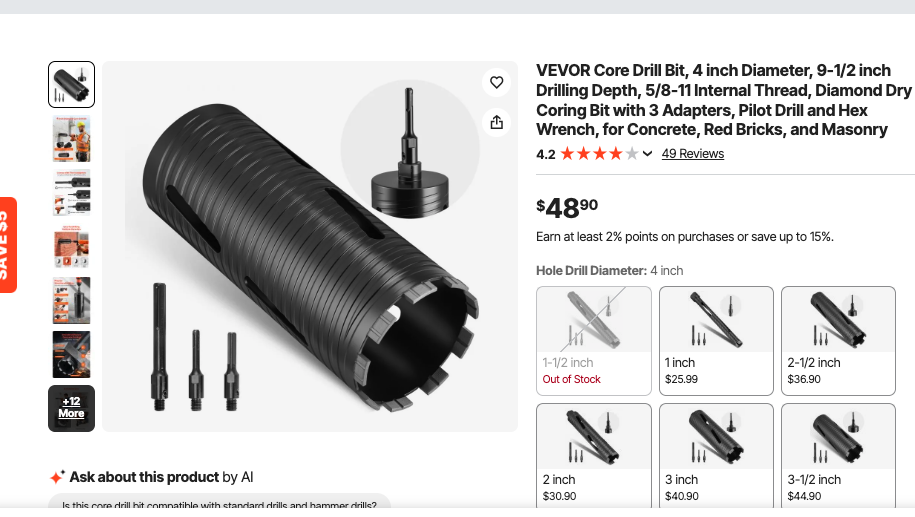

    I cannot seem to find a cheap 3 5/8 core bit online.. only 3 1/2
    hot_rod Posts: 28,776
    4" and a tube of grey silicone to seal the 1/4" gap around it. Assuming you are using 3" PVC? If not measure the OD of the material you are using.

    go up to 3–3/4 or 4”; diamond if cutting through masonry.
    Edit: Predrill the center guide hole. Otherwise edges grab if you get off axis a bit.

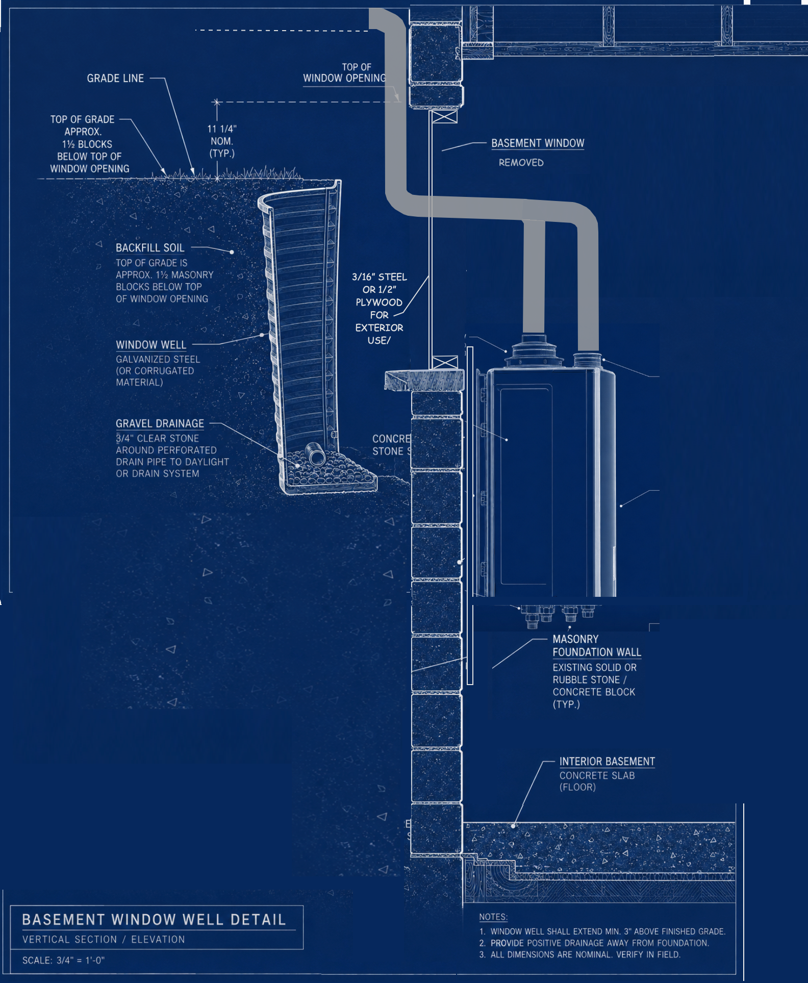

    EdTheHeaterMan Posts: 13,025
    If there was an official engineering drawing of do the pipe thru the window idea, would that make it OK?
    What do you all think?

    EBEBRATT-Ed Posts: 21,365
    What do I think? I think @EdTheHeaterMan should be given a PE license.
    using the window opening is more of an aesthetic issue, in my mind.
    Why core a hole next to a perfectly good hole, the window.
    If you want some light, I suppose part could be window, part sheet metal for the vent. As long as the window is fixed.
