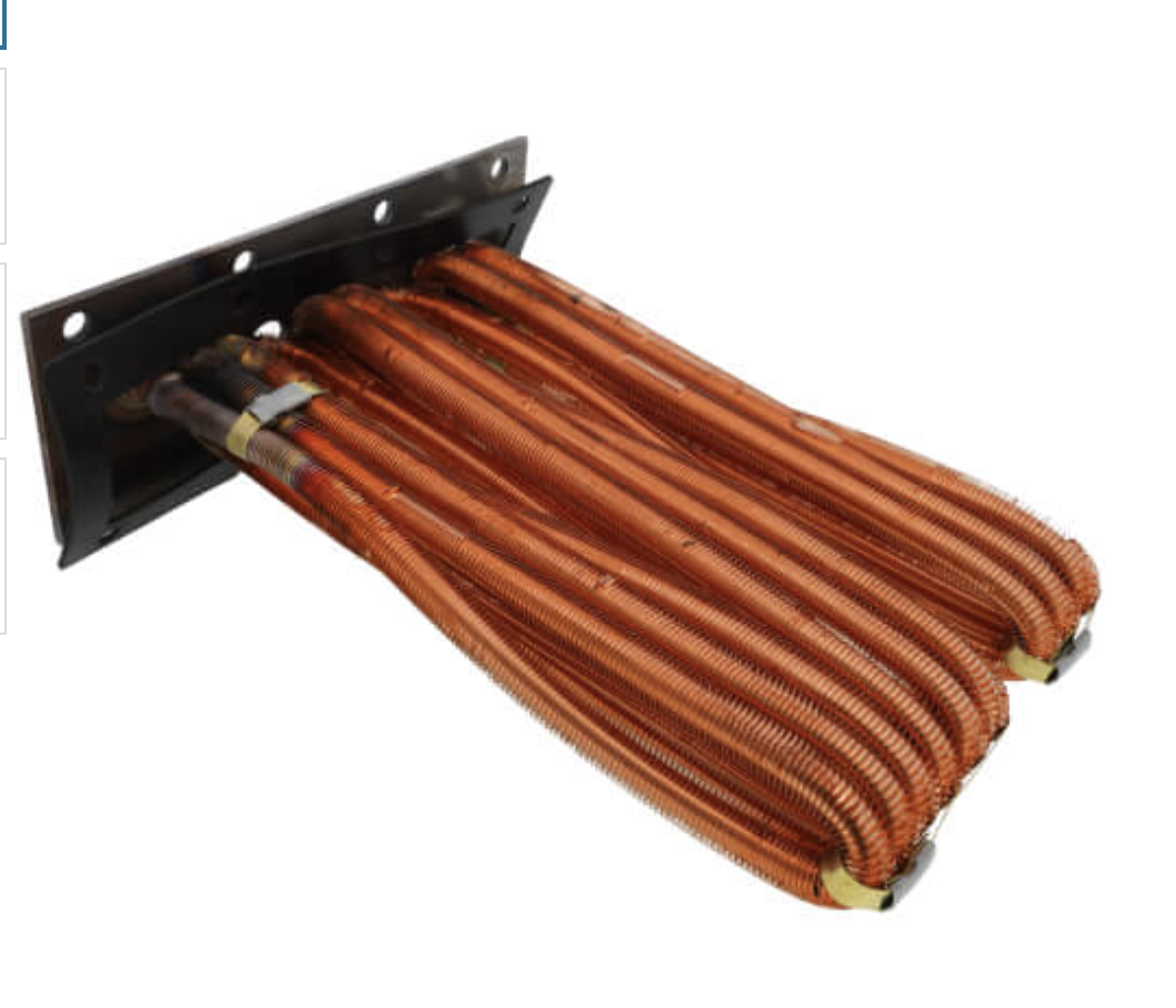

  • The coil on this boiler is not the spiral type you're thinking of — the coil goes straight back about 14" before curving back toward the inlet (see attached pic for example). I ended up using a 24" drill bit from HF and it worked well enough! As for the gasket, I cant find an exact replacement anywhere online, but feel free to link me.
