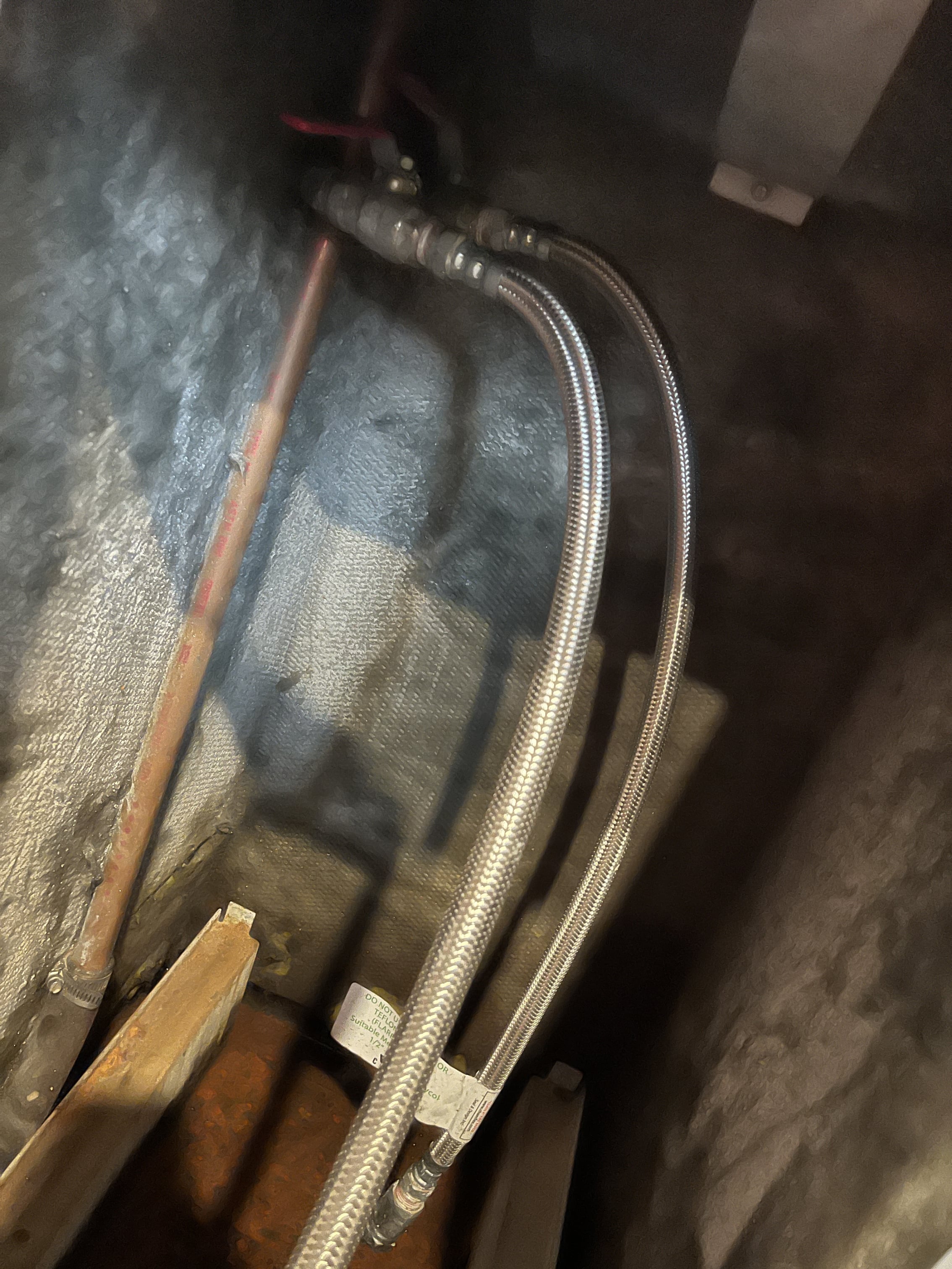

One of the two pipes (closest one) is clogged. When drained into a bucket, a cupfull of water comes out and then stops. Black sediment comes out with the water. This is in a high rise. I have drained two bucketfulls already and it has not helped. How can I get it unclogged?

    What is this water pipe connected to? You might be able to disconnect it at both ends and flush it under full pressure… or replace it… but are you sure it's the pipe and not the valve?
    EBEBRATT-Ed Posts: 21,353
    need to be careful in a high rise as you really don't want a flood. I am assuming this is a water source heat pump connected to a water tower/boiler system.
    This would be a closed loop system in a high rise. You should get water out of either hose when it is disconnected.
    I would make sure the hoses is clear up to the valve the hose may have deteriorated or broken down.
    I don't know if you are the homeowner or part of building maintenance, but I would get building maintenance involved. You could take the hoses off carefully and open the valve slowly and stick a wire in there but use caution you could spray water or black mud everywhere. Depending on the building height you could have a lot of pressure on those pipes
    pecmsg Posts: 7,644
    pull the hose off the valve and S L O W L Y open the valve.
    if there plenty of flow replace the hose. Personally I’d use copper. I wouldn’t trust those hoses on tower pressure and chemicals.

    Yes, water comes out of both pipes. Only one pipe seems to be clogged.
    It is not the hose, the clog is upstream of the valve. If I leave the valve on, the flow slows to a trickle. Leave the valve turned off for a minute and a cupful of water gushes out when the valve is turned on before the flow slows to a trickle again. The longer the valve is left off, the more the initial flow of water when the valve is turned on.

    So the braided hose has no pressure out but the other braided hose has plenty of pressure going in?
    I'm assuming that water is for the geo, not the fan coil because of the M copper and the hose clamp connection.

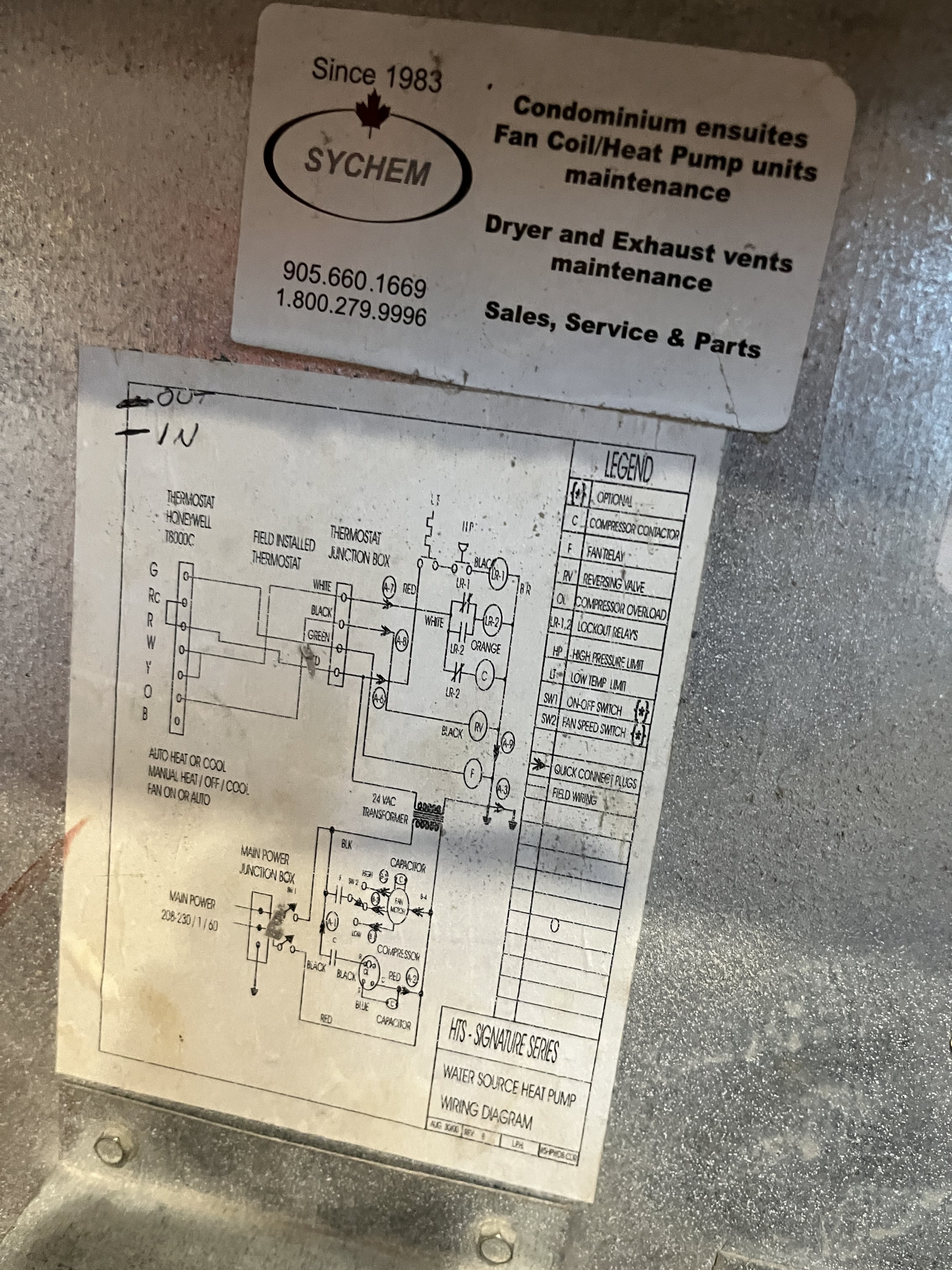

    The diagram doesn't show a factory geo valve. If one was added, check for 24 vac. If its constant flow, I'd say the coax coil is clogged. There's a cleaner you can try that uses a recirculating pump setup and opposite flow. The manufacturer might recommend a specific type of cleaning agent. If there's room, pipe in a water filter.

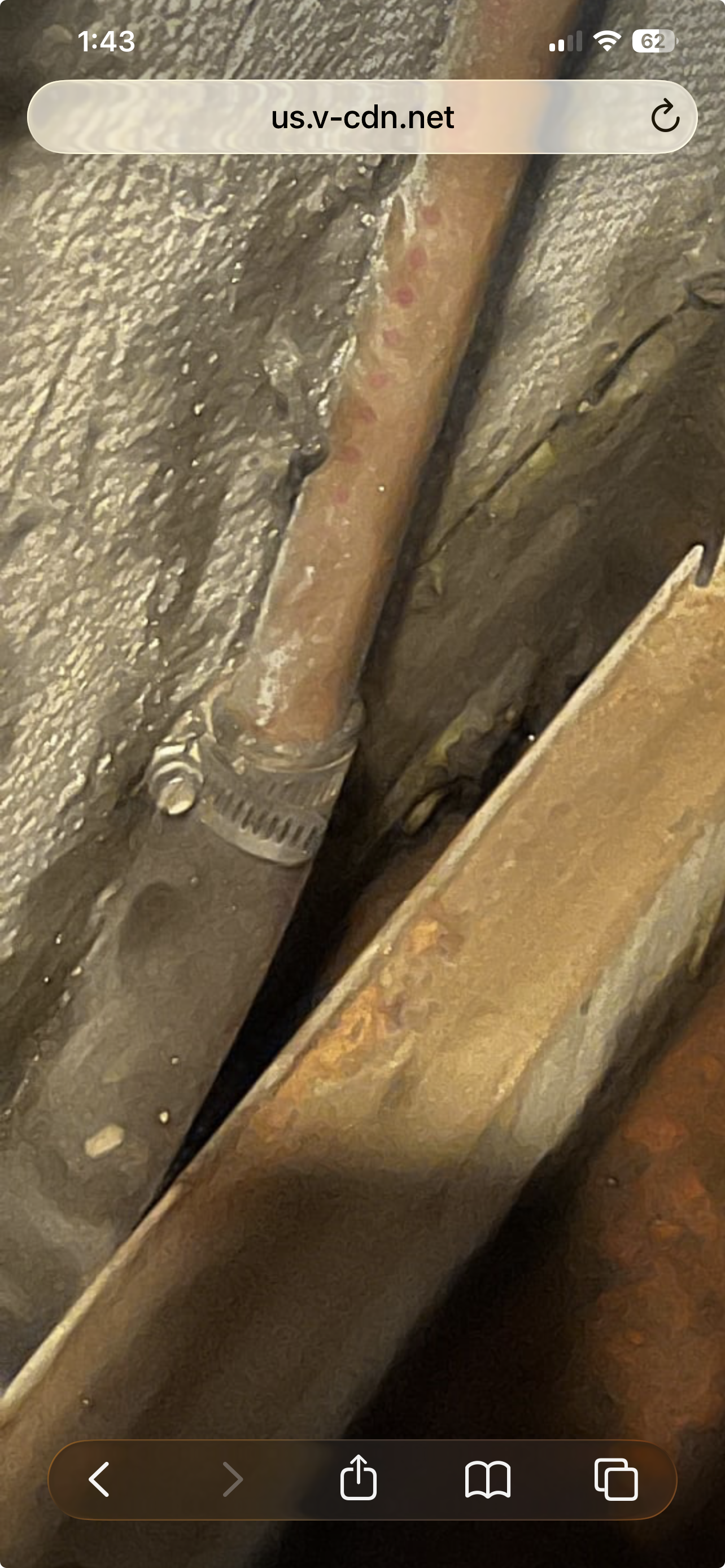

    what’s with the hose and clamp?
    maybe the condensate drain.

    The M copper is a drain line and I think it is from the heat pump located in the floor above this. Both floors belong to this apartment.

    All I have posted about is with the heat pump removed. I don't think the coax coil is a factor here.

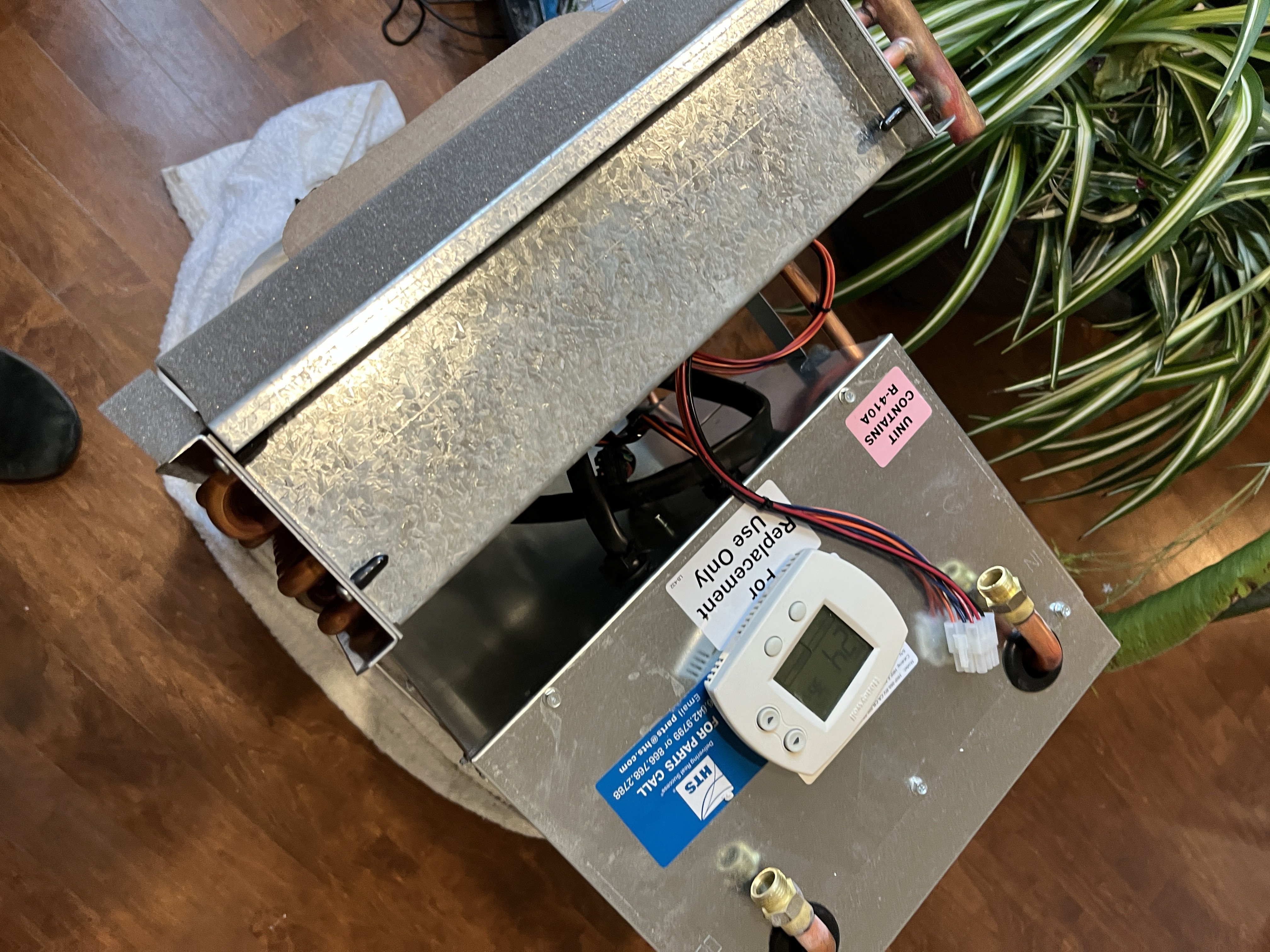

    The old heat pump quit and the HVAC company ny friend hired brought a new heat pump and noticed that the flow through one of the hoses was low. They said they cannot proceed till the building clears out the clog.
    I did not remove the old burned out heat pump, so I don't have answers to your other questions.
