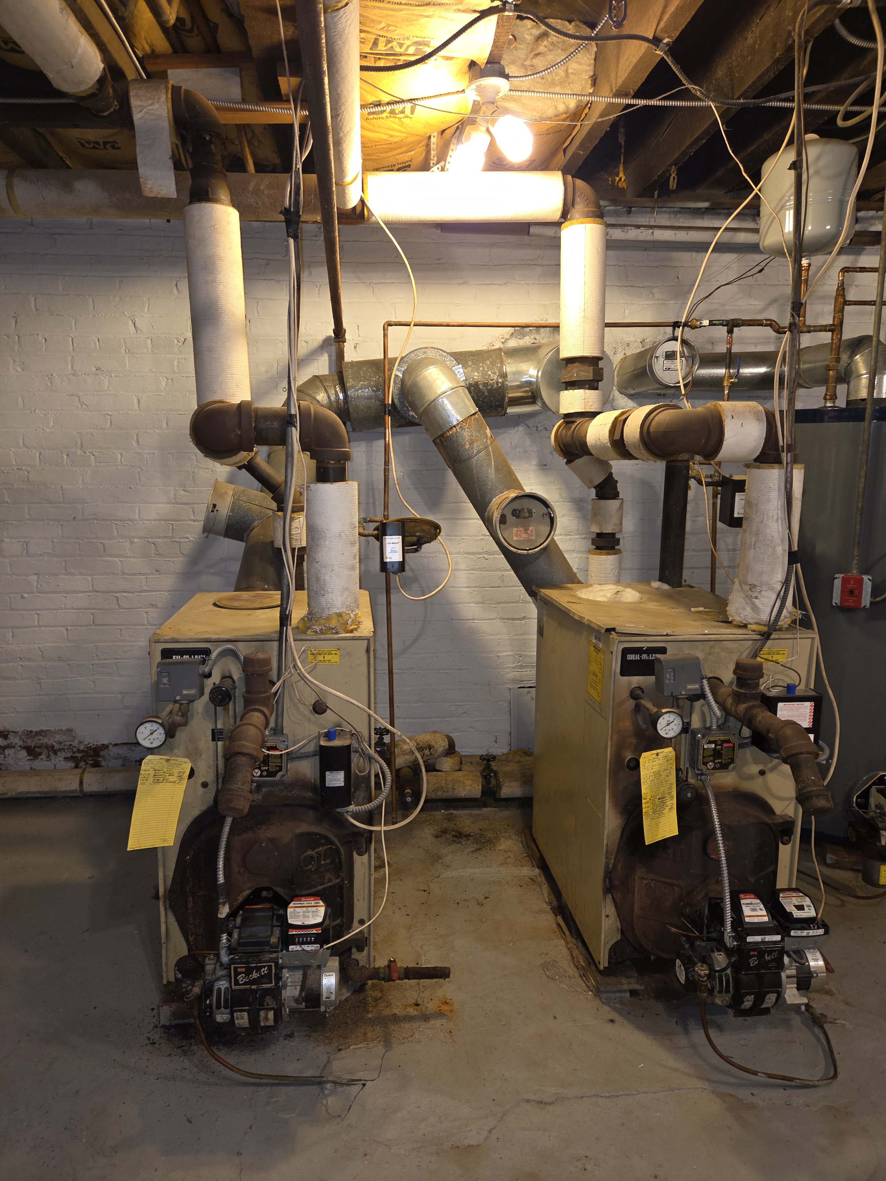

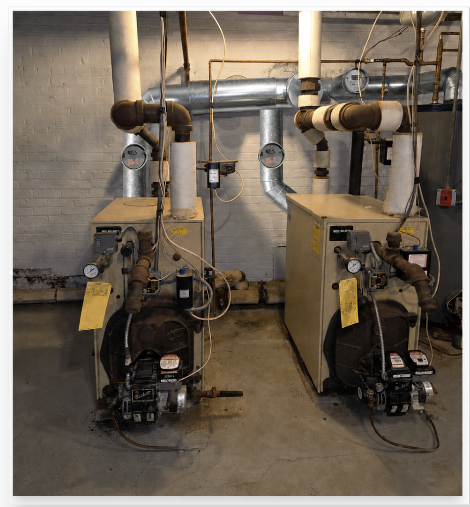

Hello - I have 2 oil steam heat boilers (Weil-McLain SGO 5 and Weil-McLain SGO 7) that I want to replace this summer. We want to replace with the same make and model. Does anyone have any recommendations for someone on Long Island who is knowledgeable about steam heat and can install?

    @lovebug11768 , is there a specific reason you're looking for the same boilers? Can you post pics?
    If you're thinking just an easy swap out while retaining all existing piping, you could be seriously deceiving yourself. There are numerous steam installations that aren't piped even close to manufactures specs. Especially on the Island. Let's see what there now.

    That’s some horrible flue pipe.
    In addition to making sure the current boilers match the connected edr, make sure the returns under the floor aren't leaking.

    So is it your intent to keep two separate systems as is? Is it a duplex type property?

    Are these boilers leaking?
    Is this steam heating system a two pipe system?
    How old are the oil tanks? Would you mind providing pictures of them?
    Are the oil tanks in the basement or outside?
    Removing those in floor oil lines and replacing them with the proper covered ones should be done to bring it up to code.
    You seem to have plenty of head room for a double drop header or 2 double drop headers to make drier steam in a new installation to save fuel.

    A 30-year-old boiler does not need to be replaced simply because it is 30 years old. If the cast-iron sections are not leaking and the boiler is operating safely and efficiently, it may have many years of useful life remaining.
    The worst likely failure is a leak in a cast-iron section. Even then, the homeowner may not immediately be without heat. A small leak can often be slowed or temporarily sealed with a boiler stop-leak product. That may keep the boiler operating while a replacement is ordered and the installation is scheduled. Stop-leak is not always a permanent repair, but it can prevent a minor leak from becoming a six-week no-heat emergency.
    Most other failures involve replaceable parts, such as the burner motor, fuel pump, igniter, primary control, aquastat, or low-water cutoff. Those components can usually be replaced within a day. The greatest inconvenience may be waiting until Monday for a supply house to open if the failure occurs during a holiday weekend.
    It may also be worthwhile to keep a few correct spare burner parts nearby. A used burner identical to the existing one can sometimes be purchased inexpensively on eBay, and kept as a source of emergency replacement parts. Any replacement part must still be properly installed, adjusted, and tested by a qualified technician. Those spare parts will work on both of your Weil McLain boilers with Beckett oil burners.
    If the cast-iron block does not leak for another 20 years, replacing the boiler today would have accomplished nothing except creating a large unnecessary expense. New boilers can also have manufacturing defects and early failures. You could replace a dependable boiler today and later find yourself wishing you had kept it, especially if you happened to purchase a factory defect boiler and need to replace the factory defect cast iron sections in the first few years.   Those warranty sections may be free under warranty but you need to pay the labor to replace them after the first year. That labor is sometimes more that the cost of the actual part(s).
    If these boilers were in my house, I would maintain them properly, monitor it for leakage, and continue using them. I would plan financially for its eventual replacement, but I would not replace it merely because it has reached its 30th birthday. A coat of paint would not hurt either. The flue connector pipe with the off balance barometric draft control can be adjusted to operate properly also. You might want to show your oil burner service tecj this photo so they can get it right for you.
