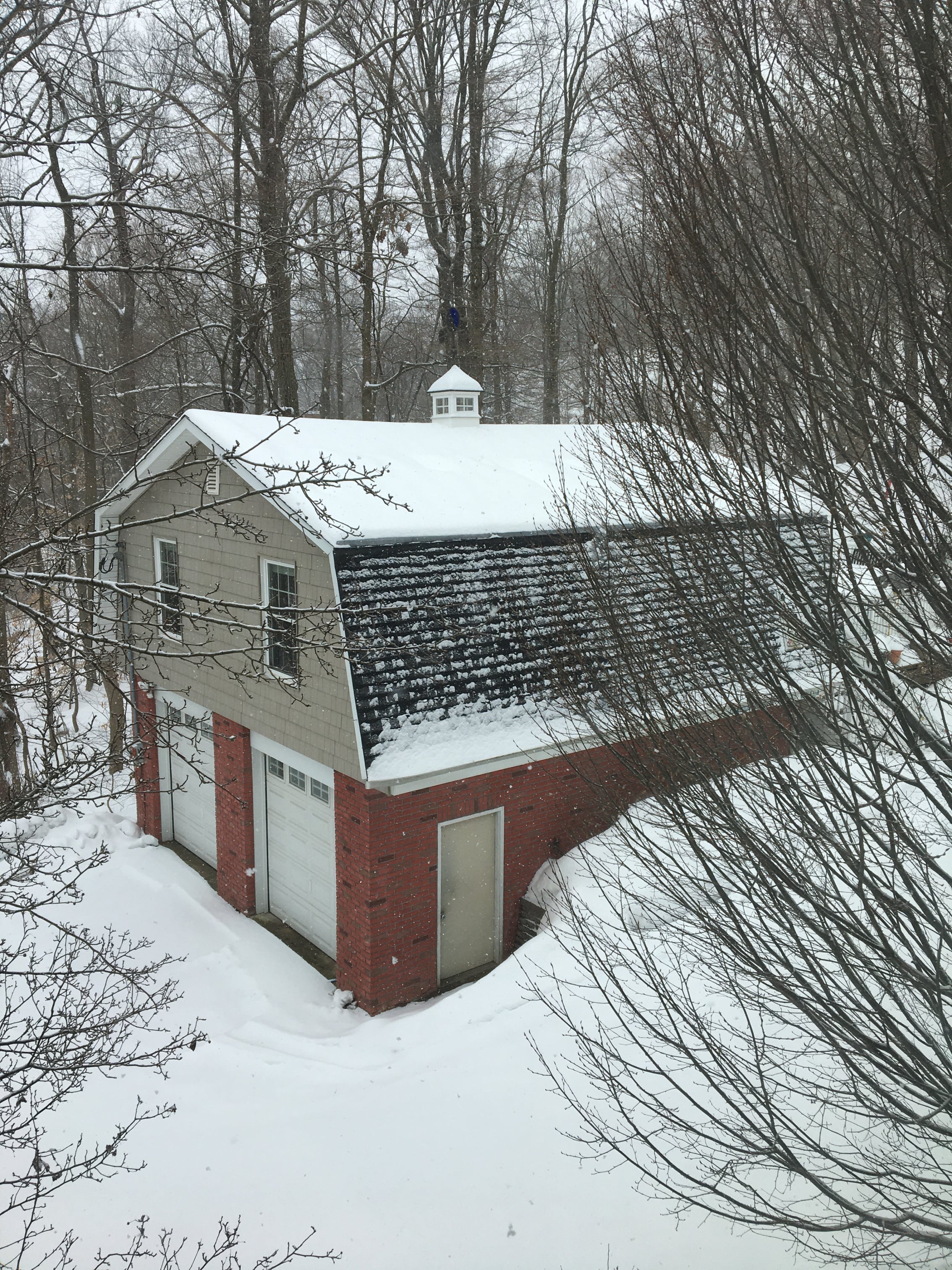

    HVACNUT, when the existing unit was installed the room was an unfinished space,just exposed studs in a room over a detached garage. I’m sure a new line set and wiring could be installed but using the existing ones would make it easier. I will discuss this with my contractor the decision will be his. I recently had a central system in my house replaced the original refrigerant lines were used. The room is 600 sq. feet, second floor, moderate sun exposure with 10 foot ceilings. The current unit is 18k with both AC and heat.

    25x25 freestanding detached garage. The room is second floor with unheated space below, floor is uninsulated. Ceilings are 10’ walls and ceiling are insulated low attic above. There ia a kitchen area with oven/range. Would 1ton mini split heat pump be enough for AC and heat? The 13 year old 18,000 btu unit to be replaced has worked fine. There is a ceiling mounted electric garage heater in first floor garage set at 45 degrees.

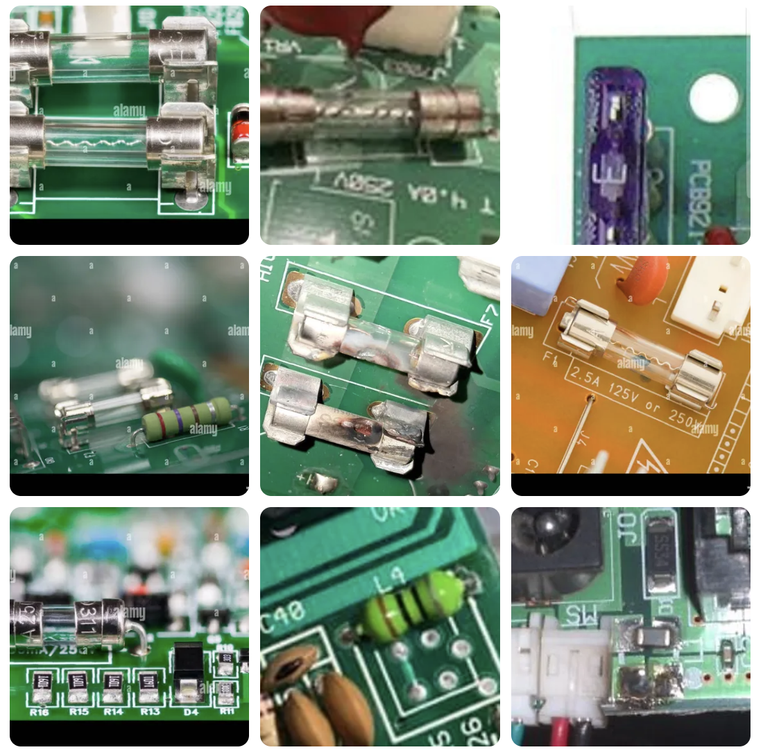

    Here is some examples of circuit protection on a circuit board:
    Bottom right and bottom center are not included. Thay just happen to be in the frame when I took this screenshot. The center square looks like the location of someones problem.
