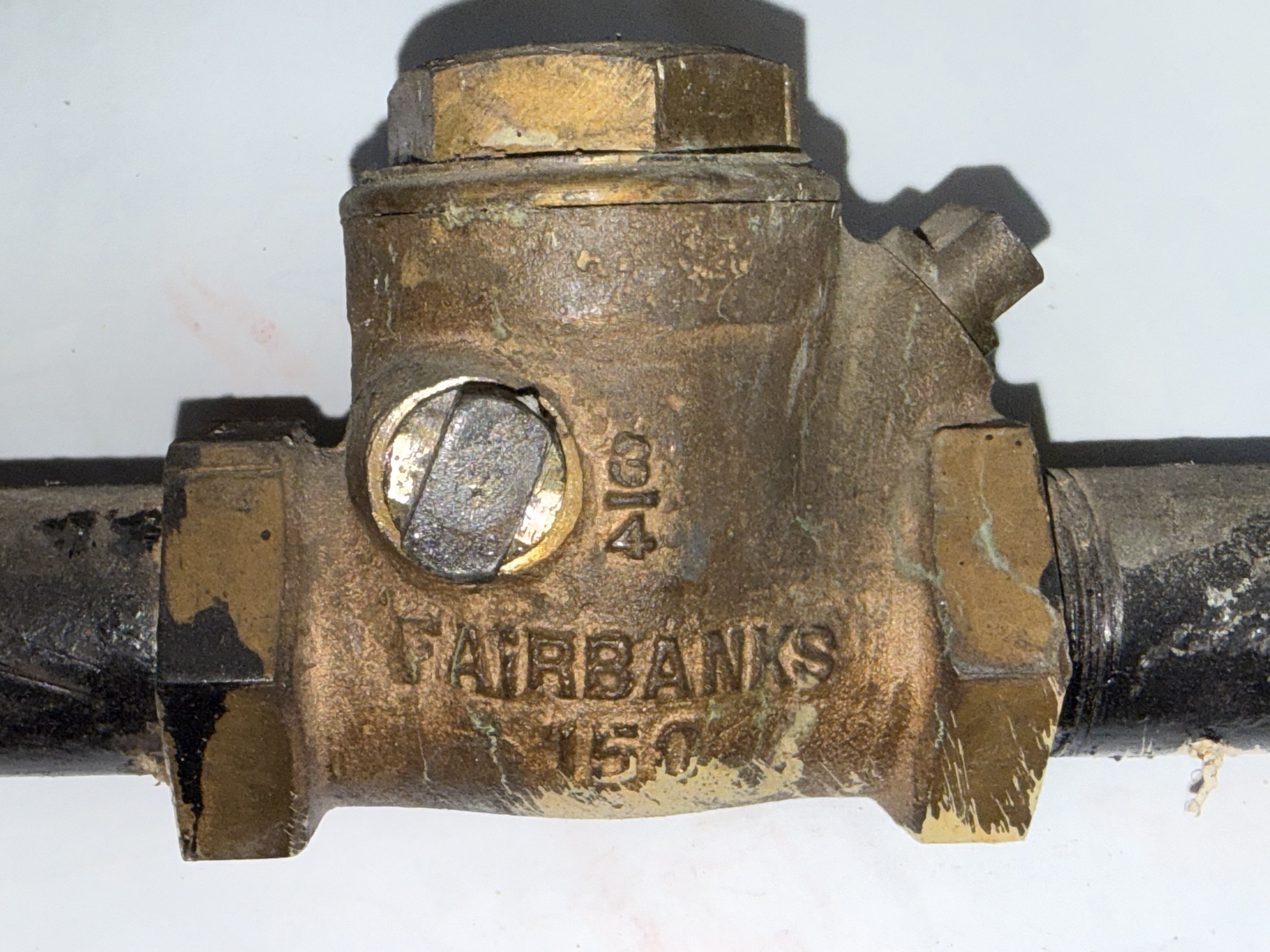

Hello, does anyone have a source for this three-quarter inch swing check valve? This is for the return section of a two pipe steam system.
The Fairbanks brand is out of business and I can't find this exact one. It's 3/4" NPT, 3" long.
If anybody has new old stock, or an alternative brand with a similar spec, I'd appreciate it. Thank you.

    looks like a basic tee pattern swingcheck. You may need to shop all the brands to find one exactly the same length.
    Watts, Apollo, Milwaukee, Nibco are a few brands. Unless there is audio. On either side, you may need to cut and do so rethreading. So exact length may not be a issue?

    Hi, A question, or two… What's wrong with the valve? And have you taken the top off to get a look inside? I've often been able to free up stuck valves by removing the top to get access. 🤔

    As @hot_rod mentioned check valves at least threaded ones do not come in a standard length.
  • Thanks for the replies.
    I'm doing some off-season repairs and preventative maintenance. Specifically replacing some old piping, which this valve falls in the middle of.
    The gate is frozen but I'm going to take a shot at repairing as suggested. If I can't, I am going to replace just replace it.

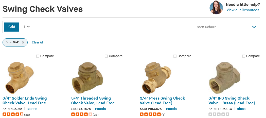

    Simple fix is to get another swing check. Cut it out and mega press in another check….if the check is needed.

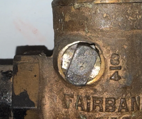

    The side view shows the hinge pin, I suspect. That is typically what the gate pivots on.
    Looks like maybe a test port up on the top.

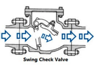

    Do you suspect the gate is frozen in the shut or open position? In either case it should have an effect on the operation. I think you would need to take the top assembly cap off to know for sure.
    If it is frozen open and the system works properly, maybe it is not needed?

    those were generally used on vapor systems in conjunction with boiler return traps. are you sure the check is bad and it isn't doing exactly what it was designed to do but some knucklheading of the vapor system is preventing it from operating as intended?

    Supplyhouse.com
    https://www.mcmaster.com
    I'm sure there are other sources for one.

    Hi, I'll add that check was made when we expected to be able to service things. Notice how big the flats on the top are… nicely designed for a wrench or socket. I'd be tempted to hold the body of the valve with a pipe wrench and use a socket on the top/cap to encourage it to behave. 😊

  • Thank you to everyone. The original one couldn't be salvaged. I replaced with a Legend unit that was a little shorter, so I just used a longer nipple.
