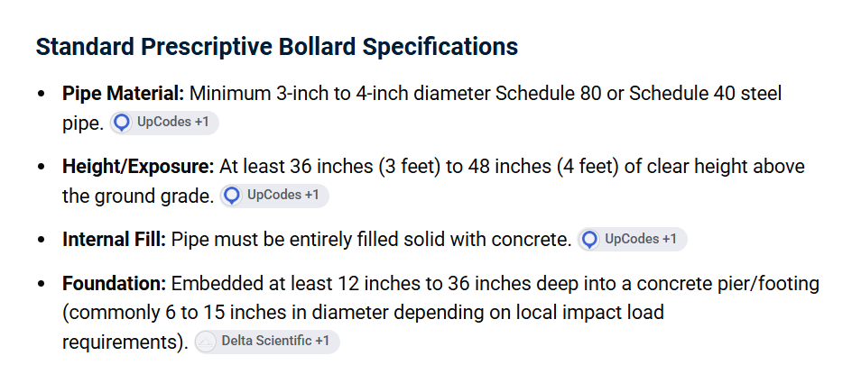

    i believe there are specs for the bollard protection in the code. it is usually a lally column.

    I guess I'll have to rummage around to find what the code says about bollards. Great, another project!

    Huh, here's what basic Google AI says:

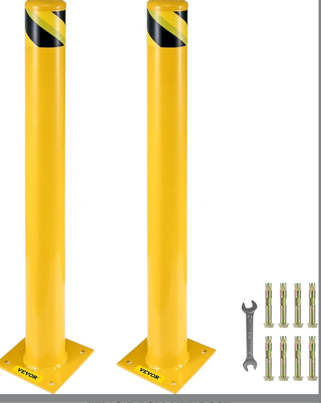

    These 48" bolt down 5.5" dia steel bollards from Amazon look like they will do it. A lot easier to use lags than break out a footing from the driveway.
    https://a.co/d/0ewaL12y
    i think the code specifies how far it has to be buried in the ground. depending on where it is it could possibly be bolted to the building too. the rules are a lot more lax if it is just the residents vehicles vs public traffic.

    Just follow the directions in the boiler manual. I doubt you need bollards. For what? The vent sticks out of the house like a dryer vent. They don't stick out of the house enough to matter.

    We need bollards because we park a car literally right next to it, and we need to do the snorkeled version. One reason I'm replacing it is shards of stucco off the chimney have been falling on the 14 year old car, and we're getting a new one!
