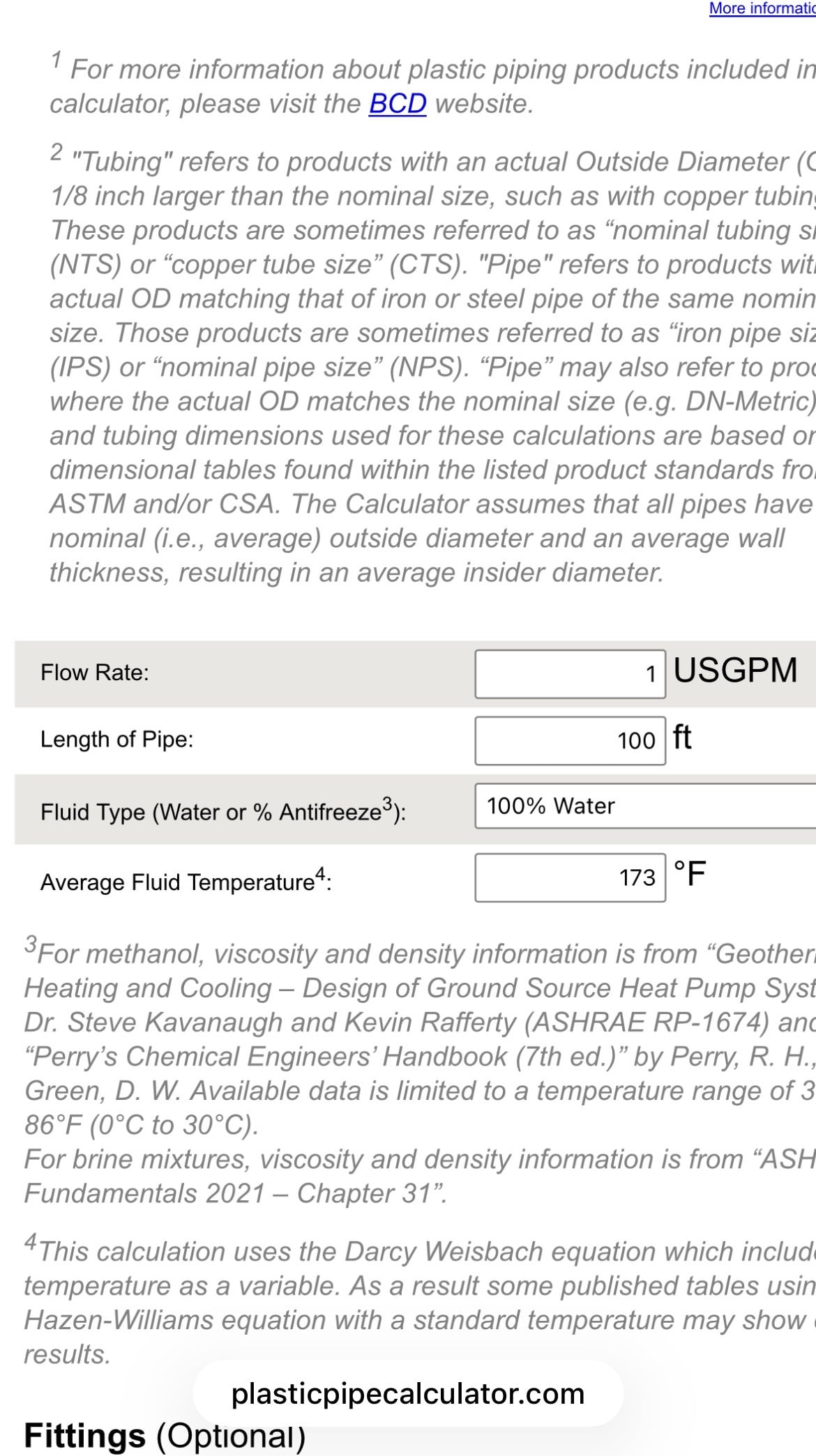

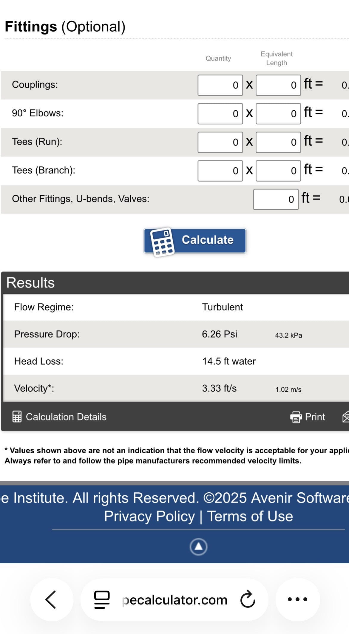

    hot_rod Member Posts: 28,075
    depends on the loop length.
    The PPI online calculator is good to run examples
    https://plasticpipecalculator.com/PressureDropHeadLoss.aspx
    100’ of 3/8 pex at 1 gpm
    14, head will take a high head circ
    50' of 3/8 with a .6 gpm flow
    Alan (California Radiant) Forbes Member Posts: 4,839
    edited June 28
    Sorry, this is wrong and .6 - 1.1gpm is correct. I was figuring ½” PEX.
