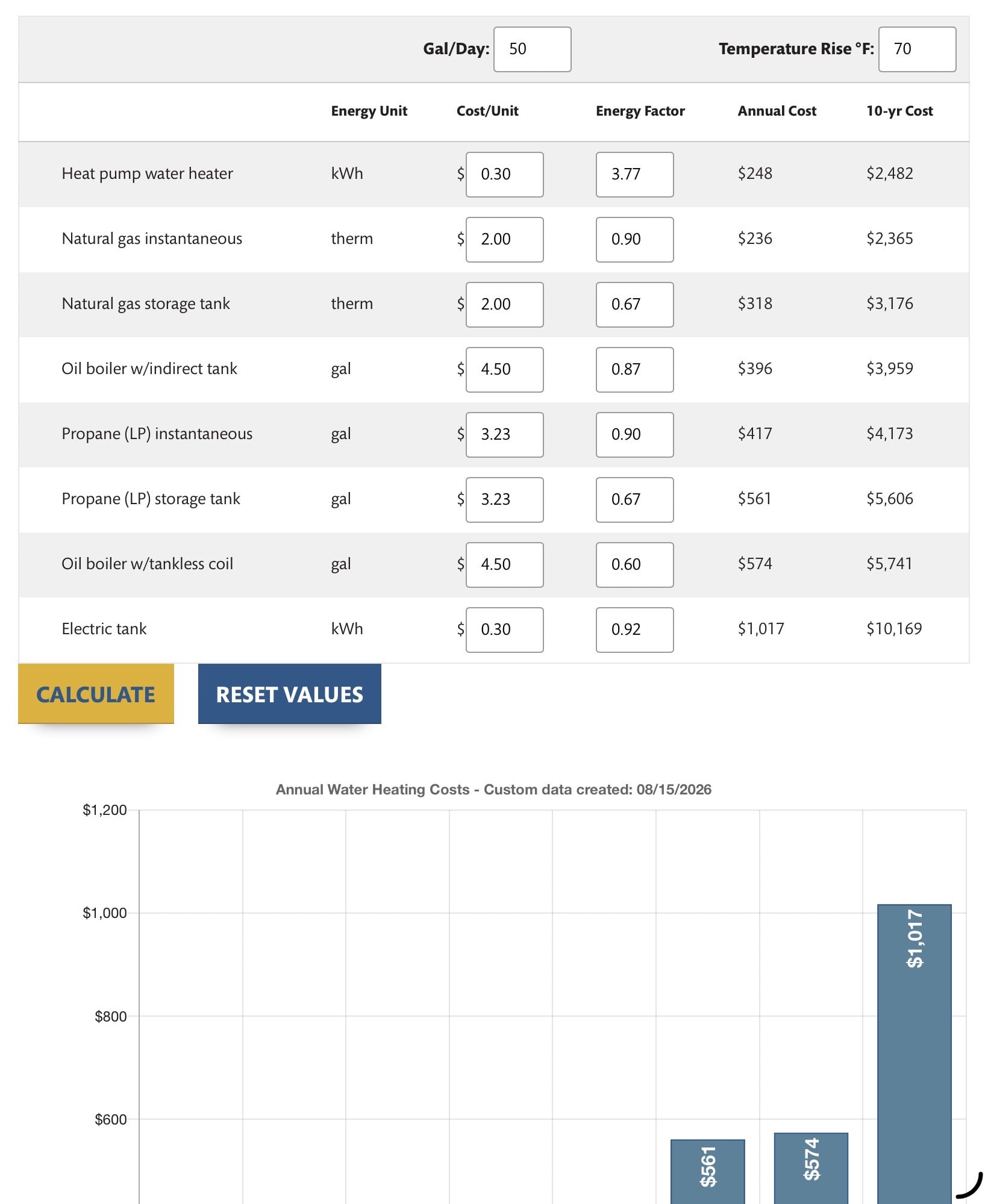

    this calculator allow you to plug in your actual fuel costs.
    https://www.efficiencymaine.com/at-home/water-heating-cost-comparison/
    Oil at 4.50, electricity at .30, here is a look. You are unfortunate to be paying twice the national average for a kWh.
    Even so a HPWH is the least expensive option.

    That is quite insightful honestly. This explains my energy costs so well. It seems unless electricity goes up significantly and oil goes down a lot that the tankless coil is going to be the most expensive way to heat water for a long time. I absolutely love seeing data so clear like this. The hpwh shows as the clear winner on this. The indirect hot water tank is better than my current setup but the hpwh is a clear choice. I feel like the install itself would also be easier.

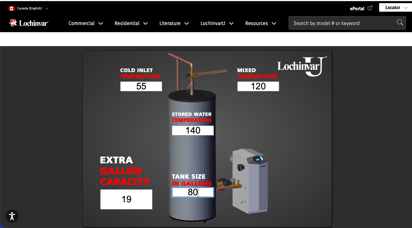

    The online free Lochinvar calc (lochinvar toolkit) shows the effect of elevated tank operation.
    So the 80 becomes a 99 gallon tank when mixed down rom 140- 120.
    Keeping in mind the 80 will take longer to recover thn a 50, like through the night hours or more!

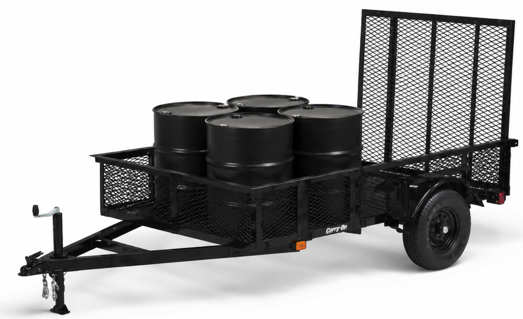

    Interesting that you want to go into the fuel transportation business "Frankly i have wondered if i could get a 50 or 100 gallon tank to tow with the car since for some reason diesel at the pump is less than getting oil delivered and its a nearly identical product". What would you be willing to pay for such a trailer? Would you consider doing it for a friend? If you did this for a friend how much would you charge them? Would you sell them the fuel at the same cost that you paid? Would you then offer free delivery? Would you want to get some money for your time or for the gas it takes to make that fuel delivery for them?
    Once you own the trailer, you could find a gas station that has "Off Road Diesel" with no road tax added. Farmers buy that stuff all the time for their tractors. It would have a redish/purple dye added so the government coild tell there is no road tax. We used to sell it at a rural gas station we owned in South Jersey many years ago.
    Would this work for you? You might want to add the cost of a pump and explosion-proof motor. You wouldn’t want a spark from an open motor pump to be that close to any fuel vapors that may be escaping from those tanks while transferring the fuel.
    Have you ever looked at the electrical wiring on a fuel delivery truck that operates the turn signals, windshield wipers, and such? It is all enclosed in explosion-proof junction boxes, and each cable is sealed in explosion-proof conduit. The truck and tank manufacturers do not want a spark from a loose wire to accidentally ignite any vapor. This trailer does not offer that electrical protection.
    Then you might want to look up your state and local fuel transportation rules to see whether you are allowed to do that without a Commercial Driver’s License (CDL) with a HazMat endorsement. Under 119 gallons for personal use should generally be no problem. Doing it for others may not be subject to the same rules.

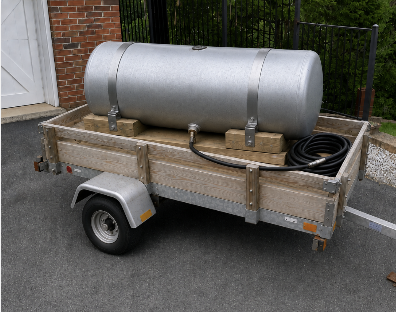

    @EdTheHeaterMan 's picture of 4 55 gallon drums on a utility trailer terrifies me.
    EdTheHeaterMan Posts: 12,940
    edited August 19
    @Jamie Hall said: "@EdTheHeaterMan 's picture of 4 55 gallon drums on a utility trailer terrifies me."
    That s the point.
    Now lets see how the numbers work out.
    Retail oil price delivered in your area. You recently paid about $900.00 for 200 gallons that is roughly $4.50 per gallon.
    You mentioned that you could get diesel including the road tax for less. According to the information available Diesel at the pump is approximately $5.50 per gallon in your area, but a month ago it may have been less. So lets say it is actually $4.28 per gallon.
    An you burn maybe 600 gallons per year.
    That is $4.50 less $4.28 or a difference of 22 cents per gallon.
    a 100 gallon tank will hold about 95 gallons. (you need some air space for expansion) so that is about a savings of $20.90 per load of fuel. That is a savings of $125.00 to $130.00 per year.

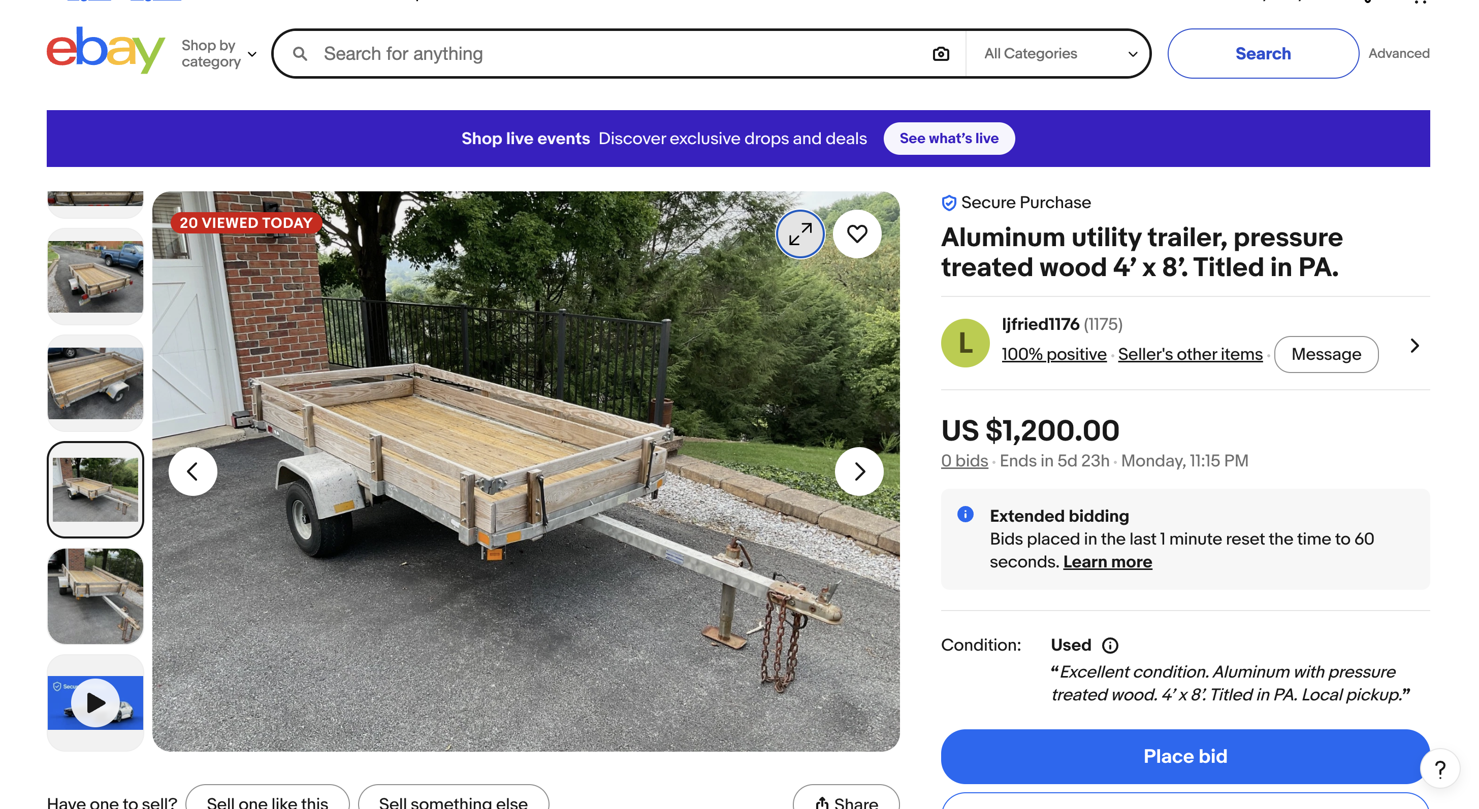

    Now lets look at the cost of that trailer you want to get. eBay has several used utility trailers for around $1200.00

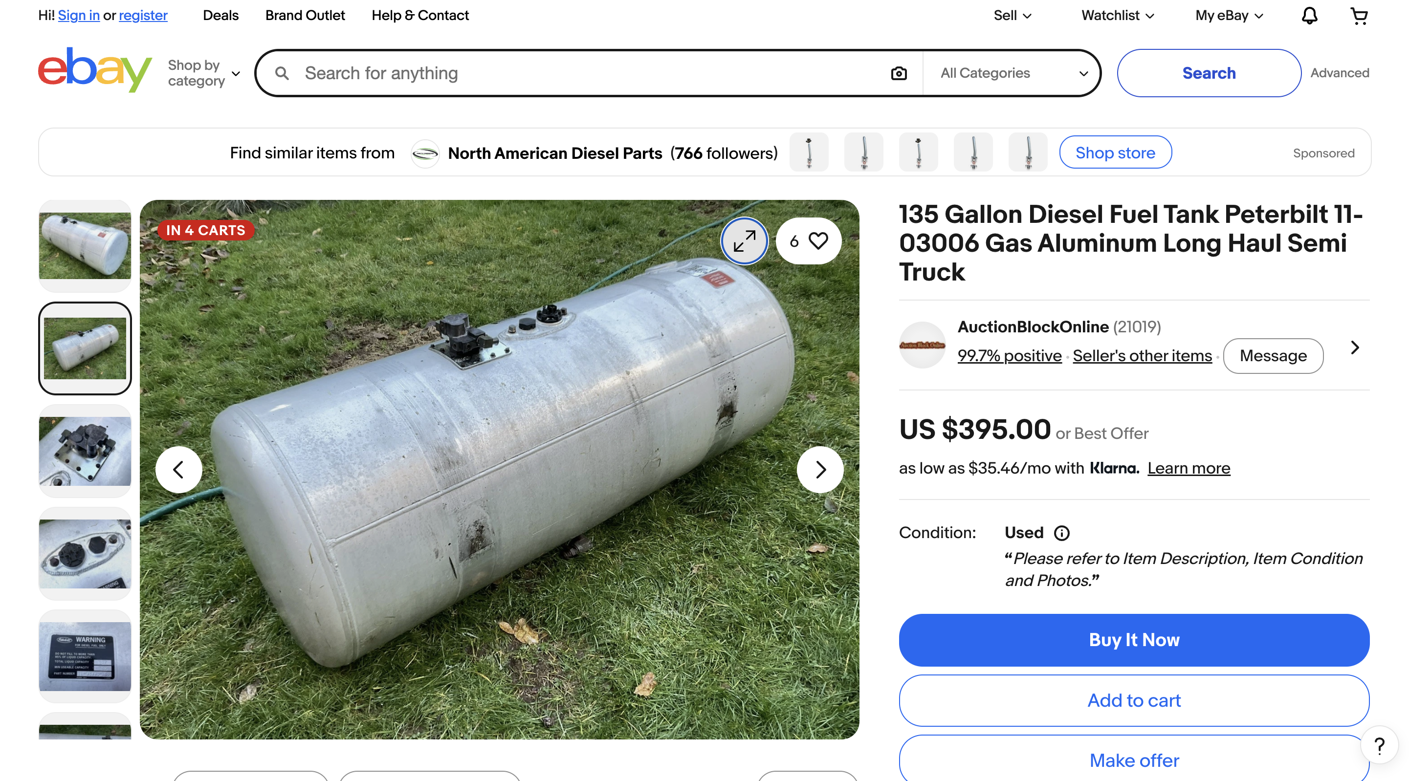

    There is a used 135 gallon aluminum diesel truck tank for about $395.00

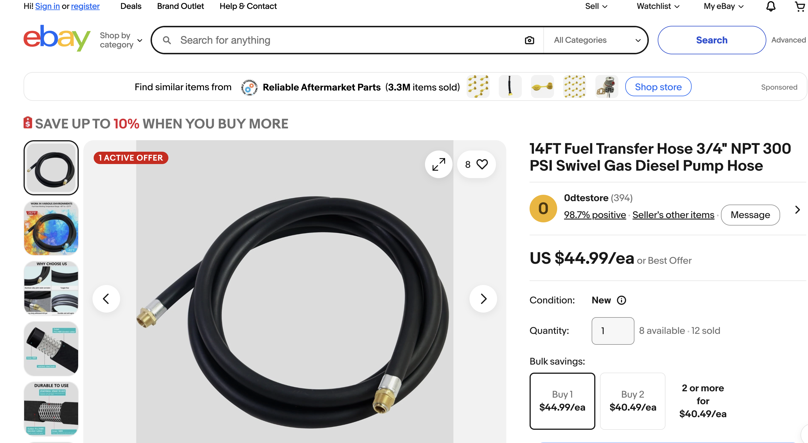

    then a diesel hose to connect to the bottom of the tank at about $45.00

    That comes to about $1,800.00.
    At a savings of $125.00 per year, you will save enough on fuel in about 15 years to pay for that investment. Then you can start saving big time.
    Maybe if you were to let your friends use the trailer for a fee, you can recoup a few years sooner.
    Of course, you might need to repack the trailer wheel bearings, fix a busted tail light or even change a flat tire over the 15 years. But still…. You are saving big time on that fuel.
