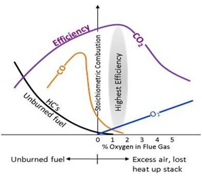

Battling the HTP phoenix lite that I've named "tuba". Foghorns like a sonofa for the first 30 seconds or so after ignition. I tried all the usual suggestions and the only thing that works is throttling a little rich. It's out of spec though. Manual calls for 8-10% for low and high fire. I keep low around 8.5 for some excess air to keep the burner cool but high is closer to 11 if I want silence. Maybe a little more. CO stays well under 60 so I don't know if I should even care as it's more efficient combustion the higher that CO2 goes. I've searched and searched and nobody ever has a real answer to all the modcons that howl besides richen it up.
co of 60ppm seems kinda high, you are probably on the low excess air side of the curve.

You probably aren't confused, but I've seen it enough times to feel a need for a caution: CO and CO2 are not the same thing. And in combustion work in general, CO will increase with a richer mixture, while CO2 will increase with a leaner mixture.

Yes I'm on the right side 100%. I thought of that. The readings verify based on my gas adjustments. I'm between 3 and 4% O2 currently.
Just a thought — but have you tried going way lean? Just enough fuel in the air to fire up? and then adjusting back richer? Until the CO2 peaks and the CO maybe beings to show an increase?
Not sure what you mean. just to verify I'm on the right side of the curve?

I have checked that. I am 100% sure I'm on the right side of the curve.
If our CO is around 60, you are way too rich. End of story. Something is not adding up.

the better question here is if you are on the left side, as you lean it out, does it stay ignited as it gets to the excess air side or does it go out and leave you with no way to adjust it?
