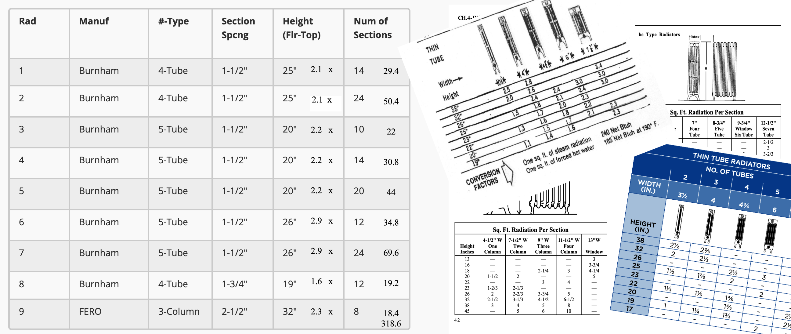

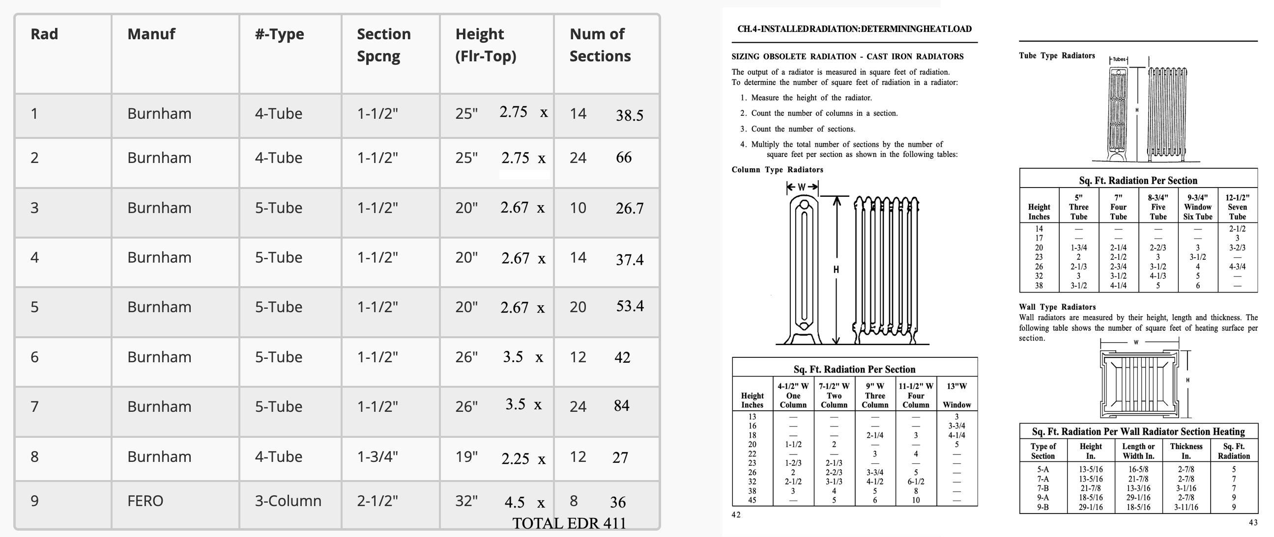

    I used the Burnham boiler sizing guide and got 411.
    But that book does not have the thin tube listings. I use to use the Weil McLain sizing guide and that listed both the standard tube and the thin tube with dimensions of the sections. Do your 4 tube width sections measure 7" and 5 tube width measure 8-3/4" Like the attached chart? If they are smaller then you may have thin tube and this calculation is not for you.

    I believe that the radiators in my home are the much older, slenderized Burnham radiators. The widths are as follows:
    Burnham 4-Tube, 1-1/2" spacing, are about 4-7/16" wide
    Burnham 5-Tube, 1-1/2" spacing, are about 5-5/8" wide
    Burnham 4-Tube, 1-3/4" spacing is 4-7/16" (new, replacement slenderized)
    Fero 3-Column / Tube, 2-1/2" spacing is about 5-1/4" wide
    The Burnham Heating Helper is a great resource, but the sizing of the radiators in this reference do not match the sizing of those in my home. I believe that the contractor used the Heating Helper for his original calculation.
    EdTheHeaterMan Posts: 12,940
    With that additional information and some other steam rating tables to match your dimensions. I was able to get a more accurate EDR of 318. So the Burnham Steam max 125 is spot on!

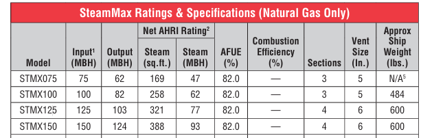

    If it had to be a Burnham I'd be going with the STMX100 honestly.
    You have 277sqft, so enough radiation to consume 66,480 btu/h. The STMX100 produces 82,000 btu/h output. That's more than 20% over what you need in a perfect world. That's plenty of safety margin and quite a bit more than my own system has.
    The 125 is still oversized and it'll be a mistake.
    The 150 is ridiculous.

    Strongly agree with @ChrisJ the STMX100 still gives you 23% pickup factor. In your case that would be enough to support about 102 FEET of uninsulated 2" main. That boiler will run beautifully on your system.
    The 150 is literal insanity and for me shows the incompetence of the contractor. The numbers don't lie.
