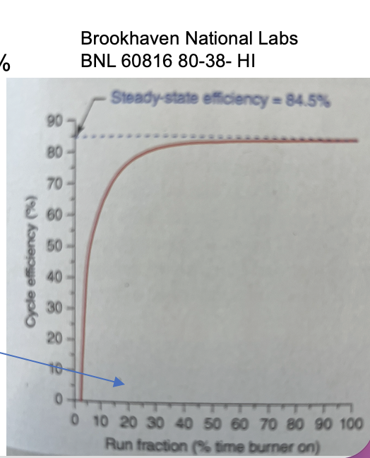

    hot_rod Posts: 28,699
    If you time the cycles, how long it runs after firing, then how long it is off before the next run. Then you calculate the Run Fraction.
    Suppose an oversized boiler runs just 5 minutes, then shuts down for 20 minutes.
    5 ÷ (5+20)= .2 or 20%
    Enter the bottom of this graph at 20%, run up to the curve to get actual efficiency, running in the 70% range at that Run Fraction, quite a bit less than what a steady state condition would be, at the 84- 85% range
