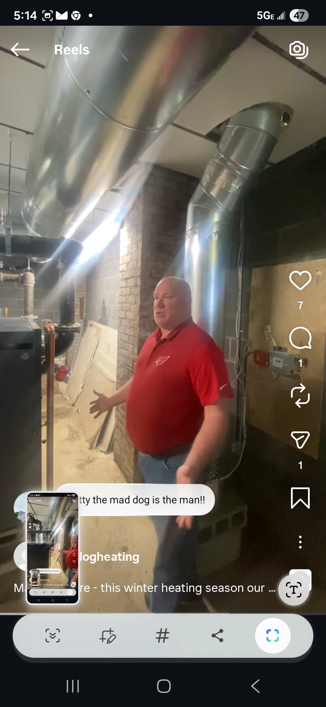

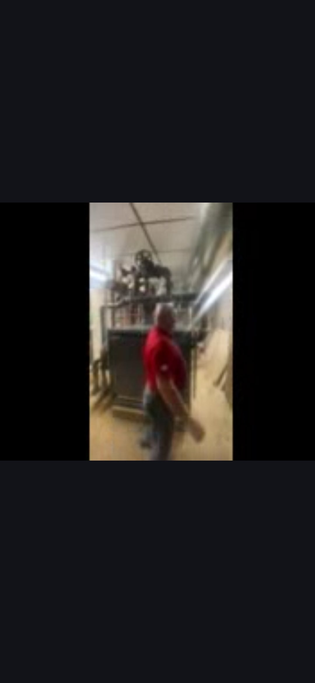

Last winter we replaced two, 12 year old Weil Mc Clain LGB-8s in an historic Hudson Valley Church ⛪️. The Boilers had unnecessary F&T Traps that clogged over the years and helped cause dry-firing of both boilers, Zero Combustion Air provisions which lead to both boilers carbonizing as well.
On Top of all of this, The Church had been paying for an expensive maintenance contract but the automatic and Manual reset LWCOs were clogged and failed to prevent total boiler failures.
If you're going to tackle Steam work and want to be successful, going All-In is the only path to Victory. Mad Dog

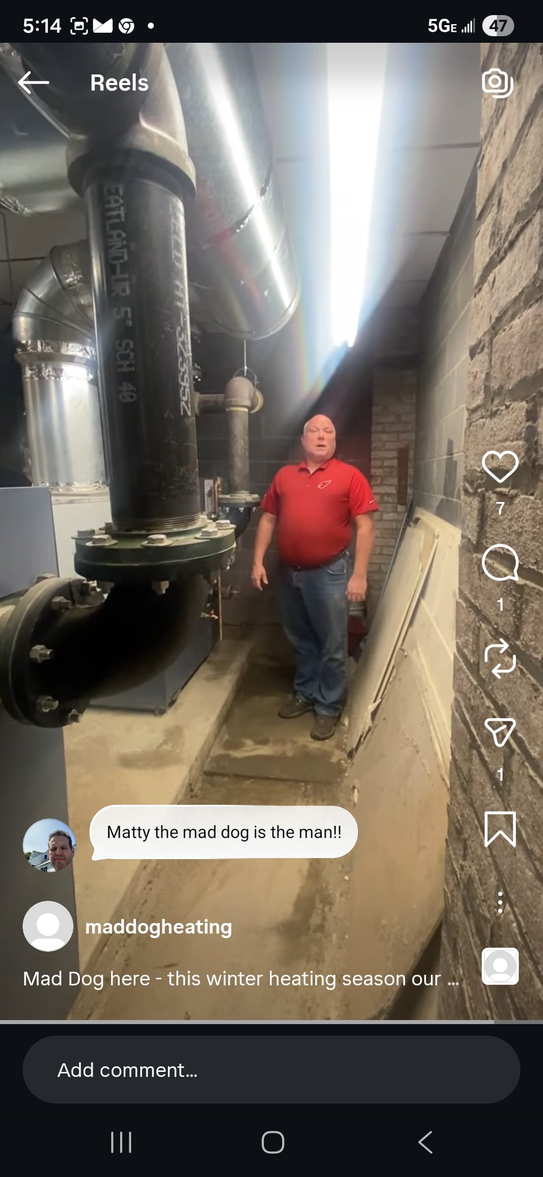

They were extremely lucky and had The Lord looking over them. All the electronic controls and wiring were fried too! We make sure ALL of our boiler installations from a Small residental job on up get a Carbon Monoxide/Smoke Boiler Interlock for added safety and protection of Life and Property. Mad Dog

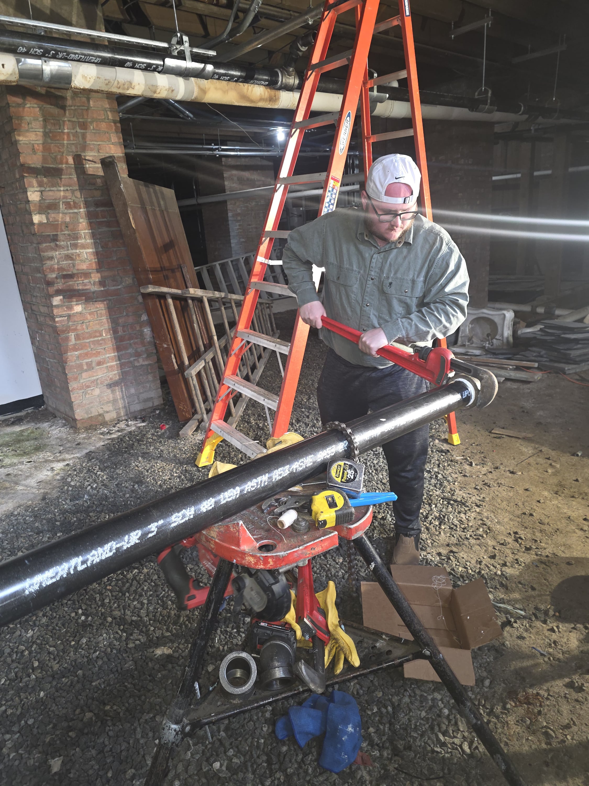

One LGB -10 and One LGB-5. The Sanctuary (LGB-10) and upper level of the Church gets used only 3 hours every Sunday, so we seperated the systems and ran the first floor on its own new mains 3" and 2 1/2" and Returns. The First Floor is used 7 Days a week for Meals-on-Wheels, Bingo, Et Cetera.
We expect to see a healthy drop in fuel usage. We now have both systems humming along on 12 ounces and 8 ounces, respectively,of Steam Vapor. Mad Dog
