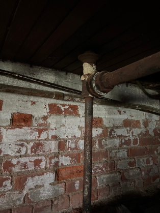

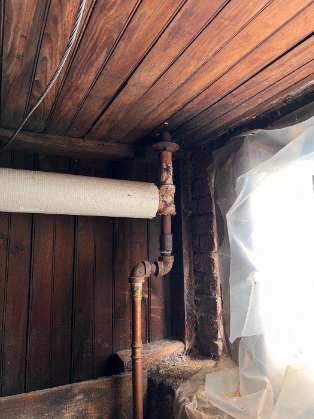

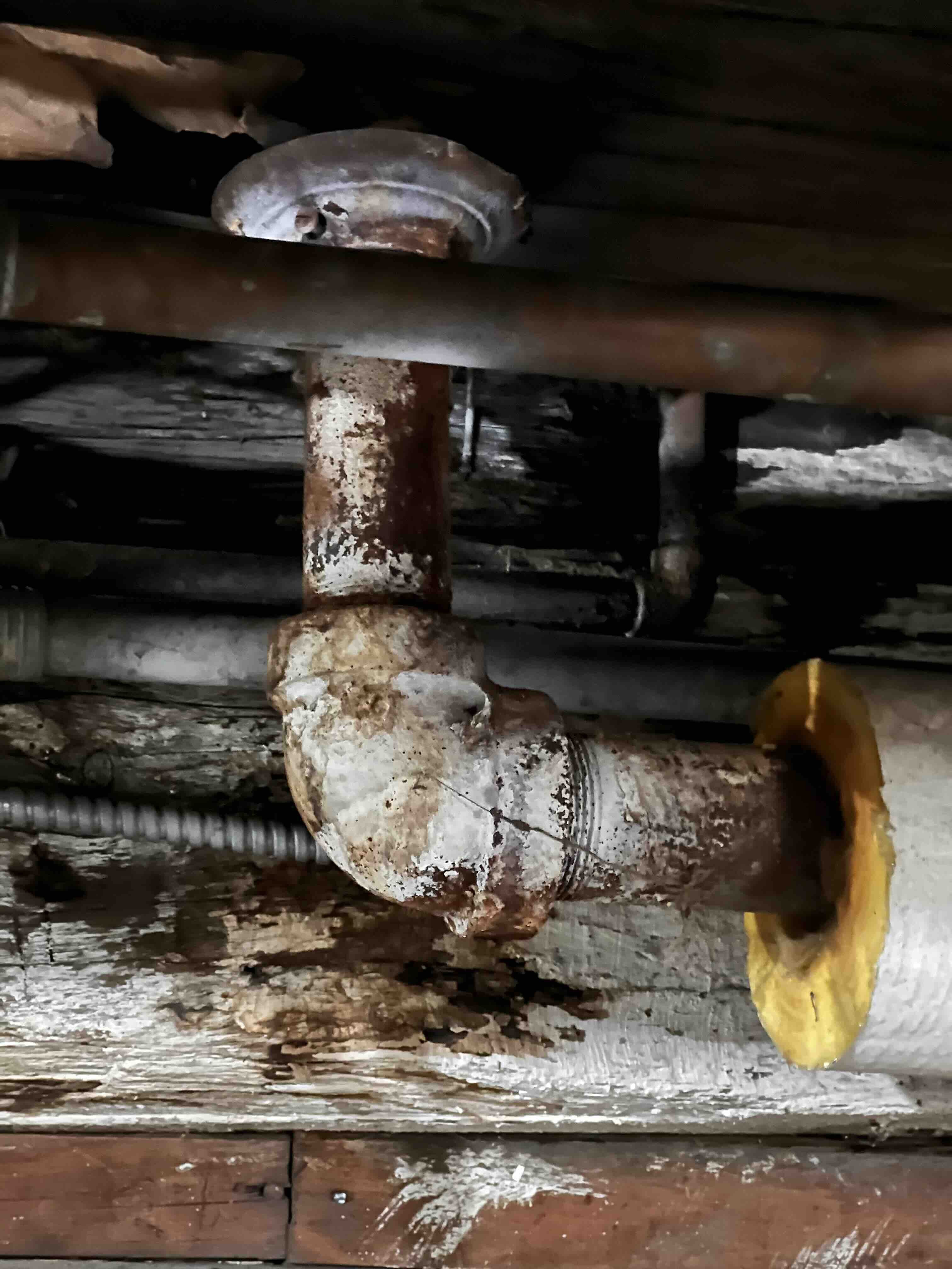

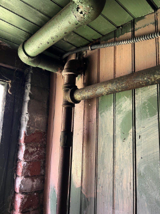

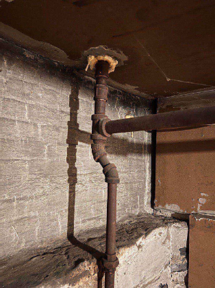

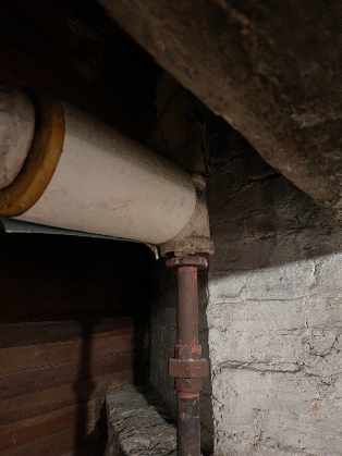

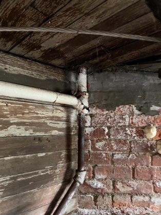

Here are the locations where I believe we need to install main vents - do these look right to you? The house is large, so there are 19 radiators in total, which are served by 5 main runs (or so I believe).
My understanding is that the main vents should be installed in those places in my basement where a supply run meets a return run. is that correct?
Here's an example of a place where I do not think we need a main vent - there's an upward pipe but it does not meet a return. Am I right?

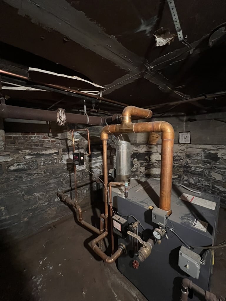

Finally here's a picture of the boiler and the near boiler piping:
I don't love that the near boiler piping is in copper, but it's perhaps something I will attend to next year.

    More or less. The idea is to have the main vents for each steam near, but not necessarily right at, the end of the main. In fact, it's better to have them a foot or two back from the end of the main, so as to protect them from any possible water hammer.
    ethicalpaul Posts: 9,075
    edited May 11
    I wouldn't count on being able to notice a significant energy cost difference, but there should be a lot less venting through the radiator vents for sure.
    Balancing and speed of heat arriving at your radiators should be a lot better.
