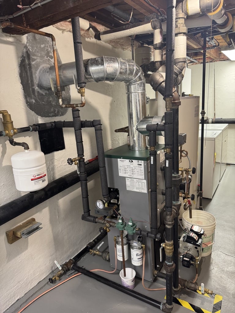

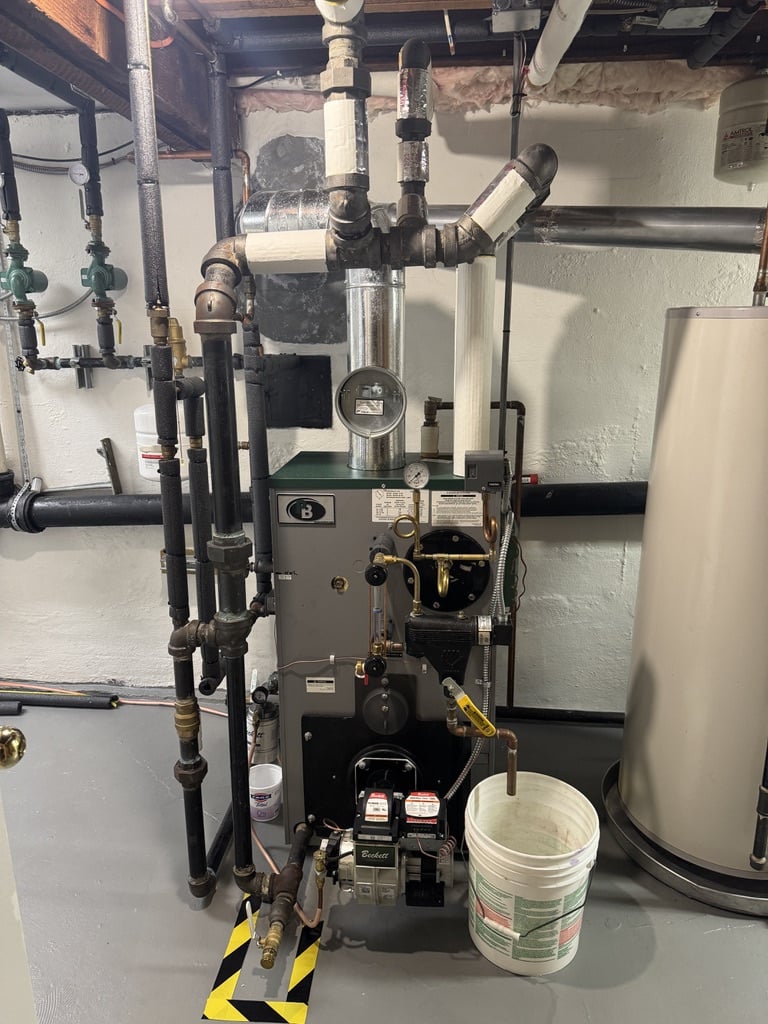

Brand new installation of a Peerless ECT 3 Oil fired Steam Boiler with 2 additional hydronic zones added from coil.
Boiler has been cleaned ( with washing soda) and skimmed, drained refilled, then Rectorseal 8 way was added. (Full Bottle big mistake) , Boiler was blown down, via manual blow down, countless times
Boiler then was drained fully, and only 4 ounces of Rectorseal 8 way was added to maintain a boiler water Ph of 9, via Ph paper tests.
Last consideration the gaskets around the coil, which will heat and cool over summer dry out, and eventually crack. Should this be considered a reason to leave system on for summer.
Now the million dollar questions?
  1. Should I completely shut down the boiler until next heating season?
  2. Should I monthly fire up the boiler to steam, blow it down, and then re-shutdown.
  3. Should I leave the boiler on to heat the water to about 180 to maintain coil hydronic temperature?
  4. Should I lower the boiler aquastat for coil to 120 degrees for summer and leave system on for summer?
Thanks for any wisdom on The Wall.

    Of your options, I'd pick 4 — but I have a question about the coil gaskets. Presumably that coil and its gaskets are below the boiler water level? If so, why would they dry out? So why keep them warm?
    So what I'd probably do is just leave the boiler alone. I might turn the thermostat down so it won't run on a cold morning… I might not (actually, I don't — I never touch the thermostat for my system, and for the seasonal houses I care for I turn it down to 50 when they aren't occupied and to whatever the owner wants when I hear that they are coming). I would certainly not blow the boiler down. Once a year should be ample for that.

    I agree with @pecmsg about the tankless coil bolts. They should be removed 1 at a time and coated with never seize. They should be checked for tightness yearly.
    If you see and stains or dripping around the coil gasket in the future don't wait too long to get it fixed.
    Other than that keep the boiler off if you don't need to run it.
    Congrats on finding a good installer. Looks like you got a good job from what I can see.

    Tankless coil bolts are something contractors often forget about, and homeowners usually do not discover the problem until it looks like something from the Coral Sea has been growing there for years. By then, it is often too late.
    When I installed a tankless-coil boiler (which I rarely recommend for domestic hot water), I would go back after 6 months and snug up the bolts. Sometimes I could get a full half-turn on them just from gasket shrinkage during that first 6 months. I would check them again at the 1-year mark. After that, I would still inspect them every year, but they rarely needed any adjustment.
    That is one of the advantages of selling service agreements—you get the opportunity to go back and correct things like that while performing the annual tune-up.
    I applaud you for taking the initiative in this area.
    As far as leaving a boiler operating and burning fuel just to keep an unused tankless coil warm, that is a waste of money. When you do not need heat, turn the thermostat down and let the boiler sit unused in the basement all summer. It will not burn any oil that way, and therefore you will not spend money on fuel being wasted up the chimney for no reason.
    I think of it like this: After spending $$$$ for 18 years of keeping the boiler at 140° all summer (or what ever temperature you choose) and you find that your coil gasket has leaked anyway, think of all that money you could have saved by turning off the boiler in the summer, so you could afford to repair the leaking gasket.

    Thank you for the advice on these coil bolts, I plan on unthreading them carefully one at a time, and adding Never- Seez NSBT- 8 Silver to threads and retightening, then will check them regularly for any loosening.
    I will shut down the boiler for summer, and let it sit, perhaps firing it once mid summer for a check and blowdown, saving oil.

    Jamie Hall: the coil gaskets are on the exterior of the boiler between the first section and the coil, I believe. someone correct me if I am wrong. I was told they dry out from aging, and from being cold (shut down mode_ to hot (steaming mode). The side coil bolts are in the last section.
    Ethical Paul and Pecmsg:The side coil of the boiler is used for two hydronic zone loops for basement and attic as attic had only singular radiator, and basement had existing hydronic zone.
    The benefit of lowering to 120 was to reduce boiler cycling on to maintain temperature at 180.
    As mentioned summer full firing to steam would be only to blowdown and check system prior to heating season.
