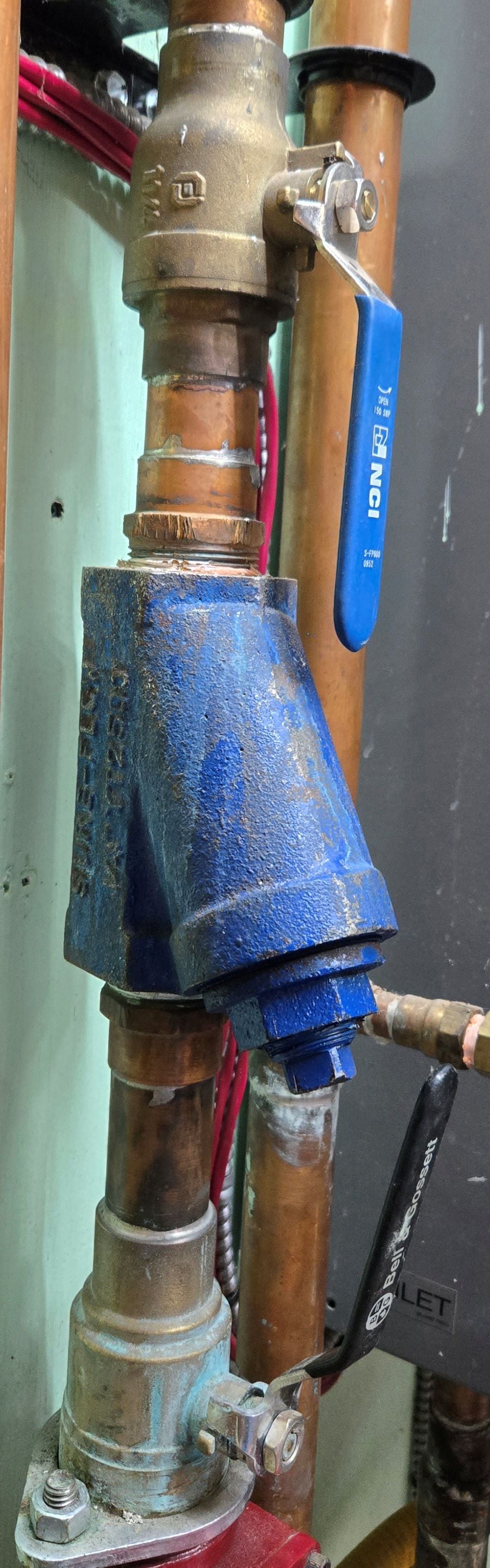

I have a Y-strainer that hasn't been cracked open for years. I've tried WD-40 Specialist Rust Remover over several days, but no luck so far. Here are two questions:
1) What brand of penetrating oil do find works best for hydronic systems?
2) To open the strainer, I could use two pipe wrenches; the second one pulls in the opposite direction to stabilize and reduce torque on the pipes. I'd like to try an impact wrench on low setting. In other situations (e.g.: rusted lugnut), high-frequency, low-duration impacts work better than a strong-arm . I would still use the second wrench to stabilize the connected pipes.
  • Any thoughts?

    Pb Blaster. I have had some very good luck with it.
    There have been a couple of times when a heated-up fitting and pressing/melting a crayon, yes, I said crayon, into the heated joint can work well too. Take the one from the coloring book box that never gets used. 😉

    When new pull the strainer nut and never seize it.
    What size strainer. Maybe replace the whole thing!

    That plug…3/4" or 1/2" ? should come out. Pb Blaster? Apply it often over time if you have the time, and try it after a couple of weeks.
    I'm thinking you don't even need to do that. A couple of 18" or larger pipe wrenches should unscrew the plug as is.

    that will probably unscrew with the right wrenches. the plug to just flush it should be easy, the cap to remove the whole strainer will take more force.

    could replace the plug with a boiler drain and hose thread cap to make flushing much easier.

    Heat. Kroil.

    I never understood why plumbers install strainers with a plug instead of a bibb drain. See it all the time.

    What type of piping in the system?
    Do you really need a Y strainer? Looks like it has never been drained or disassembled?

    Kroil Oil is the best IMHO.
    Y strainers are difficult to get the wrenches on especially in a tight spot.
    I would unbolt the flange below the strainer and unscrew the strainer off the copper adapter.
    Then you can put it in a vise and get the plug out. I would also while it is out remove the bushing and take the screen out and clean it. Put everything back together with teflon tape and "Never Seize" as @pecmsg mentioned and a drain valve instead of a plug. You are in an awkward position with the strainer vertical and the wall to get leverage on it.

    Ed, that is great advice (to "unbolt the flange below the strainer"). Get that strainer away from the pipes and walls and entanglements, and work on it in a vise. I wish I'd seen it\\your comment earlier.
    I was able to get an electric impact wrench with an oversize socket on it. The frequent, short bursts smoothly did the job. The strainer was packed with magnetite. It feels so good to put it back clean.
    Thanks to each of you for your advice and insights.

    if the system is empty, heating the casting seems to always loosen stubborn threaded connections
