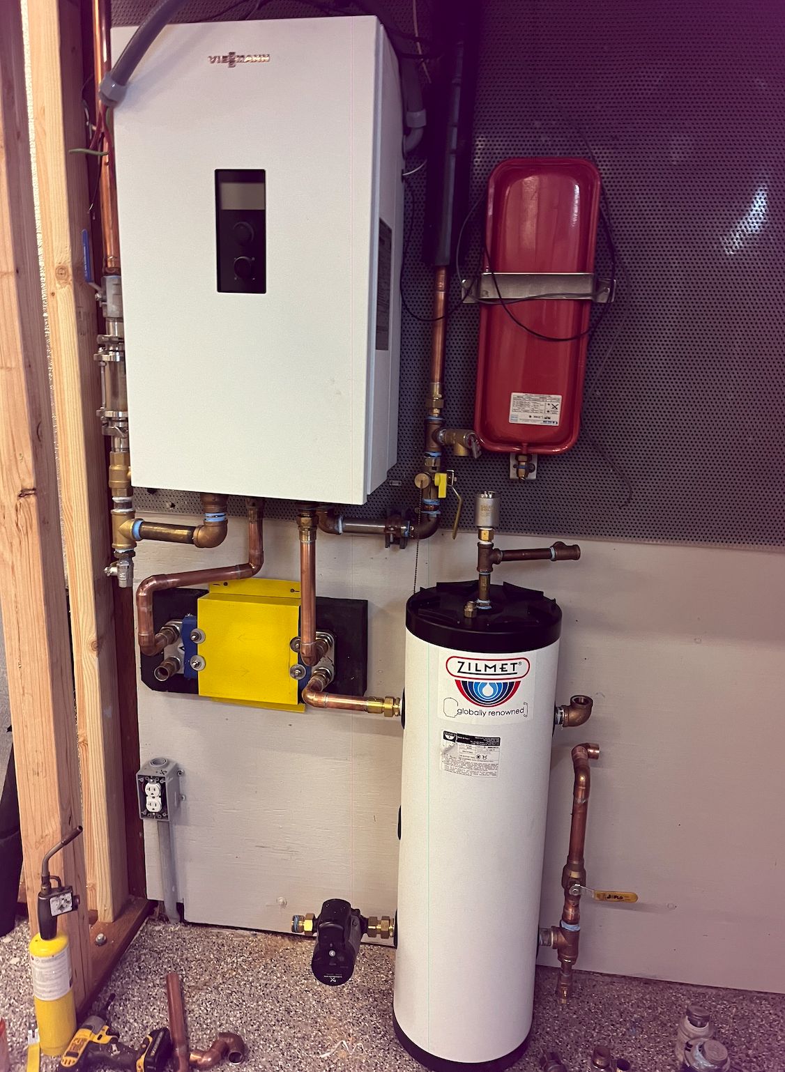

I apologize for the fusillade of questions lately. I am getting very close to pulling the trigger on accepting a bid, and am trying to take care of a few details.
I have a converted gravity system, so ~170 gallons of water in the 100-year-old iron/steel pipes and rads. I specced a magnetic dirt trap, strainer filters, demineralized and treated water, etc.
However, the pro that won the job is offering two options for the primary/secondary interface: The expected/requested hydraulic separator, or an upgraded option of a flat-plate heat exchanger.
Naively, it seems like the flat-plate HX would be a big improvement for this application. I imagine that it would subject the boiler HX to a lot less gunk/scale, and presumably extend the service life. So I wonder why a HX is not used as the separator for the primary and secondary loops more often? The upgrade is not cheap, but not ridiculous, about the same as the sticker price on a middle-of-the-line modcon.
Any comments on desirability of the flat-plate HX option? Thanks!
(I couldn't help but notice the one in @hot_rod 's AWHP project: )

    any time you have a heat exchanger there is an efficiency drop. in smaller systems a hydro sep, or buffer tank can provide some added volume allowing for less cycling. There is an argument to be made where a heat exchanger can be a better option, but in my mind the heat exchanger is typically a last resort to protect the boiler due to site conditions.
    Gunk and sludge is not good for your boiler, and it will also impede heat transfer. typically I would rather put money to cleaning the existing system and using something like a caleffi sep4, however your contractor may have info I don't have. with a heat exchanger you also will need 2 expansion tanks, and pumping requirements for the system may change with the added pressure drop of the additional heat exchanger.
    an example of when I opted to use a heat exchanger, there was a system that was used as a chilled water pump and dump loop in the summer months. they were killing boiler heat exchangers annually so I recommended separating the boilers from the system via heat exchangers.

    For my application the HX is to separate glycol in the HP circuit from the buffer/ separator and the radiant loops.
    If you select a separator with a 4 in 1 function you get the hydraulic separation with excellent air, dirt, and magnetic particles separation.
    I don’t see a need for the plate hx and I would definitely add a Y strainer to it if you go that route
    The Sep 4 is one of the high performance options.
    But as @GGross mentioned, a good power flush of the rad and piping before you connect to it would be wise

    the hx will be a lot less tolerant of the muck in the gravity system than a fire tube boiler will be. you will still have a circulator on the system side and that is the thing that is most likely to have a problem with the iron much in the system. it can stick to the magnets in the wet rotor circulator and damage things which is why the magnetic dirt separator is important.
    if it is a single zone and you do your math right you probably don't need to do primary secondary on a gravity conversion with a modcon. if it is also running an indirect or is several zones primary secondary is probably better.
