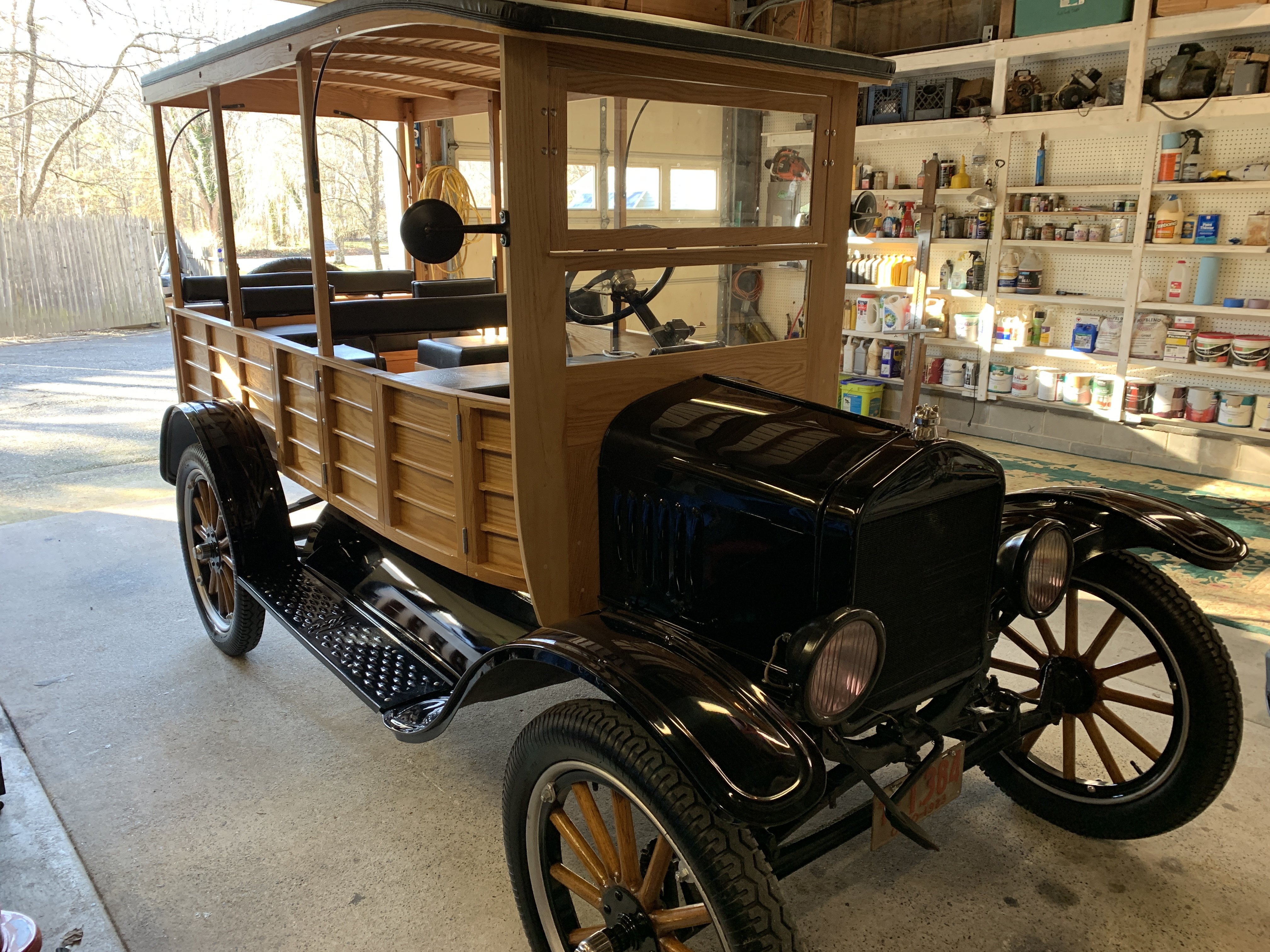

    I hope you have good luck in finding a steam head in Maine. I was there one winter to pick up this Depot Hack hand made body for my 1923 Ford T. It was from a town called Cape Neddick.

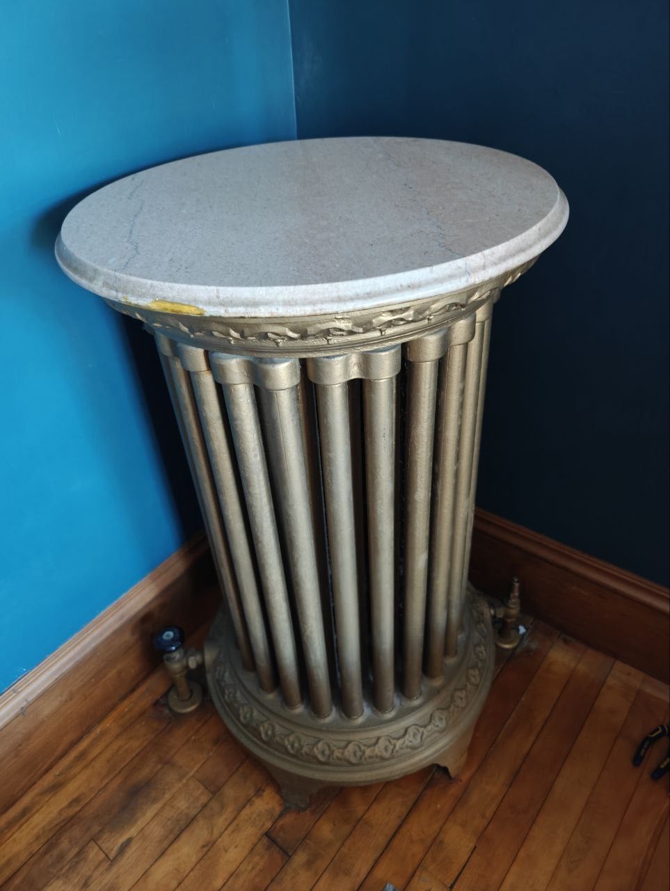

    Thanks ED! The house is aprox 4000 sq feet/3 stories, and all steam piping is insulated in the basement, but the risers past the basement are all uninsulated. In many cases this is for aesthetic reasons, since on the first floor they are all painted and designed to blend in with the living space (all outside the walls) but on the 2nd and 3rd floors there are a few places where we could pick up a little insulation where runs are in closets. This beauty alone I estimated to be about 120 sq feet (there are 2 rows behind the first one):

    That's a beauty! I think it might be a Nason. Is there a name on it?
    We have ratings on a lot of very old radiators on the site. The Nason and other similar radiators are here:
    https://www.heatinghelp.com/systems-help-center/ratings-for-gold-nason-bundy-and-reed-radiators/
    Click on the PDF link and scroll to page 2, the Nason circular radiators are there.

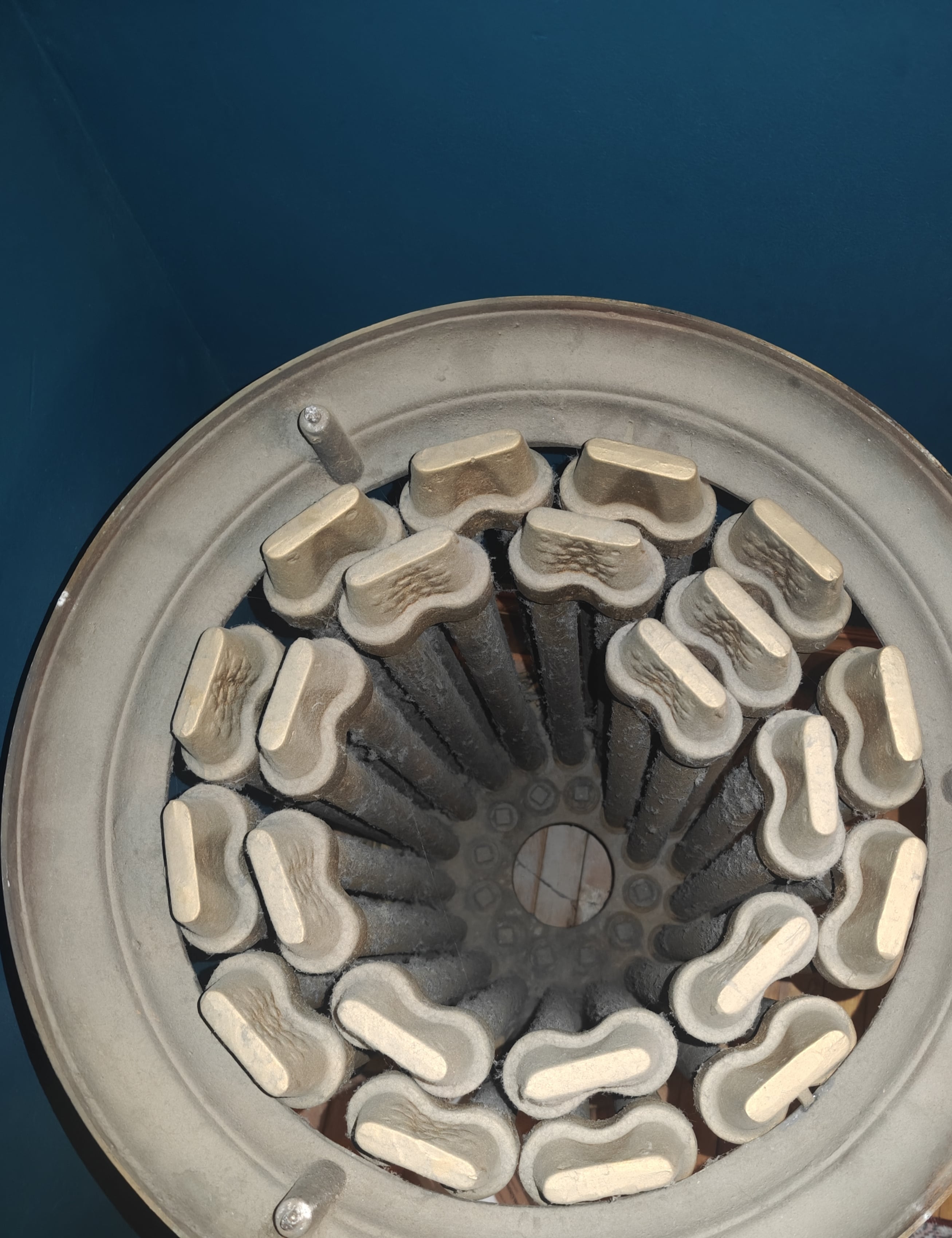

    I can't find a name. It looks like its 40 tubes, 1.5in OD, 27 inches long. The surface area is something like 18 square feet of pipe OD so maybe I was way off

    If the overall height of the radiator is roughly 3 feet, each tube is 1 square foot.
    AFAIK Nason did not put their name on their radiators. Bundy did, not sure about Gold and Reed.
    Are all your radiators of that general type of construction?
