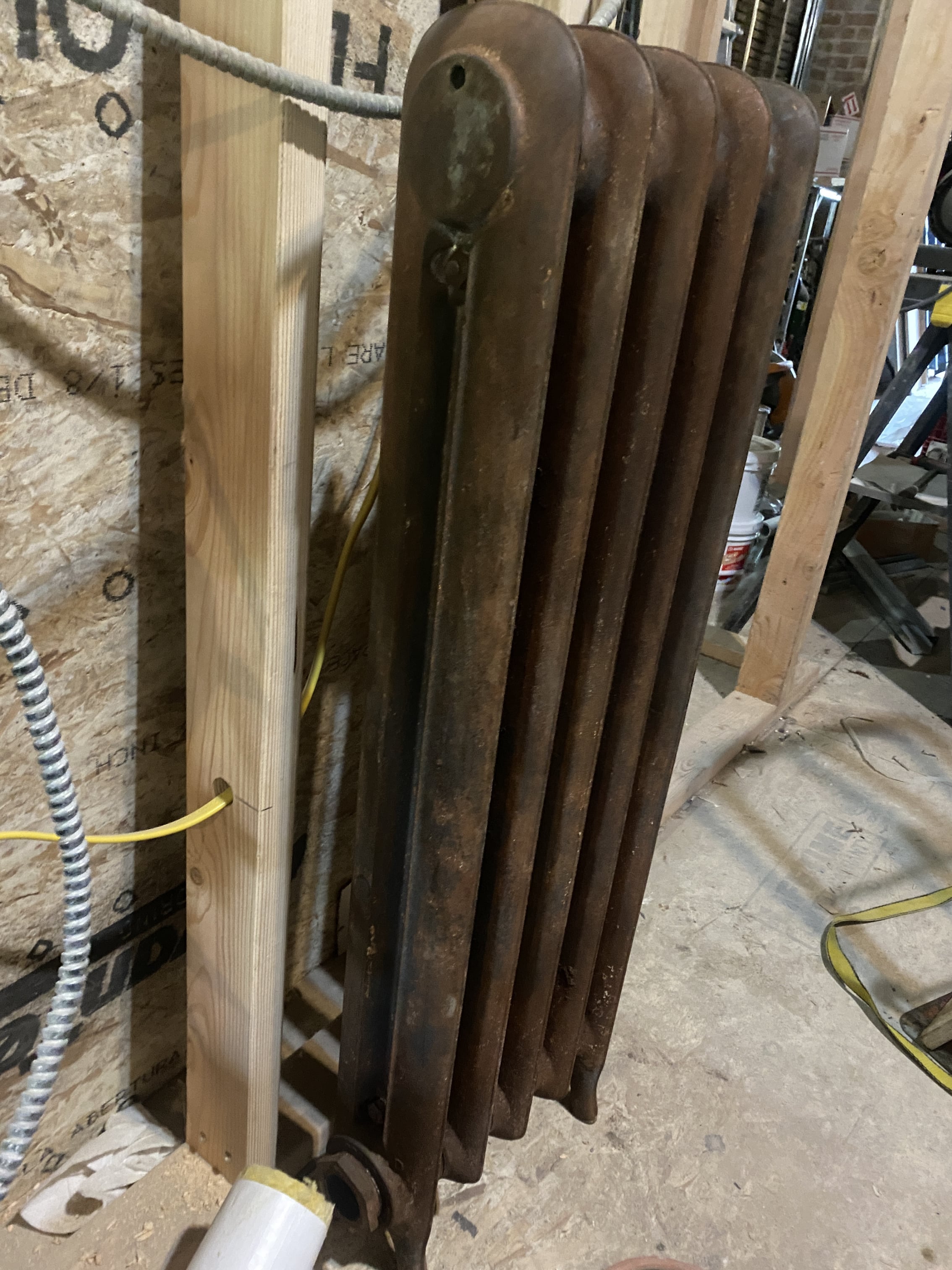

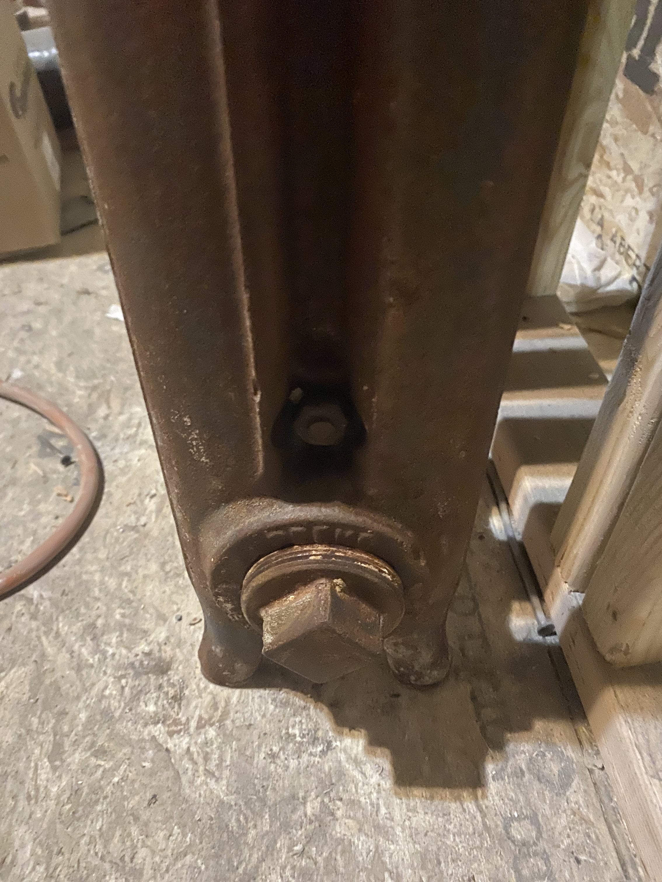

I have a radiator where the vent hole is on the same side as the valve opening. And the vent hole is in the wrong location (near the top instead of 1/3 of the way up from bottom). From what I recall, it heated up ok. Maybe not 100% but it did the job and my radiators will be a backup heat source. MAin heat will be from heat pumps.
I am not going try to drill the vent boss on the opposite side. I am batting 0.500 on that procedure. 2 situations where I ruined the radiator. Cracked thru the column.
So I could attempt to remove the plug using mapp gas, PB Blaster and cheater bars. I've cut out bushings from radiators valve openings in the past, but never removed a plug with a sawzall.
Is there a good procedure to remove the plug, or is this a "LEAVE WELL ENOUGH ALONE" situation?

    You can dill and tap a vent hole on that flat side , 1/3 from the bottom, Plug and seal the other hole .. We are talking steam..
    branimalkcoppIntplm.
    Then leave it alone. I don't take risks when there is very little to gain. You take risks when there is a lot to gain.

    You could hire someone to tap it out for you.
    pecmsg Posts: 7,634
    edited May 1
    That's about how we all learned……….By mistakes. Try drilling and taping. Worst that happens is you have to get a replacement radiator.
    Intplm. Posts: 3,160
    Leave well enough alone. I would put the radiator back in service as is.
    because that radiator is pretty small, the vent begin in the wrong place probably doesn't have a huge effect on its output.
    since that is a column radiator rather than a thin tube radiator the casting is thicker where you will be drilling and tapping. get the right size drill from the tap chart and work up to that size in a couple steps. use some cutting oil like tap magic for both drilling and tapping, don't just use some random oil, cutting oil has extreme pressure components that lubricate where the cutter is wedged in to the face of the metal in a way that ordinary motor or household oil doesn't. Make sure you drill and tap square, if it is not square it will put off center loads on the tap that are likely to break it.
